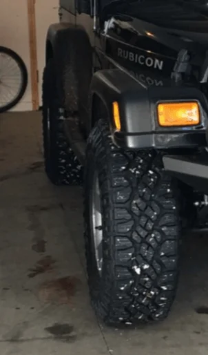

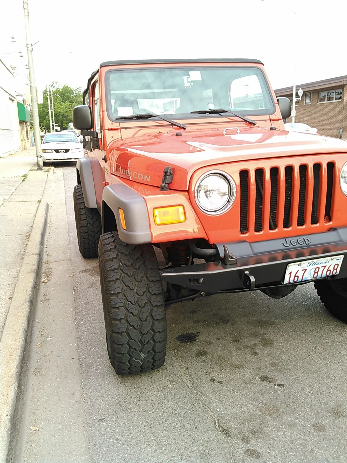

This should actually get you pretty close. 305 70 16s mounted on the factory wheels, which are 5.5" backspace, however, they were mounted with 1" spacers. Rubicon flares. They hang out there a bit. Looked pretty cool, but those things were heavy.

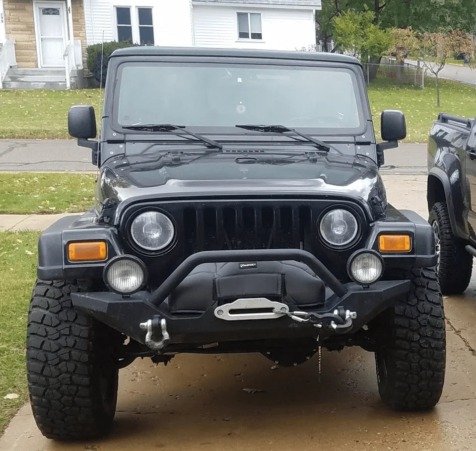

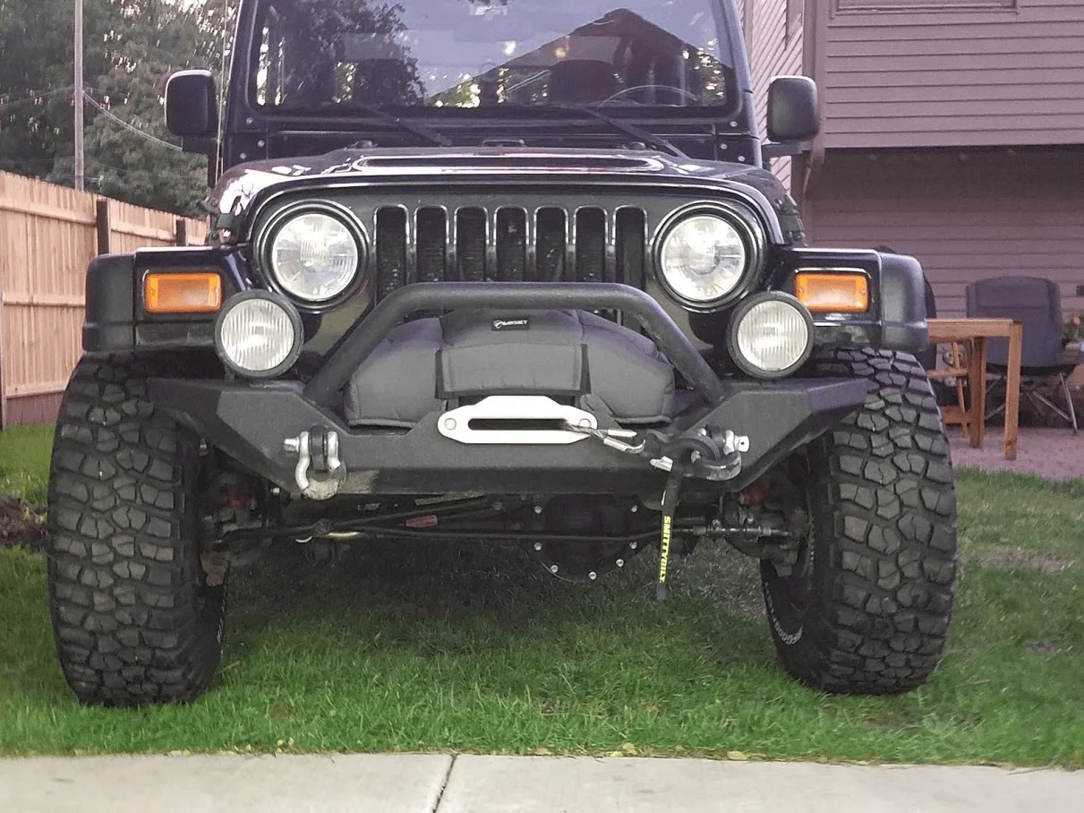

Here is my other data point:
Chris, correct me if I am wrong, but I believe this to be factory moab's with no spacers, just touching on the control arms at full lock with 285 75 16 duratracs:

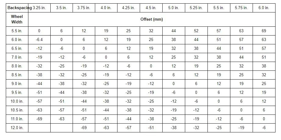

Honestly, I couldn't recall myself, so I did a quick search as I replied to your first note and found a couple of references to ET 25. Based on that, and this little chart I dug up someplace, I got 5.5" and that sounded right to me.
At this point, we're talking about 1/2" so either way, what you see in that pic isn't going to change significantly. The Jeep was on aftermarket control arms at that point (Skyjacker) and they did not rub. After changing tires to 255/85 16s, and removing the spacers, they did rub a bit, but I didn't adjust the steering stops. Sometimes, on trail, I want as much turn as I can get, so I just let them rub - it's not a huge a deal to me. When it comes to parallel parking or making the occasional tight turn, I just back off the wheel a bit.
