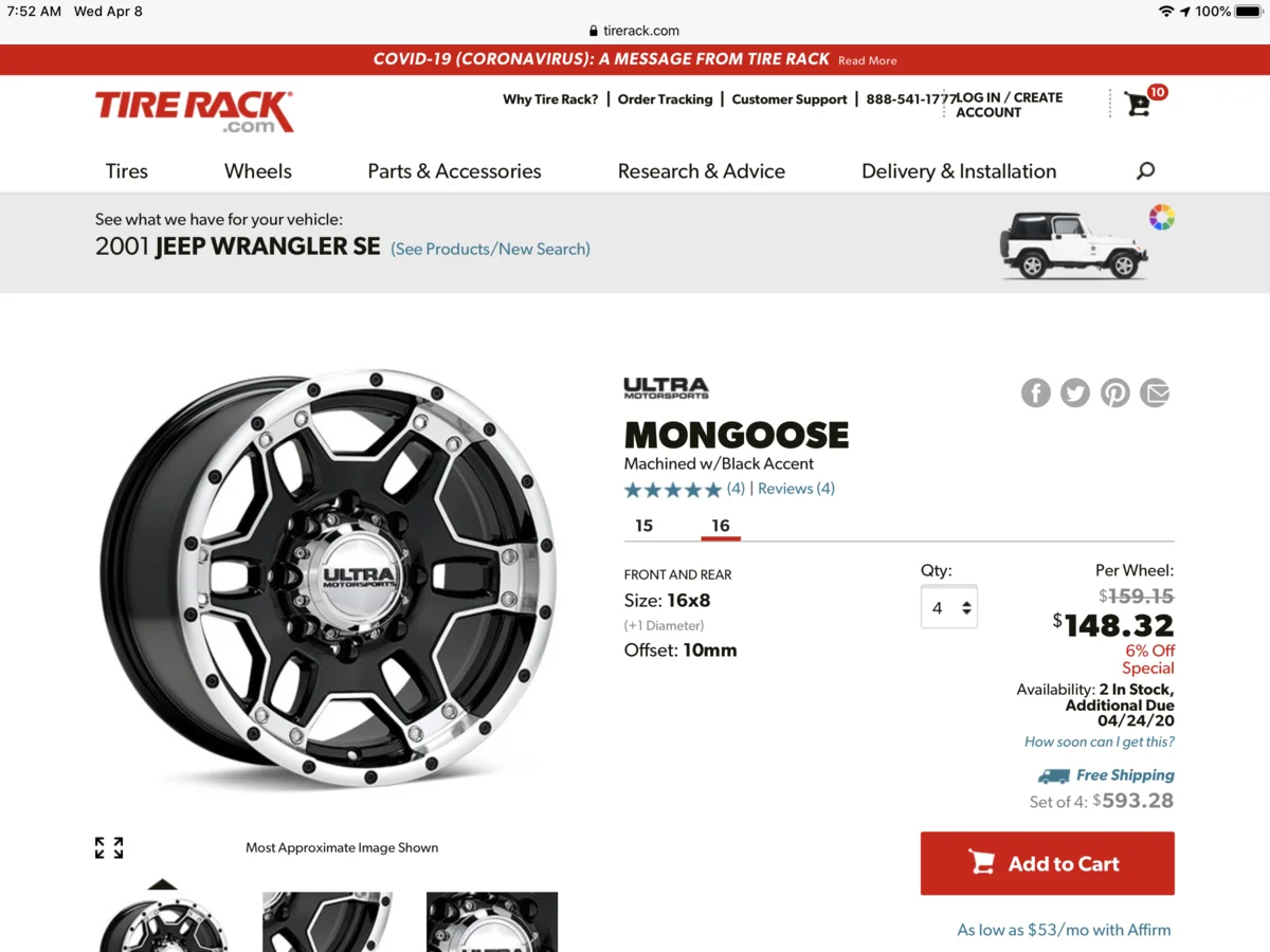

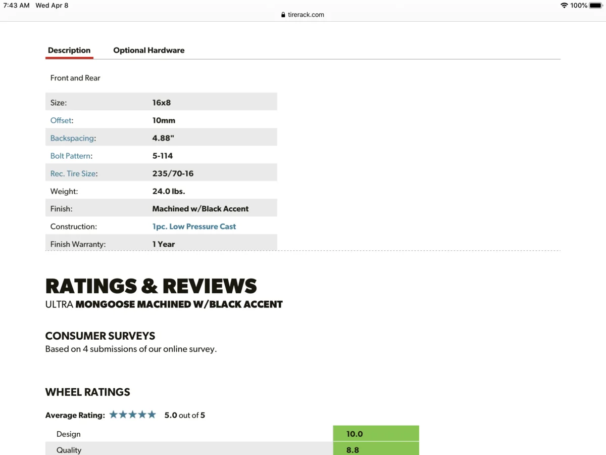

I am searching for new tires and wheels and I think I have narrowed it down to something the wife and I can agree on. I wanted to see what everyone thinks and if I am using the wheel offset converter correctly. Currently the Jeep is stock, 2001 SE, 2.5L. Our Rancho 2.5” lift will be here this week. I have uploaded a picture of the wheel and screen shots of the offset calculator numbers I plugged in. They 16” has a 10mm offset and the 15” has a 19mm offset. And from what I can tell the stock wheels have a 38mm offset.

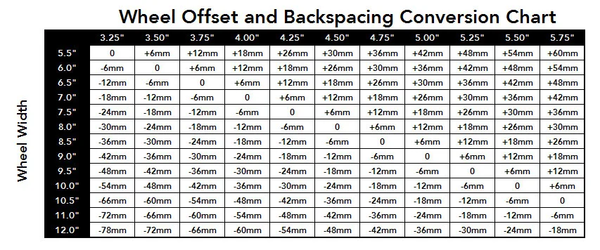

Here's an offset to backspace conversion calculator here:
http://www.gtsparkplugs.com/Offset-to-Backspace.html

Ok so someone can check my math. Stock for my Jeep is 7” wide Wheel, 5.5” Backspacing, +38mm Offset, a new 8” wide wheel with 19mm offset, = 5.25” backspacing.
Would that work with a 32x11.5x15 tire. I believe it would have the tire about 1/4” closer to the inside of the Jeep. Is that 1/4” going to cause issues with clearance. I am installing a 2.5“ Rancho Kit first and we are still shopping tire/wheel combos
Thanks again.
You will probably rub on the control arms with that setup. It'll be close and you'll probably also rub on the inner fenders as well with the sway bar disconnected.
