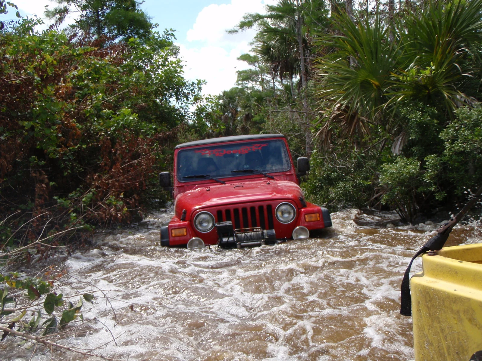

I've relocated all my vents. I ford water about bumper deep pretty regular. That's as deep as I feel comfortable going. A properly set up snorkel would get me more depth capability, but I don't fully trust them. And reverse is always my best option
So, to answer the OP's question, in my experience, anything higher than my bumper. YMMV
**EDIT** They kayak is in case I misjudge the water depth. I can still get back to dry land.
Many years of water wheeling. The water down here is stationary so no worries with risk of any raging rivers like you guys have up north :)

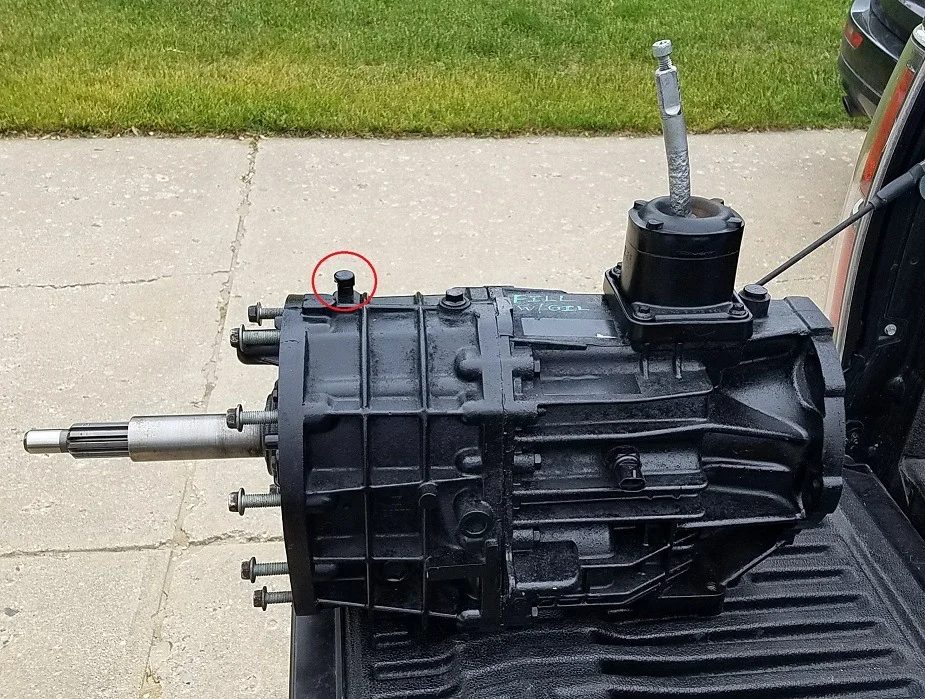

In all my year wheeling in water (2006 through roughly 2010) I have yet to put a snorkel in my TJ.for starters make sure your Axles, Transmission and Transfer Case breather lines are good and make sure they are high as possible. In my case my 6speed manual trans NSG370 had no hose just a cap so needless to say it took plenty of baths until I learned about the breather cap :). The TJ factory air intake is very good based on the design. the intake hose gets the air from the top half of the airbox there are small holes at the bottom for drainage.

The deepest I have ever taken it has been just below the bottom of the headlight bezel
