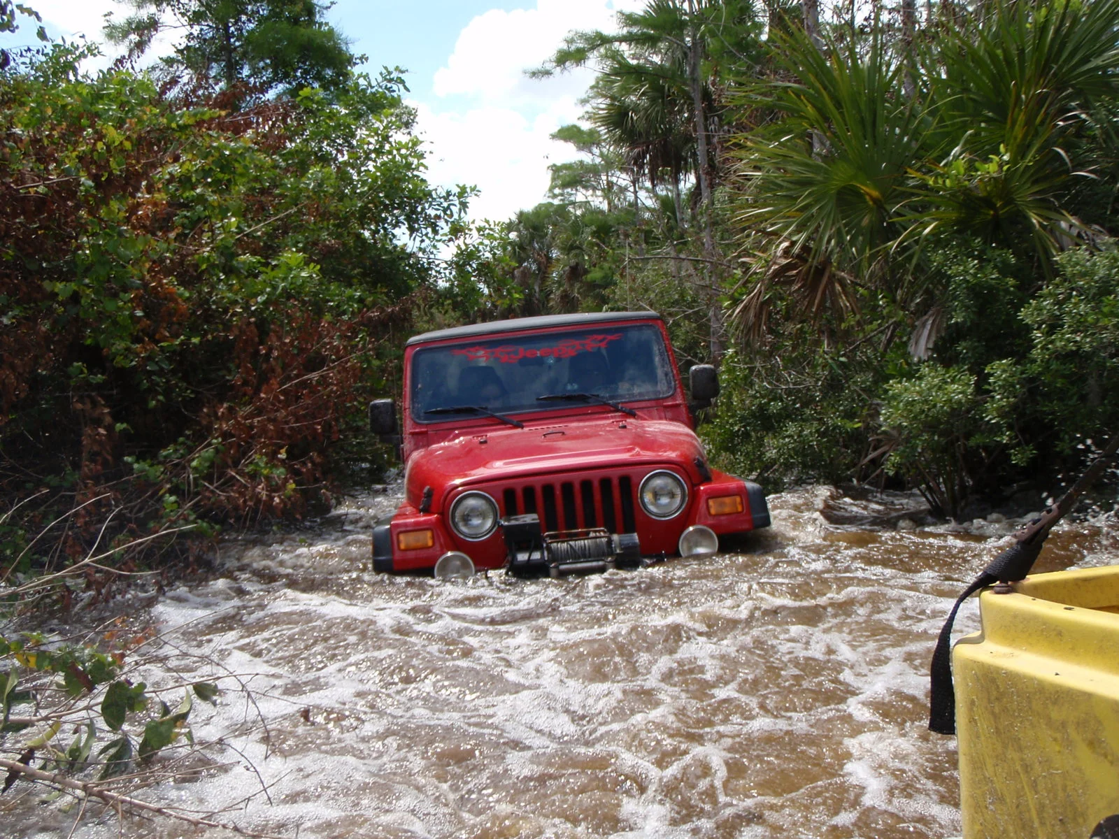

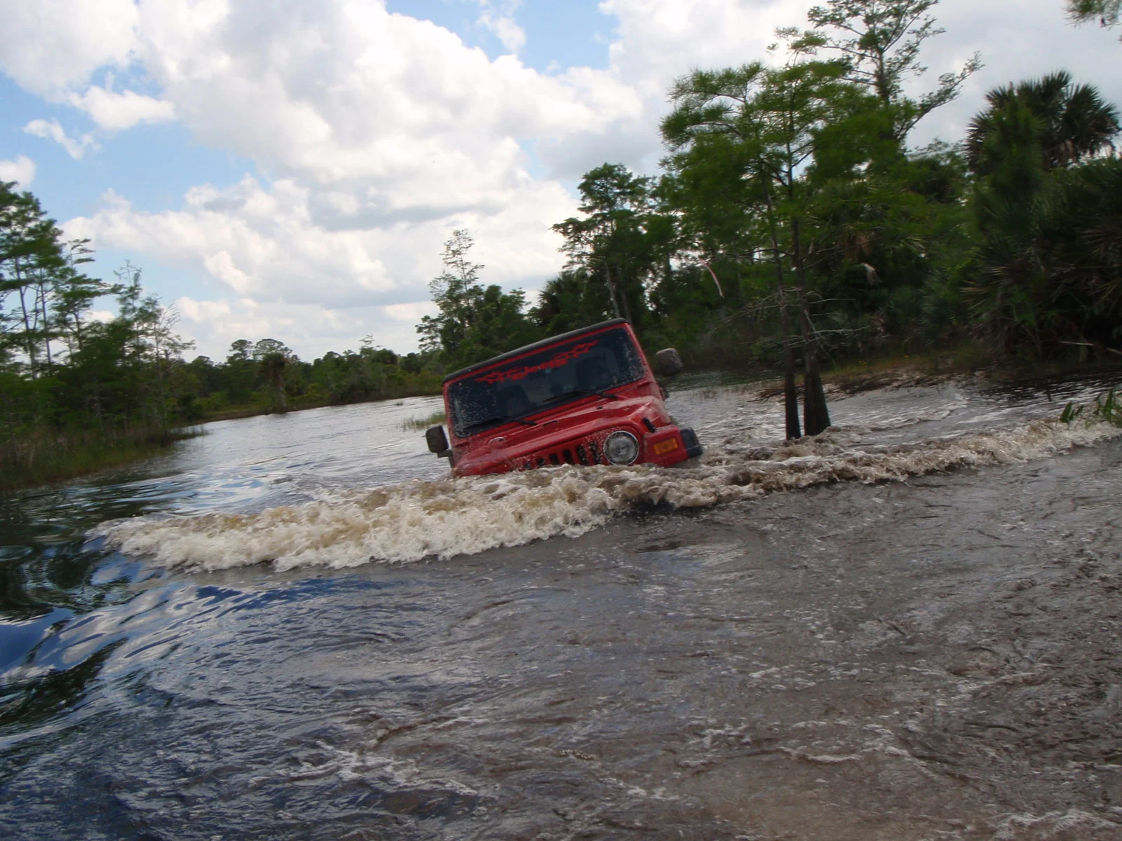

That last photo could easily be a photo of the month, well done!Many years of water wheeling. The water down here is stationary so no worries with risk of any raging rivers like you guys have up north
In all my year wheeling in water (2006 through roughly 2010) I have yet to put a snorkel in my TJ.for starters make sure your Axles, Transmission and Transfer Case breather lines are good and make sure they are high as possible. In my case my 6speed manual trans NSG370 had no hose just a cap so needless to say it took plenty of baths until I learned about the breather cap . The TJ factory air intake is very good based on the design. the intake hose gets the air from the top half of the airbox there are small holes at the bottom for drainage.
I have never had any issues with electrical connectors at all I did have to replace my starter twice and my AC compressor clutch also went. Never go fast into an area without knowing how deep it is. I have seen people sink their Jeeps because they are not careful. I basically crawl slowly in an unknown area until I know the depth then I can play fast also never wheel alone.

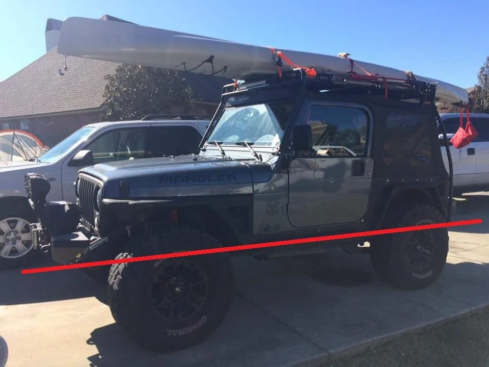

The deepest I have ever taken it has been just below the bottom of the headlight bezel

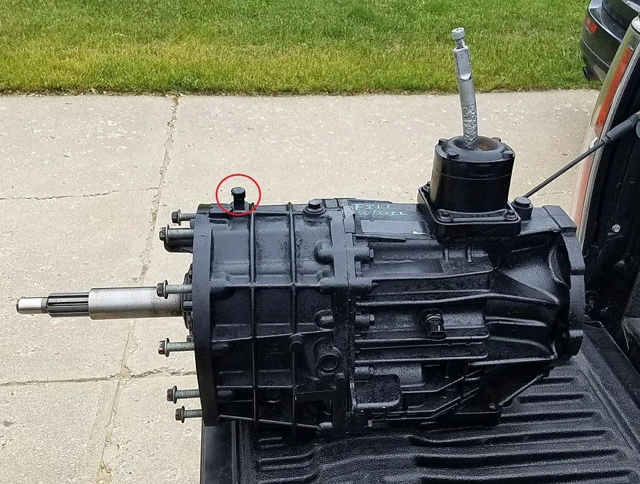

It is located there but there's a long rubber vent hose attached to it in our Jeeps to keep water out where the NV3550 and NSG370 transmissions are concerned. The top of its vent hose is positioned at the top of the firewall's center. There is no vent hose attached to the older AX-15 or AX-5 transmissions.Trying to remember, but I thought the vent on my nv3550 was just mounted to the top of the transmission. I found a picture...
No tube on mine...just a little cap. That picture is from when I had to pull my transmission to replace the input shaft.It is located there but there's a long rubber vent hose attached to it in our Jeeps to keep water out where the NV3550 and NSG370 transmissions are concerned. The top of its vent hose is positioned at the top of the firewall's center. There is no vent hose attached to the older AX-15 or AX-5 transmissions.

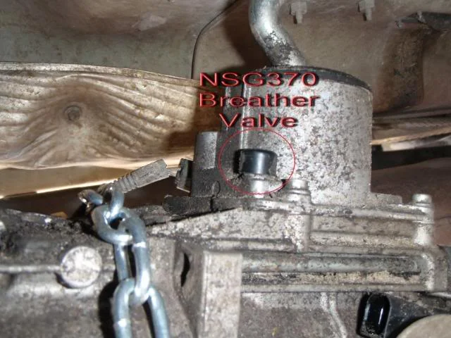

I'll be darned, I thought the NV3550 had a vent hose on it. I learn something every day, thanks!Here is a pic of the NSG370 vent cap. I ran into it when I was replacing my clutch.
