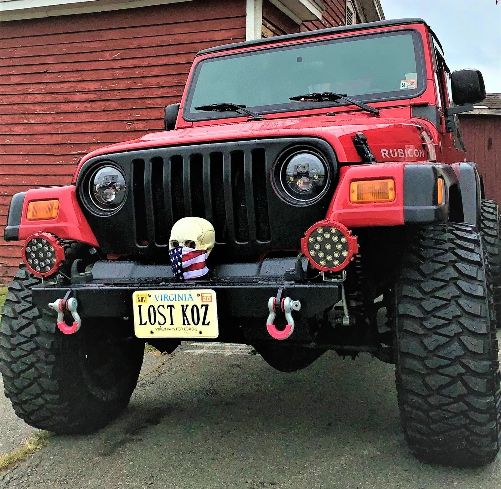

Those wheels shouldn't rub if the backspacing is correct. I have 15"x10" wheels on mine.
