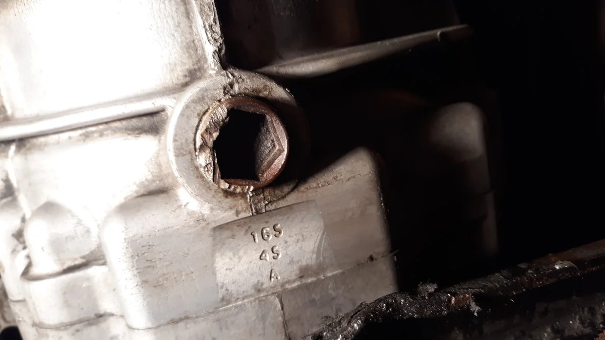

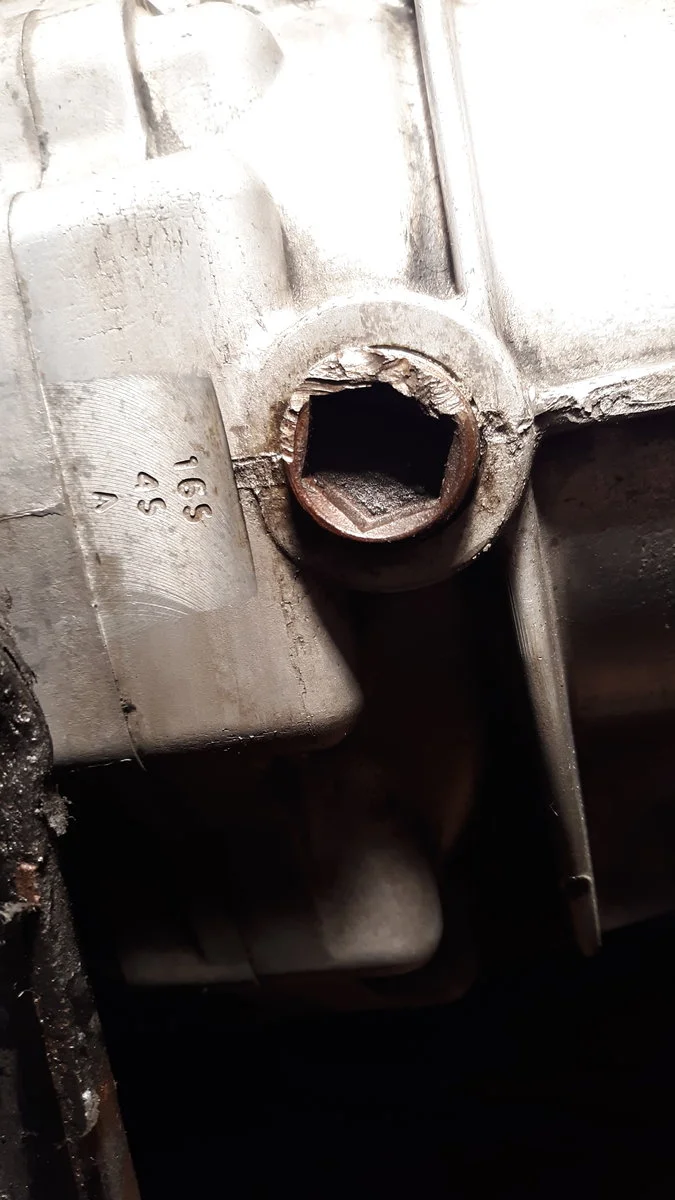

While I was under the jeep I've noticed this :( , see attached picture, it's the drain plug. What do you guys think? I definitely want to change that. Couldn't really find an replacement one online yet, I'll try to go to the actual auto parts store. Want to get the plug first before mowing on.
Before you pull the drain plug, make sure you can remove the fill plug.
Sucks to drain the fluid to find out you can't fill it back up. Goes for all fluids that have both a drain and fill plug.
I know that. Just the drain plug looks it has been scraped off a little bit. Hopefully I'll be able to unscrew that.

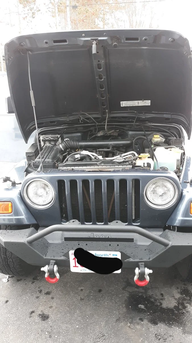

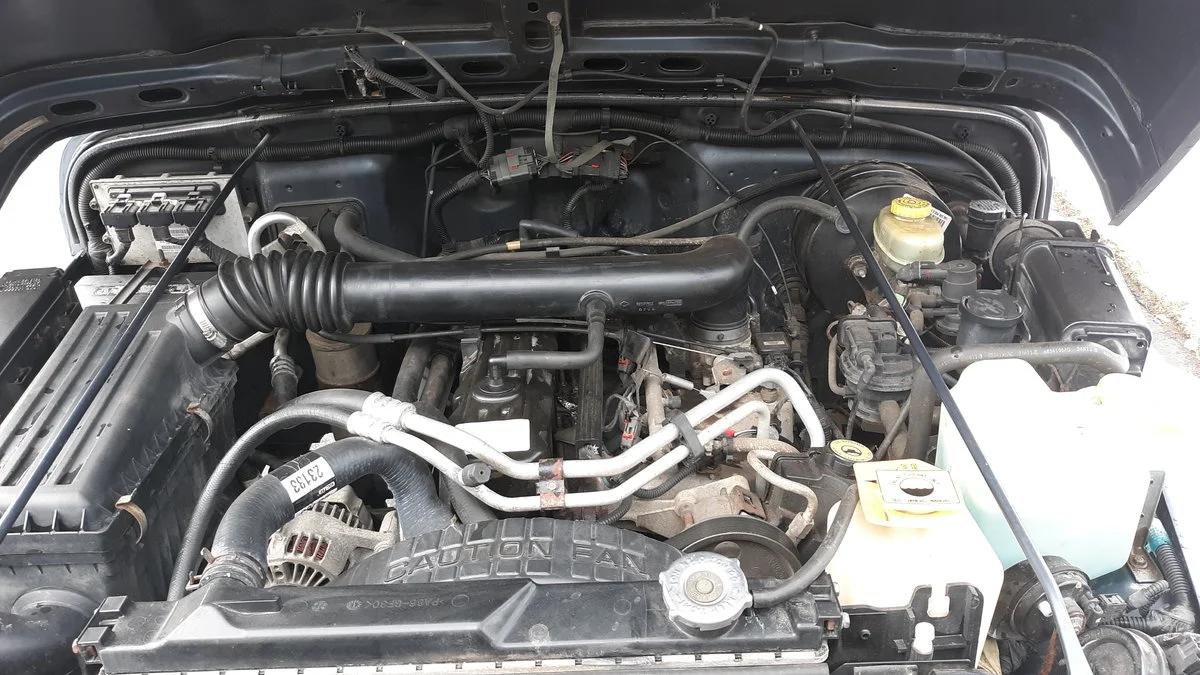

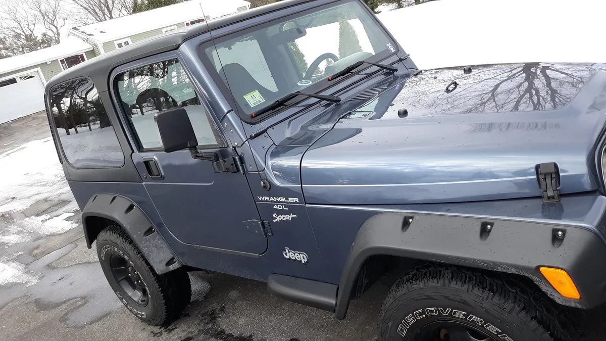

Looks incredibly good !! AllI can suggest is checking all the driveline components. U-joints, knuckels, brakes, calipers. Looks like you found a rare great buy.

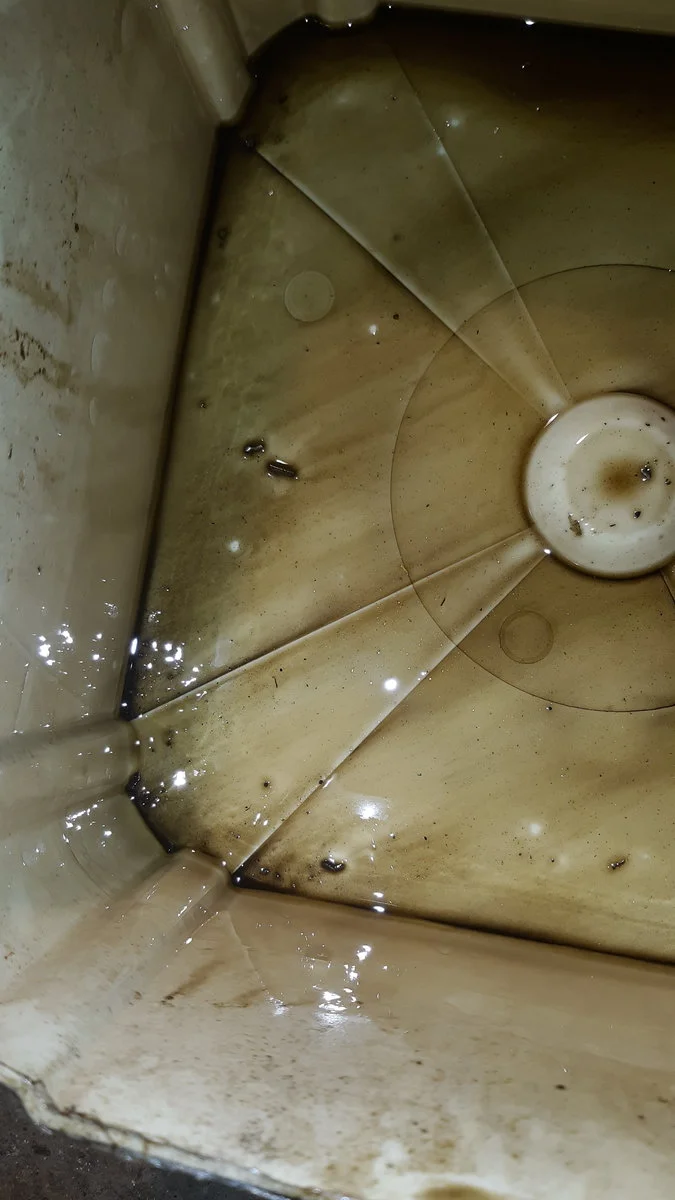

Adding some pictures.. I guess it was much needed to change out the oil...
Transfer case oil.....

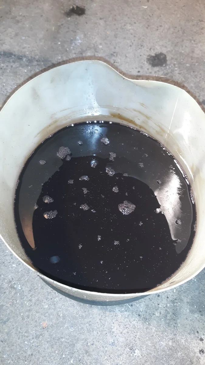

Transmission oil and drain plug
On the diff, I’m a fan of lube lockers versus messing with RTV. Some people dislike them but I’ve used them for a long time without issue.
