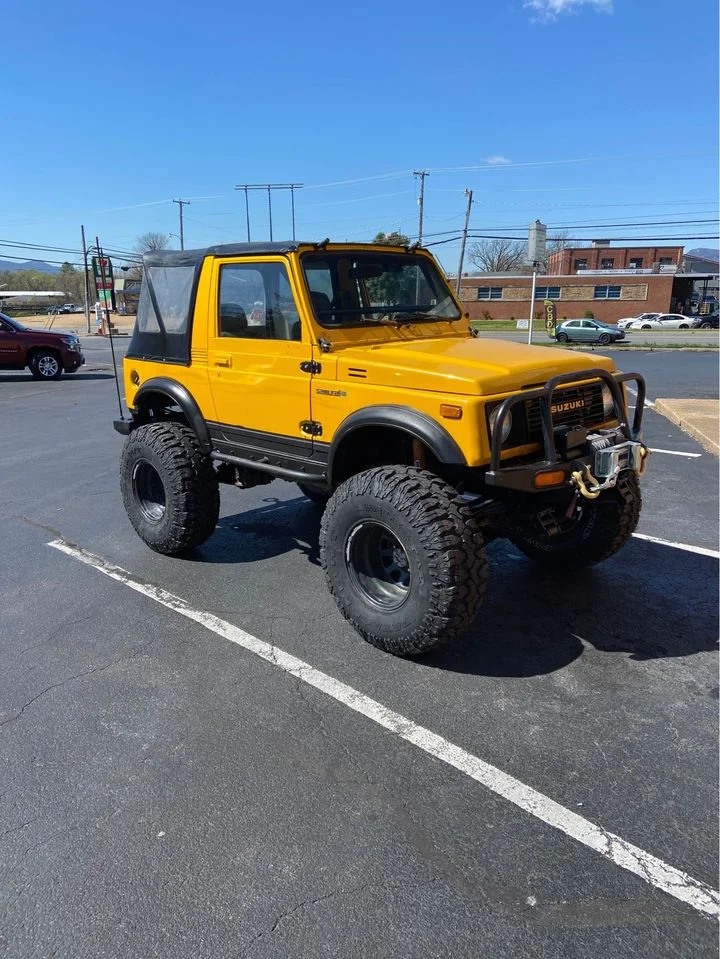

And it always will be, unless you consider this to be an SUV. :unsure:
p.s. I almost bought it recently for $3500, but the owner was an asshole. Even worse than me.
