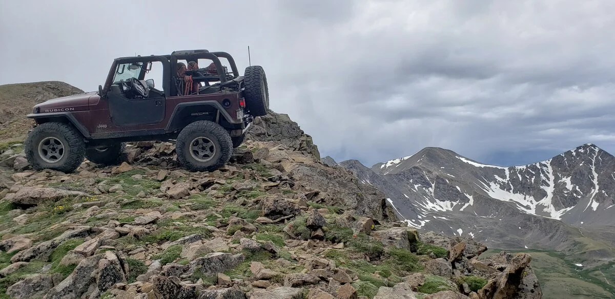

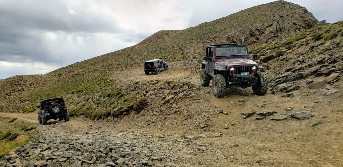

Colorado guy here. 3k rpm at 75mph is a nice place to be. Gear to get that. Commit to a tire size and build for it.
33s will get you most places out here. 35s will take you to most of the rest. Don't do anything until you get out, explore and figure out what you really want.
Stock could have easily been with us earlier today at 13,000ft.
