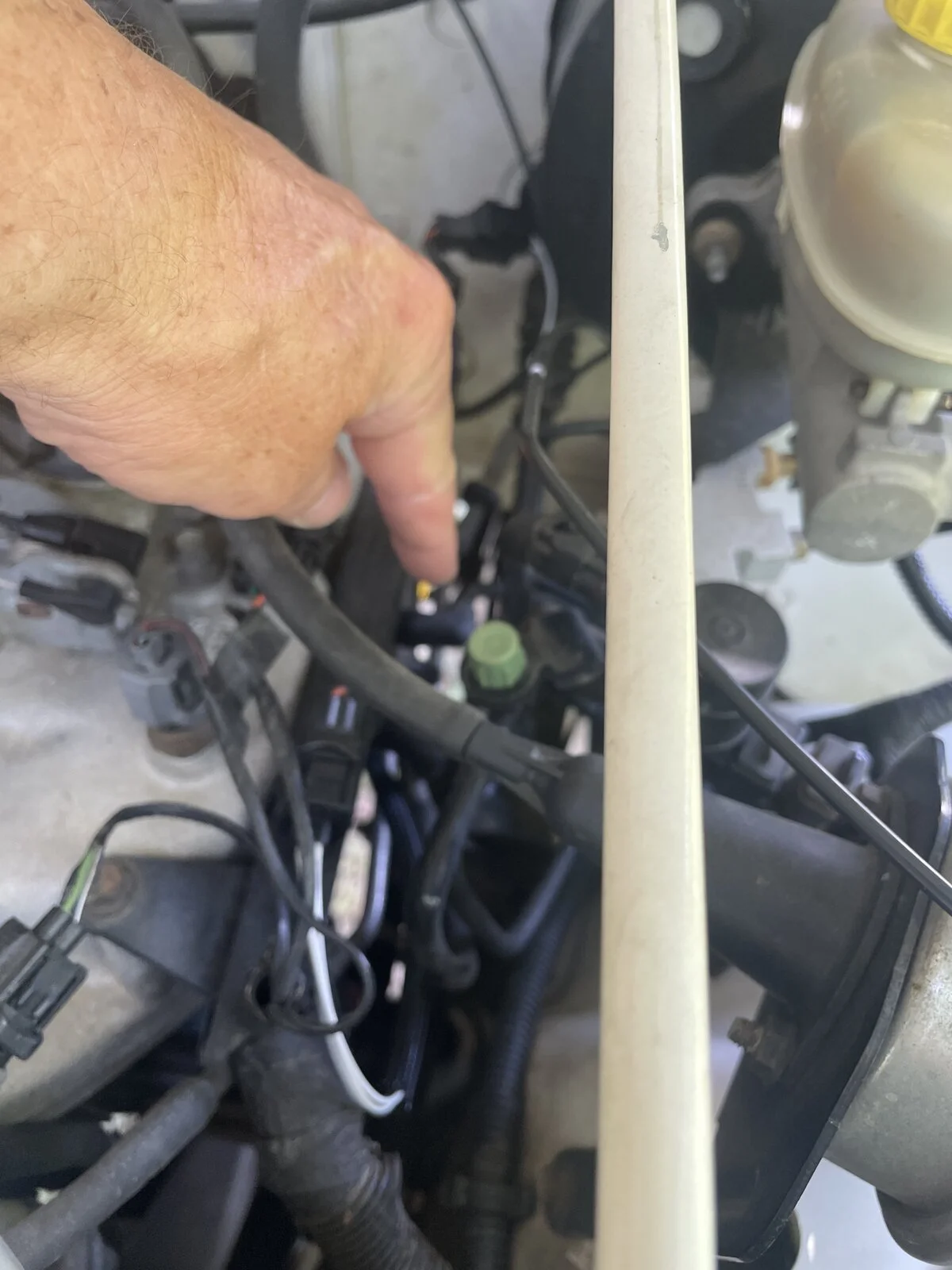

Look down at your intake manifold you’re going to see two L-shaped vacuum fittings- see if they are cracked, especially at the bottom.
Be careful with your other vacuum lines as they become brittle due to heat as you work.
O Reillys has a dorman that fits right on it.

Would you be able to post a picture of where those are exactly?
2 are about 1/4” and one o
Is smaller- the line into it gets like spaghetti.
Reactions: ColoJeep
It's the real blurry thing under the finger , next to the perfectly in focus core support rod.....:p
We want to be helpful but we don’t want to actually do the job 😀😝😝

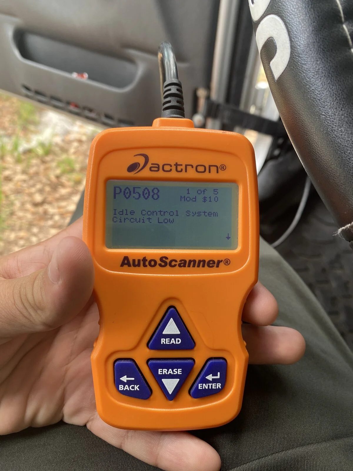

Not sure that this is a problem, but definitely doesn’t seem right. Could be worn out
