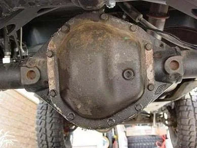

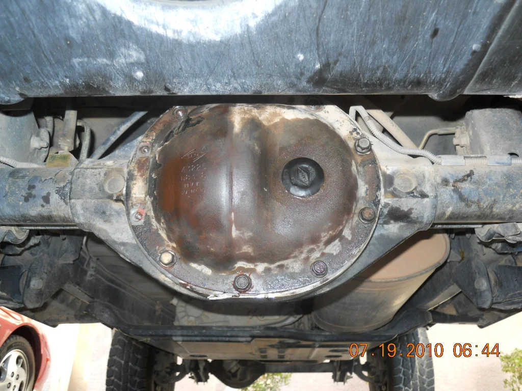

They're fine in the front when you're in 2wd on the street but don't put a lunchbox locker in the rear where they are very poorly behaved. And find out what rear axle you have as if it's the standard Dana 35 it's not strong enough for a locker. The optional factory-installed Dana 44 rear axle is strong enough for a locker.
If your rear axle's differential cover is oval-shaped and has a black plastic snap-in lubricant hole fill plug it's a Dana 35. If it's more apple-shaped and has a threaded steel plug in its lube fill hole it's the stronger/more desirable Dana 44.

Dana 35
Dana 44
