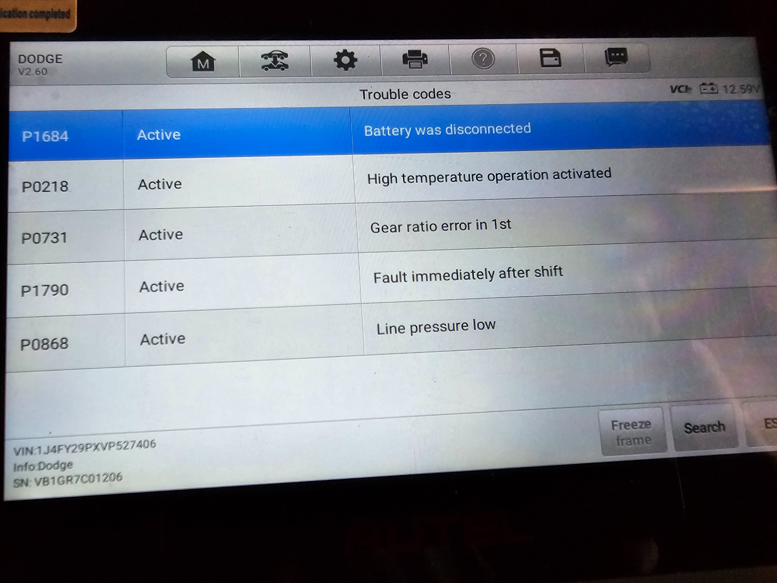

Here's what AI says about my symptoms:
If your 545RFE transmission is overheating in 5th gear but cooling down in 2nd, this points to a specific issue with the cooling system or fluid pressure regulation within the transmission at higher gears.
Here's a breakdown of potential causes and what to investigate:
Potential causes
  • Fluid Level and Condition: Low or degraded transmission fluid is a common cause of overheating. The fluid helps cool and lubricate the transmission's internal components. In higher gears like 5th, the transmission works harder and can generate more heat, making low or poor-quality fluid more problematic.
  • Transmission Cooler Issues:
    • Blocked Cooler: The transmission cooler is responsible for dissipating heat from the fluid. A clogged cooler can restrict fluid flow and hinder cooling, leading to overheating, particularly during extended use or at higher speeds/gears.
    • Faulty Cooler or Lines: Leaks in the cooler or its lines can cause fluid loss, leading to overheating. A damaged cooler itself may not efficiently transfer heat.
  • Pressure Regulator Valve/Low Cooler Flow: The pressure regulator valve in the 545RFE can cause low cooler flow, especially at idle or lower speeds, leading to overheating and torque converter-related complaints.
  • Clutch Slippage: In 5th gear, if the overdrive clutch is slipping, it can generate excessive heat and cause overheating.
  • Heavy Loads/Driving Conditions: Driving in hot weather, carrying heavy loads, or towing can strain the transmission and increase its operating temperature, especially in higher gears.
  • Electrical Issues: Problems with the Transmission Control Module (TCM), sensors, or wiring can affect the transmission's shifting patterns and cooling system operation, potentially leading to overheating.
Troubleshooting steps
  1. Check Transmission Fluid:
    • Check the fluid level according to the owner's manual's procedure, ideally when the transmission is warm and the vehicle is level.
    • Inspect the fluid for color and smell. Healthy fluid should be red and clear; burnt-smelling or dark fluid needs to be changed.
  2. Inspect Cooler and Lines:
    • Look for leaks around the transmission cooler and lines.
    • Ensure the cooler is free of debris that could be obstructing airflow. Consider flushing the cooler if it appears dirty or if flow is suspected to be restricted.
  3. Scan for Trouble Codes: A diagnostic scan tool can help identify transmission-related trouble codes, which could pinpoint sensor, solenoid, or electrical issues affecting the cooling system.
  4. Professional Diagnosis: Due to the complexity of transmission systems, especially with symptoms specific to higher gears, it's highly recommended to consult a qualified transmission specialist. They can diagnose specific issues with the pressure regulator valve, clutch packs, sensors, or other internal components that might be causing overheating in 5th gear and affecting the cooling in 2nd.
By systematically addressing these potential causes, you can likely identify the source of the overheating issue and get your 545RFE transmission functioning properly across all gears. Remember to prioritize safety and avoid driving the vehicle if the transmission is actively overheating.
Now to add to all this.... When I was trying to install the new tune from FRP right before I'd gone on the run I was having issues getting the computer to connect to the TCM. So that points me to look at one other thing also. And the Check Engine light had come on but I'd guessed it was related to the transmission overheating. I'll pull the DTC later.

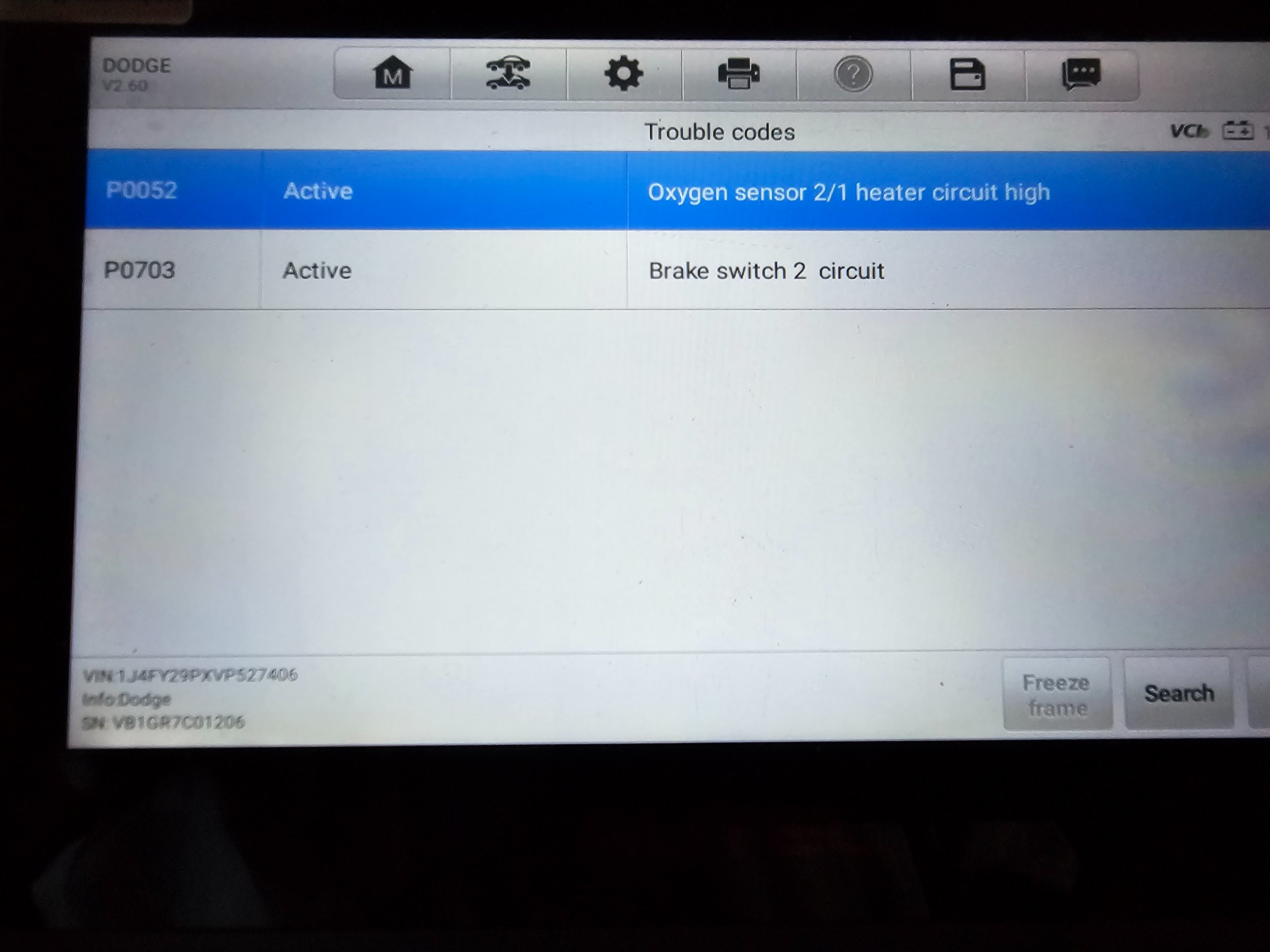

OK here's what my code scanner says..
TCM
PCM
Then Live Data from PCM, You can see the 2/1 O2 sensor voltage is higher than what it's looking for. So I'll be checking wiring first and then if that's not it swap out the sensor.
Figure I'll start with the easy stuff tomorrow...
1) Drain the ATF...
2) Drop the valve body out. I'm just going to have a look at things to see if I can see anything wrong.
3) Check wiring in the 2/1 O2 sensor. This is the first time I've had an issue with the O2 sensors reading wrong
4) Disconnect cooler lines and check each one with air to find out if it's clogged somewhere.
5) If none are clogged then check the radiator cooler & then each aux cooler with air for flow
