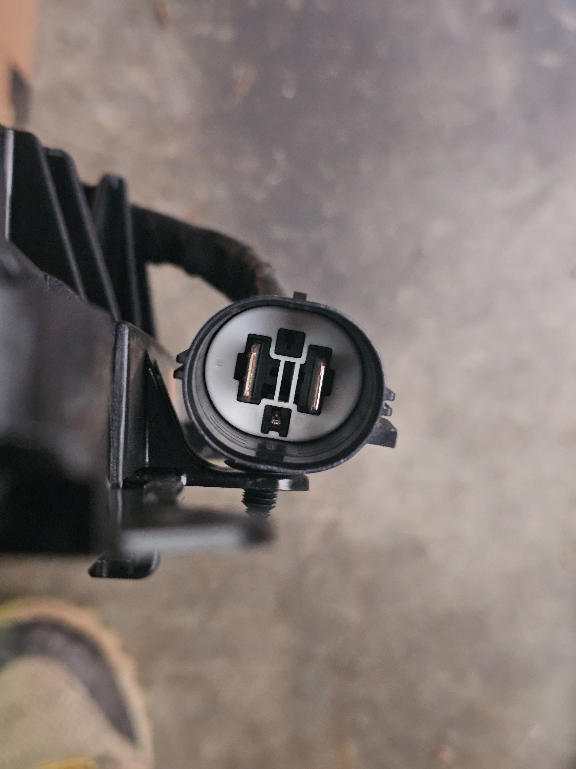

You'll have to refresh my memory here.... This was a custom harness or is it a GM based harness for your LS?
It’s a GM harness setup for the specific engine, trans and computer. All GM, all plug n play. Not integrating with tj dash or computer, it’s all going away.
OK... I'll get you a picture tomorrow. Even if it's the wrong plug with that kit off Amazon it'd be an easy fix.
Read that article on brushless fans as it explains a lot about how they operate. Positive and negative wires are hooked up ONLY ONE WAY. It's not like a brushed fan where you can swap the leads and make it run the other direction. And then you have to apply a signal to one of the smaller terminals to make the fan come on. If your PCM has a fan control function you're good but if not then you need a brushless PWM or a specific type of thermostat like the one made by SPAL. As talked about in that thread the Camero fan is reversed from the aftermarket fans in how they react to the signal.

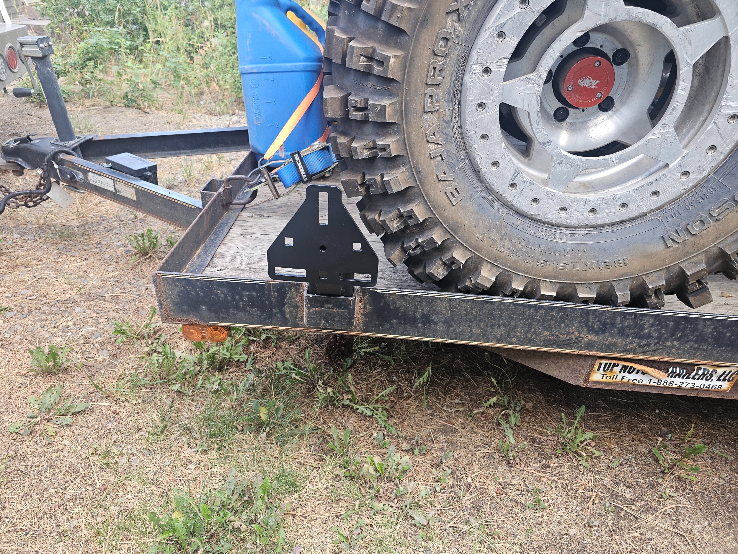

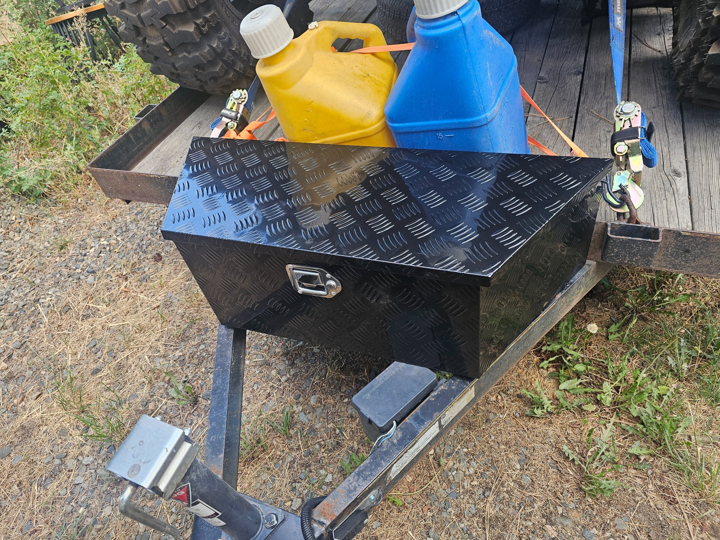

While I've been laid up I've been gathering a few parts for the trailer since I'm going to hopefully be using it more.
Yep I know I'll need to do a new a deck soon. Plan on it next spring at this point.
Ordered a storage box for the front. Been wanting one for a long time.
Will have to relocate the trailer battery box.

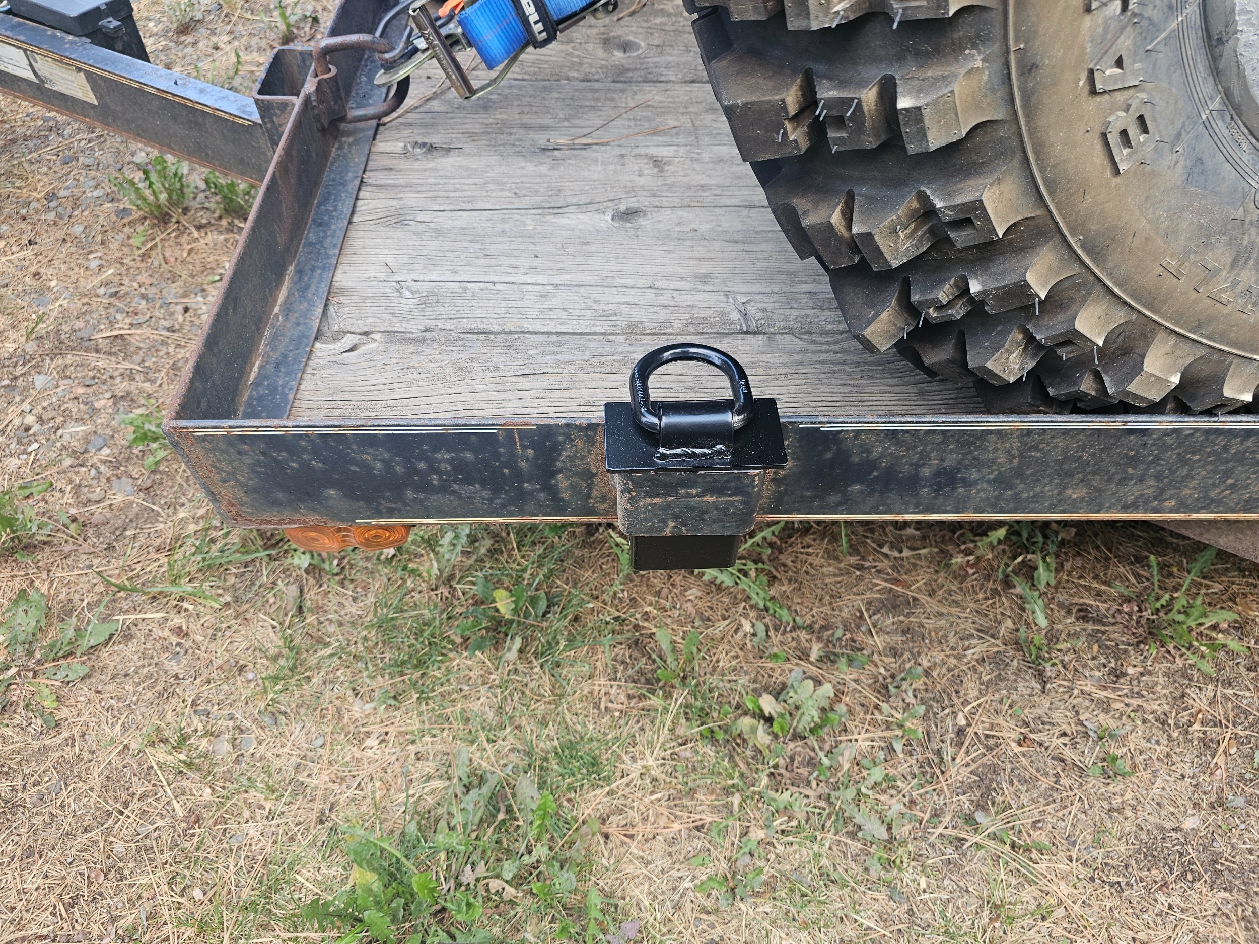

And some D-rings that fit into the stake pockets.

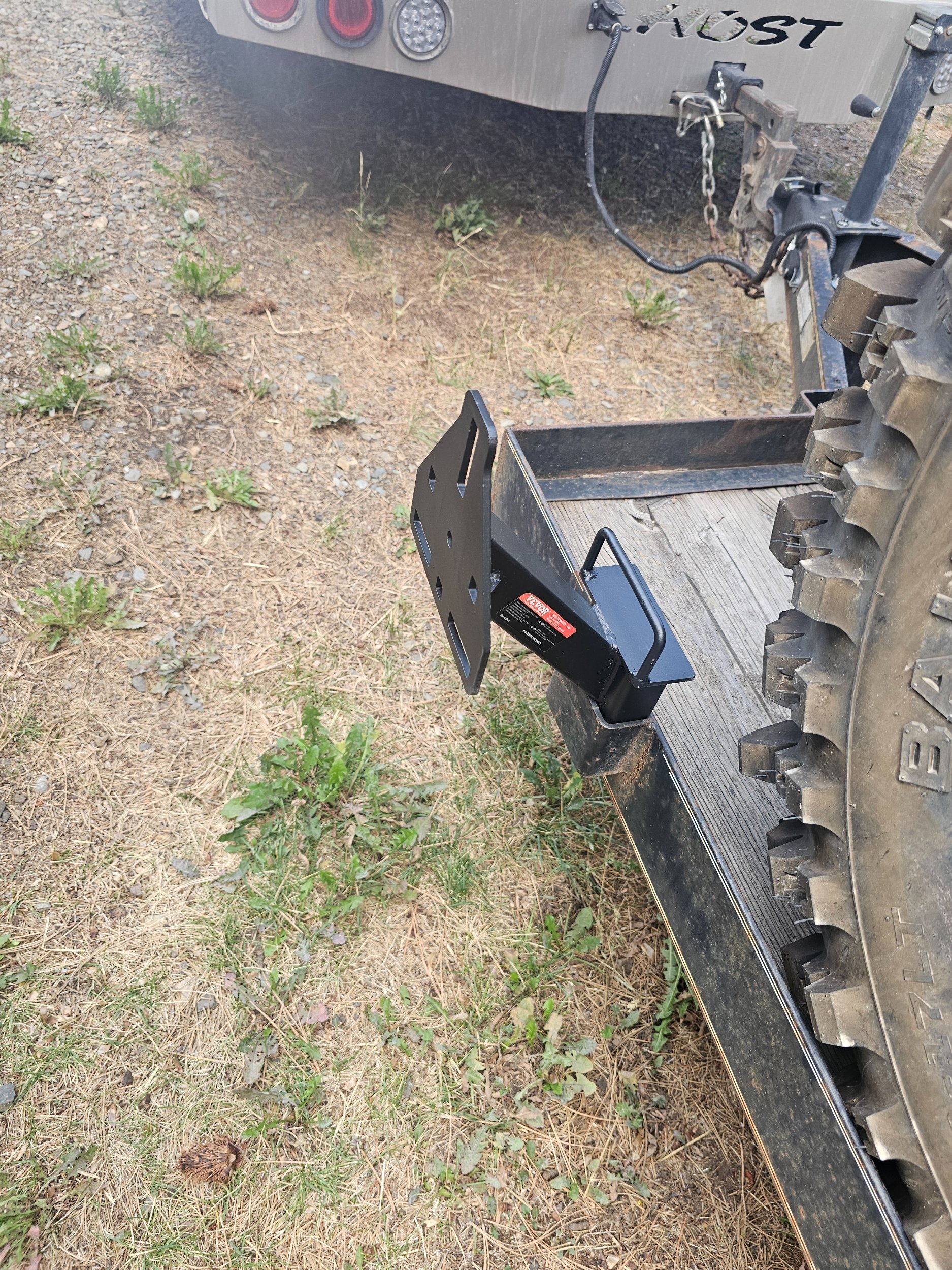

And a spare tire mount for the spare tire I'd finally bought that also fits into the stake pockets also.

Let's see if you can cram as much stuff in that box as @NashvilleTJ!! Will the spare stick out further than the trailer tires?

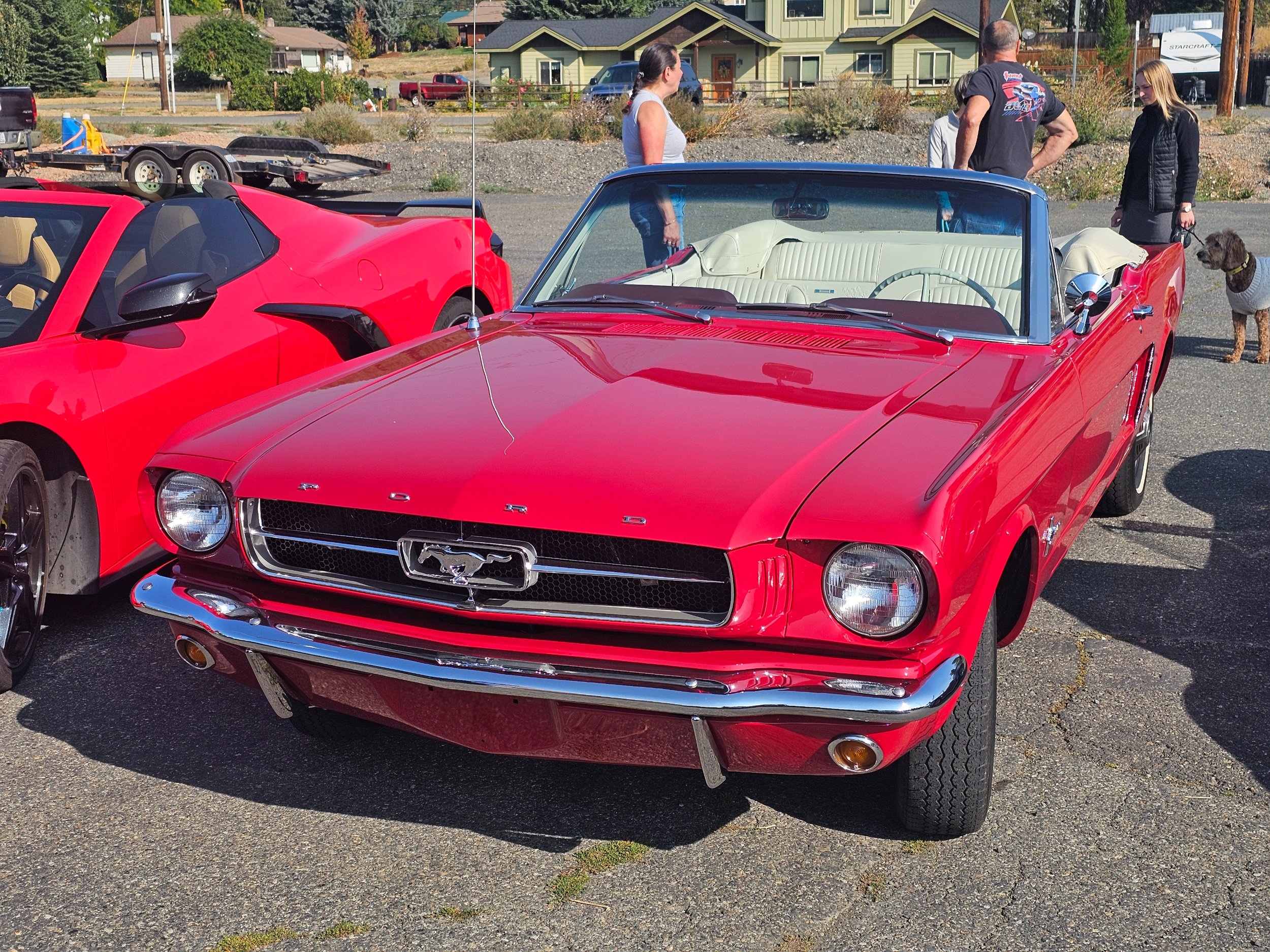

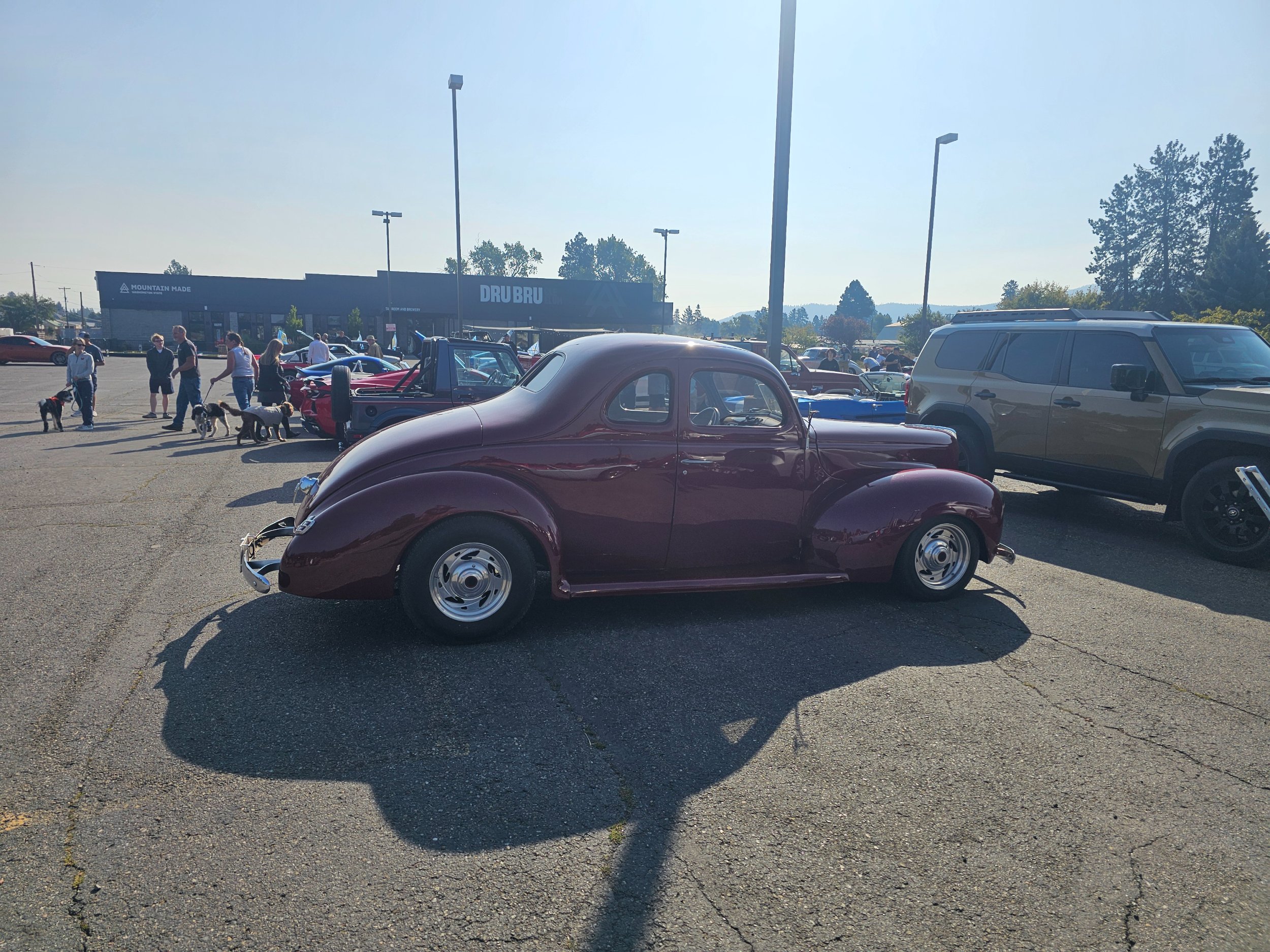

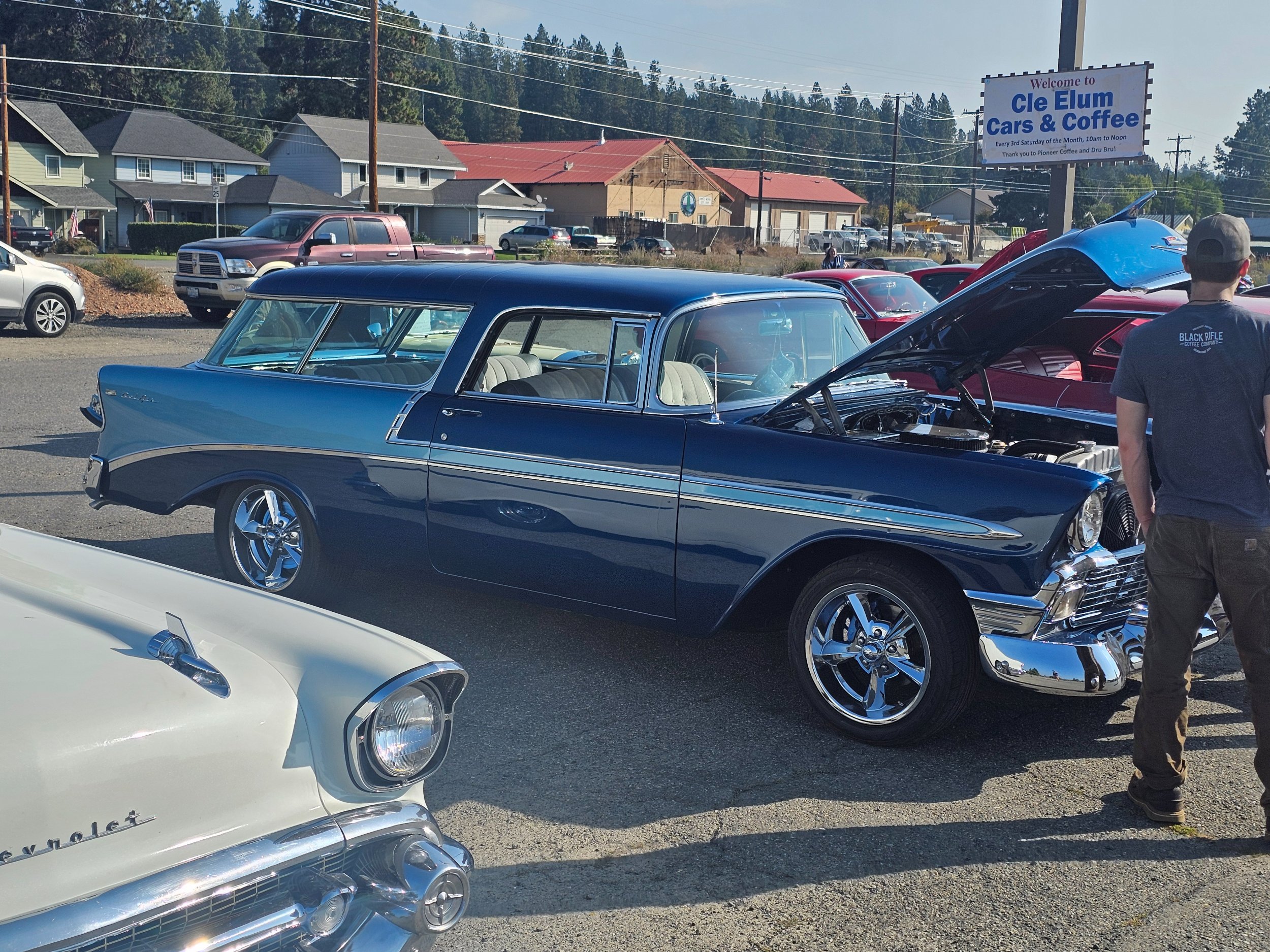

Well my leg is finally almost healed... So I'd decided to go to the local Cars & Coffee today.. Was a beautiful day out and there were about 30 vehicles there... My Jeep was still dirty from my trip to MT but Hey it's a Trail Rig so it's supposed to be dirty right?

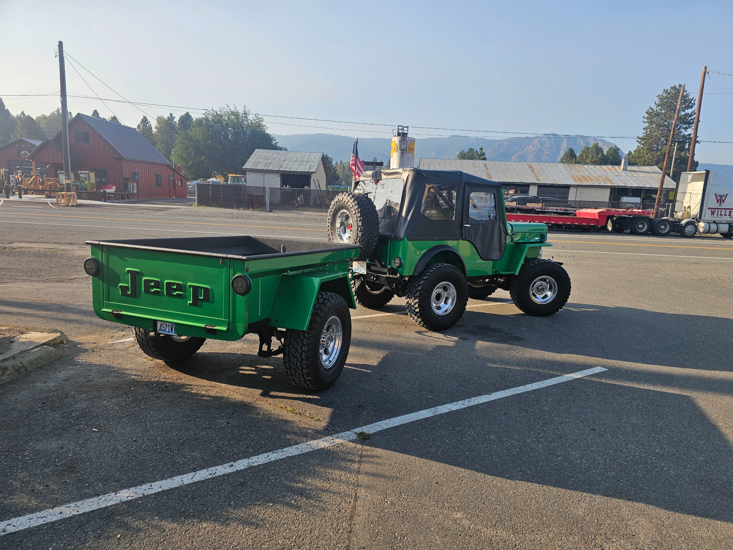

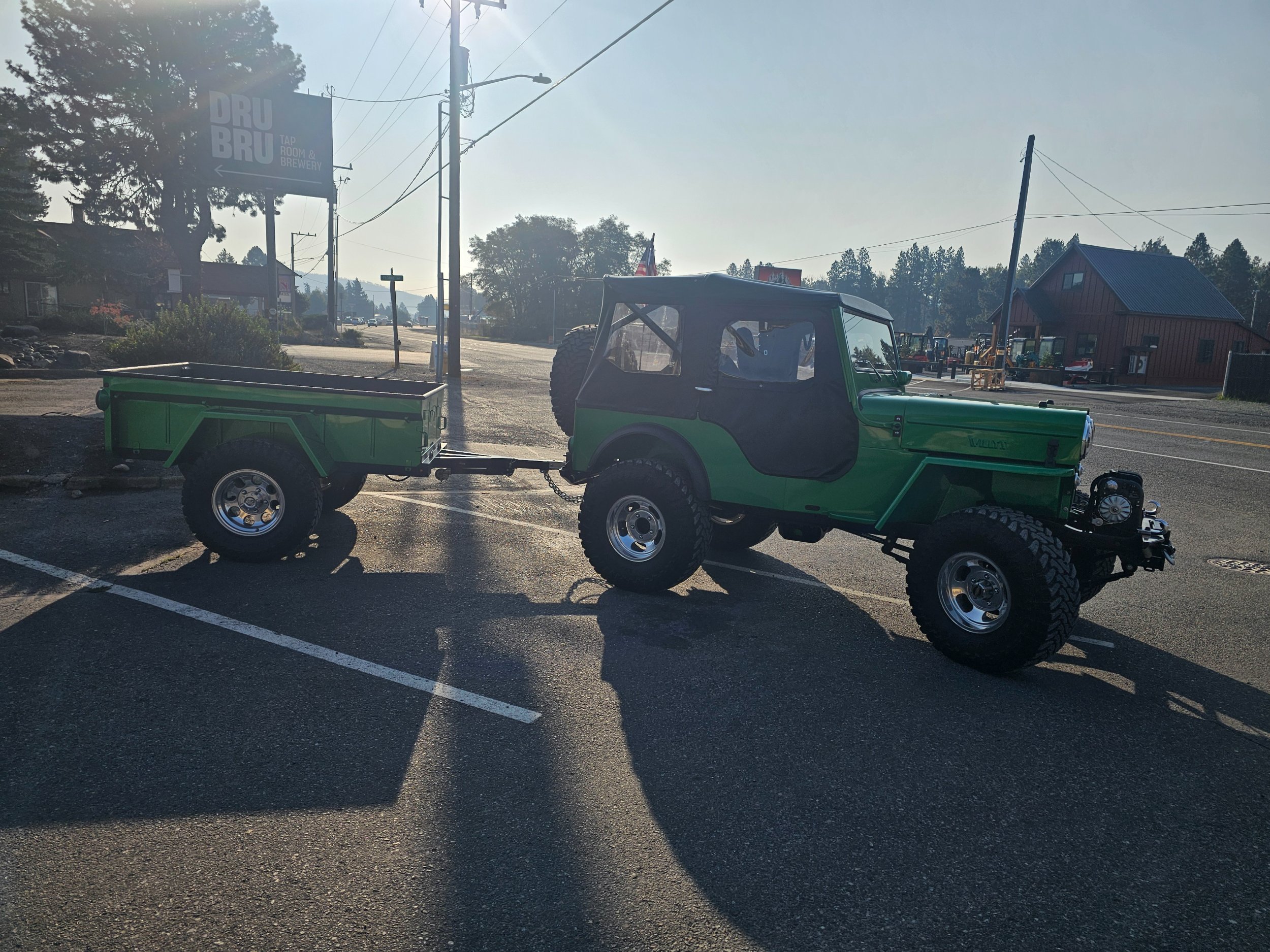

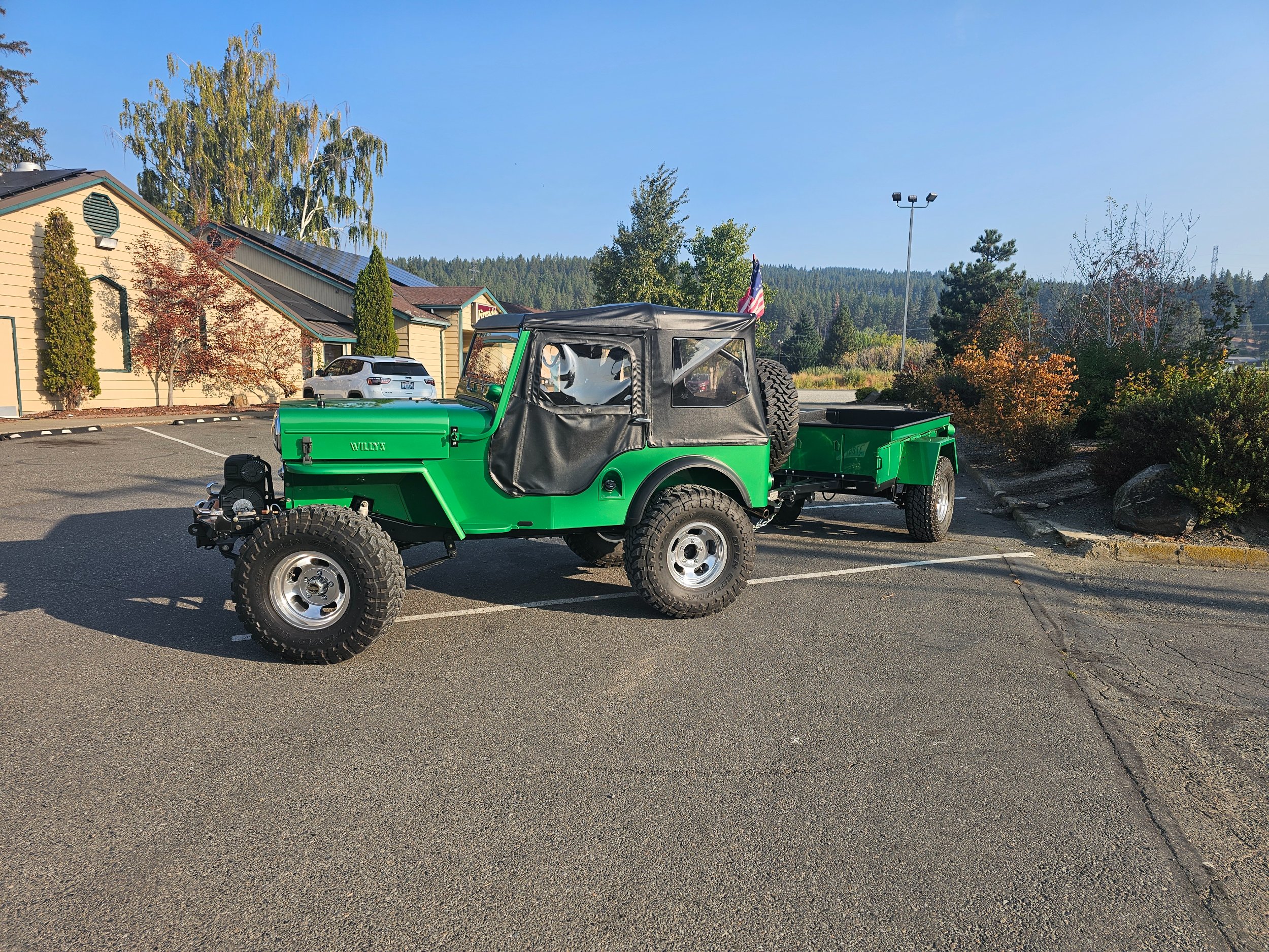

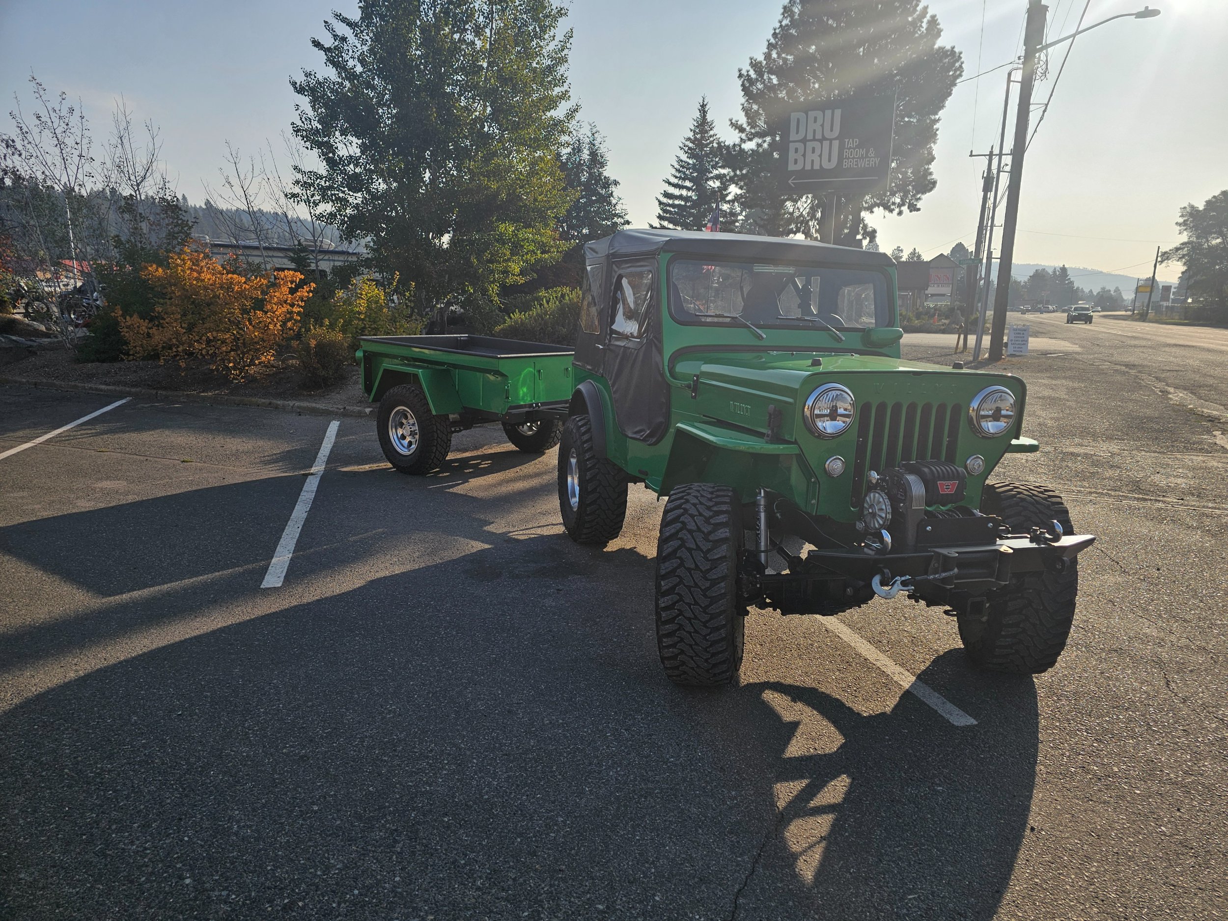

Stopped at the Cottage Cafe for breakfast with Karrlie before the event & she had to get to work too. But this beautiful CJ3B was parked out front when I pulled up.

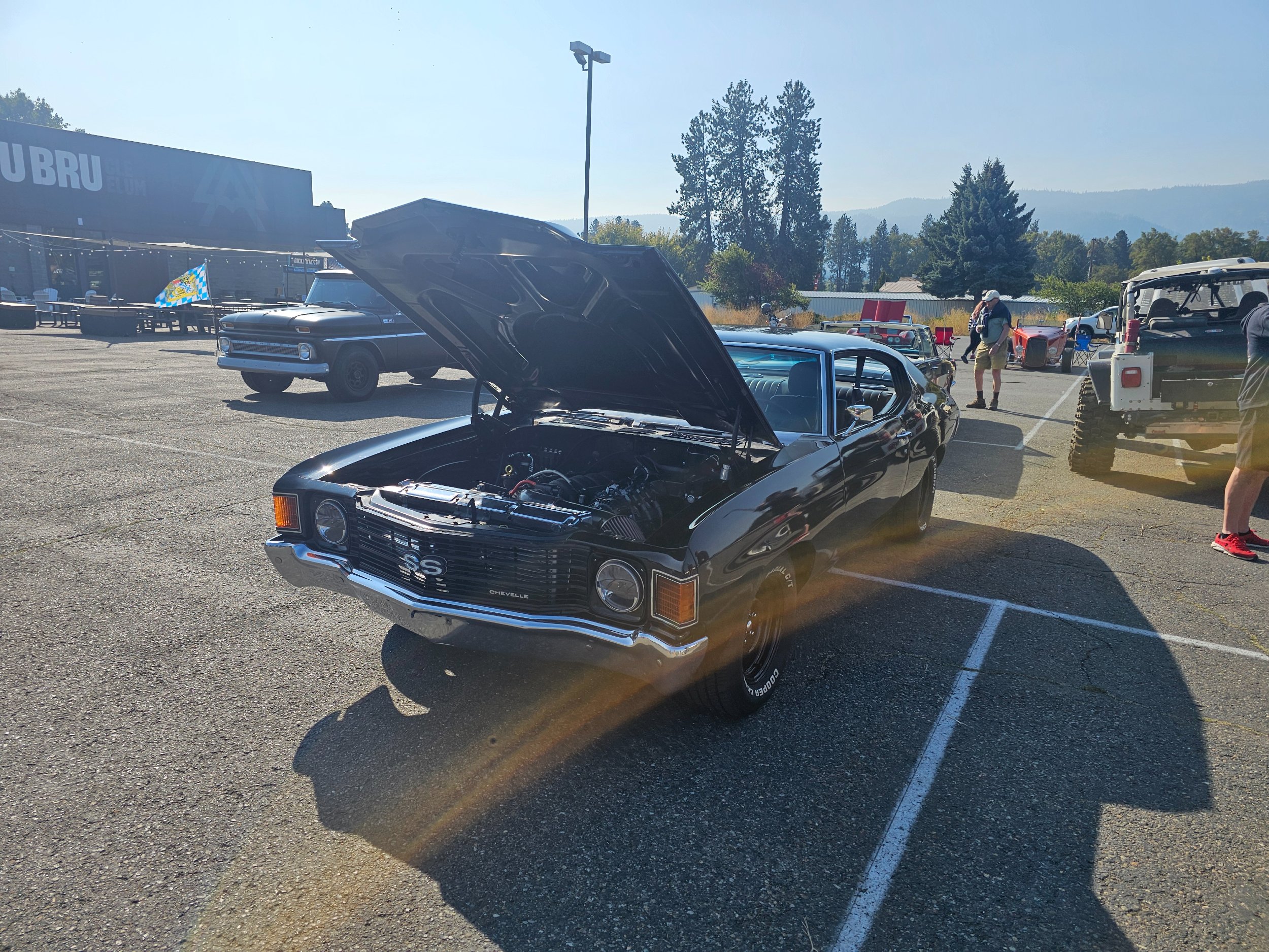

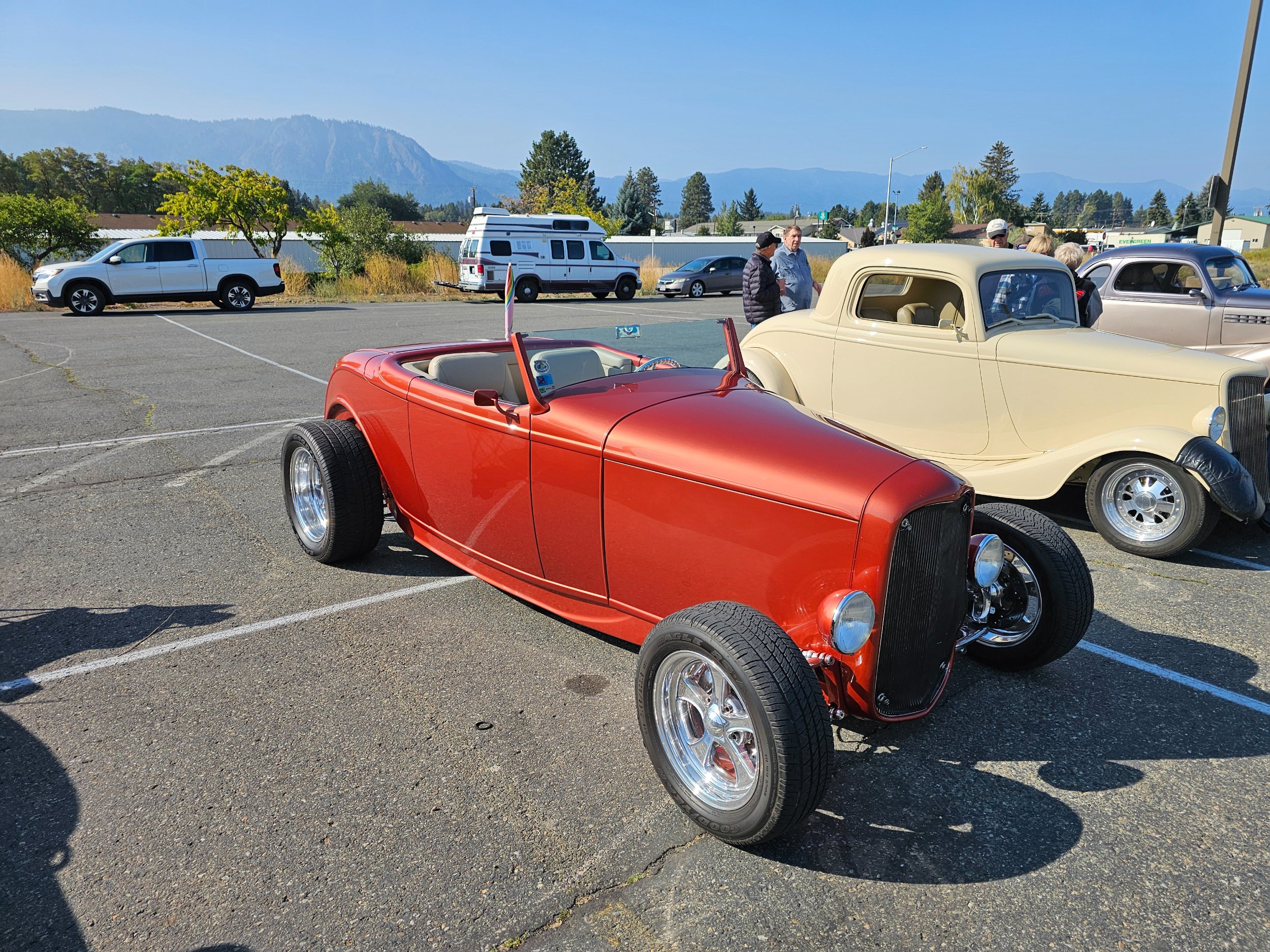

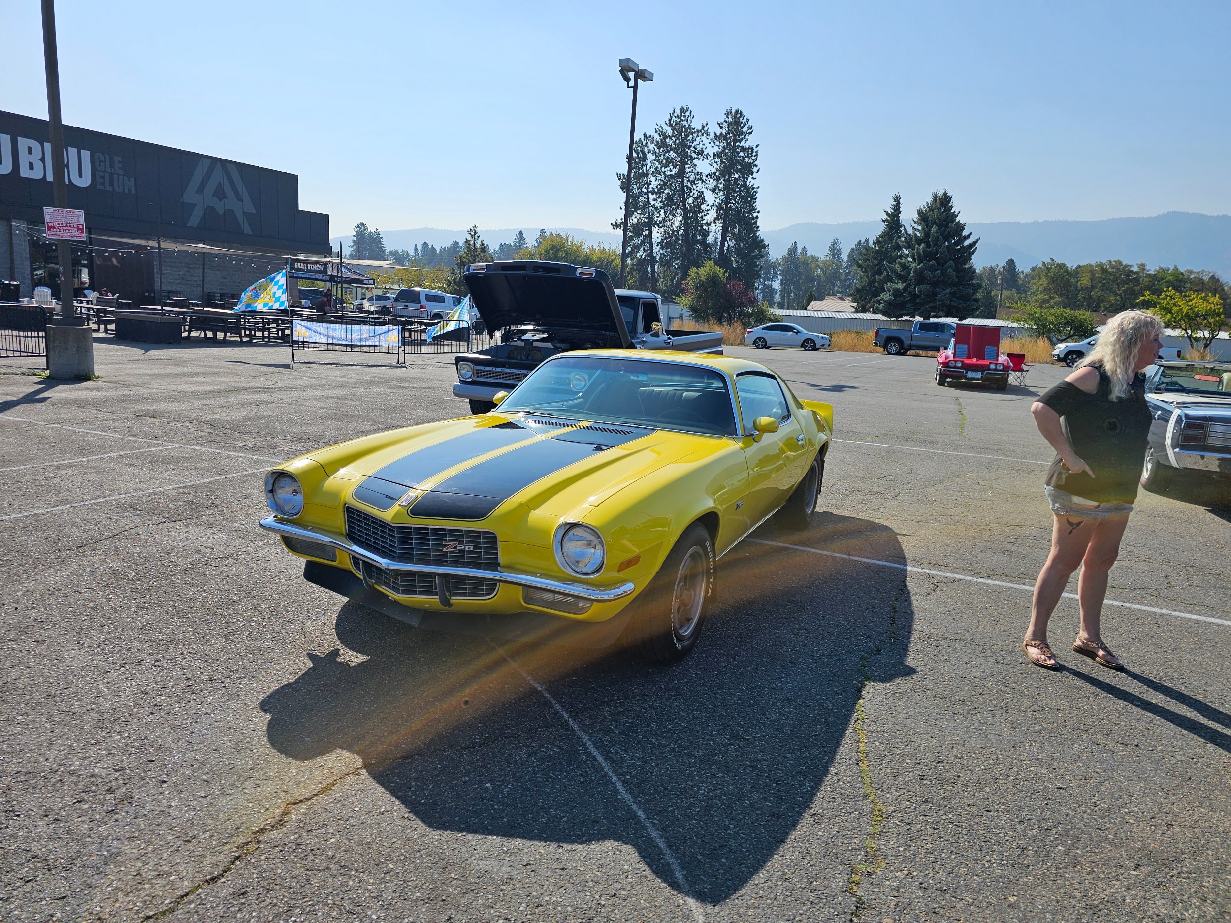

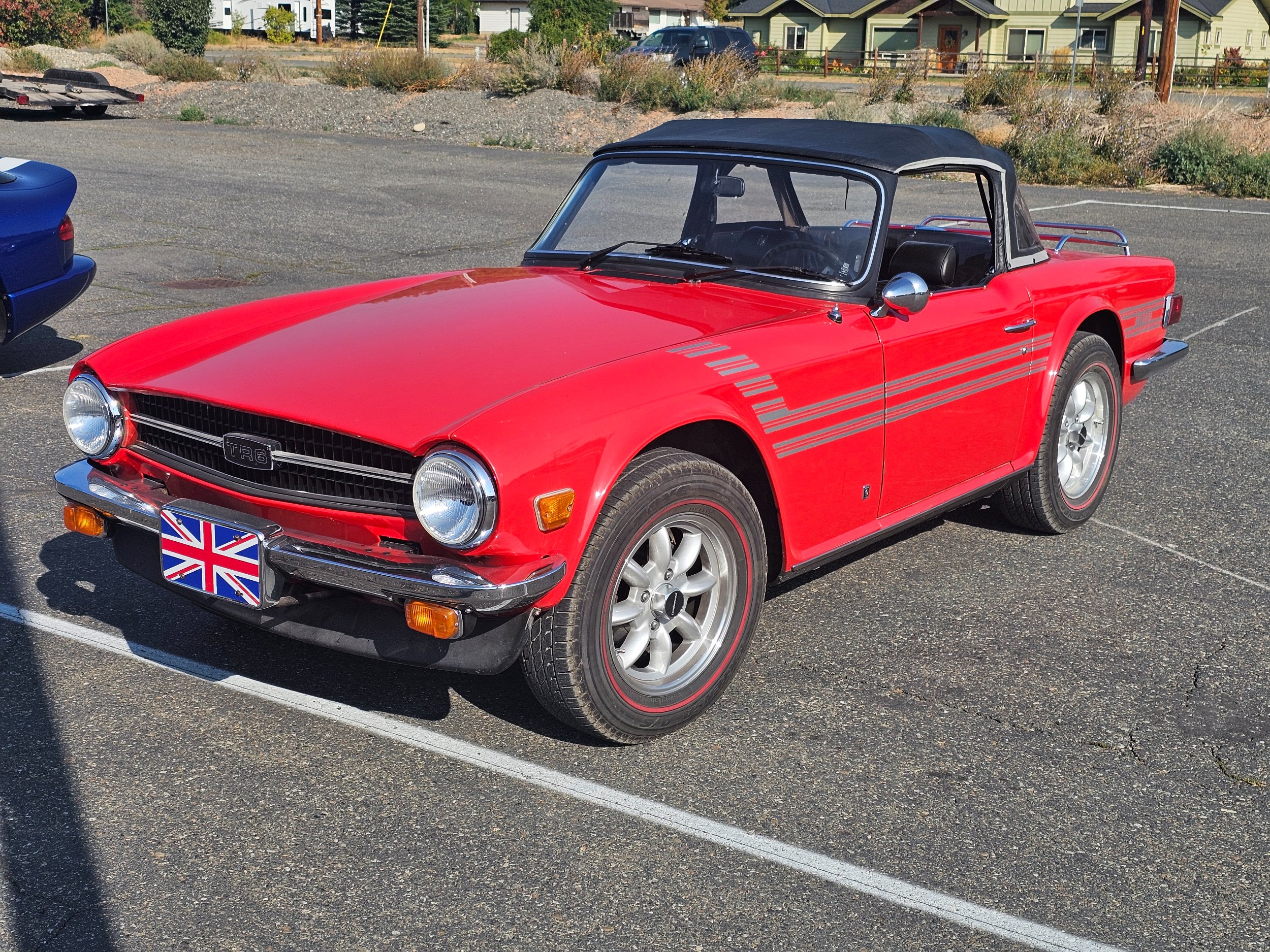

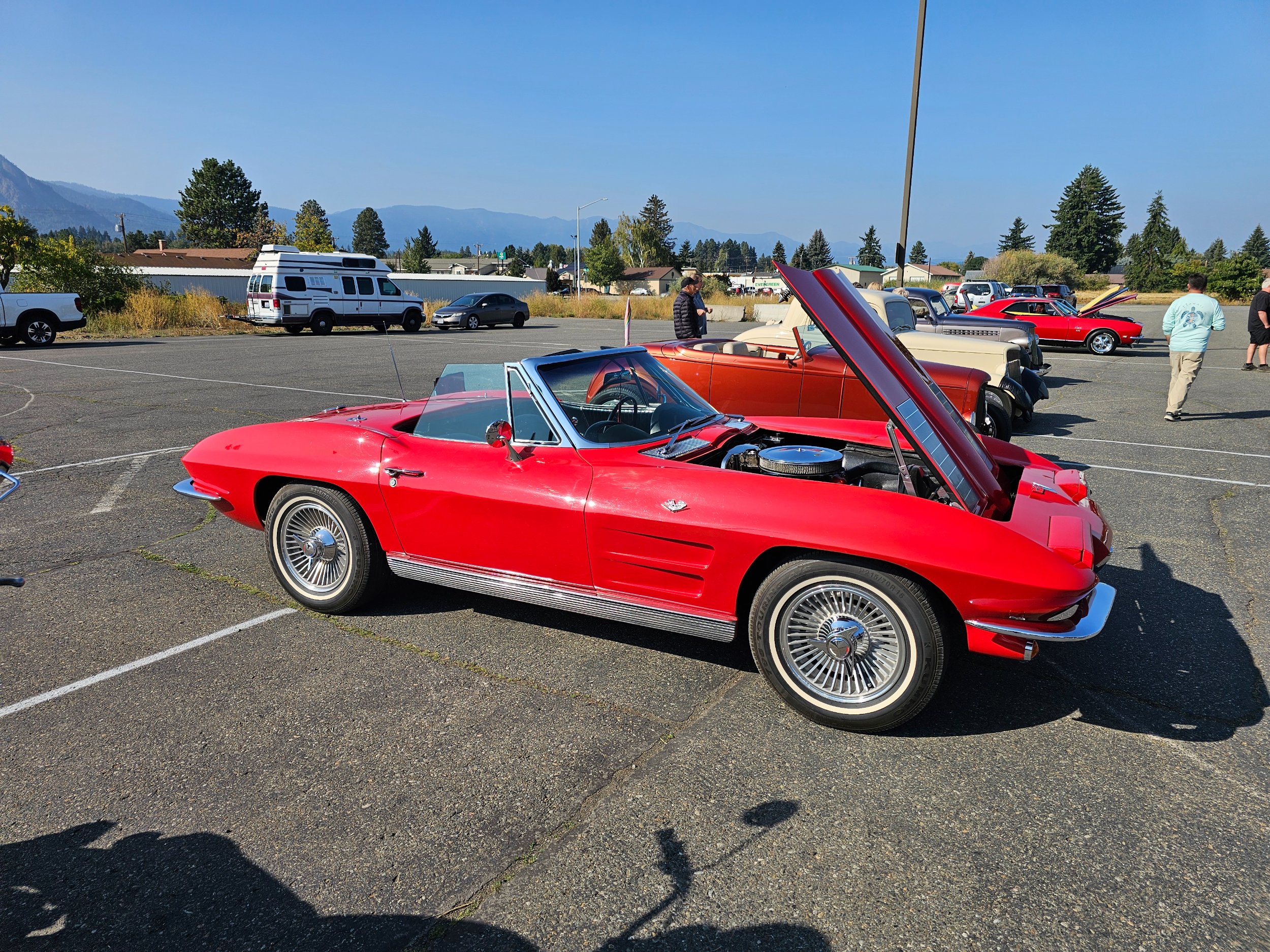

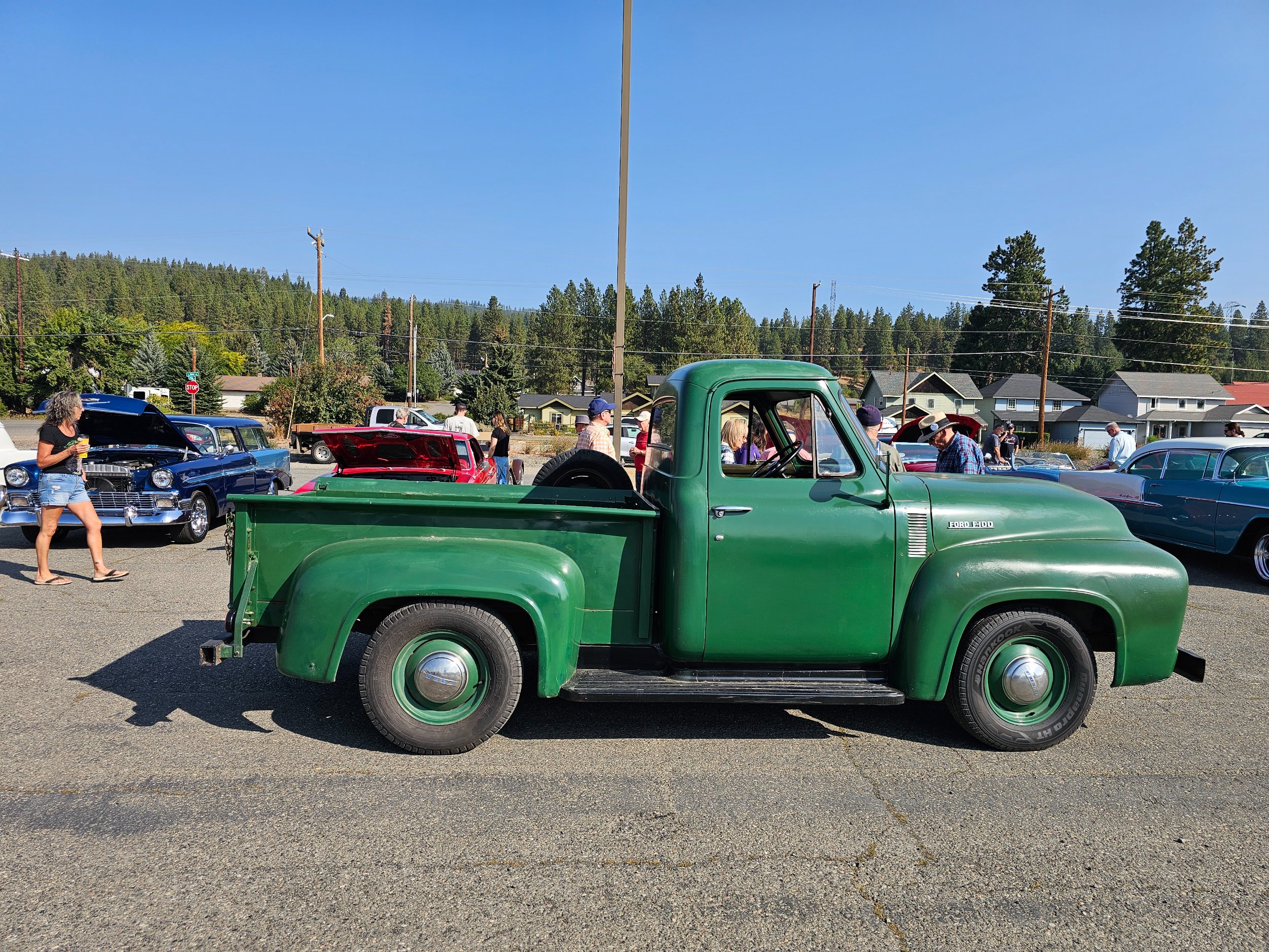

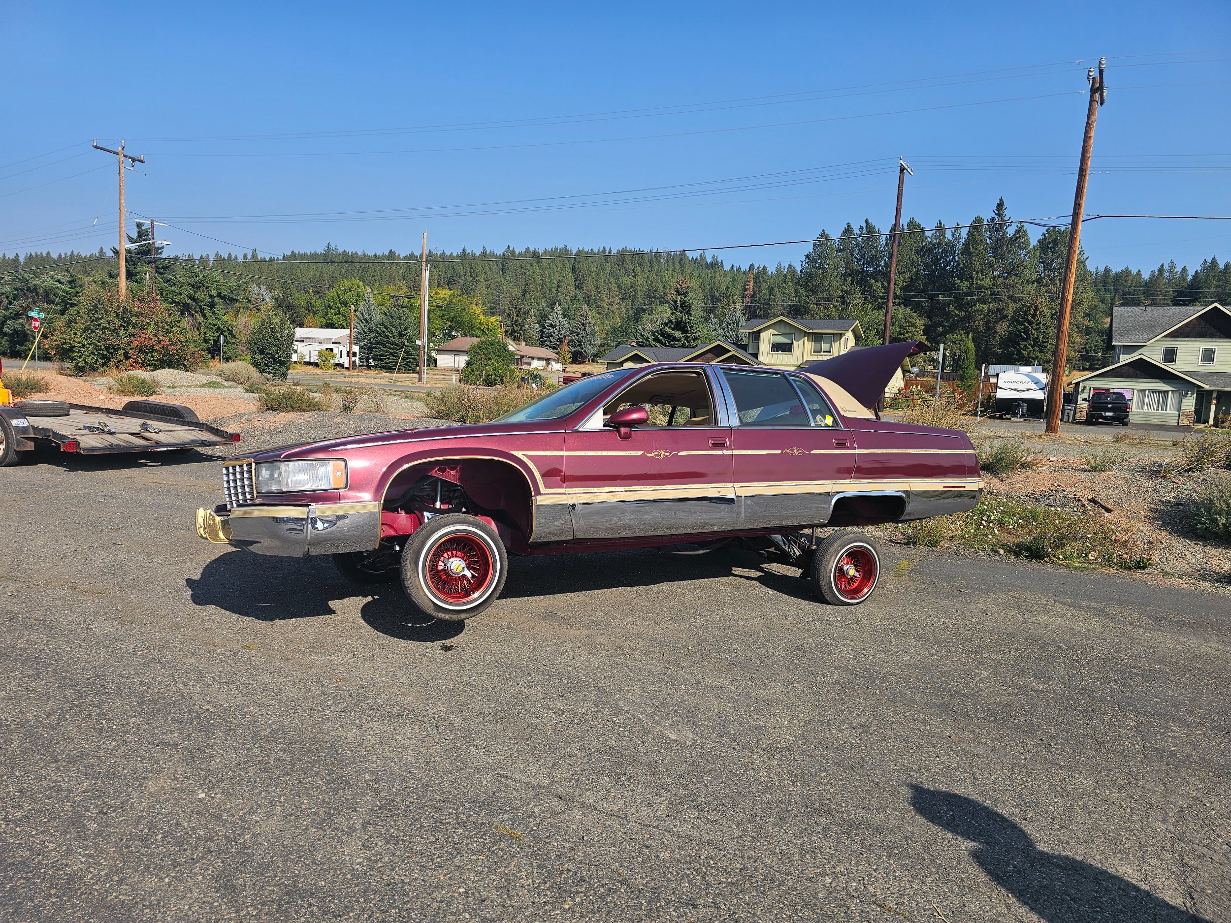

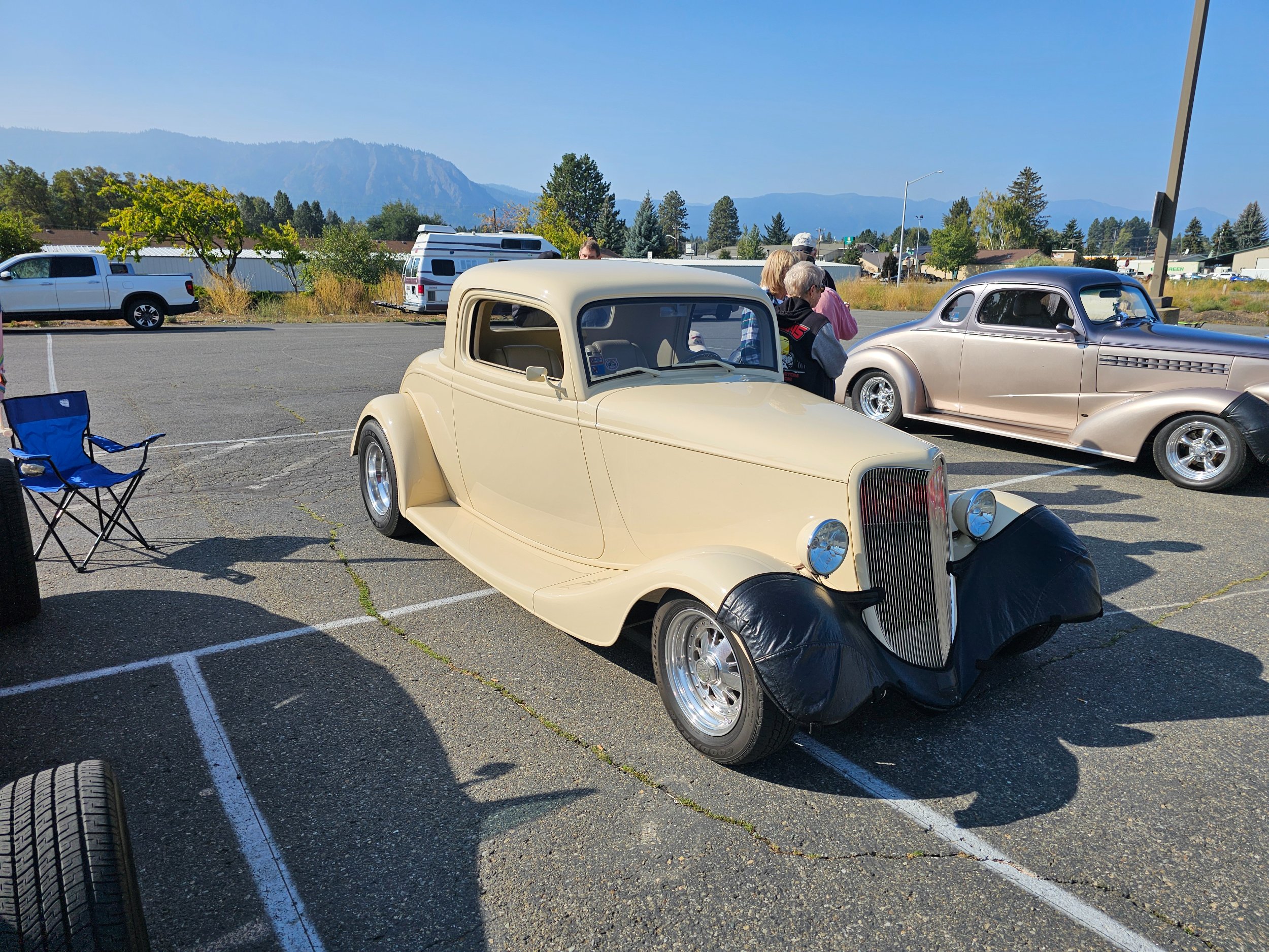

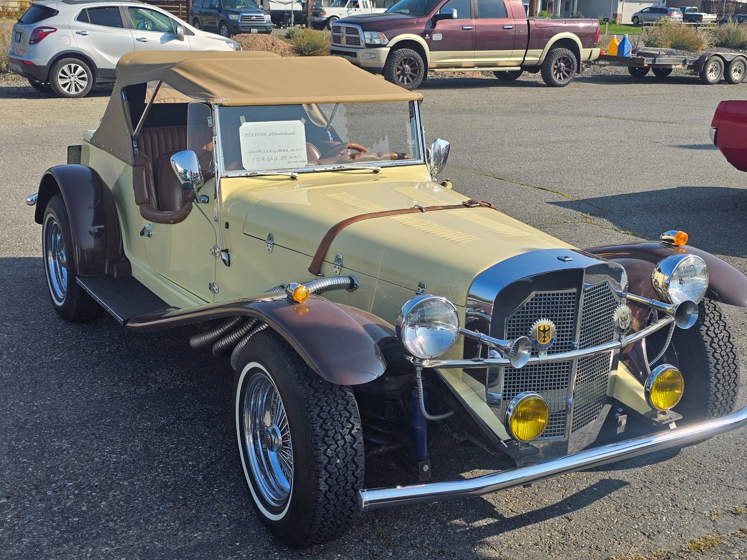

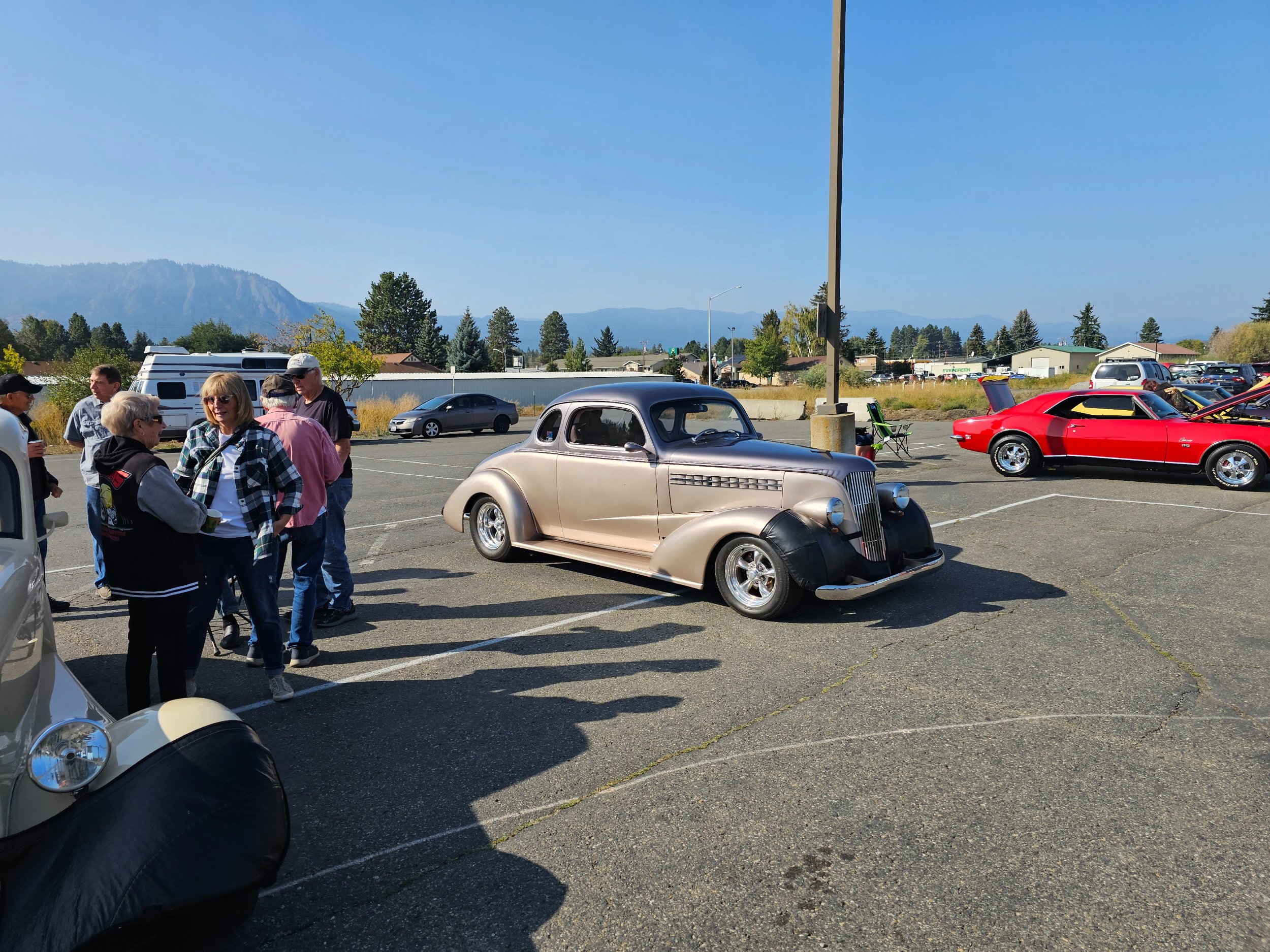

Then drove over to where the Cars & Coffee was happening.

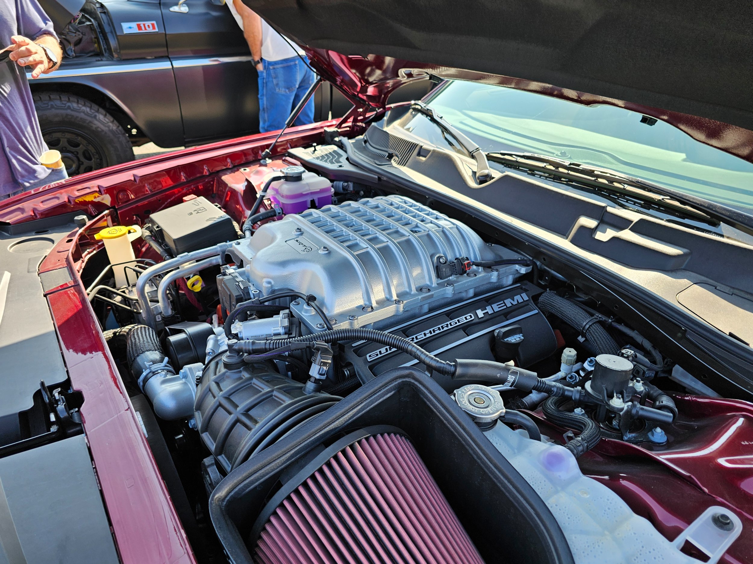

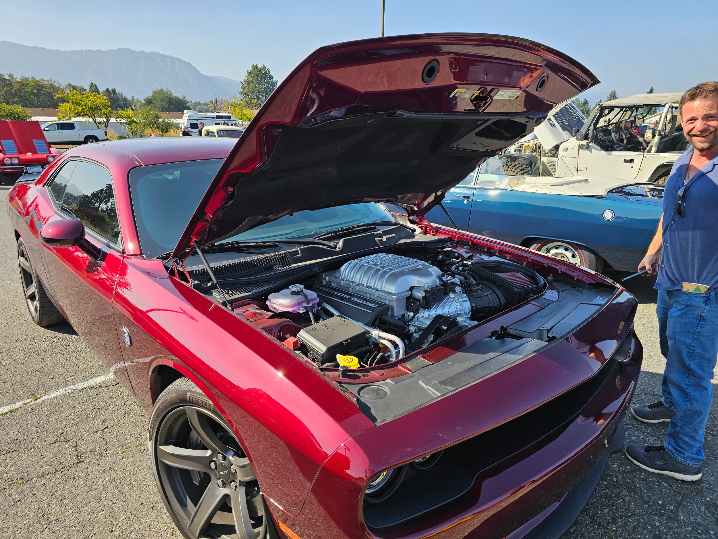

This Dodge Challenger only has 64 miles on it...

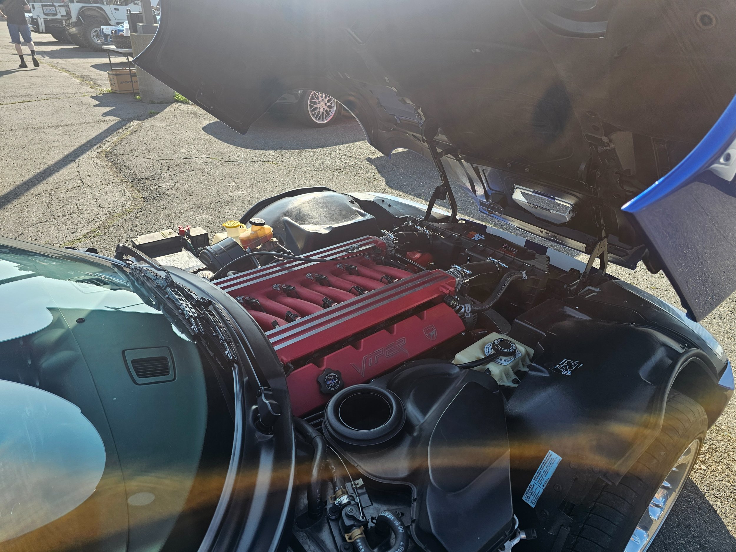

Viper!!!
Yep, And the guy was fun to talk with... This was supposed to be the last event of the season but they said if the weather holds for Oct they'll have one then also... My leg isn't too happy with me right now but it was worth the trip & time to go...
