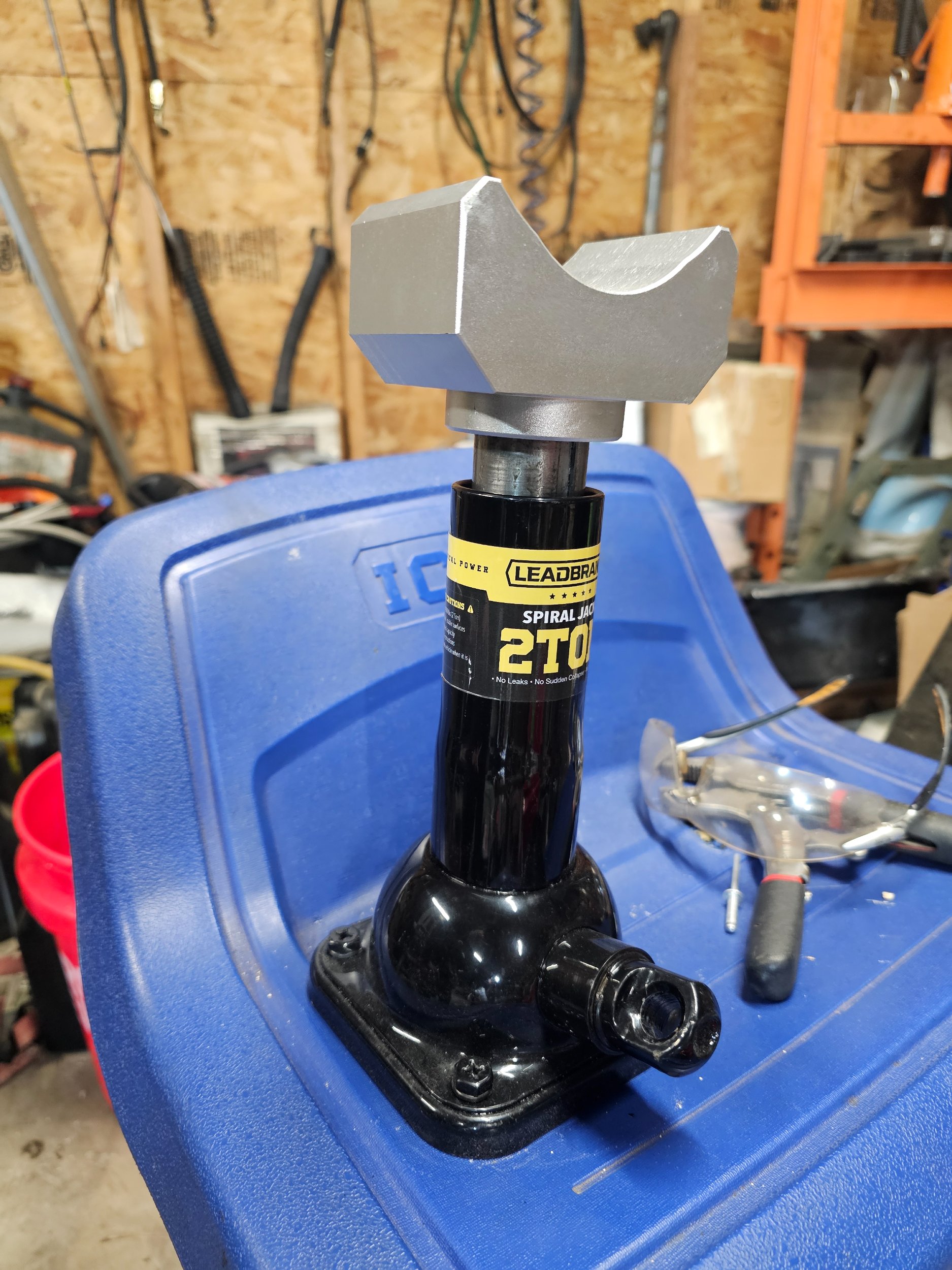

Picked up a screw jack for the Jeep. It's goes up to 19.5". And I added a axle cradle to it too.

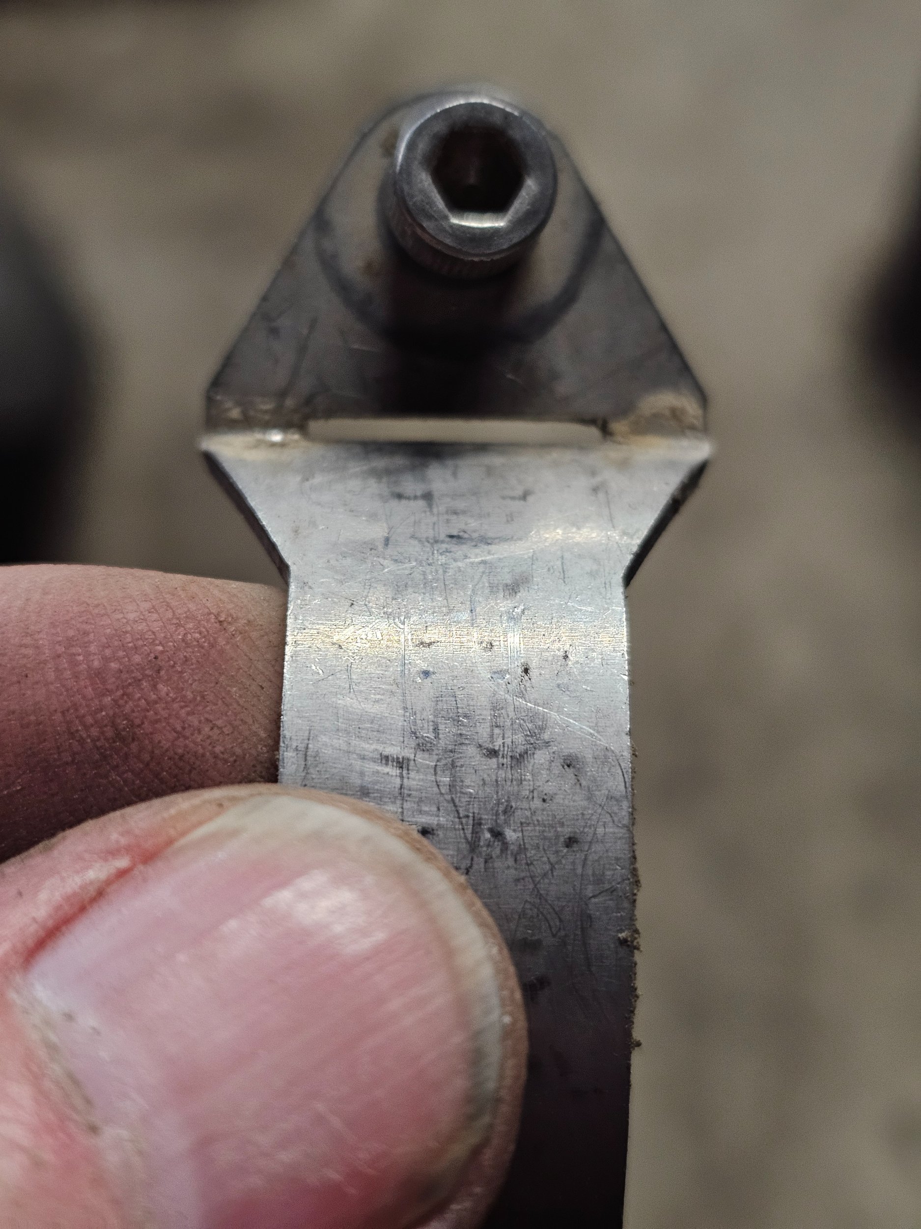

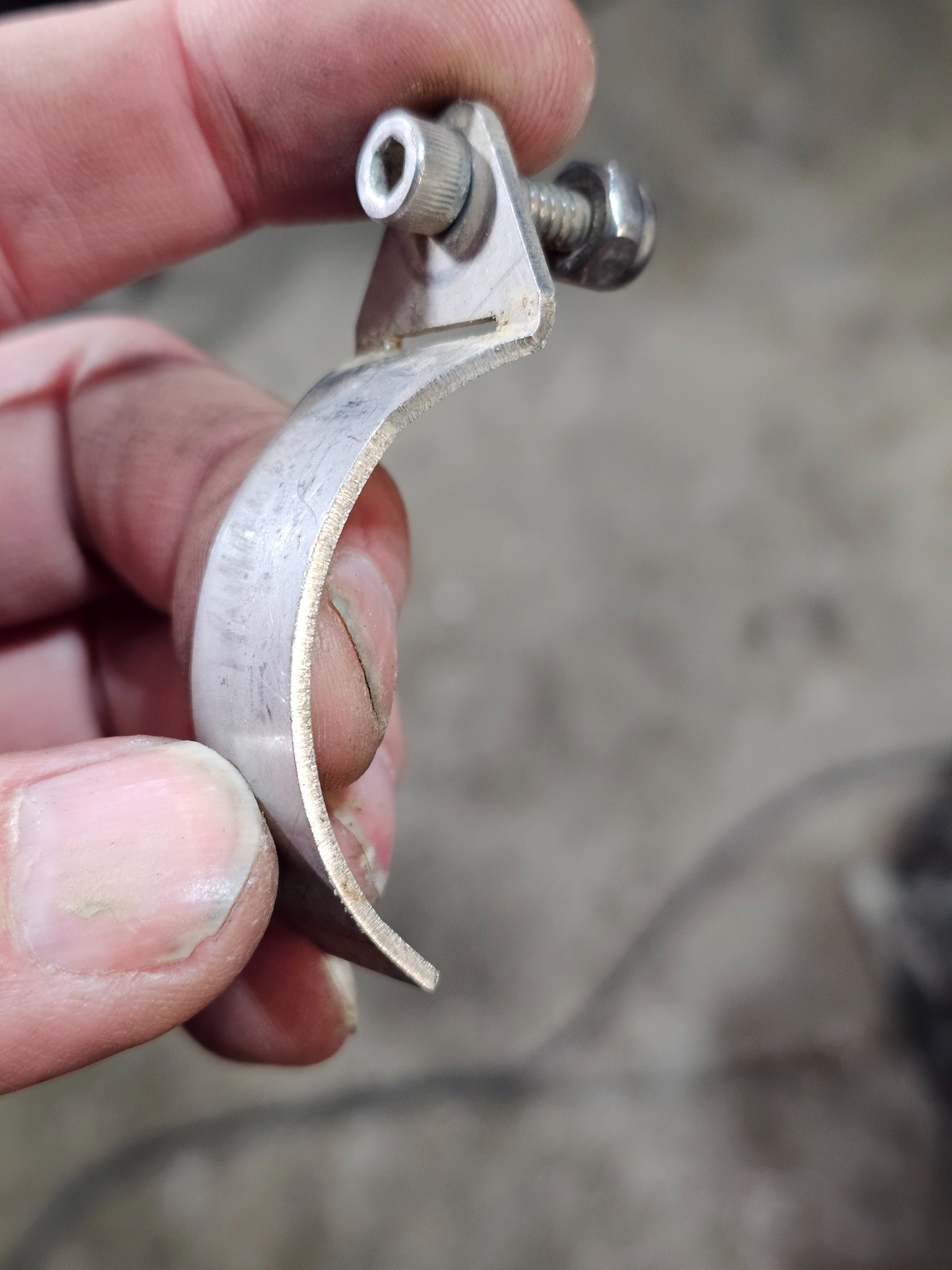

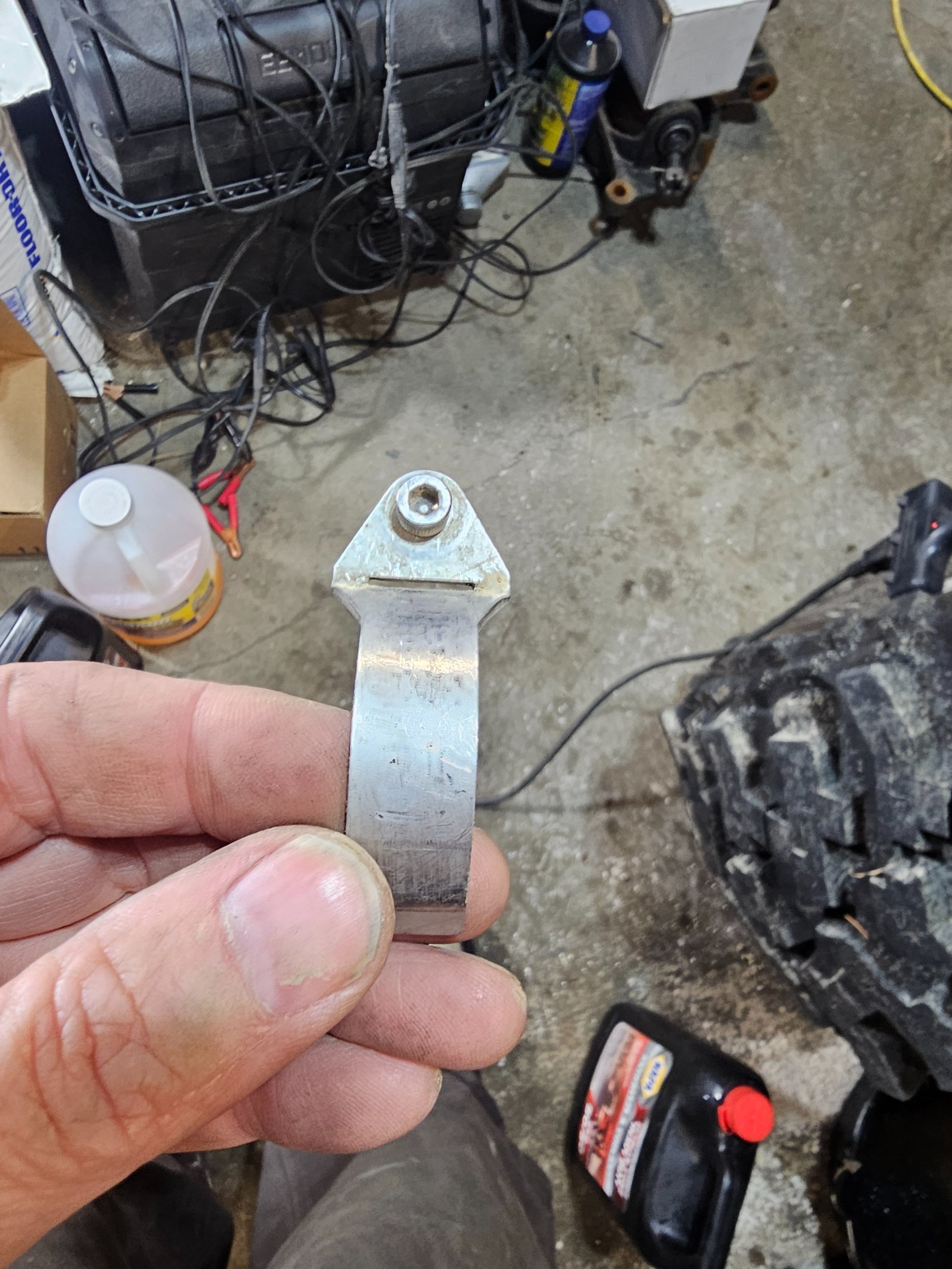

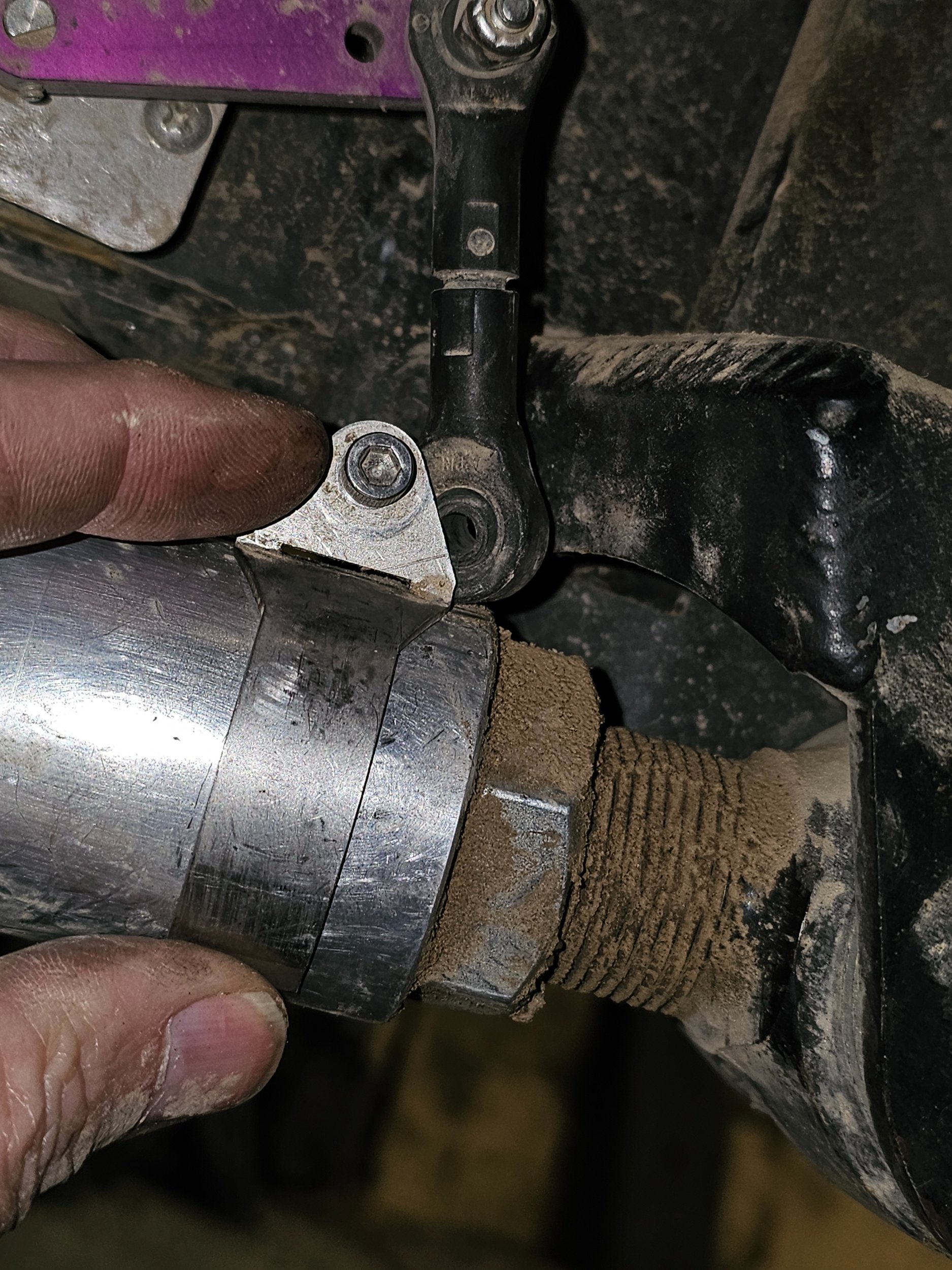

This is the tab for the height sensors. It's made to wrap around the side of control arm.
So my thought is to drill 3 holes in them and then drill and tap the arms.
I'll carry hose clamps too for backup...
And NO heavy duty clamps won't fit in the slot so that isn't a possibility.

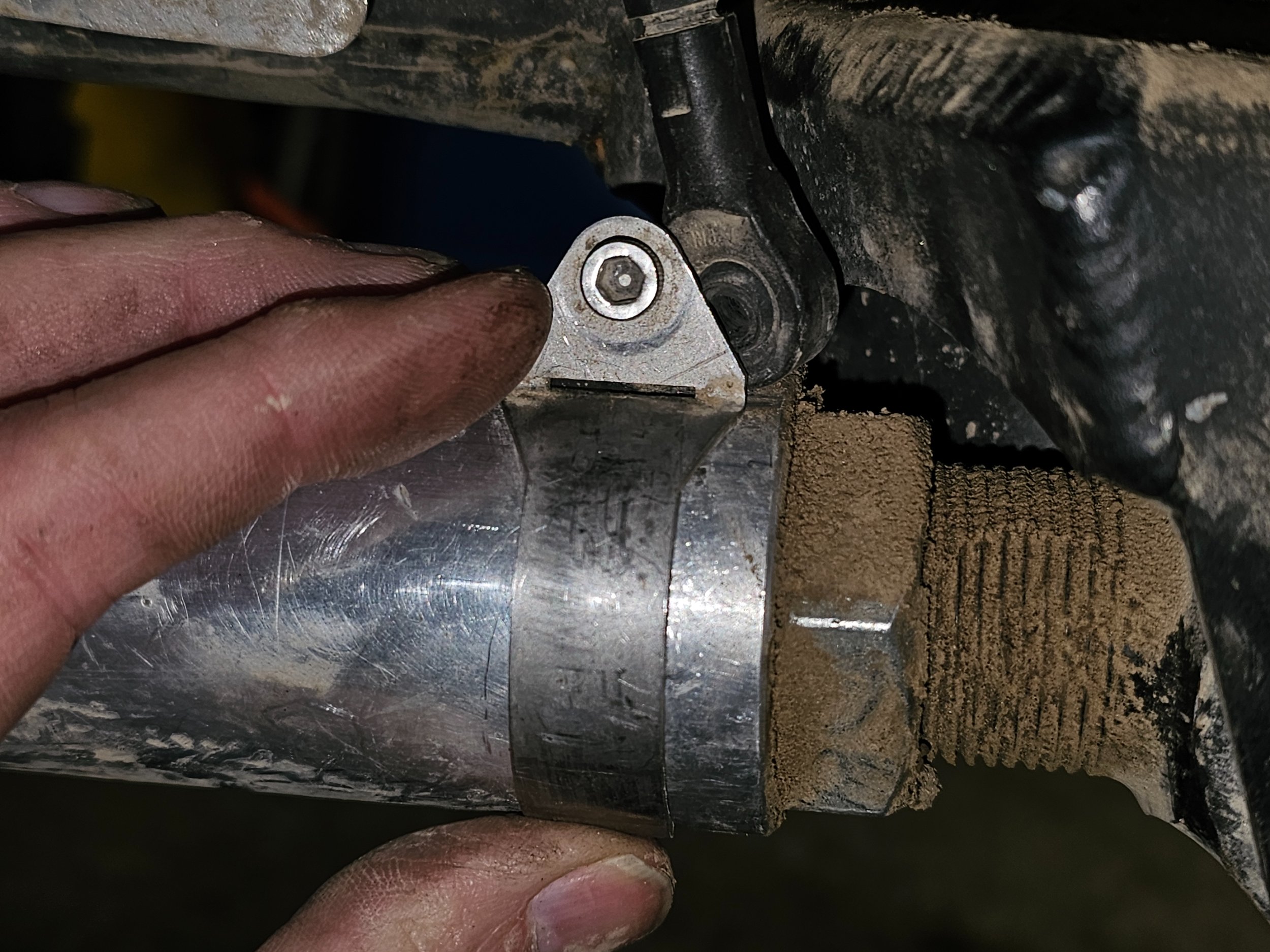

Obviously the best way to fix it would be to weld these tabs to the arms but I don't do Tig...
Or I could just put them back on with hose clamps.... but we know what can happen.

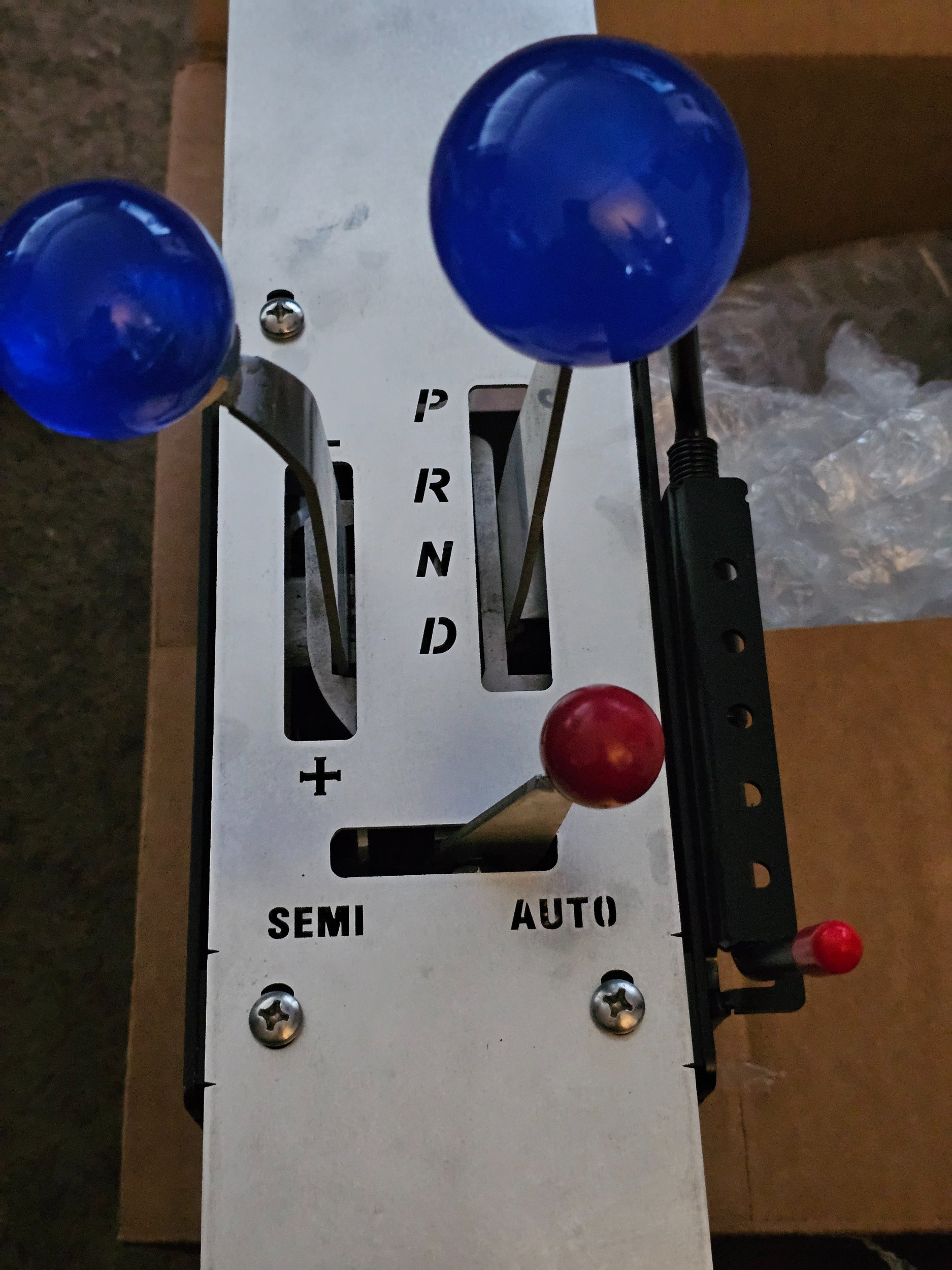

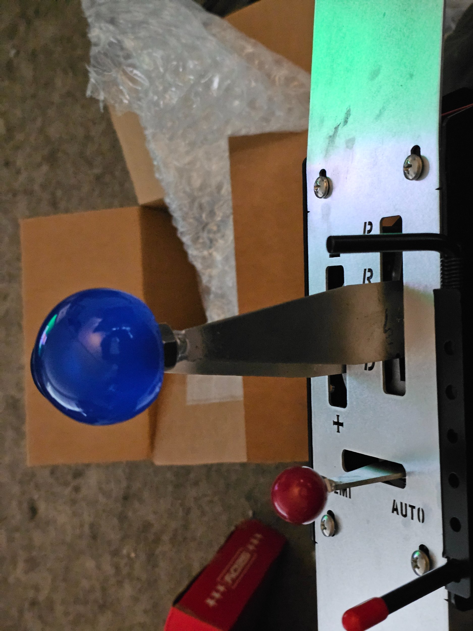

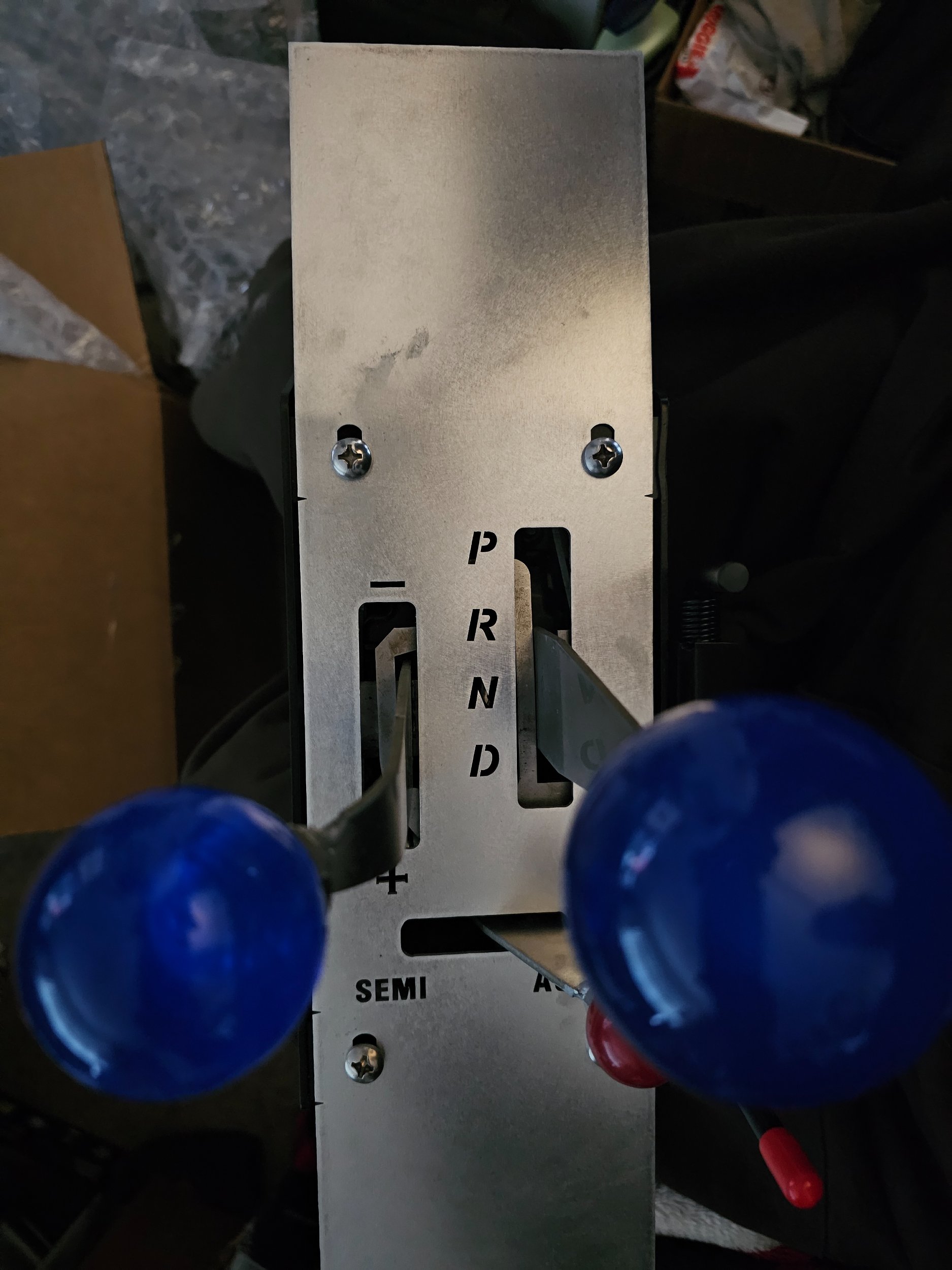

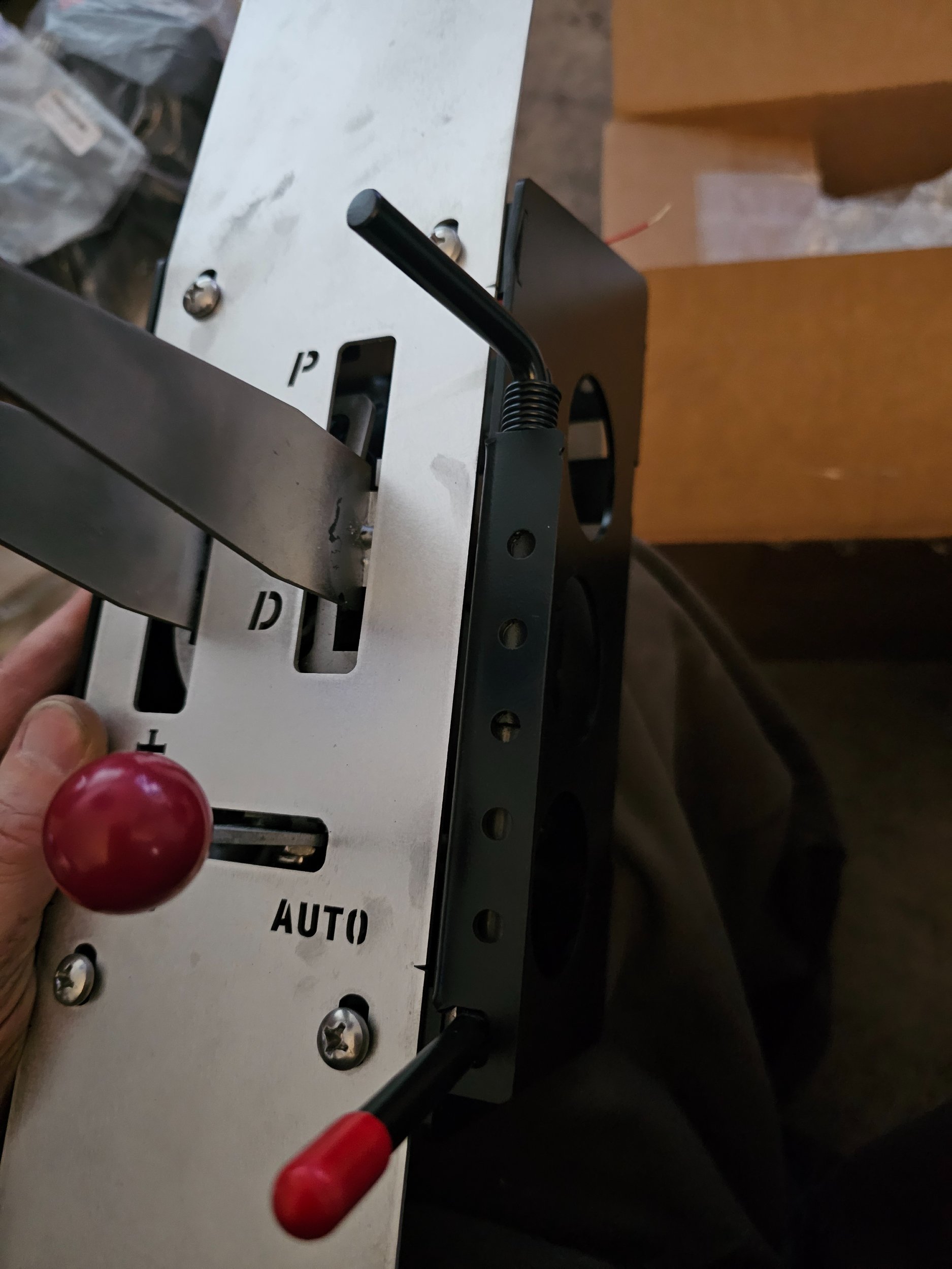

Got the shifter for the 8HP70 today. This thing is SWEET 😋.
Wasn't cheap either but as they say you get what you pay for.
I'd also opted for Blue shifter knobs instead of Black.
And I added the Park lockout for going from Drive to Reverse quickly.
It'll be fun getting it installed when the time comes.
At this point I've got all the parts I need to install the 8HP70. Once it's installed I'll need 4 HPT credits and then get Ryan from FRP to tune the transmission. Also a trip with the Jeep to Seattle so Sound German can flash the transmission with a Challenger programming to enable the tap shift.
Truck versions don't have that feature.

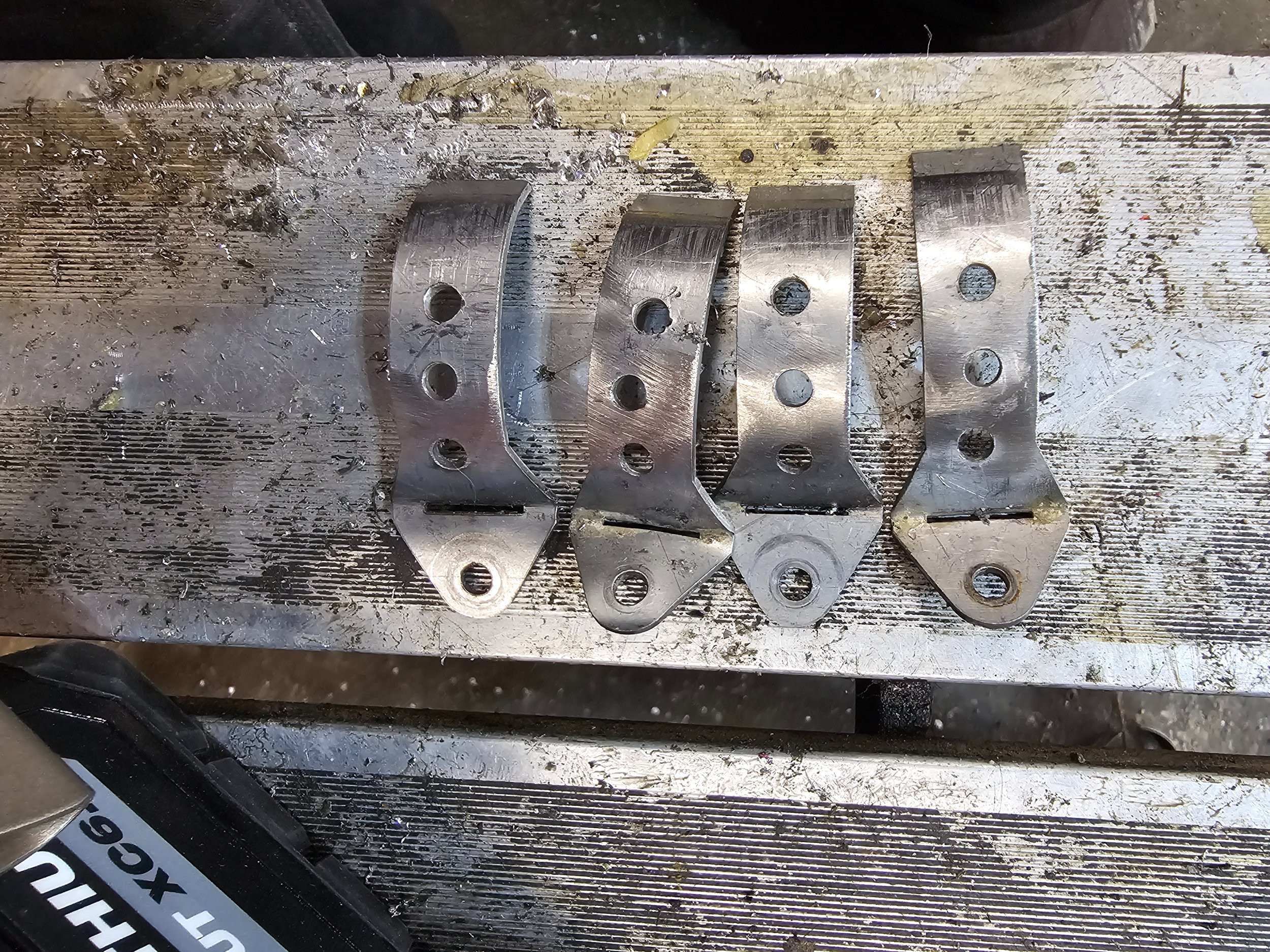

Got the tabs removed and marked where I want the holes.
