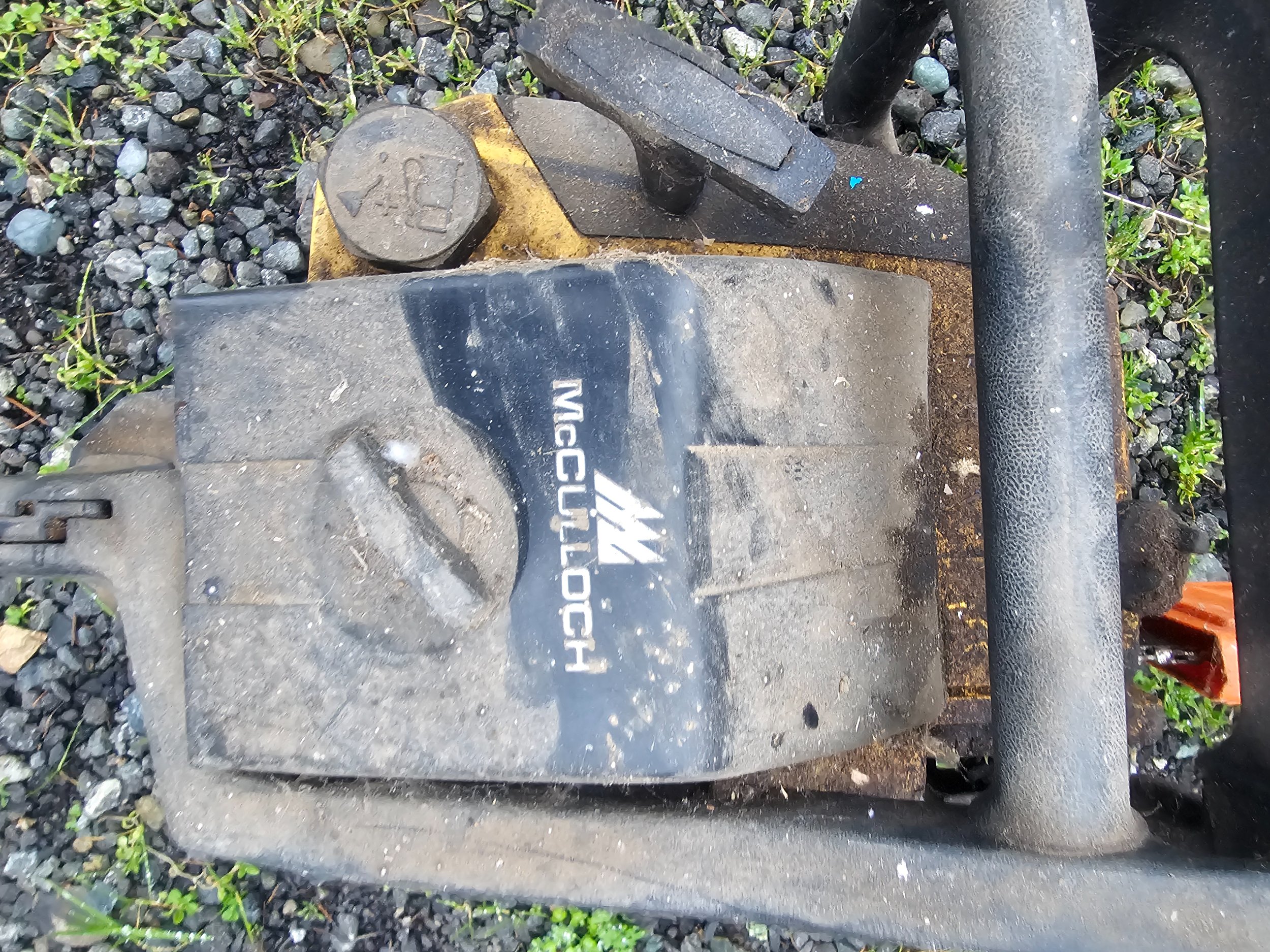

And I got a ICE chainsaw out of the deal...
It's a older McCullough saw. But pair nice with my battery powered saw.

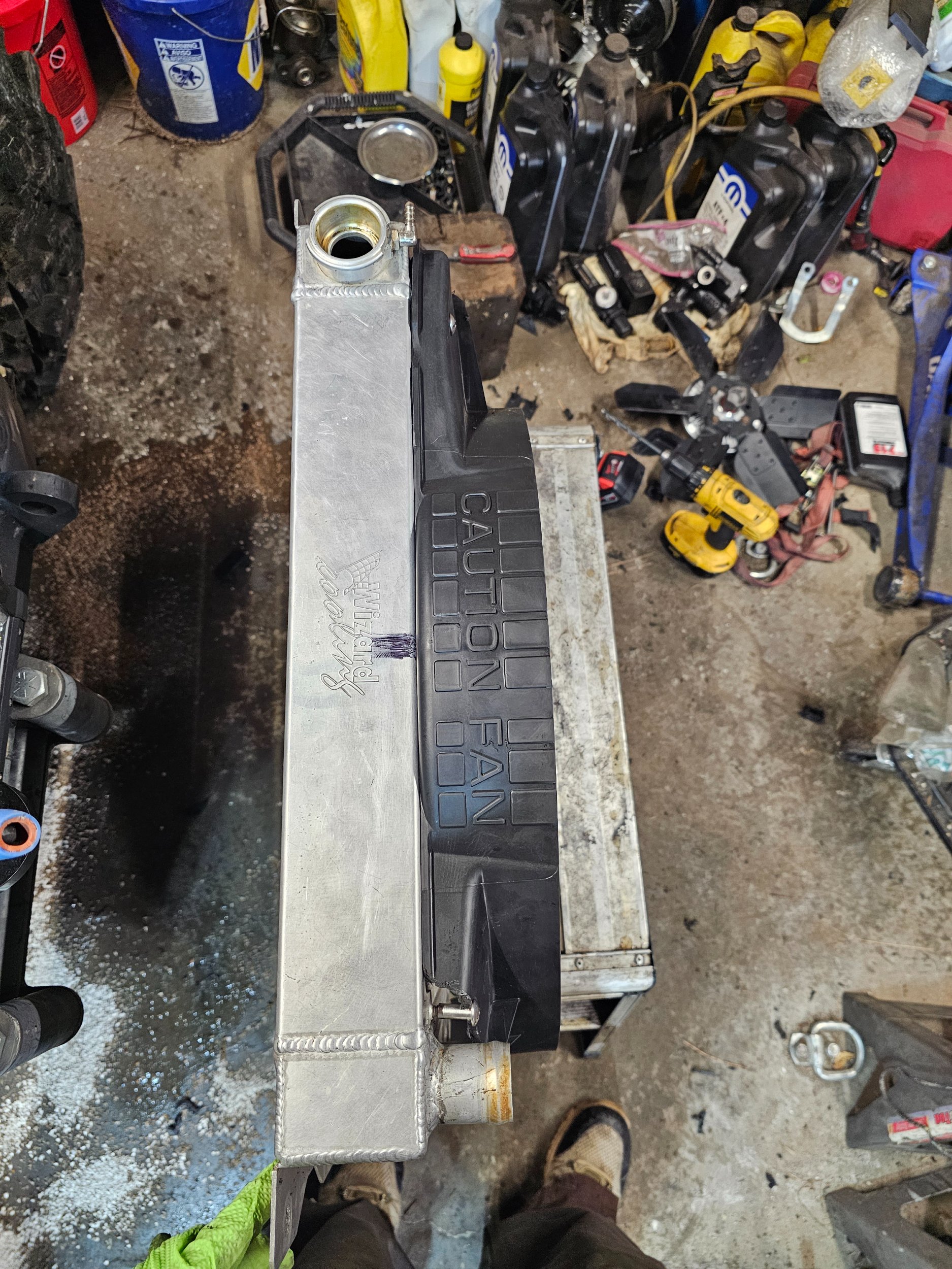

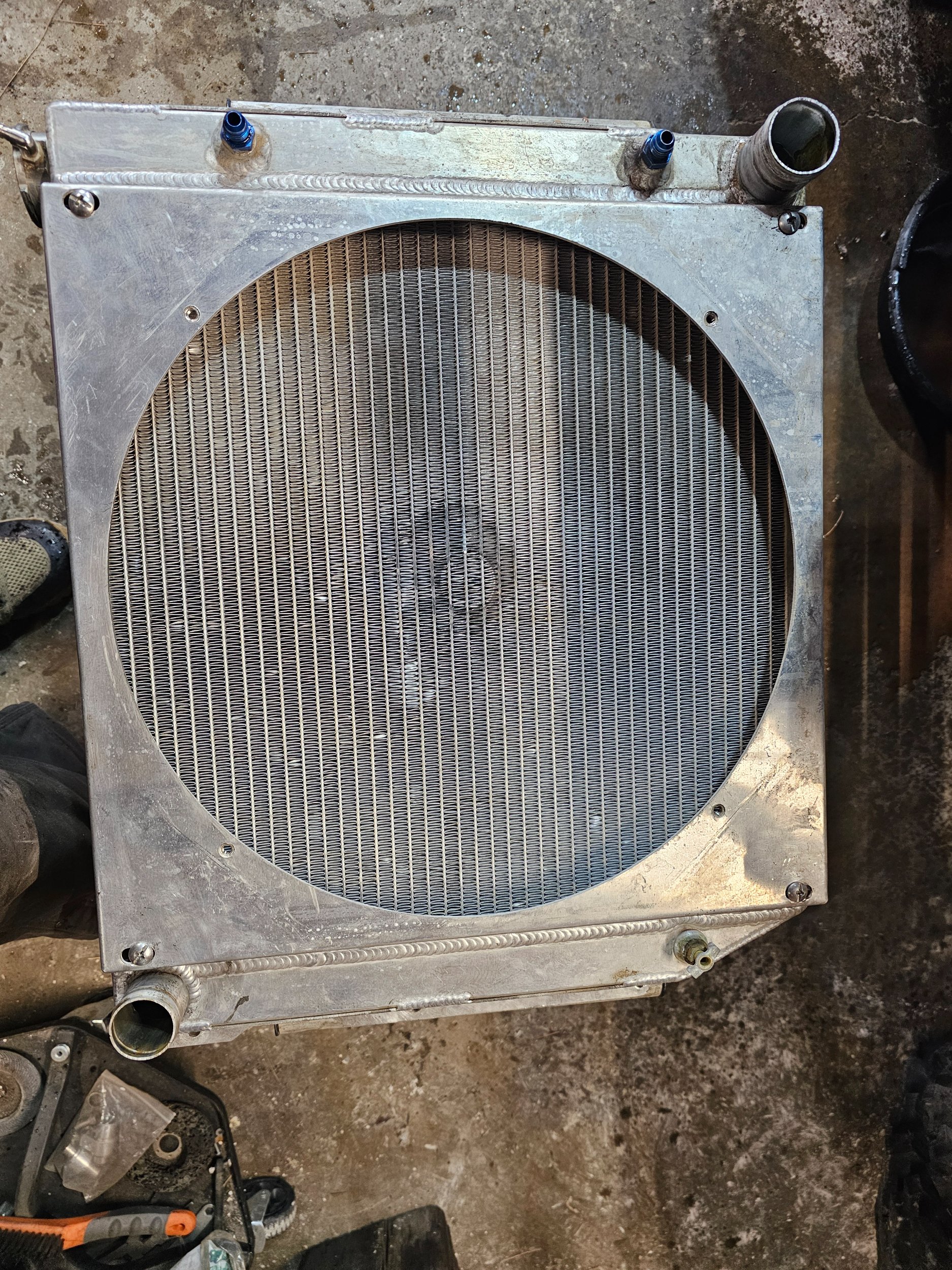

Pulled the radiator back out again...
I'm getting good at pulling it by now.

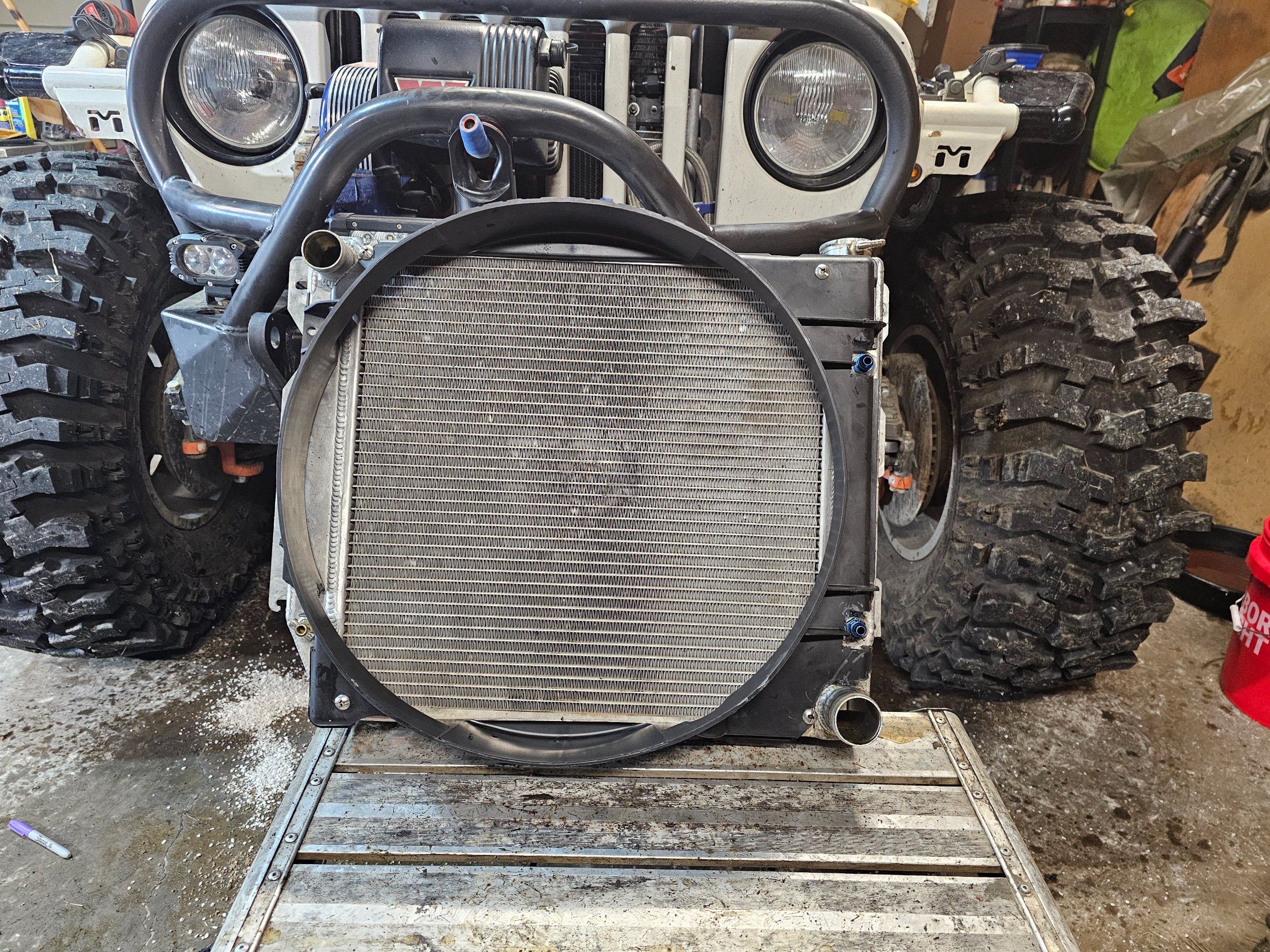

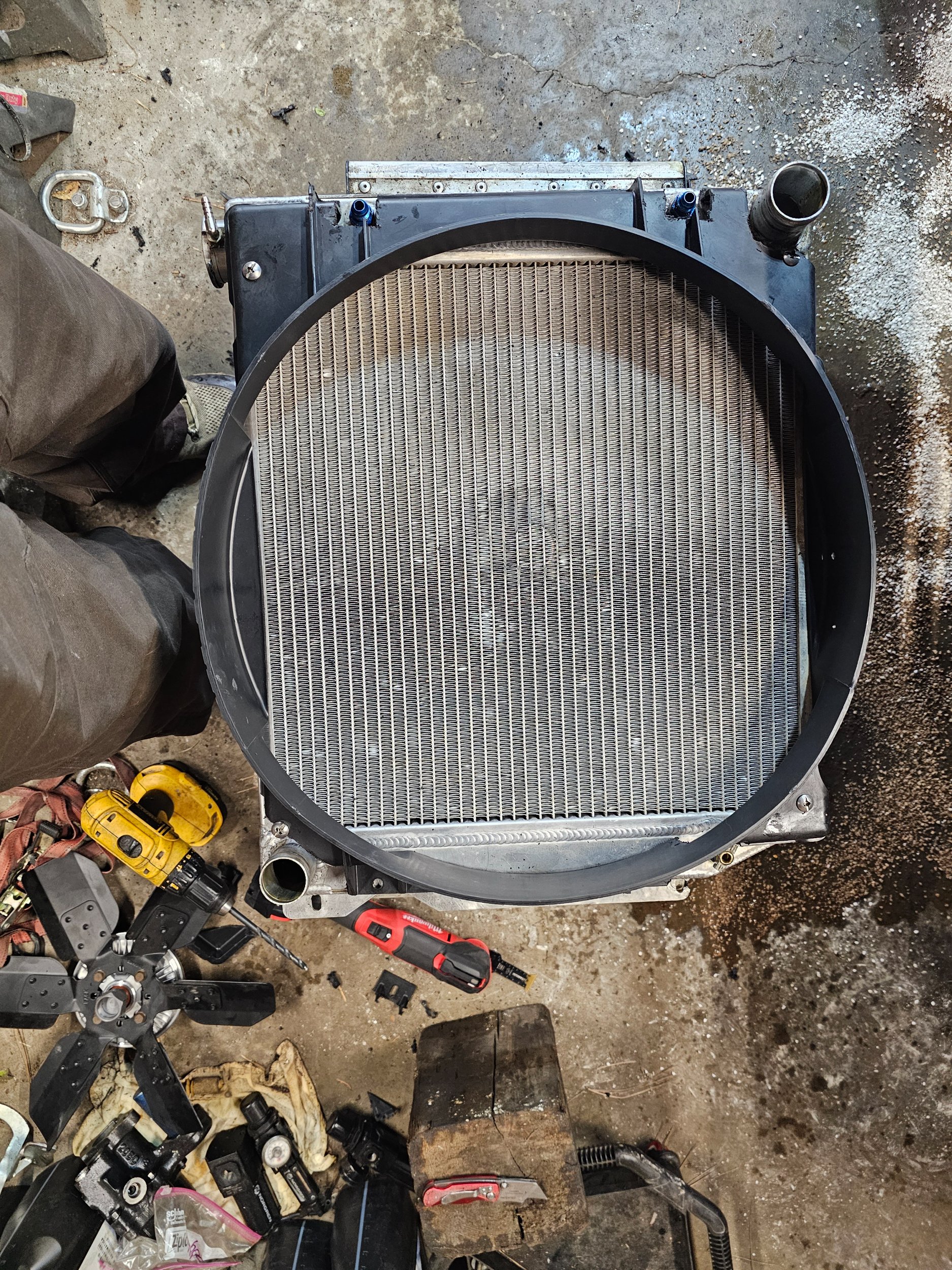

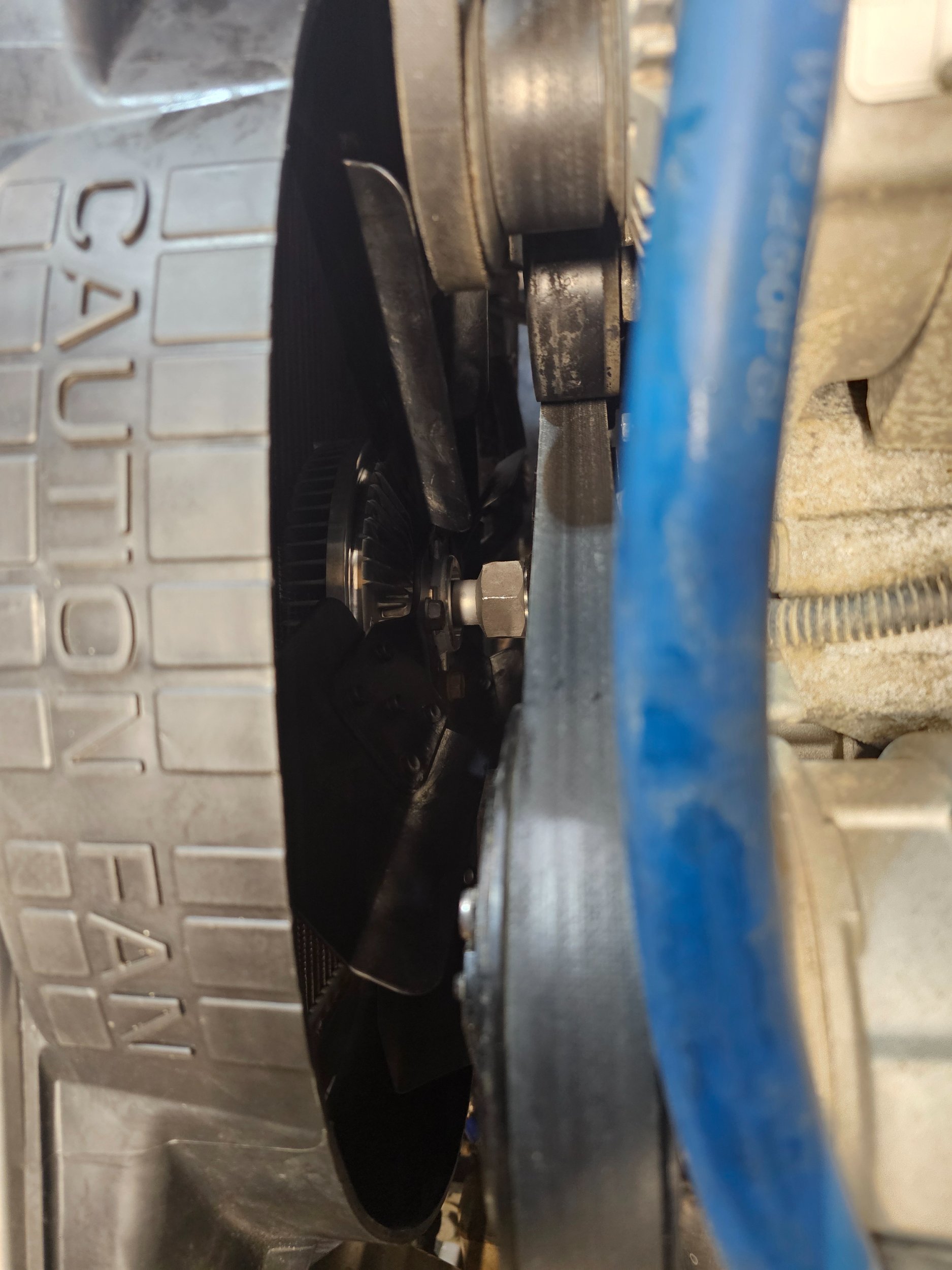

Took the metal shroud off and test fit the 4.0 shroud.
Then started cutting..

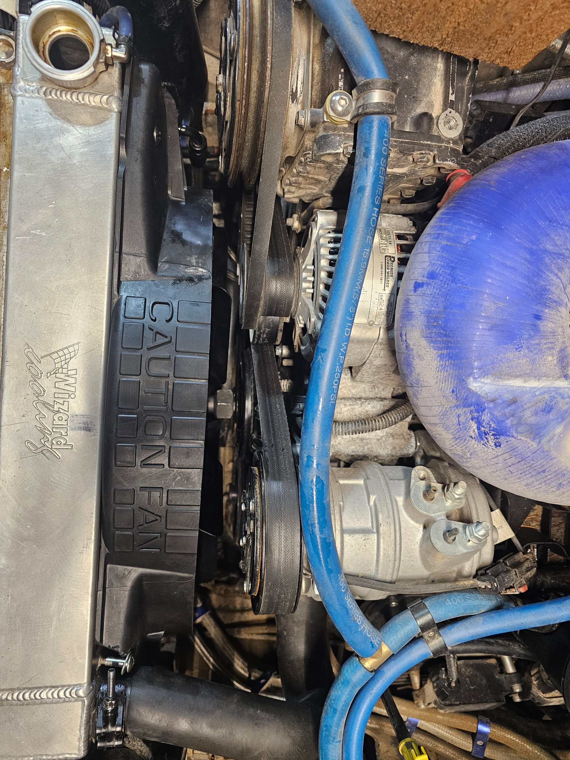

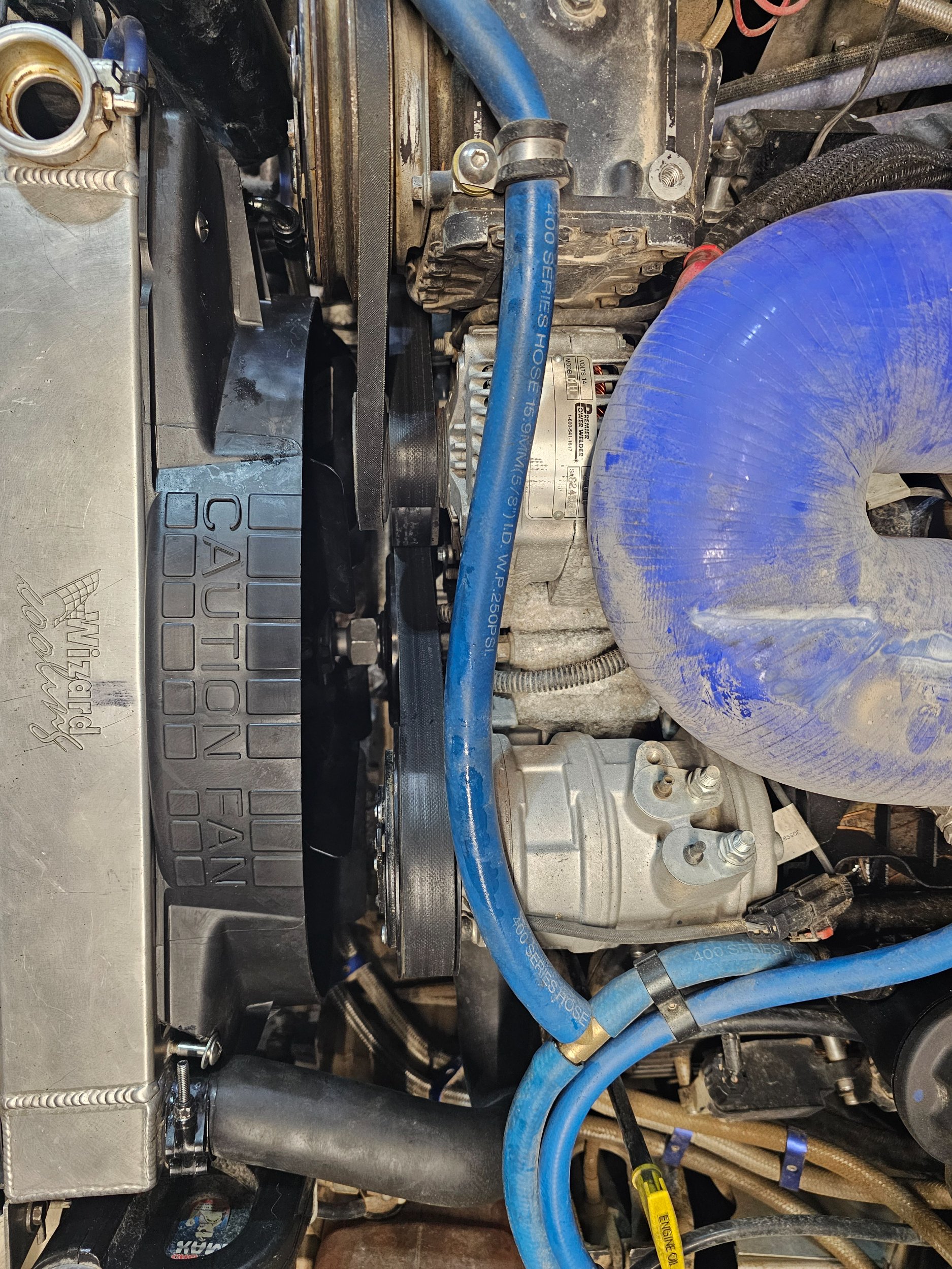

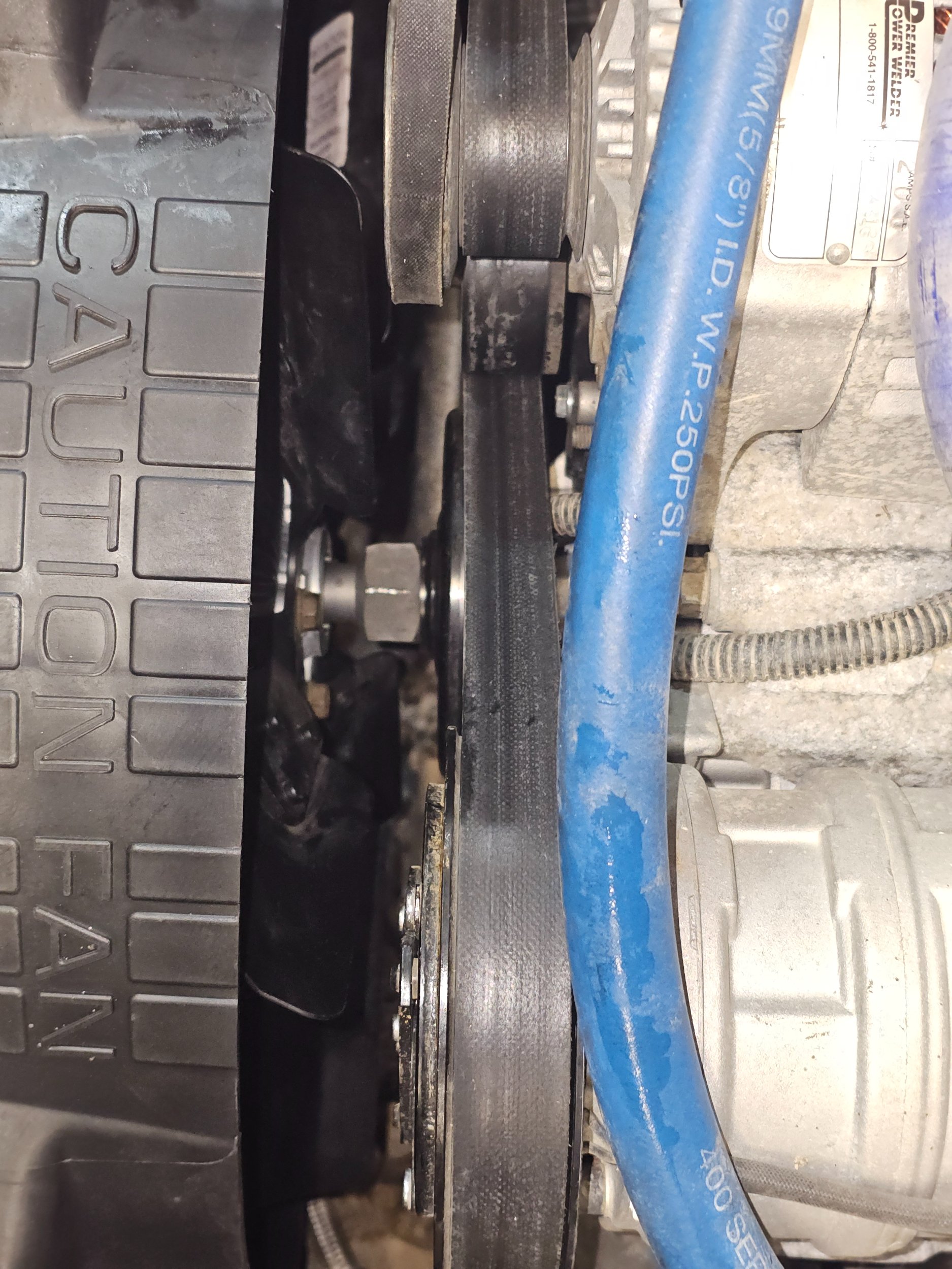

Put the radiator back in the Jeep and marked the center of the water pump in reference to the radiator.
Now getting the fan and shroud on at the same time was fun.
But it should suck the air through the radiator better than it did with the metal shroud.

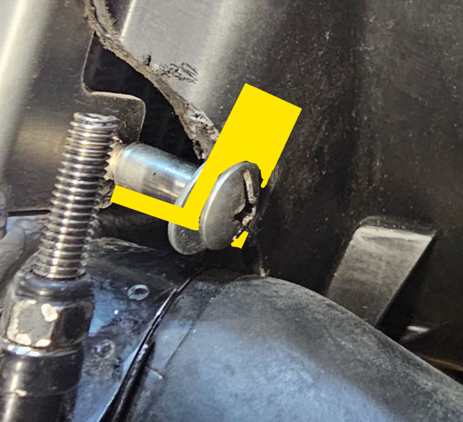

I did trim too much in the upper drivers side corner.
Grab a fender washer for that Driver Side and you should have plenty of 'grab' on the shroud. May need to trim it and/or use the clamp next to it as a 'pinch point'. Just a thought.
Overall - That's a freaking clean install!!
I'd put a small washer on it as you can see and it's hitting the hose clamp just barely. I'll have to look at it more tomorrow and think.

If you have a small strip of metal you can make a small L shaped clamp to run the bolt through.
Crude as hell but this was my thought... Not quite long enough to bottom out on the mounting surface of the radiator.
I'd thought about trying to epoxy a washer in place? Maybe do the fender washers with some holes drilled into them and then rivet then through the plastic with one on the inside & one on the outside? And epoxy? Then trim them to clear the upper hose?
Reactions: FarFire70
If you really want to get adventurous and you still have the chunk of plastic you cut off of there, you could plastic weld it back in place...
I'm not that adventurous... I don't have the tool for plastic welding either.
