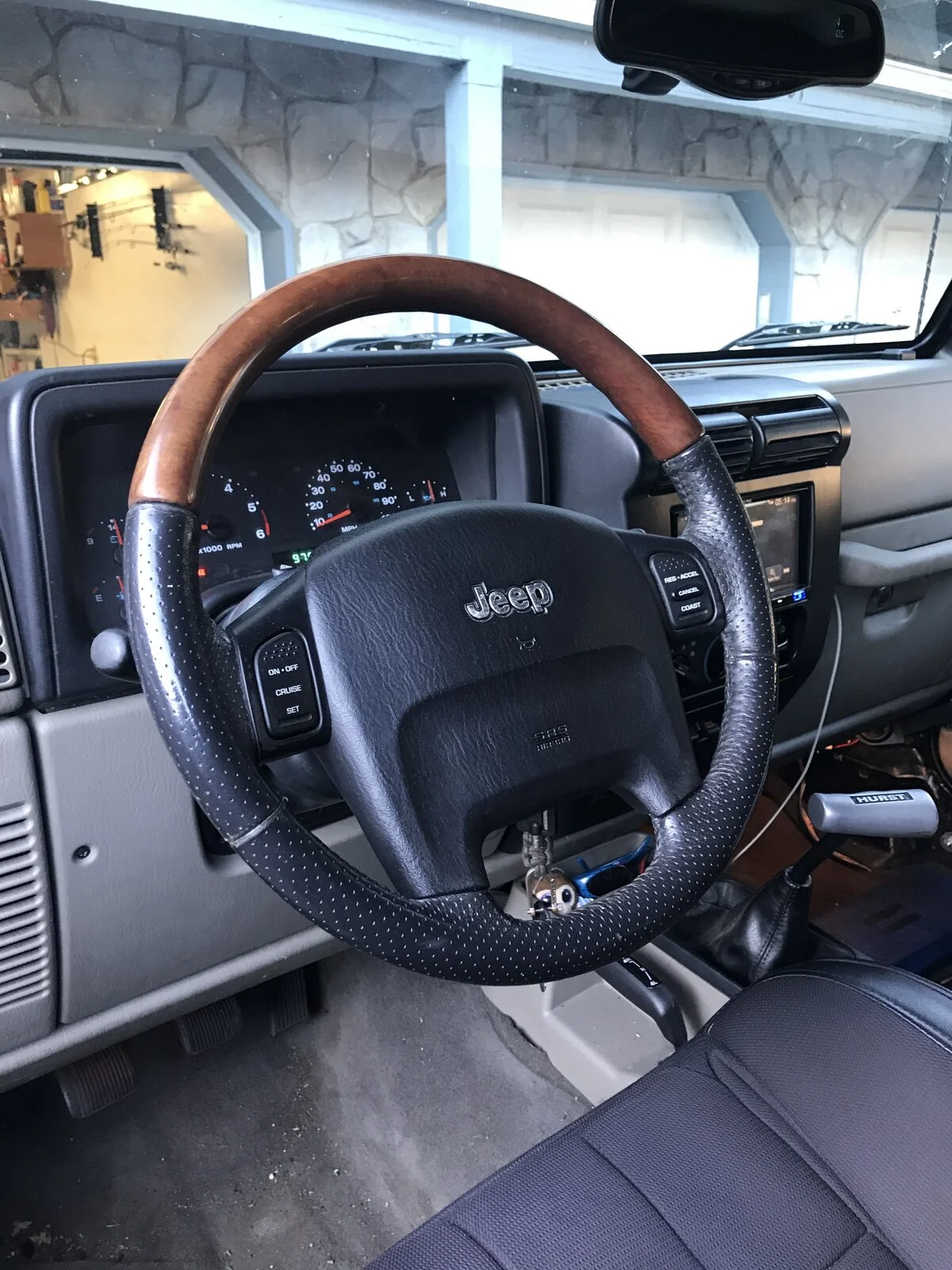

the steering wheel for a WJ is a straight swap to an 03-06 tj/wj. You have to reuse your airbag, I believe the wj is a 2 stage.
You can tranfer your switches over. I swapped a Overland steering wheel in my tj a few months ago.
One of the best mods I have done. No more sticky leather.
