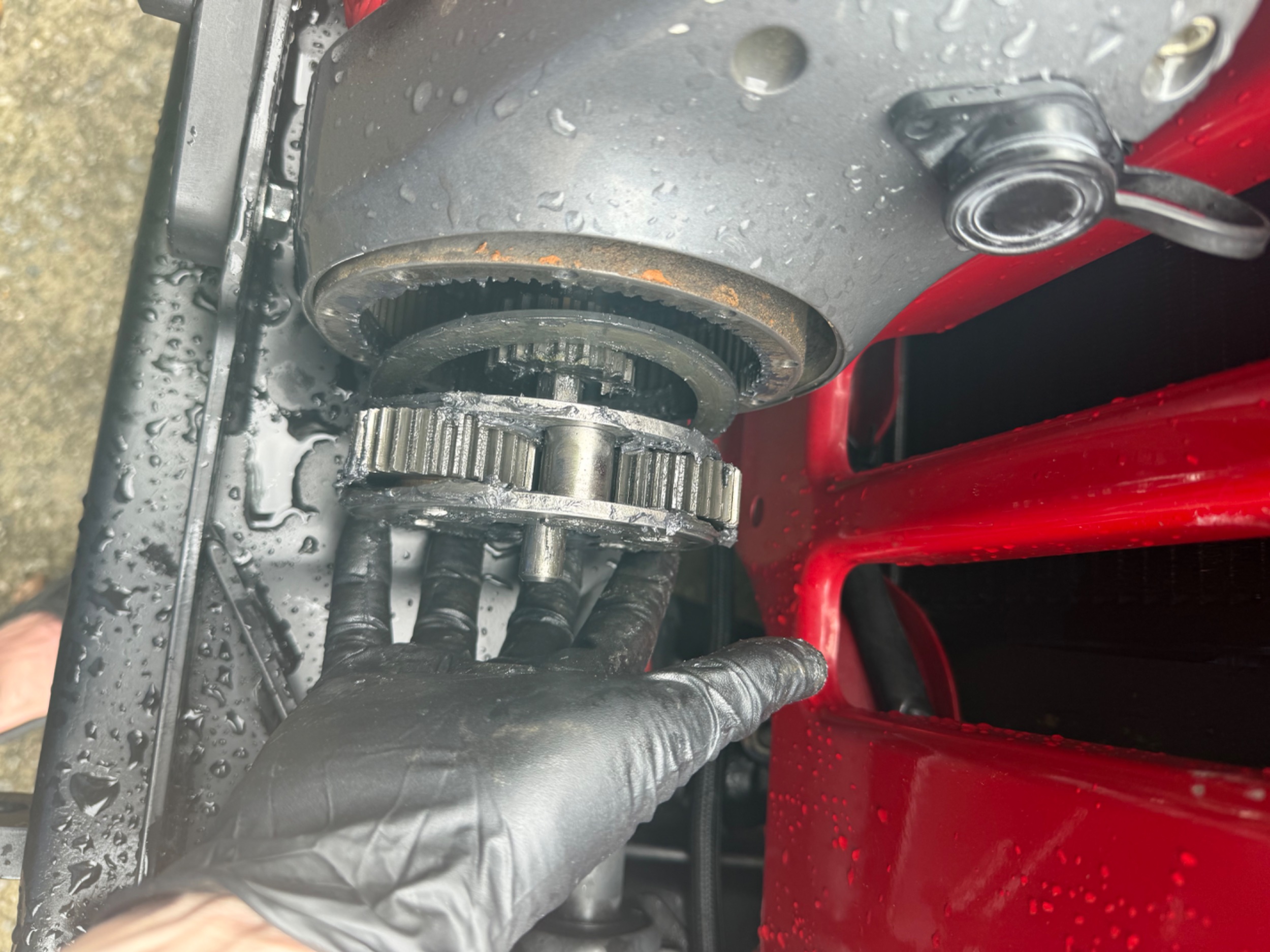

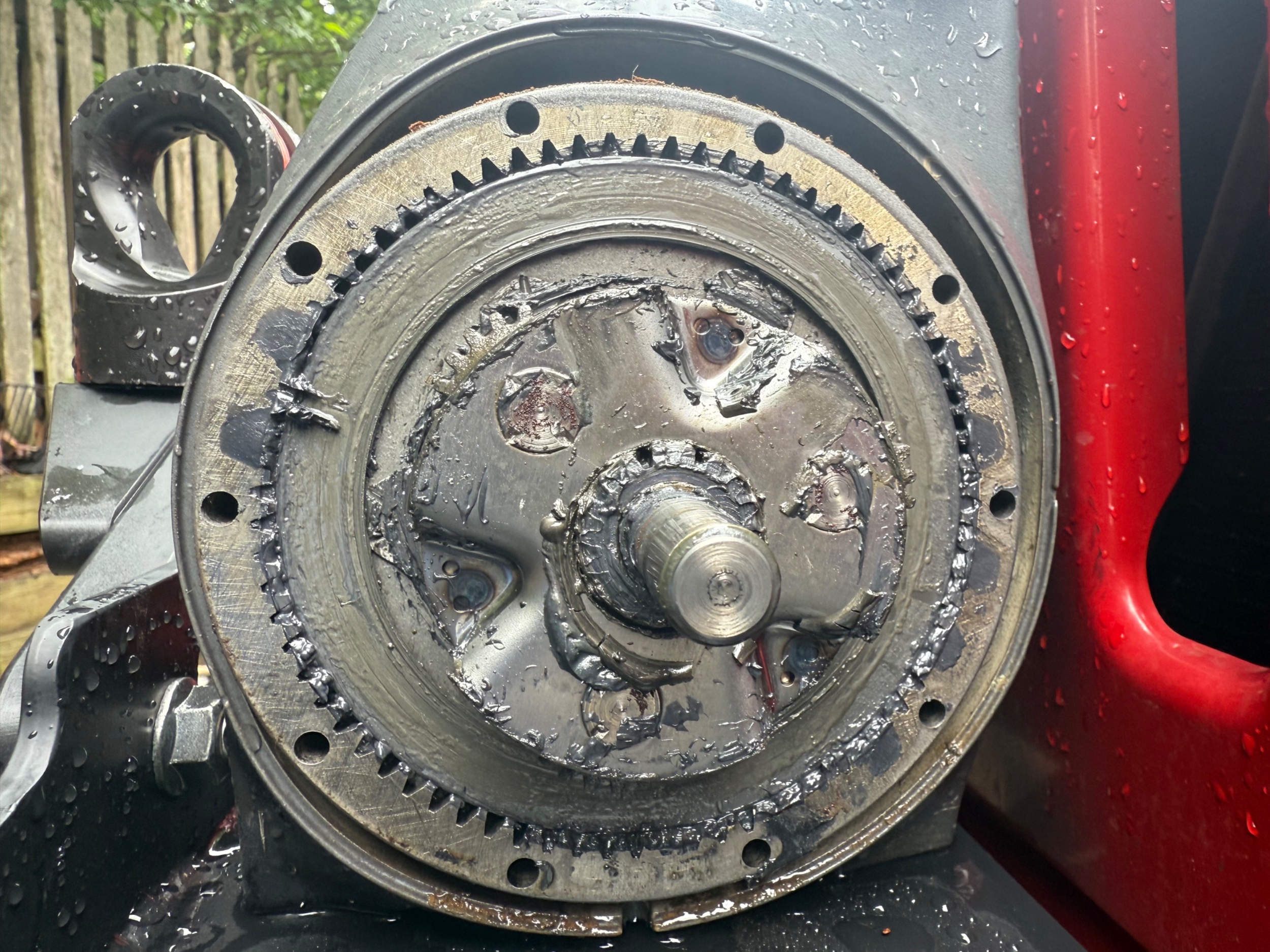

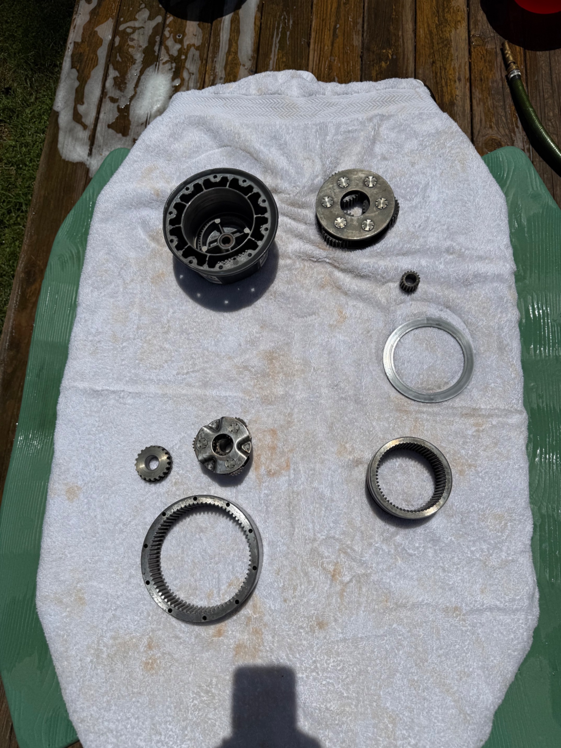

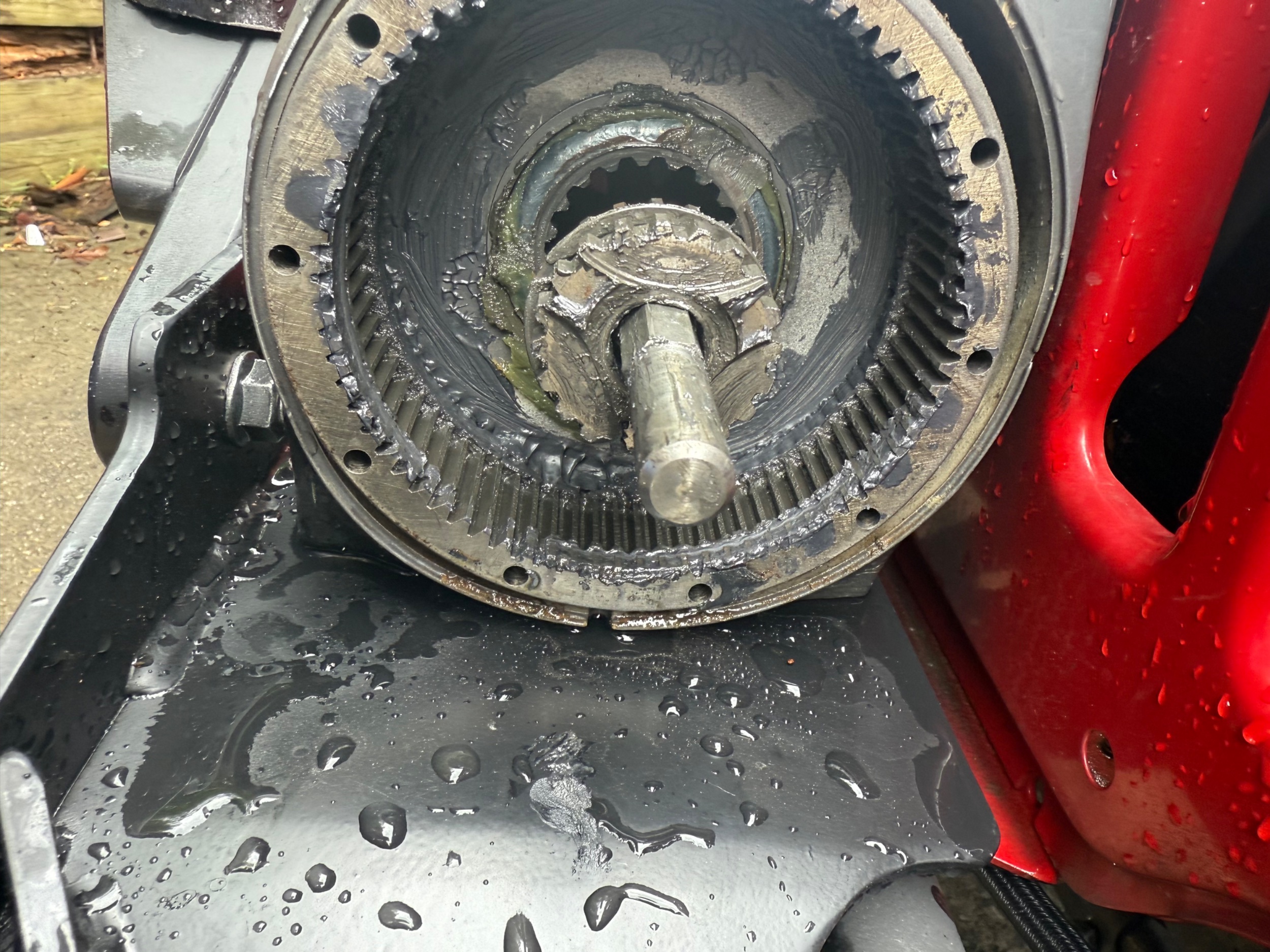

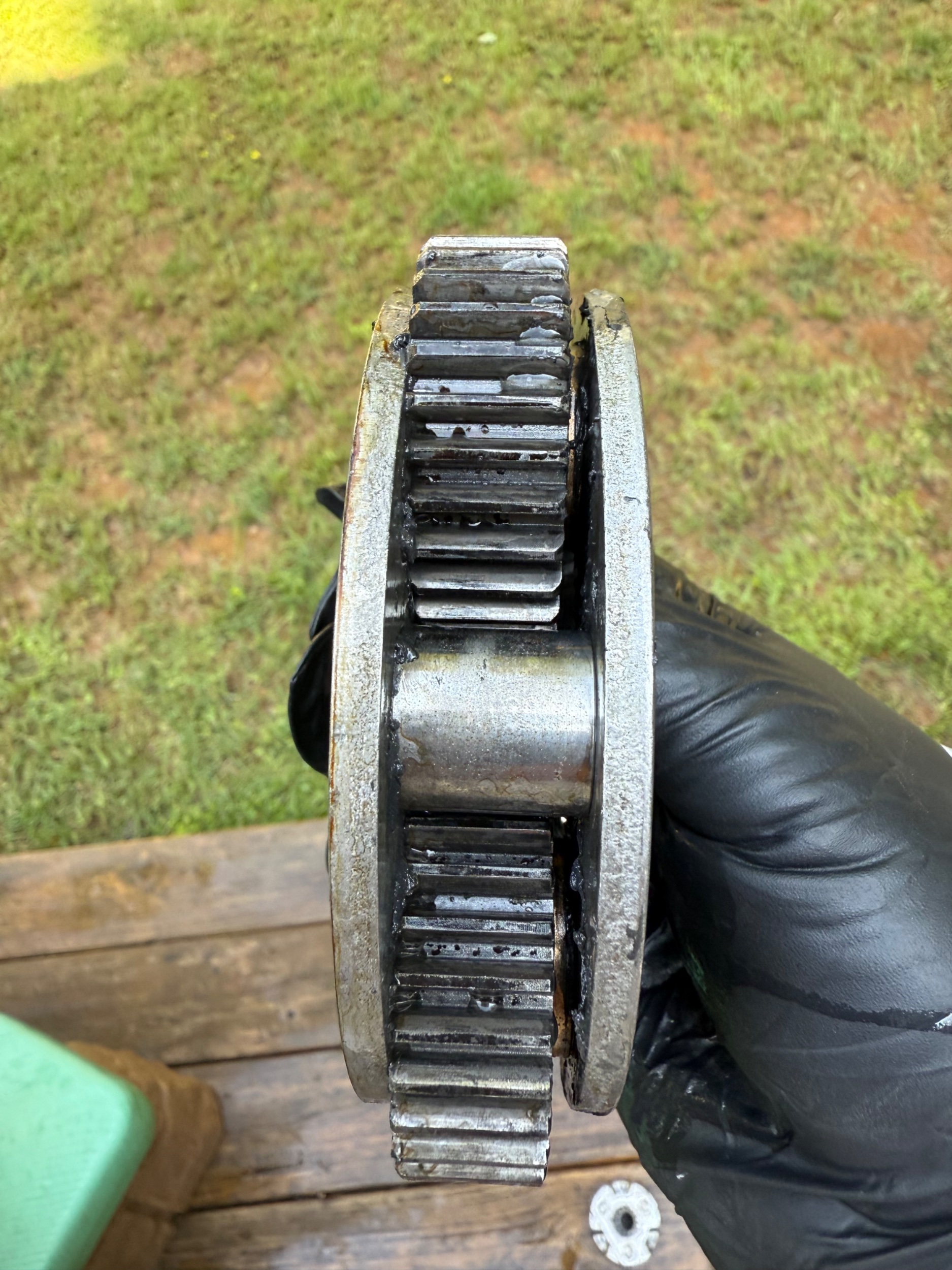

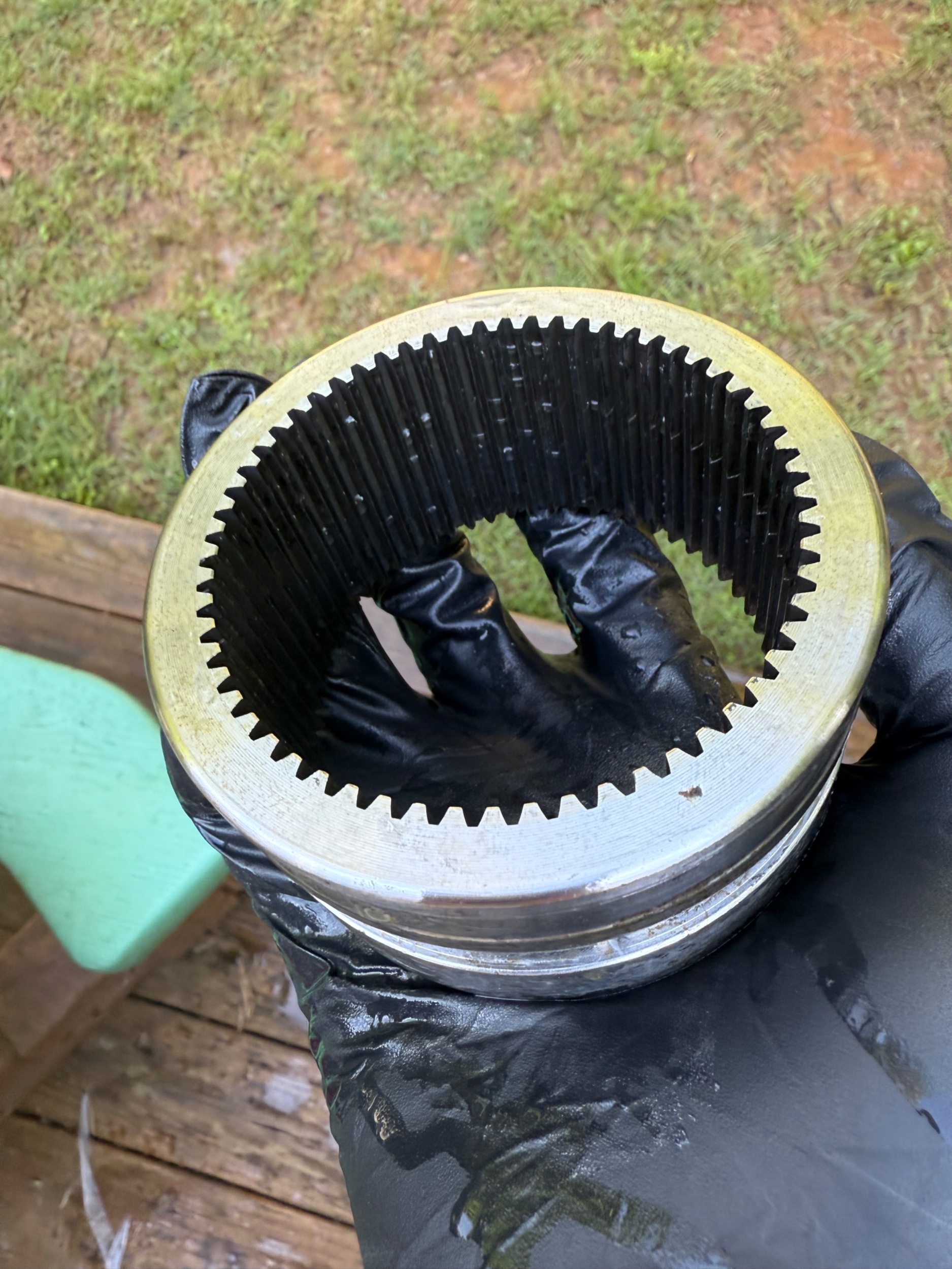

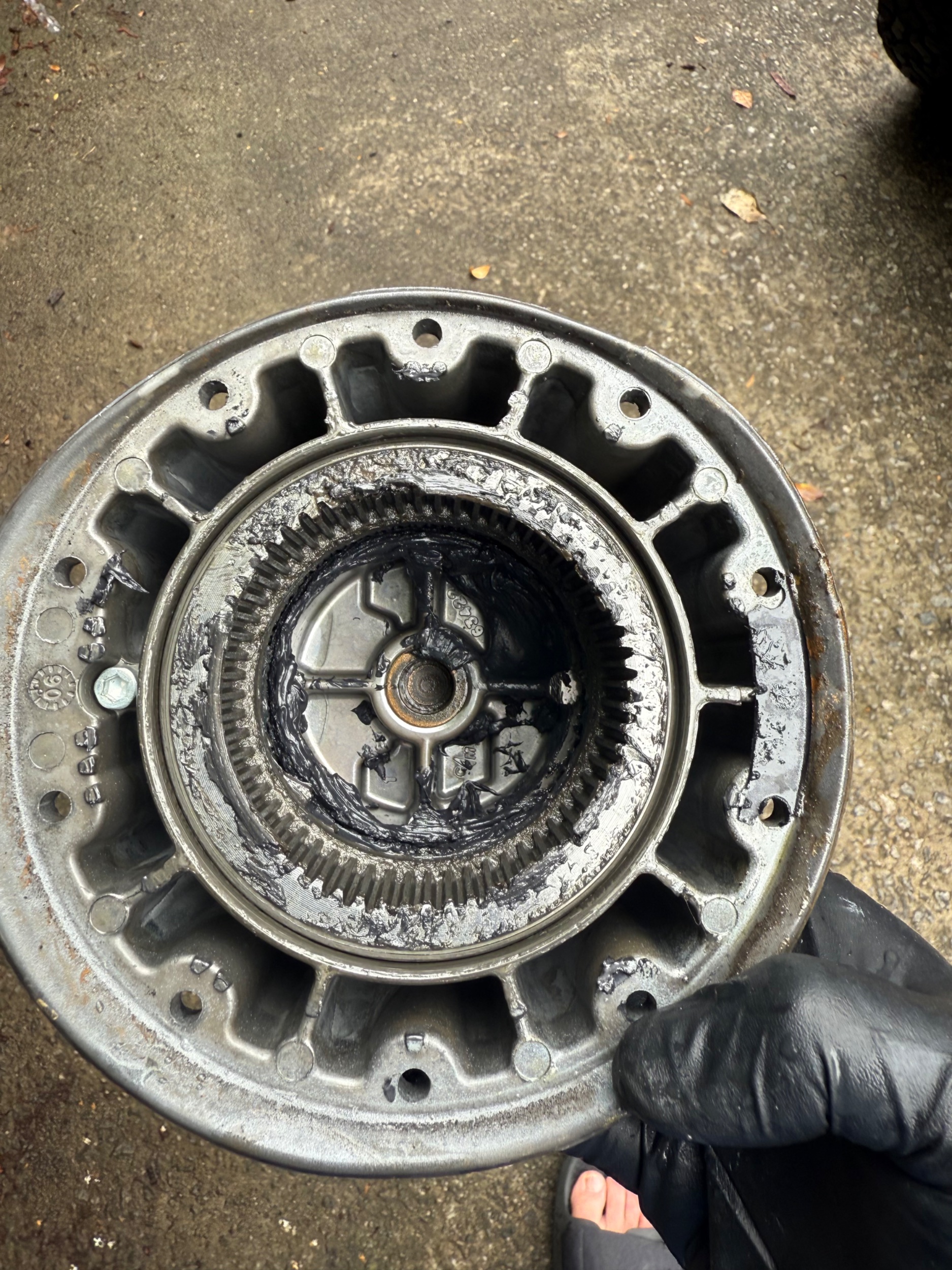

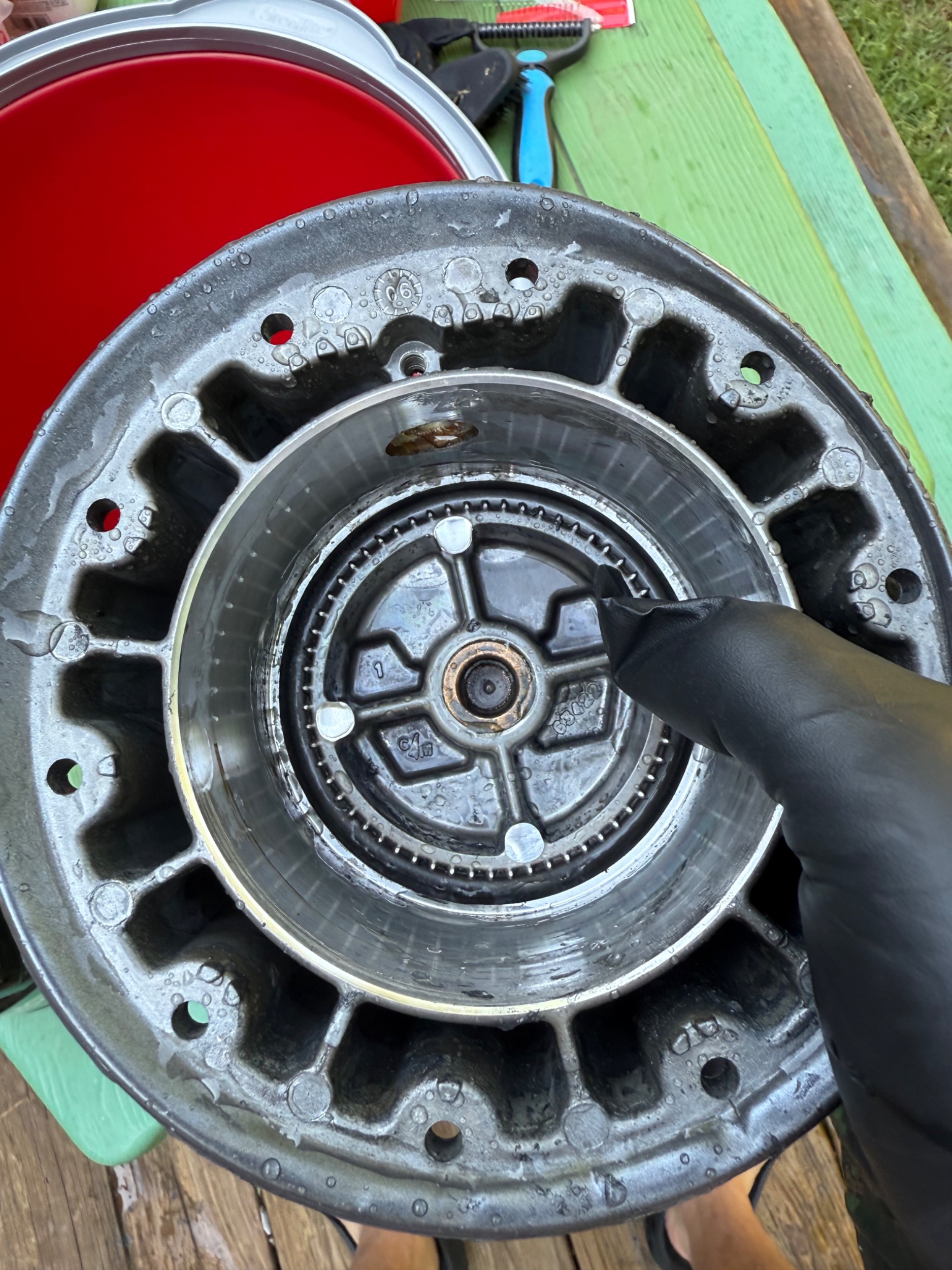

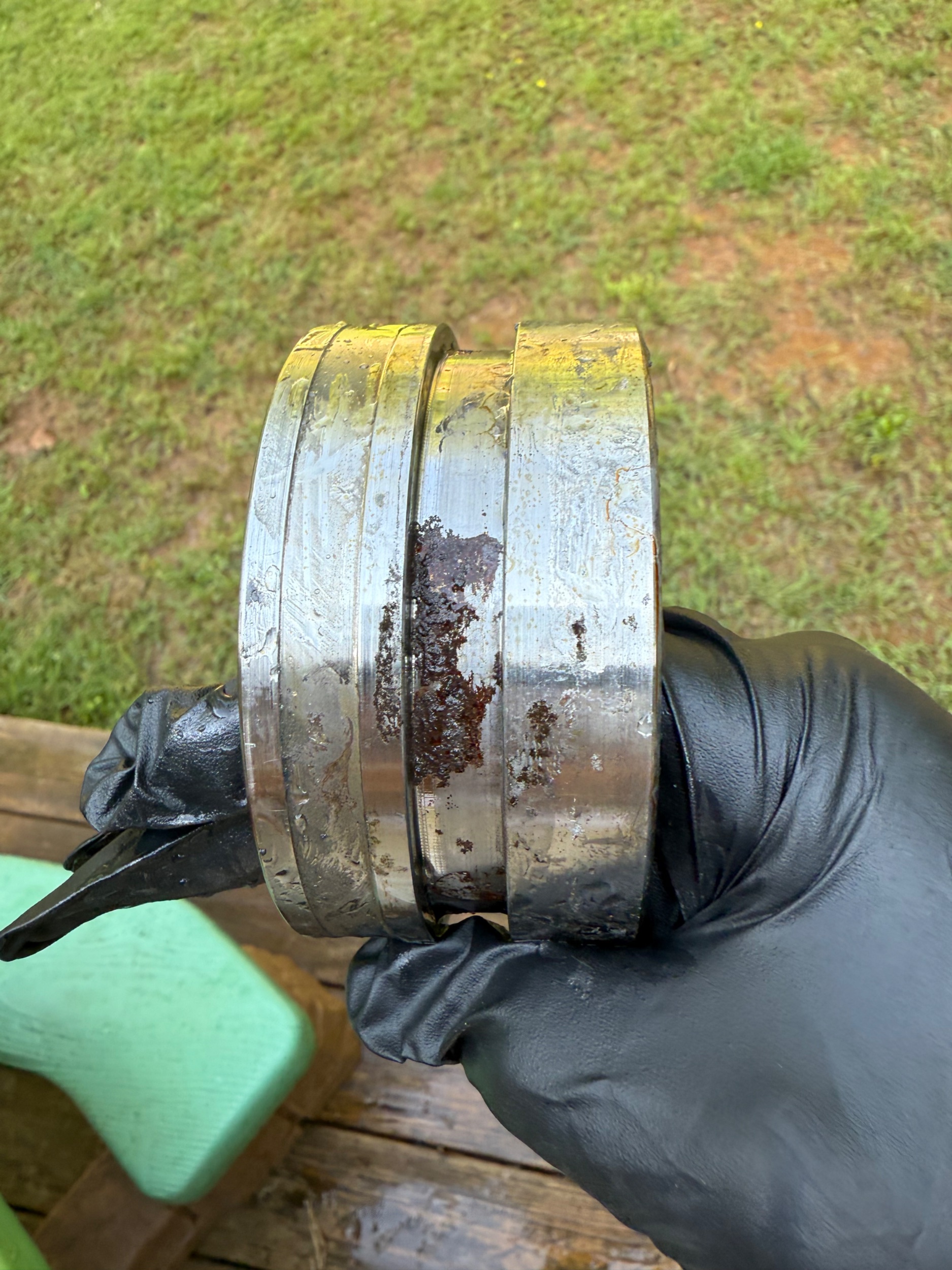

Waiting on parts and grease so I started cleanup. Some buildup and a touch of surface rust on the sliding ring gear, but overall looks pretty good.
Based on how this looks, keep tearing down, or just finish cleaning the gears and repack?
You've got it torn down this far, you're almost there. I'd completely tear it down, there may be other "surprises" awaiting, or even if not, you'll have it all cleaned up and know what you have. Its not that hard to do...

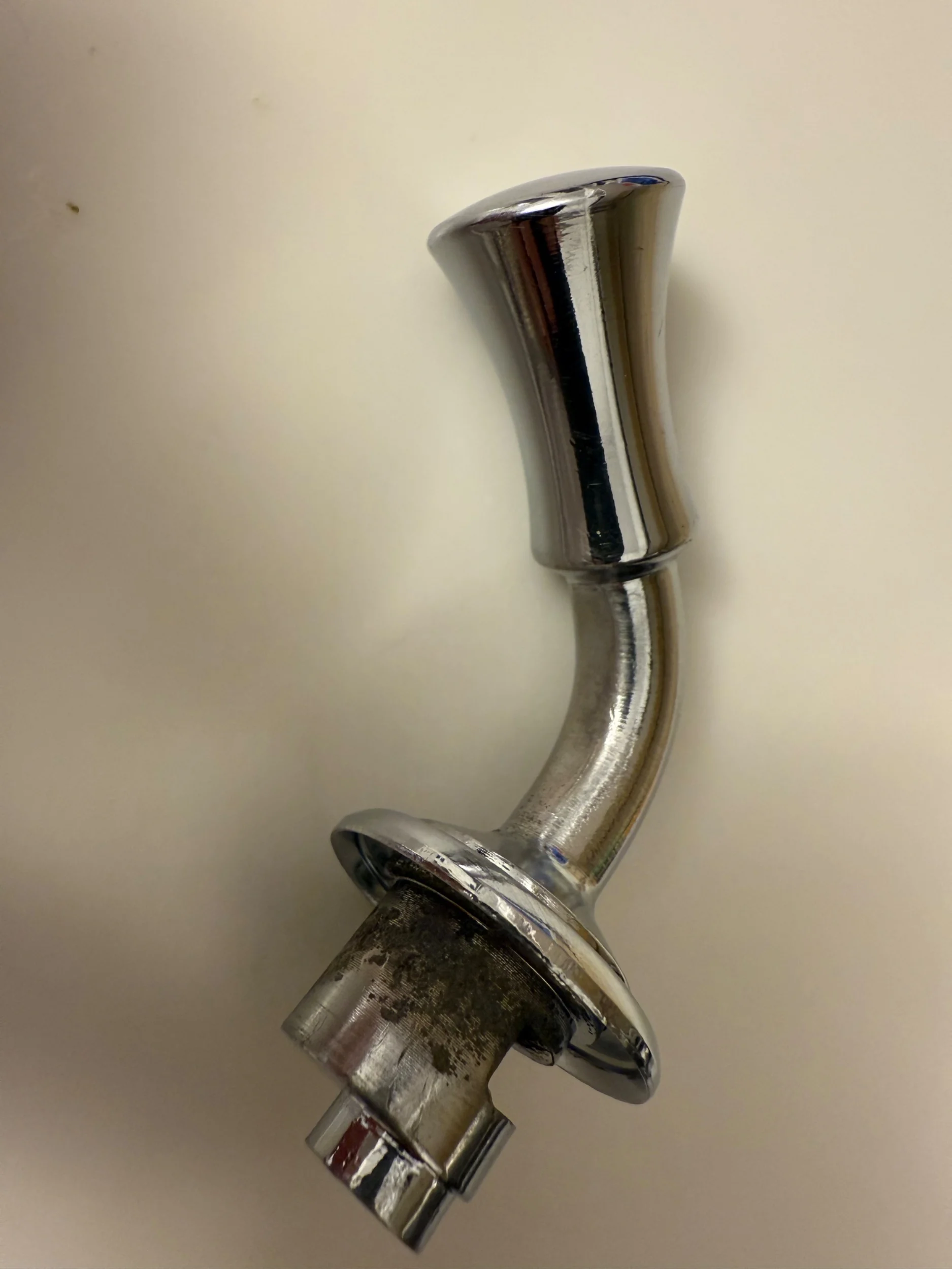

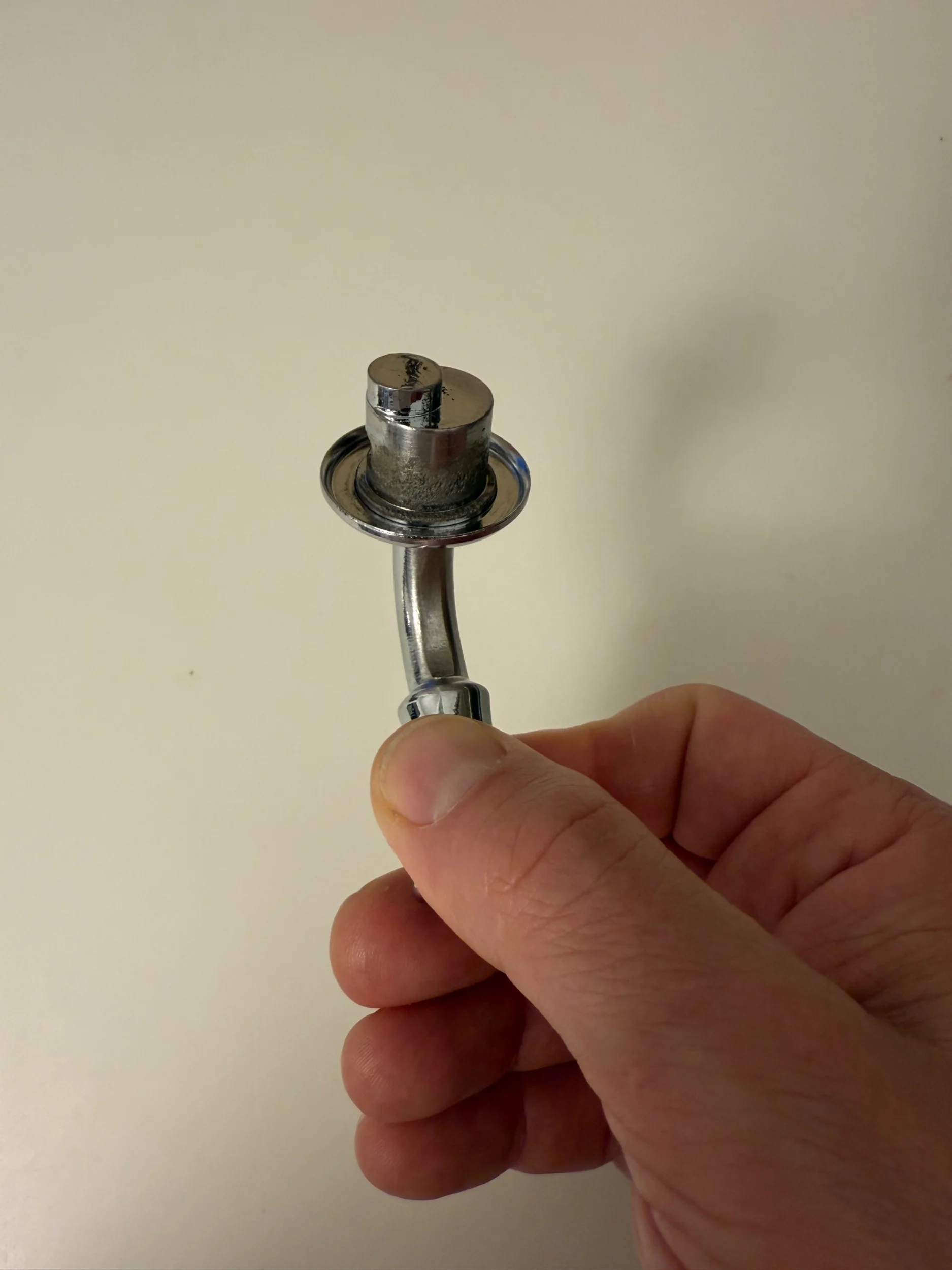

is the new style lever supposed to fit the older 9.5 series? The groove where the set screw rides is in the opposite direction, wanting the lever to rotate towards the winch and it can’t clear the housing, vs the old style which rotates out.
Either way, I like the old style better and it will cleanup just fine.
  • USA Proud
Reactions: John Cooper
Old lever cleaned up nice.

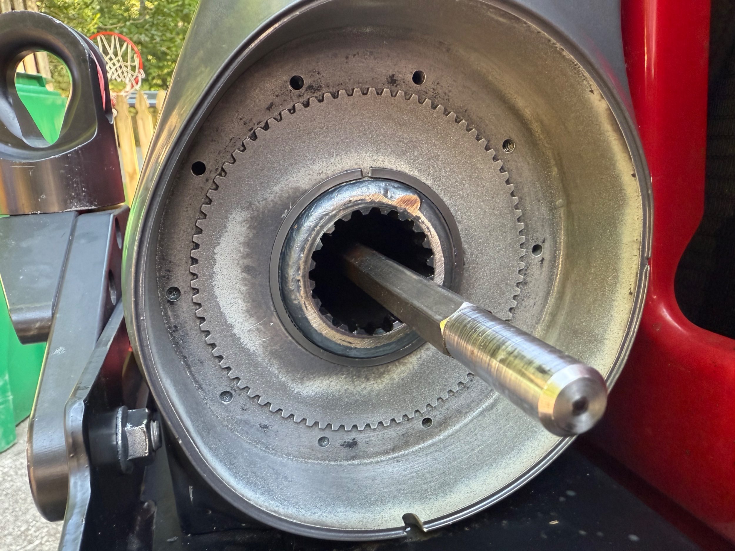

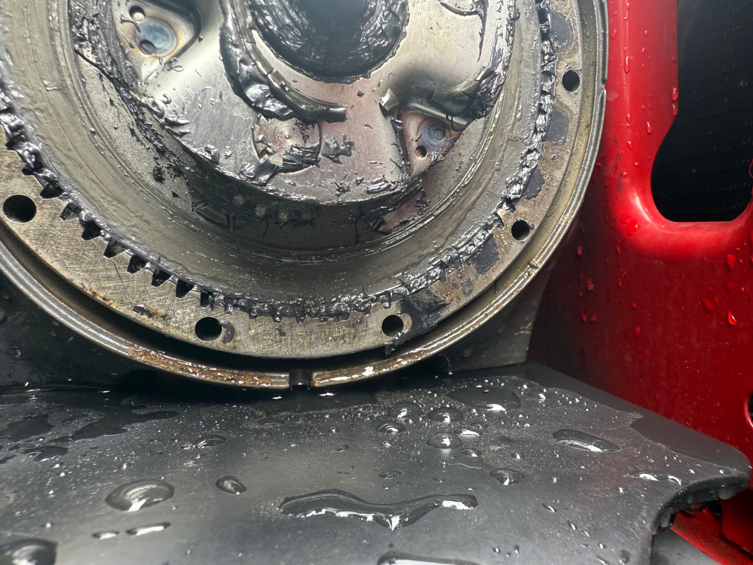

Got the gearbox assembled and did a no tensions spool of the line all the way in. Gears didn’t explode and no strange noises.
FWIW there is still a bit of friction when I have it in free spool and a use the motor but the gears are cleaned and freshly greased. Motor side for another weekend.
