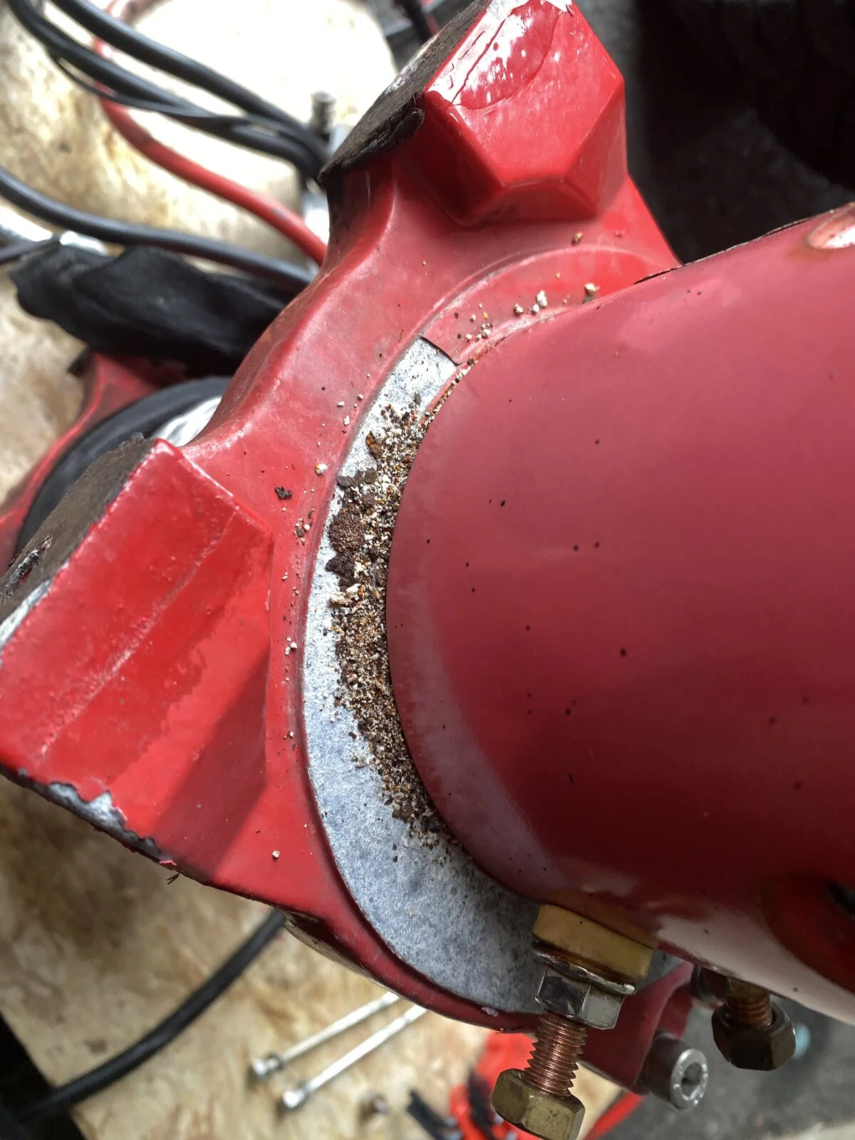

I tried getting the motor off but one of the Phillips head screws in there is nearly stripped, tho manipulating the motor around a lot of crap Maybe dirt or rust flakes were coming out... winch definitely hasn’t been submerged or anything.

Take the motor apart, make certain the brushes move freely and there’s enough spring tension
- especially since you don’t use your winch often, chances are it’s corroded

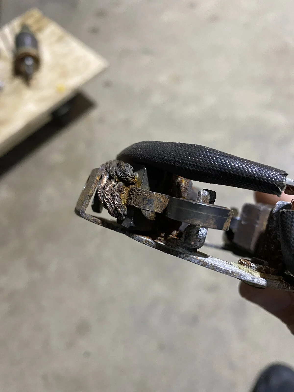

Yup definitely on me, tho I figured they’d be sealed a bit better, oh well live and learn, so brush assembly is bolted to the sides of the motor housing, im assuming you mean free sping for the cylindrical end that goes into the open space of the assembly ?
Any thoughts on reconnecting the wire from the positive terminal ? Not sure where it was connected originally.
Look at your photos from inside the motor housing, there is the other end of your brush terminal wire. If you're looking at $100 for a new motor and you're uncertain about the gearbox health, I'd just get a Harbor Freight 12,000 lb winch with a coupon which puts it at $250 or $300 for the steel cable model. All new everything, add in their 2 year replacement plan and just exchange it every 2 years.

So I got the positive terminal/bolt out, I THINK I found the spot on the brush assembly, dumb question but is this something I can just solder ?
Tried my hand at soldering it, skills are definitely subpar lol, put it all back together a few times, hooked up my jump pack to it, got a quick spark when applying to positive terminal and then nothing. After a few failed attempts into the trash it went and I ordered a new one. Not worth my time or aggravation anymore. I’ll be sure to use it once a month or so to hopefully avoid this issue again.

Probably too dirty to solder.
