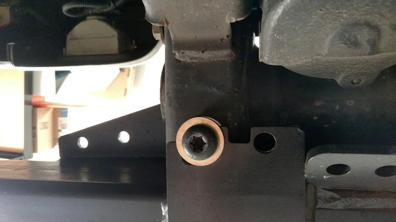

First, let's secure the bumper. I welded caps over the bottom two TORX bolts. The caps were welded to the bumper and the frame. One on each side. This will stop them from removing the bottom two bumper bolts.

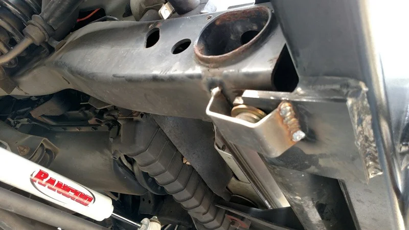

Next I need to block access to the two most forward winch bolts. They have to be blocked enough were not even a swivel can get access to them.
I welded a piece of plate steel to the bottom of the bumper. It extends to the frame blocking access to both bolts.
The welds don't look all that great, but they'll do the job. Now I just need to primer and paint it and she's done.
