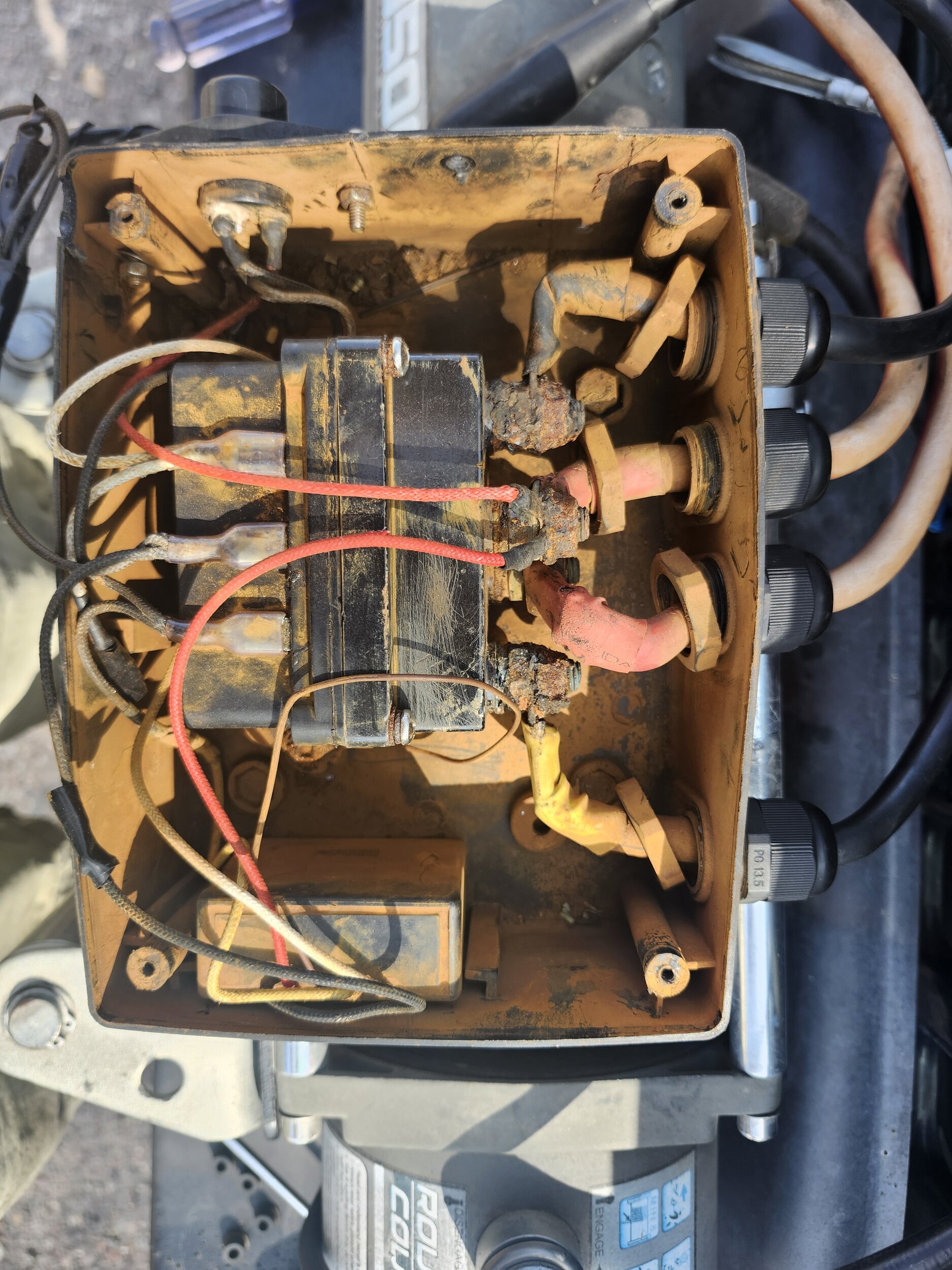

You can test the motor without the solenoid. You can also ohm check the motor. I'd at least pull and inspect the brushes. -Mac

https://www.facebook.com/marketplace/item/9089387724501116/?ref=search&referral_code=null&referral_story_type=post&tracking=browse_serp:6f07f3ba-a0ba-432c-982d-2647ed7887ae https://www.facebook.com/marketplace/item/1026375452255087/?ref=search&referral_code=null&referral_story_type=post&tracking=browse_serp:6f07f3ba-a0ba-432c-982d-2647ed7887ae https://www.facebook.com/marketplace/item/2012831955863254/?ref=search&referral_code=null&referral_story_type=post&tracking=browse_serp:6f07f3ba-a0ba-432c-982d-2647ed7887ae (probably a 30 buck solenoid) No need to spend more than $500 for a great lightly used Warn. Test your motor without solenoid and if works, great. If not you can decide if worth taking apart and learning something or toss and buy a nice Warn. Never too old to learn. D
