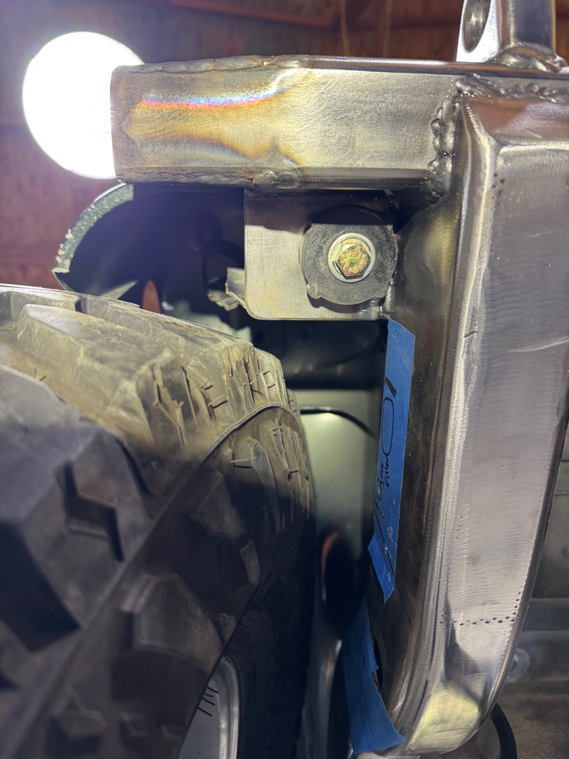

Yep. Blaine said I probably didn’t want to attempt 14” shocks with stock width axles. I think he was right
Stock width, reasonable back spacing at the wheels on 35's, it is going to be tight everywhere that matters. You can mitigate some of the interference problems by leaning the shock at a severe angle to move it further out of the tire shadow, but that creates problems with shock response.
Keeping the tires tucked closer to the body to maintain as narrow of a track width as possible and keeping the rear slightly narrower than the front has more value in scooting through stuff than most will understand.
Lay out your build philosphy and stick to it, the effort will pay big dividends when you get on the trails and you aren't annoyed by a host of little things that are easily dealt with now.
Lastly, I don't think I said you didn't want to attempt it, I just said I won't say it can't be done, you just won't enjoy it.
All of that is more readily apparent now that I’m in the middle of it.
The history of this rig says I suck at that.
Yep. This is hard enough for me.

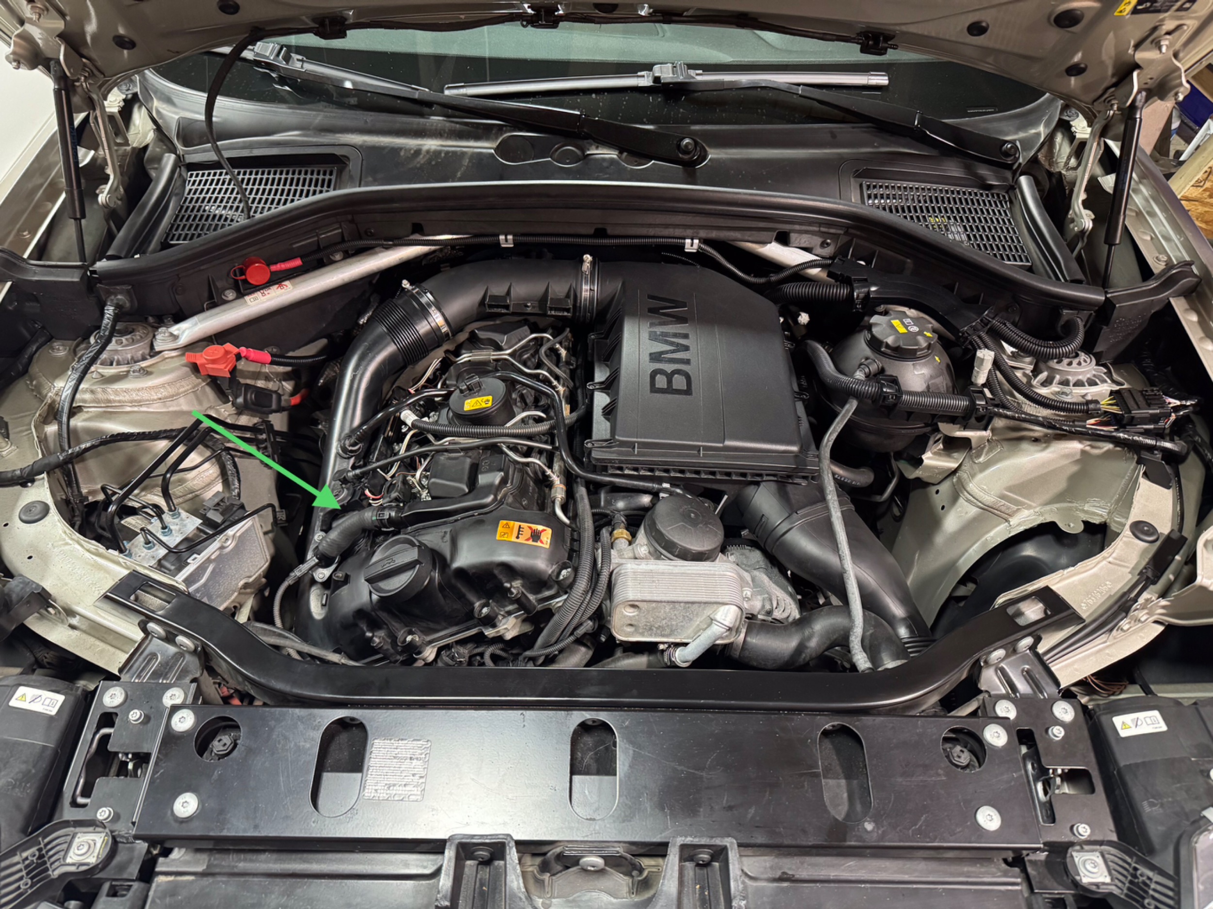

As I mentioned yesterday, no jeep work today. My wife’s 153K mi 2017 BMW X3 has had a developing oil leak for at least a year. I initially noticed some oil coming from somewhere higher in the engine several oil changes ago. It wasn’t enough to drop the level or even hit the floor so, since I didn’t easily see the source, I watched and waited for it to declare itself. It ultimately did. A couple of weeks ago, a burning oil smell began to be noticeable, suggesting oil hitting the exhaust. Another look still wasn’t immediately revealing (here’s the N55 3.0 turbo 6 with the cover off):
I’ll talk about the yellow arrow in a sec but you can see how much stuff on top of the engine needs to move to pull the valve cover. It is leaned over to passenger with that being the hot side. The internet said valve cover gasket leaks are fairly common in aged N55s and that made sense since it would dump oil on the exhaust manifold and turbo. I don’t have a good pic but it seemed like there was some seepage at least in the area. So I ordered an OEM gasket set (only $43, if you can believe that). 2 hours in, here’s the cover off:
The red arrow shows the low side with oil pretty much covering the head outside the gasket (and draining down to the exhaust manifold and turbo). I was feeling good about my diagnosis at this point.
Now back to the yellow arrow in the first pic. There were about a million electrical connectors and vacuum lines plus the fuel rail and coil packs to remove. This is not my first rodeo so I knew something, or multiple somethings would break on this old thing, no matter how careful I was. Fortunately, the only casualty was a breather from the intake to the valve cover. VERY brittle.
But, no matter, a little 3/4” hose fixed the issue.
And its all back together. No oil or gas leaks. No codes. I warmed it up and then changed the oil. I’ll leave the engine cover off for a few days while I monitor for fuel or oil leaks and any other issues.
