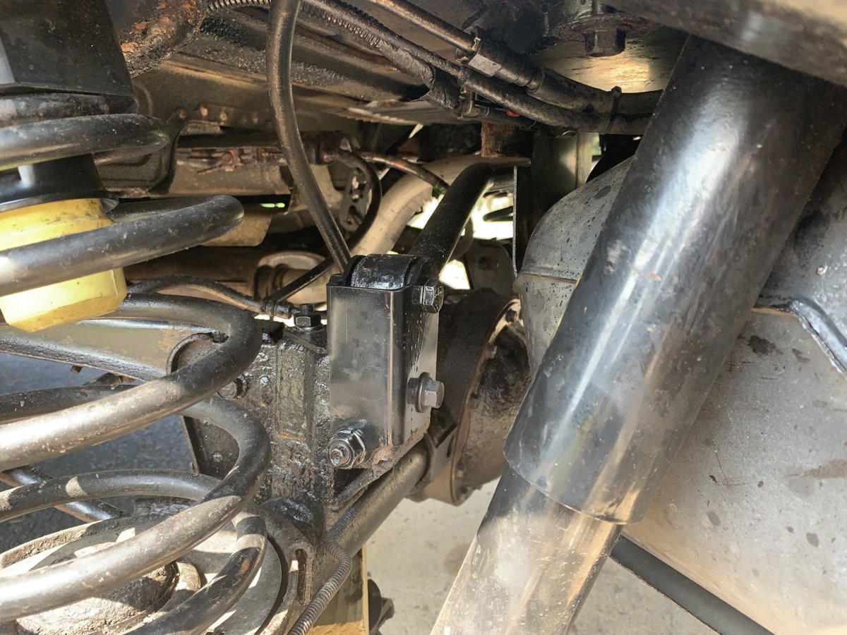

After my Drummond Island Trip I had three issues with the jeep. My sway bar link broke. (I put a new one in, drivers side, right after I left Drummond)
