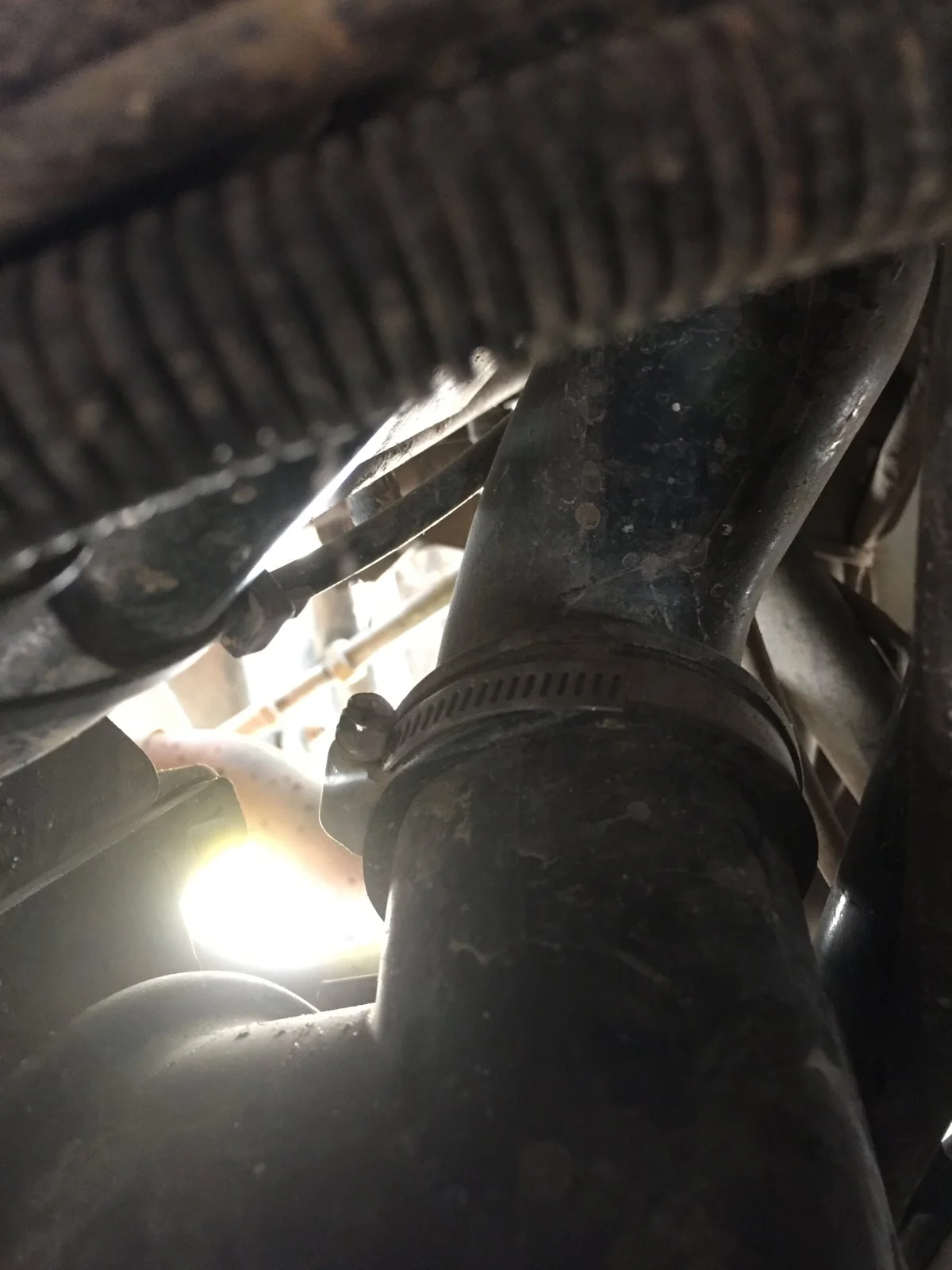

YES. And every step feels that way to me because I don’t know the basics. So then I text Dave and have to wait till he’s not busy at work to tell me the answer. Or like @Drizit said, go online to find the answer.which has been helpful. My saving grace is bit by bit I retain more and more and now know some tool basics. But my gosh, how many tools for different stuff is there? It’s seems like a conspiracy. Let’s make some new type of fastener so we then can sell the new tool to remove it . Lol. Example below.
It looks so simple. But nope. You need some special tool that looks like a screwdriver but isn’t and not sure where Dave’s are . Plus I can’t get anything in there longer than an inch due to the space I have. After what seemed like eternity using the head of of a detachable screwdriver and killing my hand I was able to loosen it just enough to think I could get it off. Nope. That waited for Dave to get home and of course he got it off in a couple minutes. He did agree it was a pain which helped a bit :). Thanks for the support.

for those hose clamps, get your self a small 1/4 drive ratchet and use a socket, much easier than getting a screw driver on them. be careful not to strip them if using the socket to tighten them, very easy to over torque, just a little past snug will do.

Yes, that was one of the suggestions Dave had, but I didn’t know what a 1/4 drive ratchet was so thought my idea was better. Not so much. Thanks!
1/4 inch drive refers to the square that the socket attaches to. If you have a look at your ratchets you will notice the square parts are of different size (most likely, most people who wrench have an assortment). 3/8ths drive is your standard and most typical size, they also come in 1/2", 3/4" and 1" drive. 3/4" and 1" drives are more common when working on heavy equipment.

Love it! Thank you. Now I know and can wrap my head around that. Problem is Dave has like 5 or more of each size and extensions and adapters and on and on, makes my head spin. I’m starting to get my own tools so I can know what and where they are.
