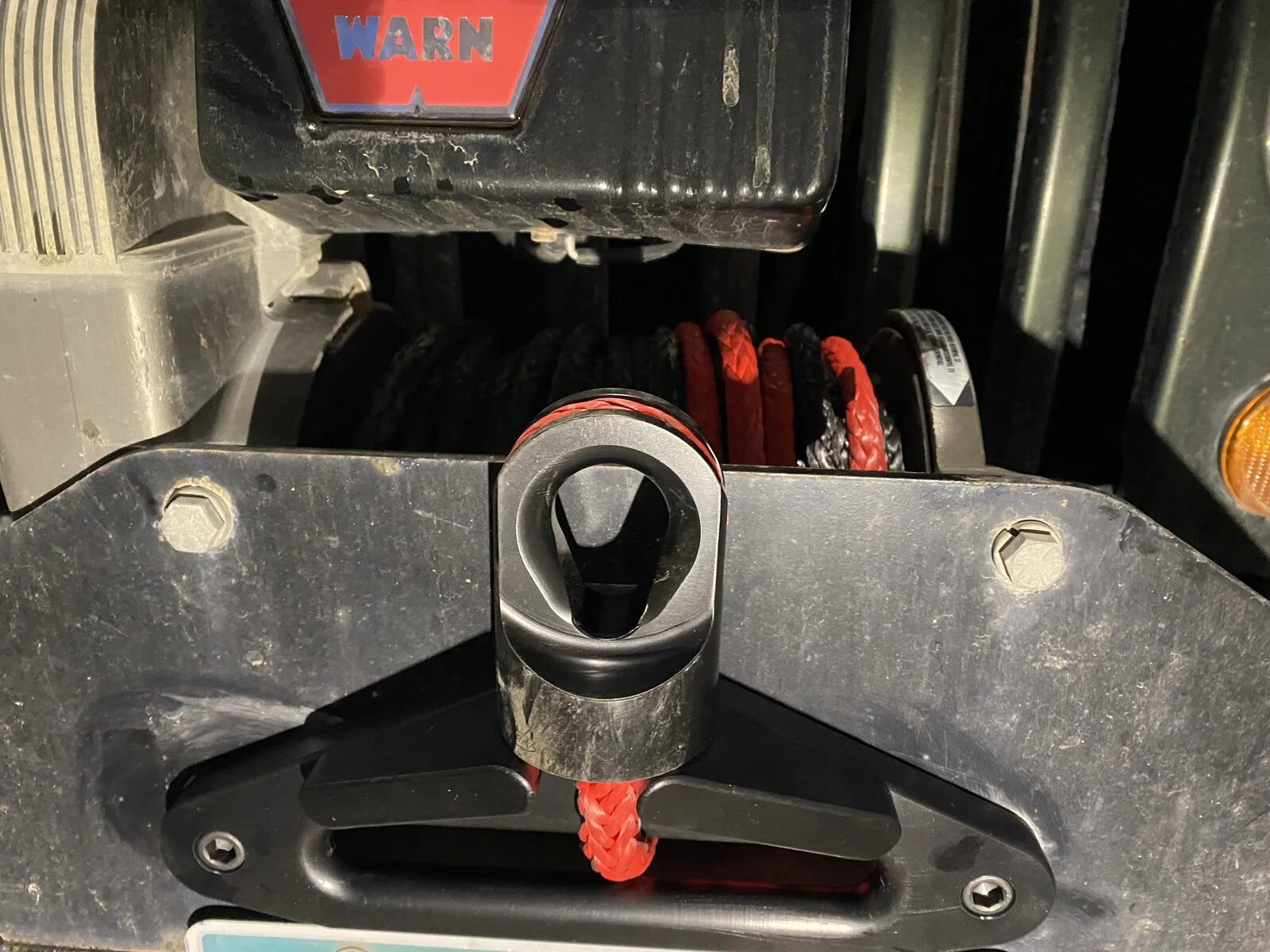

I was told my teaser pic was too subtle so hopefully this helps.
Your eyes are not deceiving you. That is a dual color line. I have been working with Blaine to bring to market an 8274 specific winch line that met what specifications I wanted in a line and like Blaine at as best a value as possible. They are in production as we speak but still a good five weeks before they are available. I will be making an official announcement both here and on my Facebook page https://www.facebook.com/profile.php?id=100083479955171&mibextid=haYZDX
once I have available to ship out.

Fucking magicians is what they are.

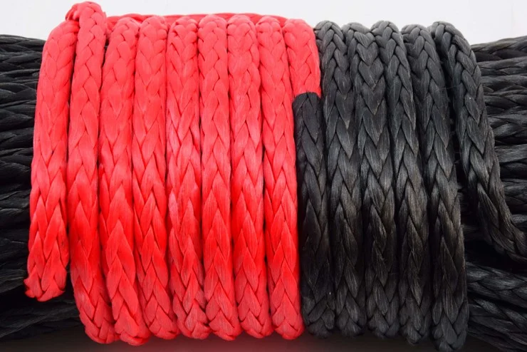

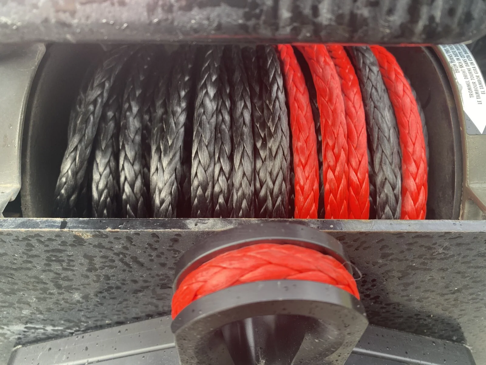

For a better idea of just how good the red color is,
That would be handy at the drum end of every winck rope
Maybe and there are ropes out there that have done things at the drum end that often times do not work well. The sleeve Warn does to their line is one, it just adds a significant amount of bulk on an already crowded drum. IMO for the 8274 it is not needed at the drum end as the in drum anchoring is so strong that you have to do something pretty ridiculous for it to be an issue. The dual color does add additional cost to the line that I think could be avoided by doing something as simple as adding a marker with a short length of bright colored tape or heat shrink at the point where you come to the first layer on the drum.
The reason I am going with the expense of the dual color for the 8274 line is to provide additional situational awareness when spooling in. With a no load speed of 73 feet per minute stock and over 100 feet with just some minor mods they have a significant amount of run on that can be a problem if not maintaining awareness.

Why did you want the color transition?
Other end. He explained it. With the higher speeds of the hot rodded 8274, there is a lot of wind in after you let go of the button. The red serves as a warning to get off of the button.
This. If you have followed my 8.7ak build you will see that while I despise the nylon tube chafe guards I left a section on my line near the eye to serve as an indicator to let off the switch so the run on did not try to bury the thimble into the fairlead. So going with the dual color gives me that visual indicator that is permanent to the line but not something that increases bulk or gets in the way.
