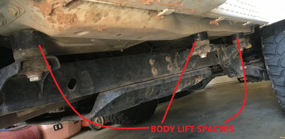

BUT 1.5" of suspension lift is not enough for 33" tires. Do you know if there is also a body lift installed, which would be additional spacers placed between the frame and body? For 33" tires the usual recommendation is 4" of additional clearance for the tires which is commonly created with a 3" suspension lift and a 1" to 1.25" body lift.

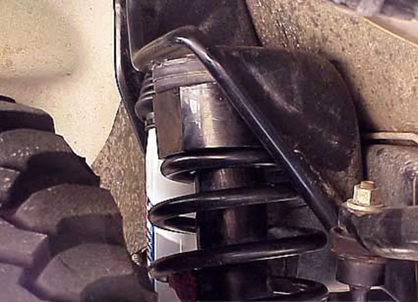

Measure your front and rear spring heights with the Jeep sitting on the ground. Stock front springs are 12" tall and rear are 8" tall. Any more than that is suspension lift height. For example a 1.5" suspension lift would make the fronts 13.5" tall and the rears 9.5" tall.
Does it have either of these?

There is no body lift.
Front springs measure 13.5" (including spacer)
