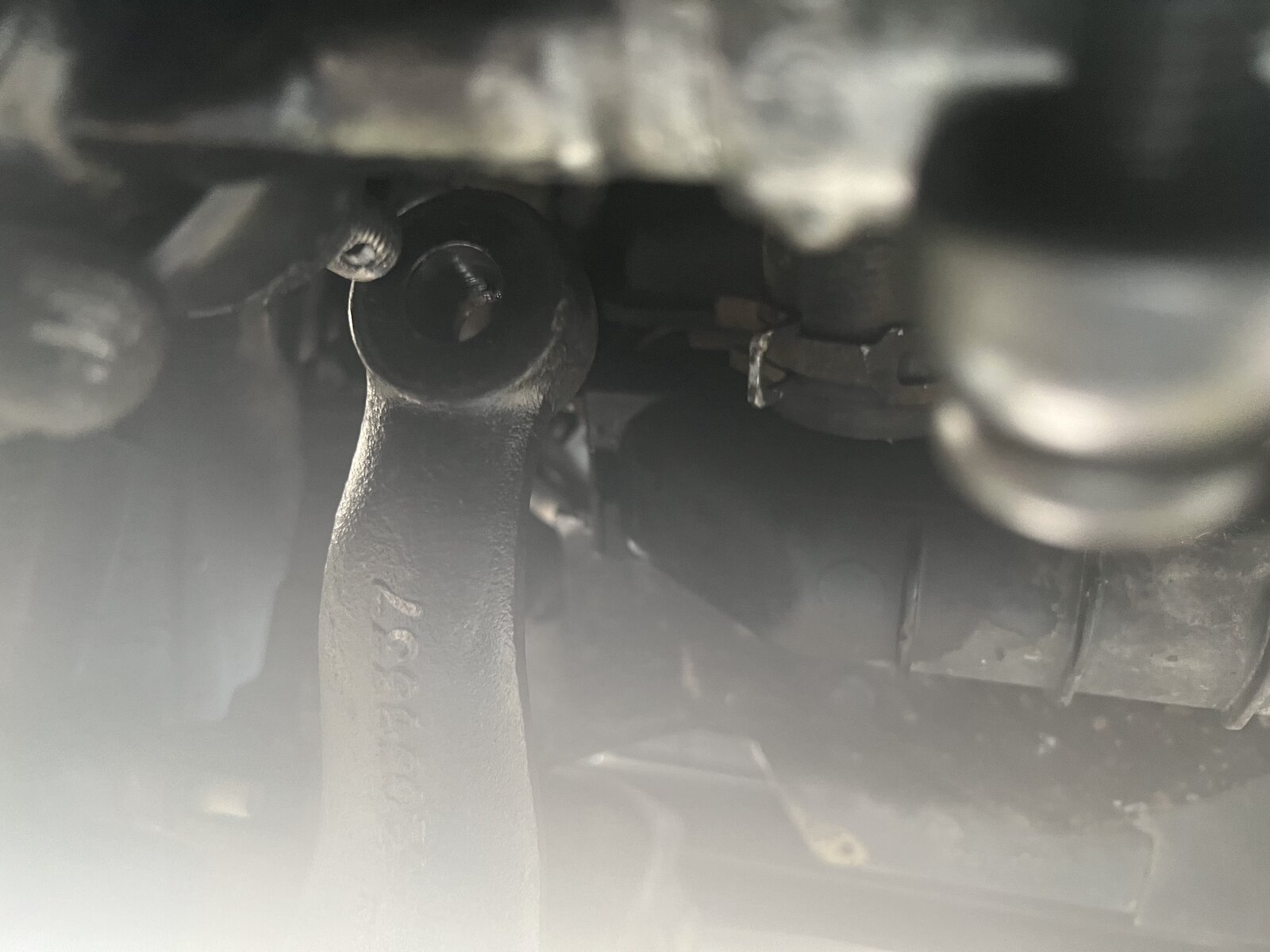

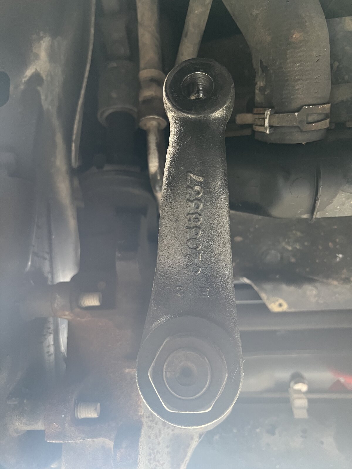

Not the most mechanically inclined but I started installing the an steering parts to replace my stock TJ steering.
It’s gone mostly smoothly but I can’t get the tie rod off the drag link into the pitman arm. The adjusting sleeve is down the drag link as far as it will go and the tie rod is in the sleeve as far as it will go.
I banged on the pitman arm pretty good to help pop the old tie rod off. Don’t know if I moved it a bit off center?
I know this is pretty low level but I appreciate any help. Thank you

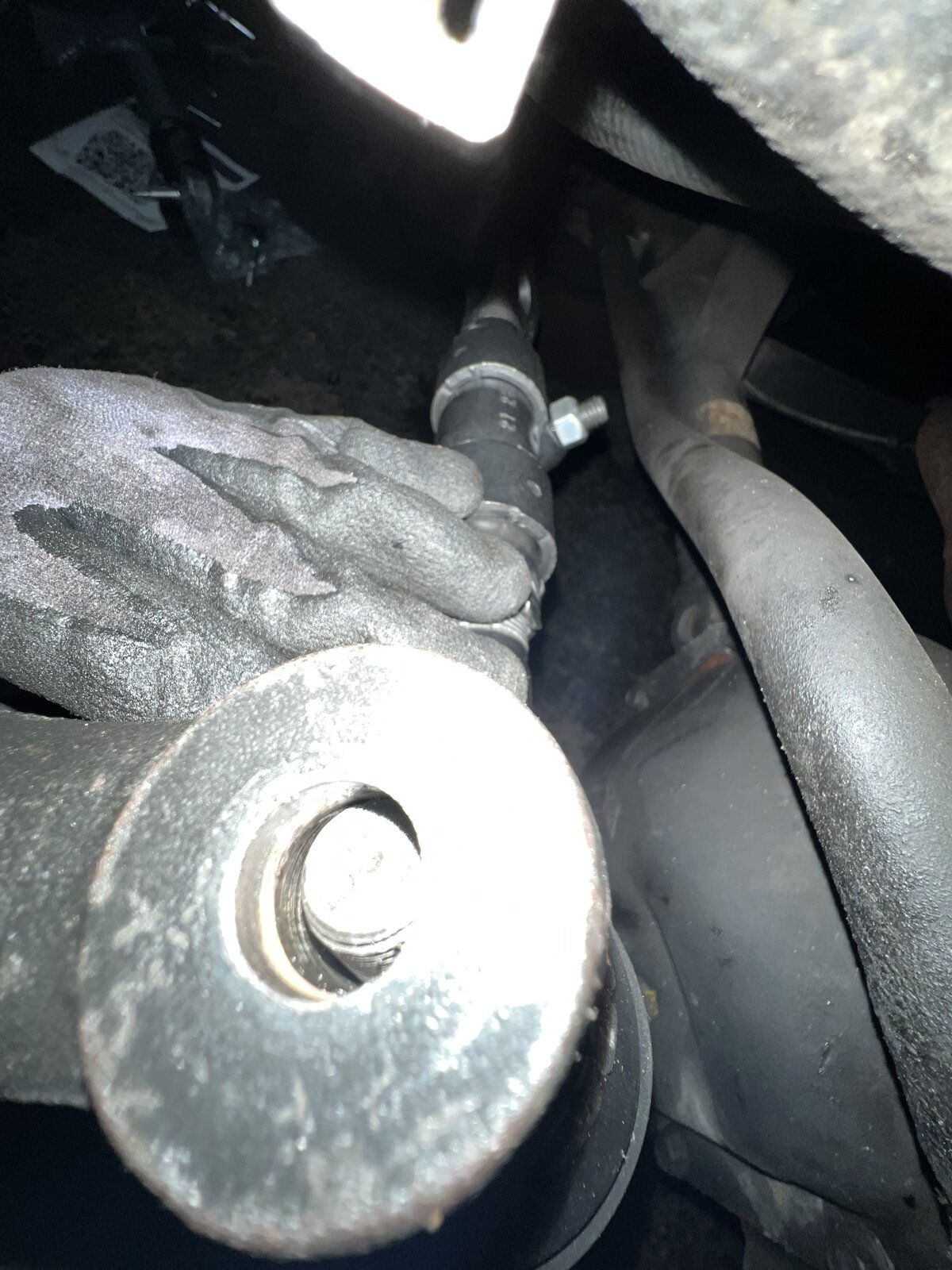

Apologies, but I am not following.
The drag link is disconnected from the pitman arm in the picture.
If you’re saying you can separate the Drag Link and Tie Rod?
Are you replacing just the tie rod? Or the tie rod and Drag Link? (drag link is the same TJ and ZJ).
If you’re replacing just the tie rod, then why did your disconnect from the Pitman?
If you’re trying to separate the drag link and tie rod, loosen the castle nut so you don’t swell the bolt. And use a hammer and knock it out.
I am replacing everything. I have pulled all stock parts off. I measured out and put the new parts together.
I installed the passenger side tie rod. Now I’m trying to put the new tie rod back into the pitman arm. The tie rod is too far to the drivers side and won’t go into the hole. If I bend the joint in it will go in crooked but gets caught.
Okay, following now.
I did the full ZJ, then a full Currectlync, in both situations, I pulled and measured and started same distances.
If you did anything close to that, then you just need to work it to get it in correct. The angles are weird, it fits with the bolt bent a certain way, just have to find that, at least for me.
