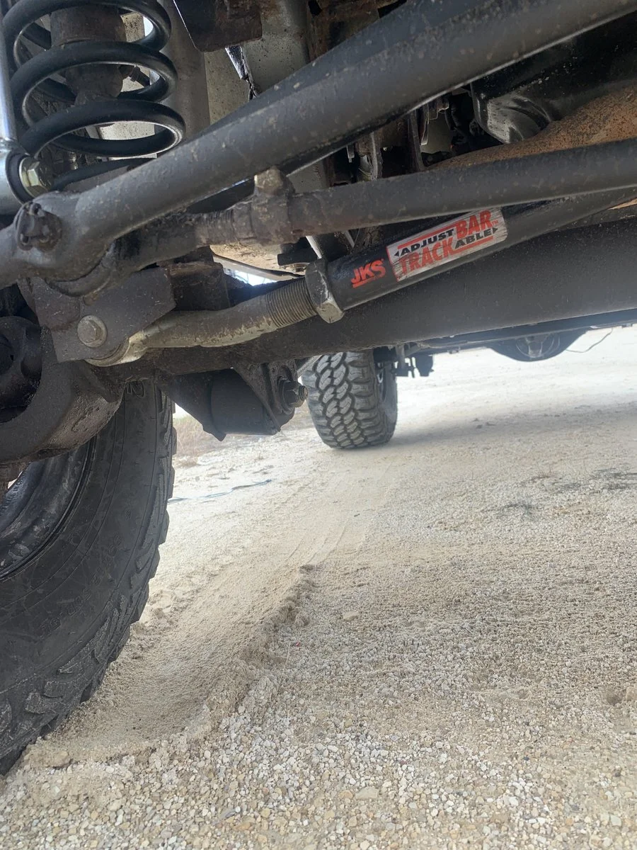

Can you show me which JKS track bar you are using? Theres a few different ones with varying degrees of lift depending on lift...not sure since the zone is only 3" suspension and 1.25 body which jks track bar to get...some say 2.5+, some are 4", idk, im a little confused....
I got the one listed for 1-3.5 inches of lift. It has worked great for me. Good luck with the lift, I have been really happy with this thus far.
