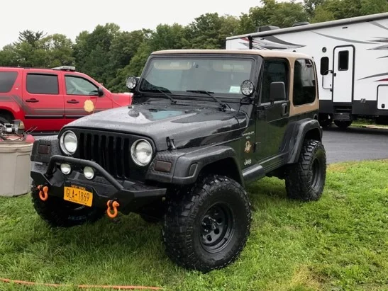

Here is how she looked when I got it:
I know some might object, but I hate the smoked signal light look, particularly when next to the chrome headlight bezels.
The KC lights are nice though, although the wiring job was terrible. Twisted wires with electrical tape wasn't going to work. The previous owner had spots and fogs running off same relay and a switch drilled into the panel below the steering column. I wired the fogs back up to the factory switch but a new circuit because the old fog wires were cut off. I also bought one of the vent switch setups and wired the spotters there. I have an empty switch for a future upgrade, maybe a winch (do people run them on a separate switch?) or a light bar (my son wants one because they are "cool").

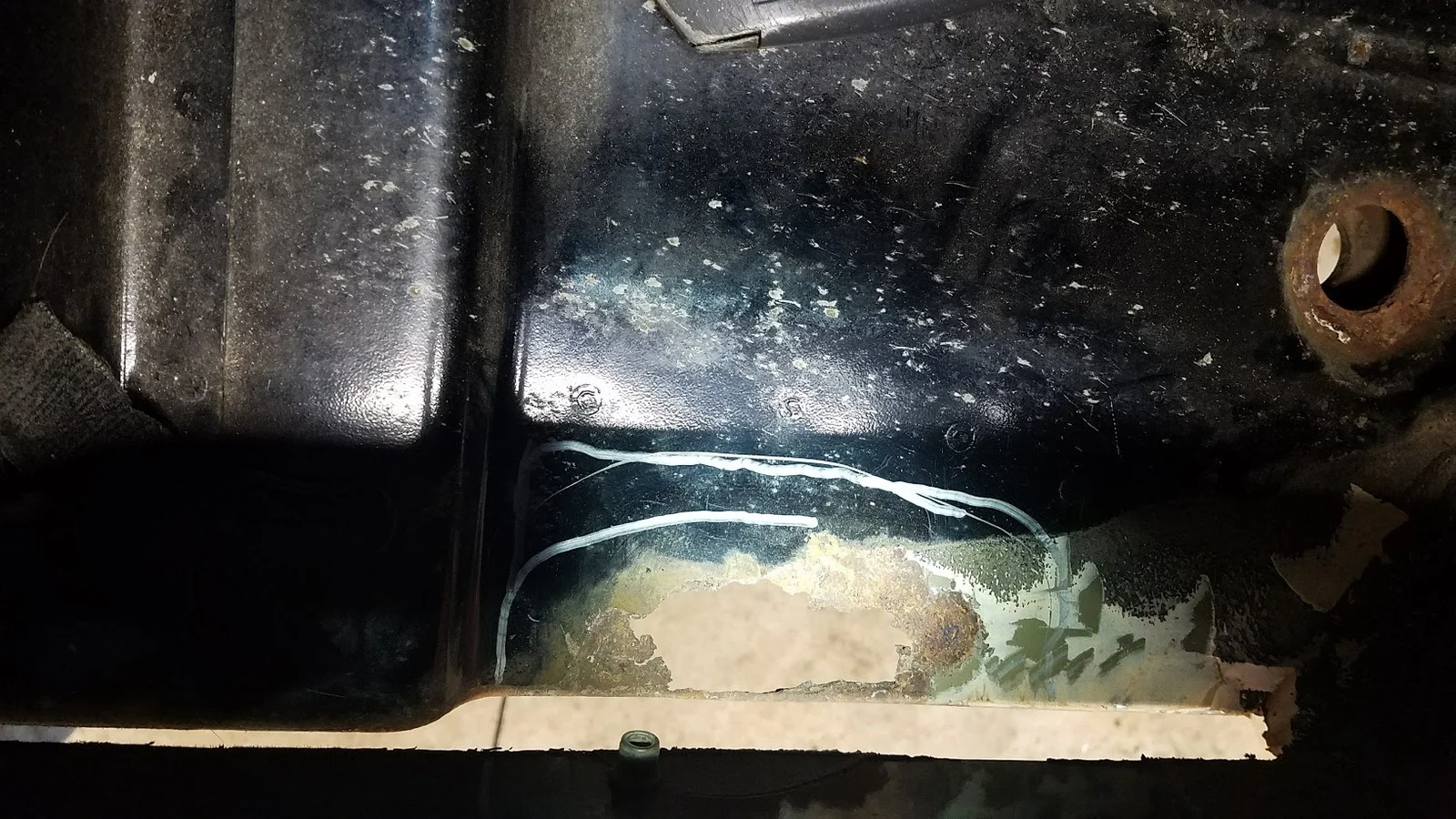

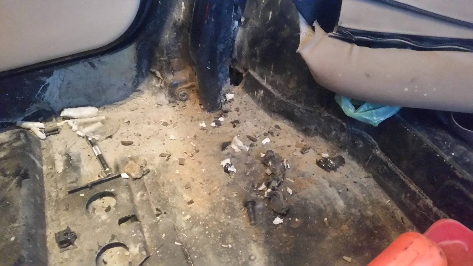

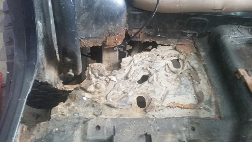

As I said earlier, we are starting on the floors now. As you can see, they are in really bad shape, compounded by the fact that the previous owner used every possible compound available to cover the rust, instead of removing it and fixing it correctly. I had to remove bondo, fiberglass (which wasn't mixed correctly so it never hardened completely, thank god), roof tar and silicone. Yuck!
Before:
After hours of removal:

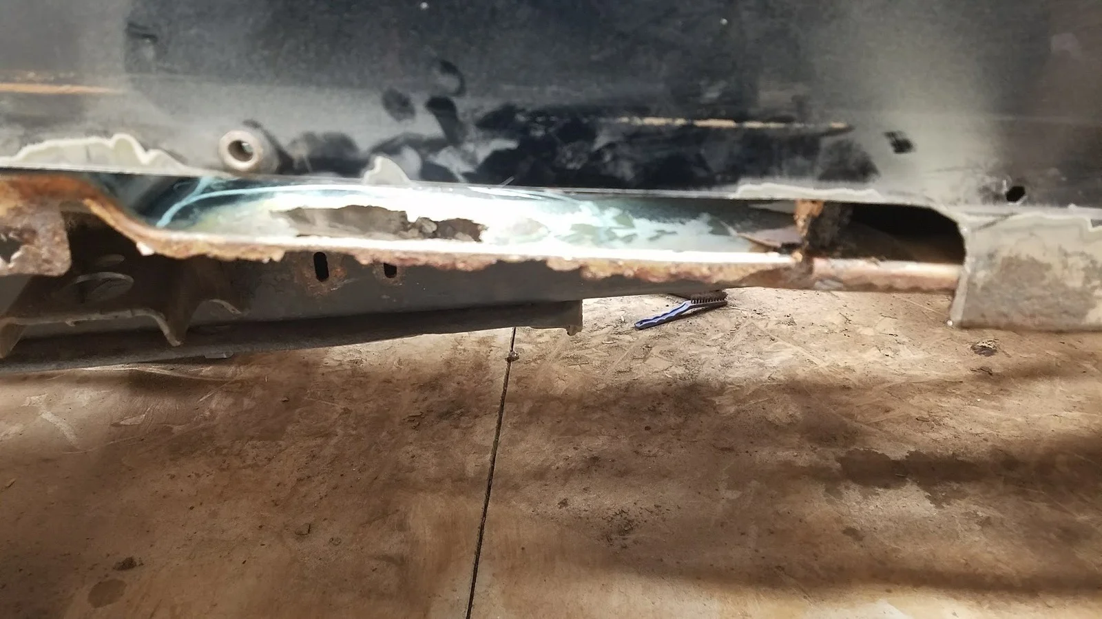

Yes, the bottom of the roll bar was trapped between the factory floor and the crappy repair and it completely rotted off. Luckily I was able to find used replacement feet to be welded on to the roll bar.

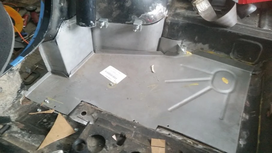

This is how it looked after this weekend:
Ignore the gaps between the parts, everything is a tight fit, just not aligned perfectly in this pic. Finished the evening by removing the gas tank before I tackle the driver's side.

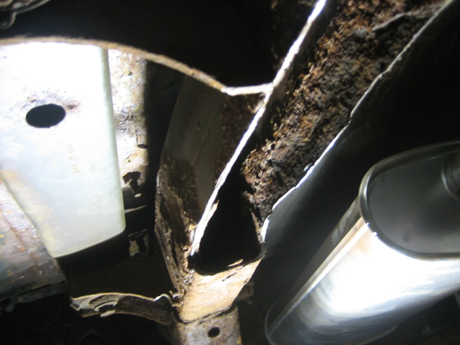

Keep at it.I thought I was the only one taking on a rusty 2000 tj.I started in the middle of dec and just finished crawling out from under it.I was new to jeeps and never took someone with me to check it out. It looked fine at first glance but after realizing the skid plate was rusted on I almost got sick to my stomach. I cut it open and made up chanels to repair it.I got off the gas tank before welding and replaced the straps and tank skid plate before reinstalling the tank. Had to replace all the brake lines and brake hoses. I used eastwoods frame internal coating and then there frame coating on the outside. Finally out from underneath and on to the front fenders I took off. The one front floor was boggeled also. Got new floor pans and hope to be done end of this month. It has been at least 3 times a week for 3 -6 hrs since dec 15th.I am seeing the light at the end of the tunnel finally. I almost wore my creeper out. I got a full 5 gallon pail of rust out of that jeep.Try to keep sane and don't give up.Just walk away when it gets too rough to continue.

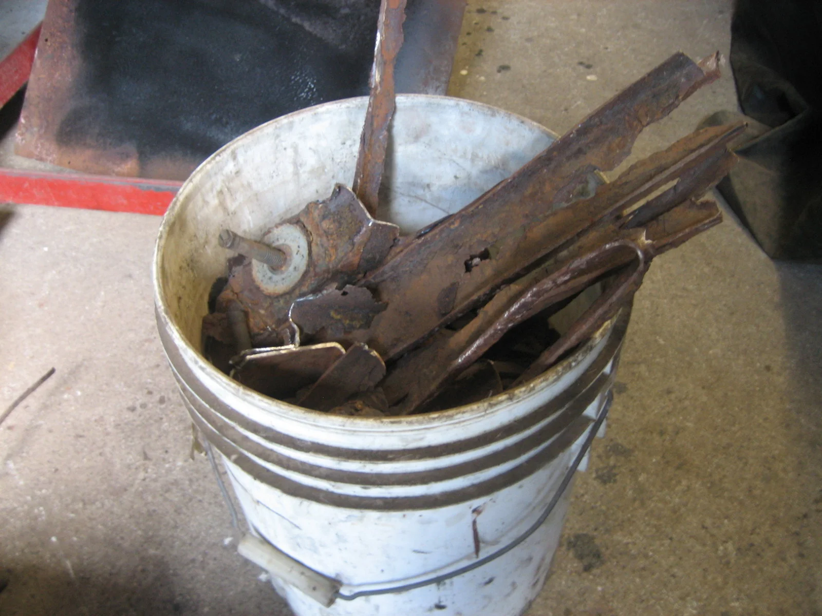

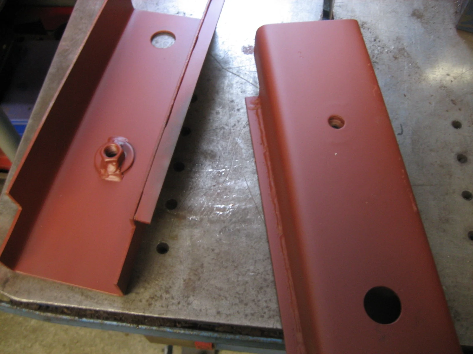

Never posted any pics before.Rust from jeep in 5 gallon pail plus a lot in my shopvac.mount brackets I made for the centre mount and frame after I cut it opened and almost puked.I read your jeep rebuild ranger bob.You do have staying power I give you that.
