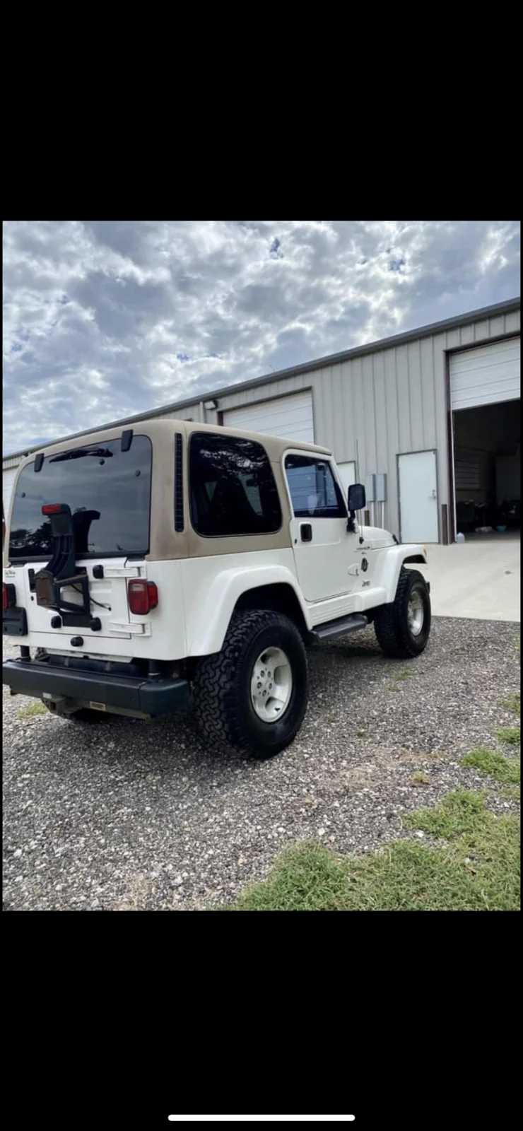

Here are a few pics from the listing when I bought it:
It desperately needed some TLC but everything mechanically was in great shape and it was rust free!

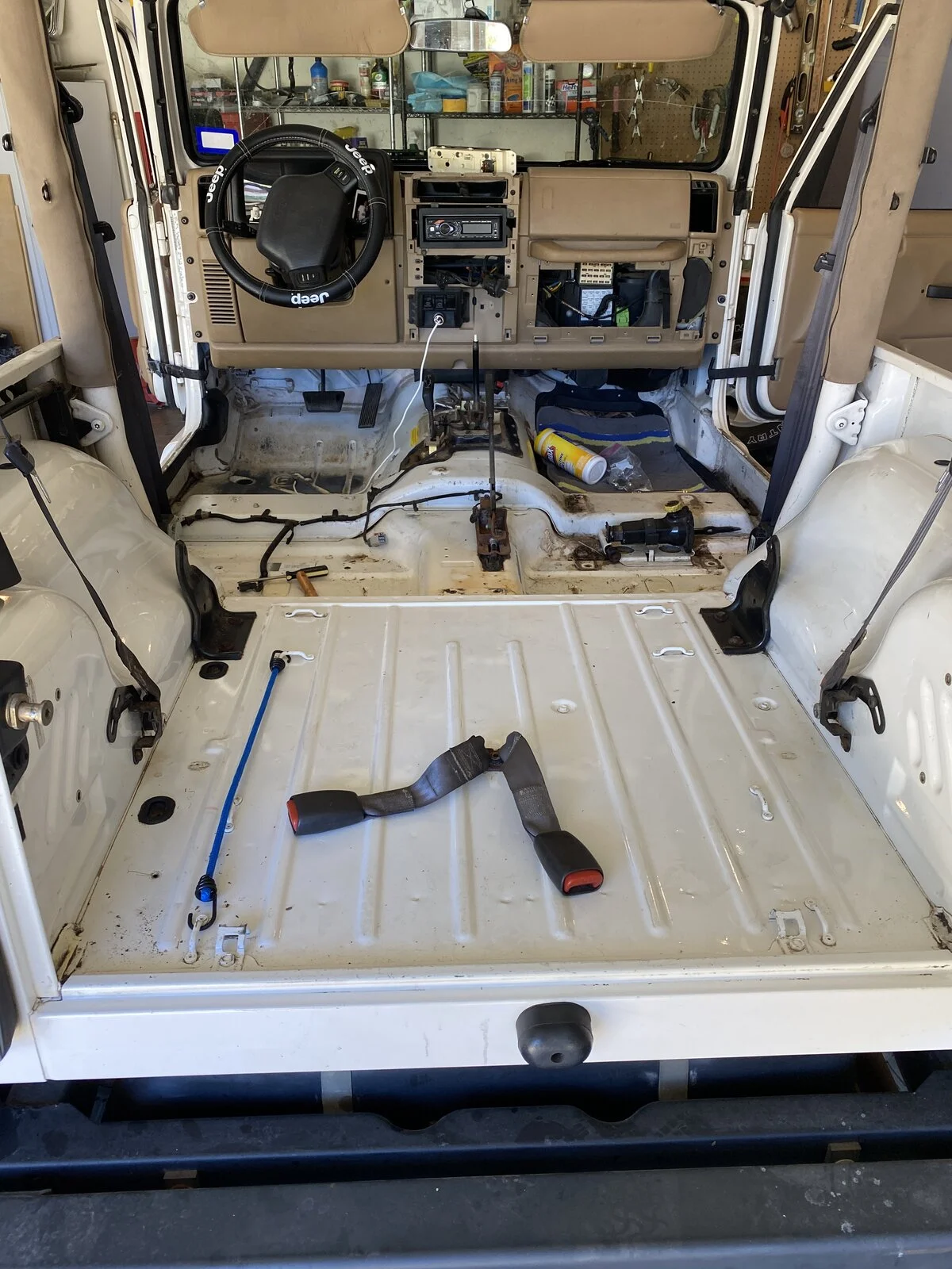

First thing to was give the interior a deep clean because it was FILTHY when I got it. This was after an entire morning of cleaning. You can still see it's pretty dirty even after that.

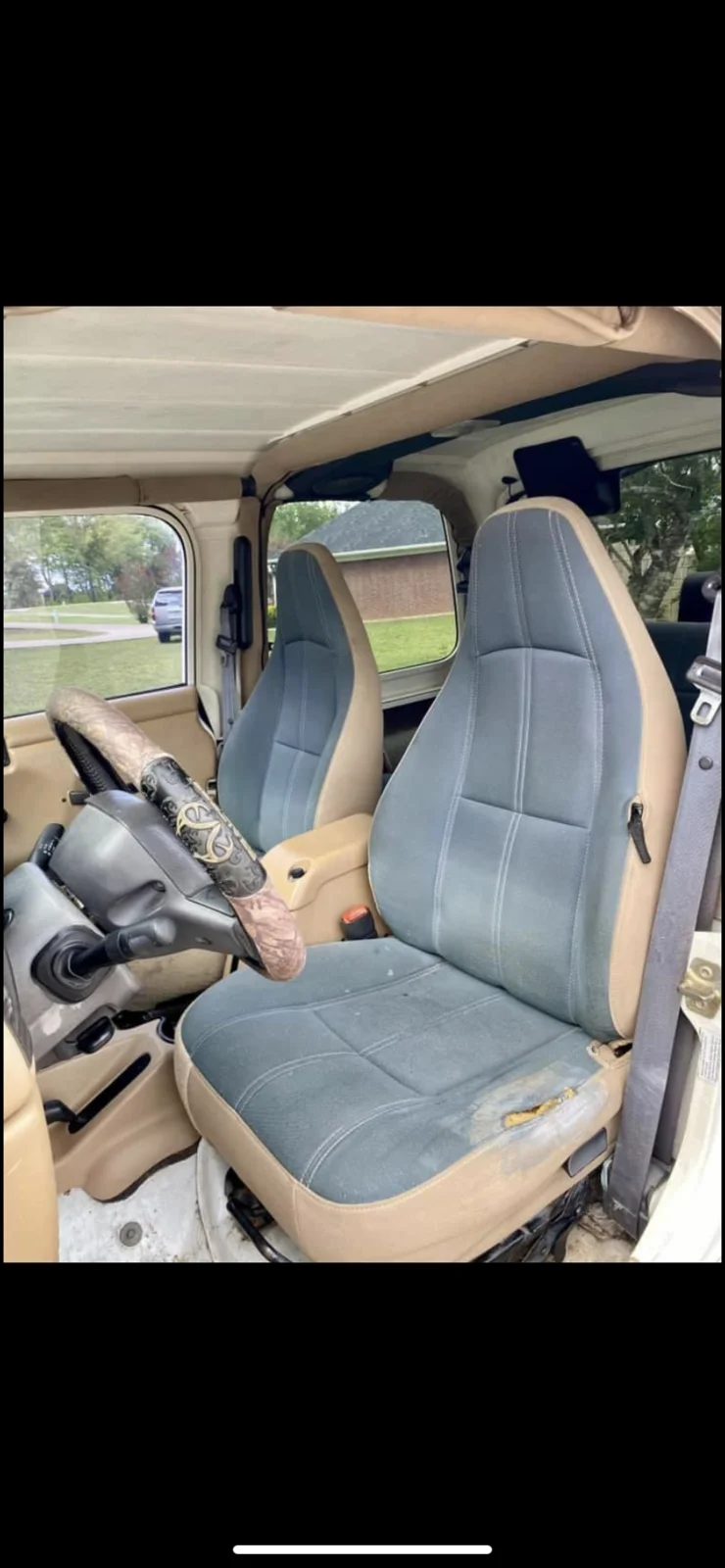

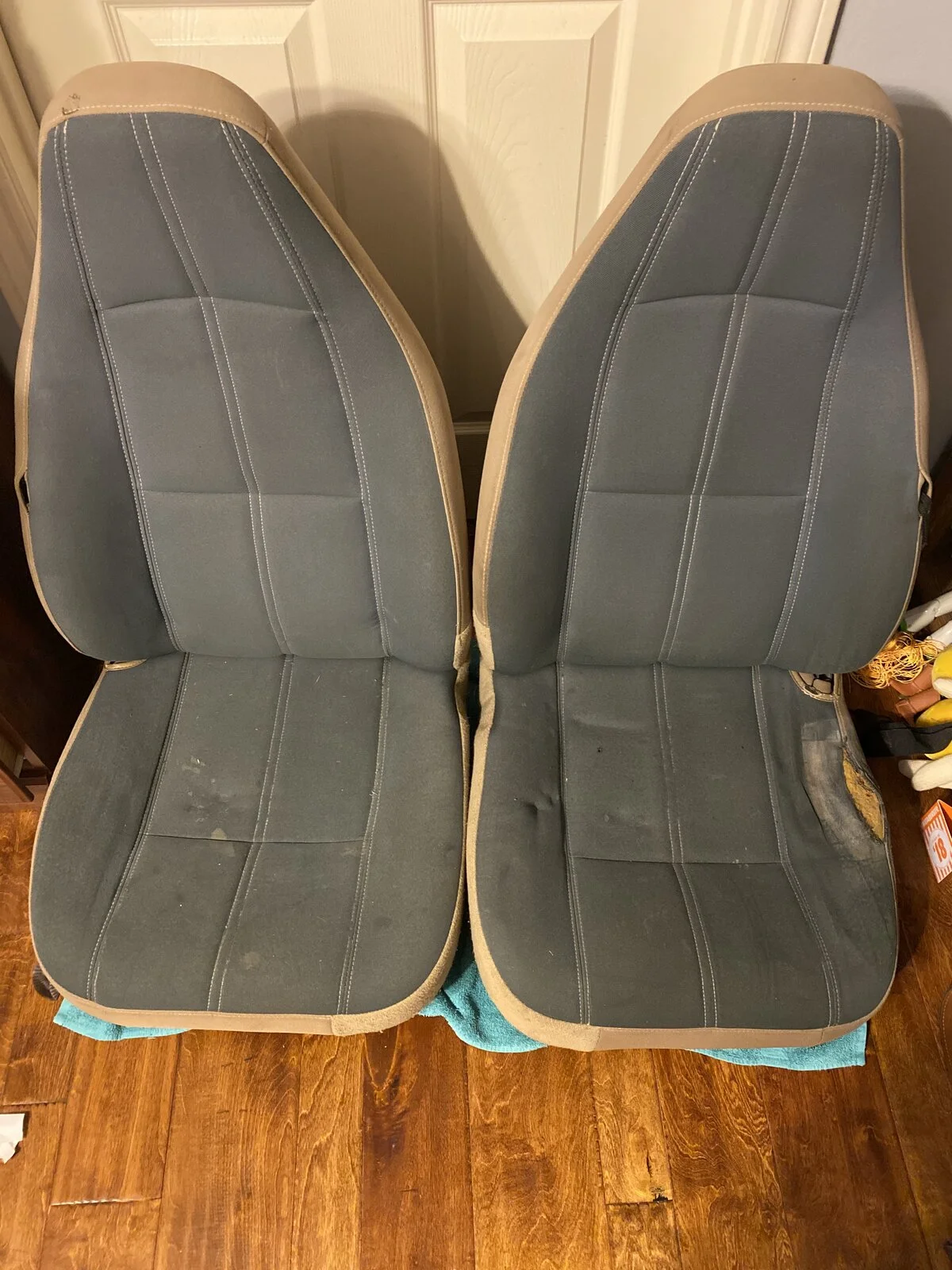

I came across a pair of seats for a pretty good deal and jumped on it because my seats were ripped, faded, and very stained, plus I love the pattern of these seats. I think someone else on the forum nicknamed them "Crazy Triangle".

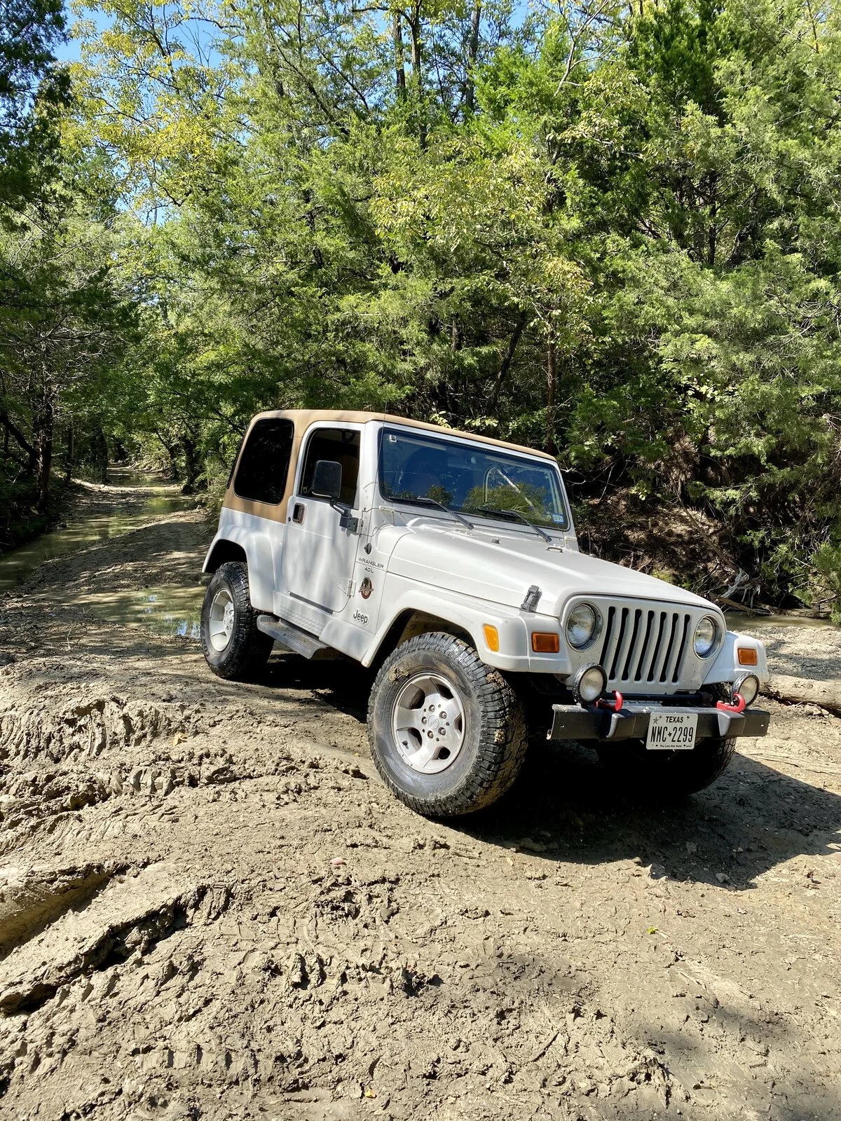

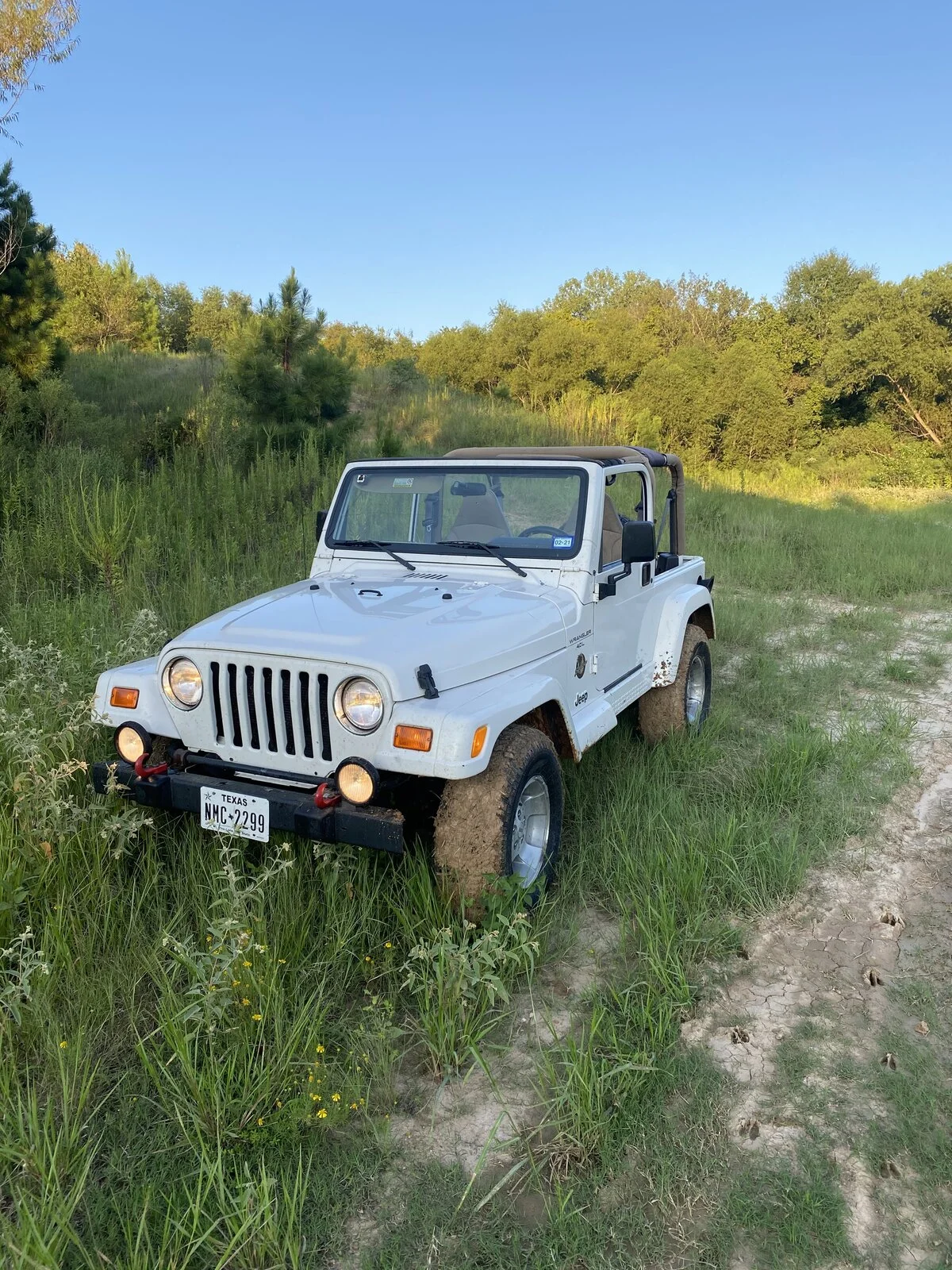

First time taking it offroad! Just some easy trails with my friend who I mentioned earlier :)

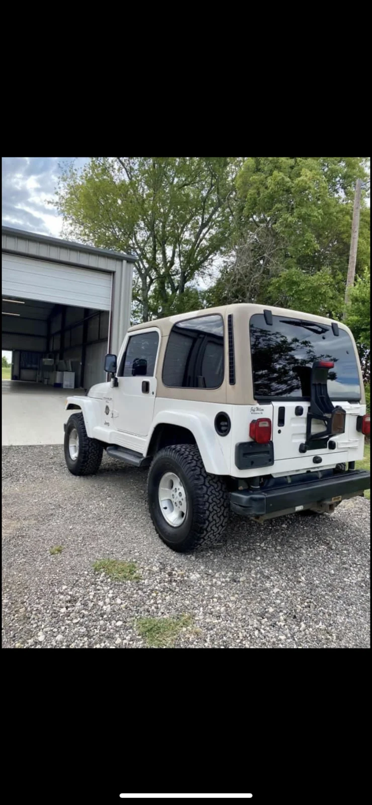

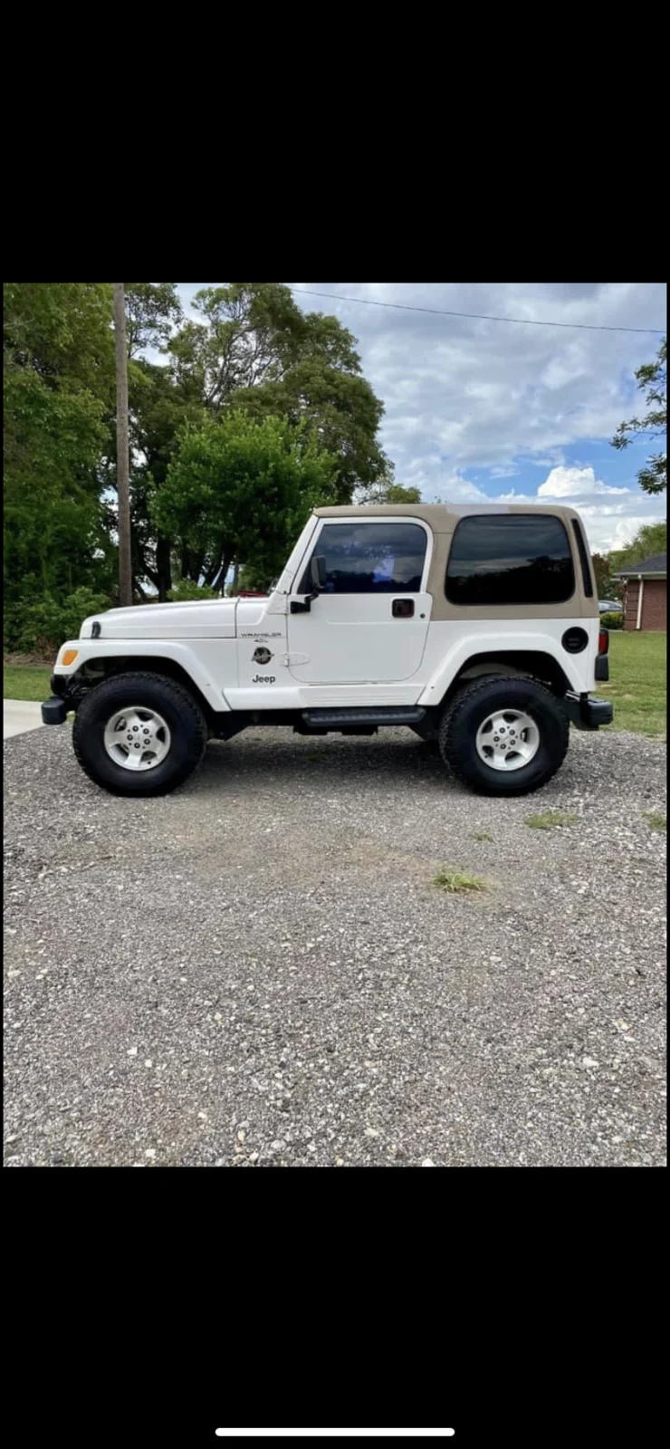

Next I needed to get new tires because the ones that were on it were pretty old and brittle. I decided to go down to 31s because I live in Dallas for school and do a lot of highway driving and I figured they'd probably be a little better on road while still having decent offroad capability.
With 31's and BL still installed
31's would also let me ditch the horrendous body lift!
Much better!

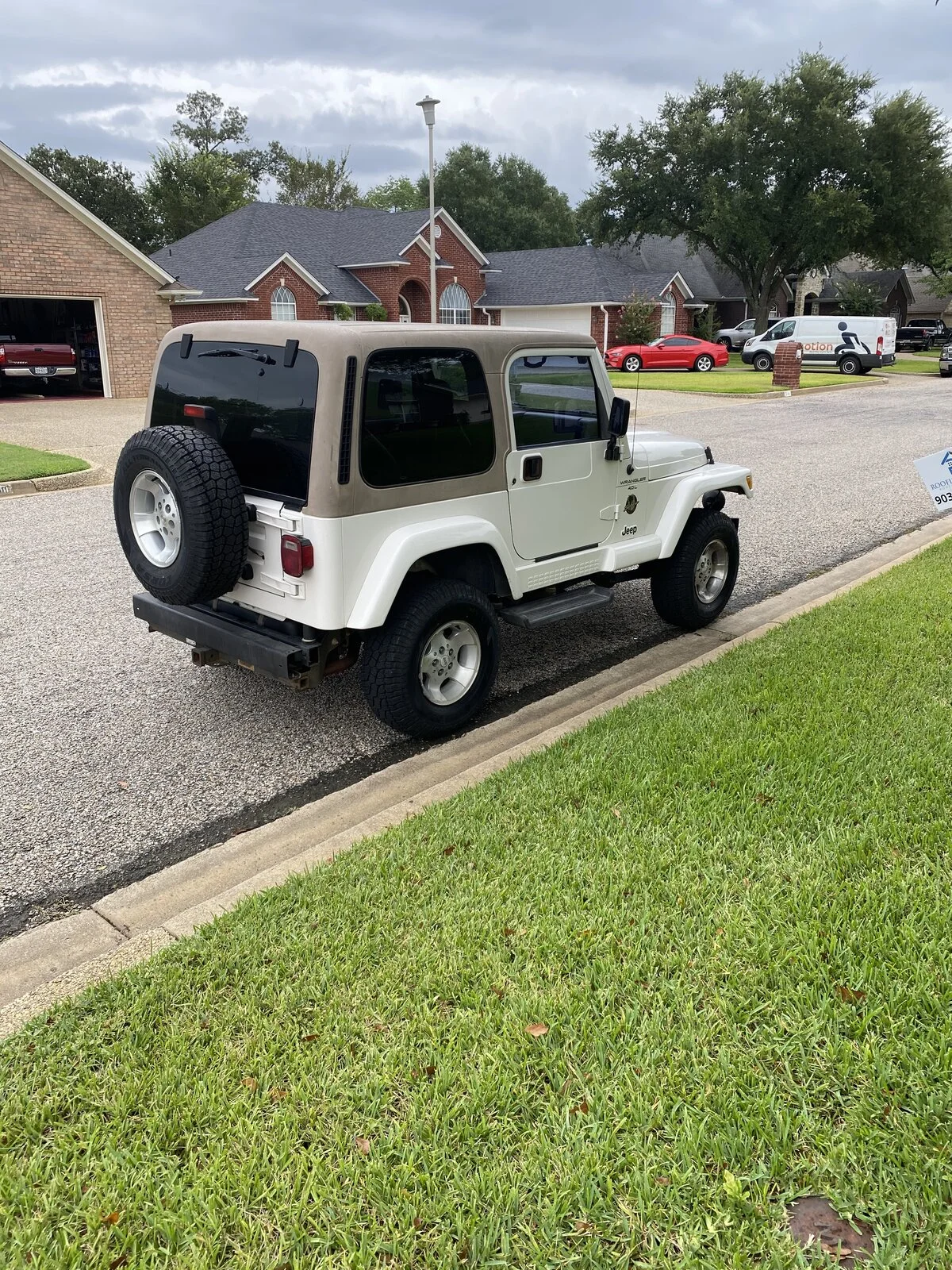

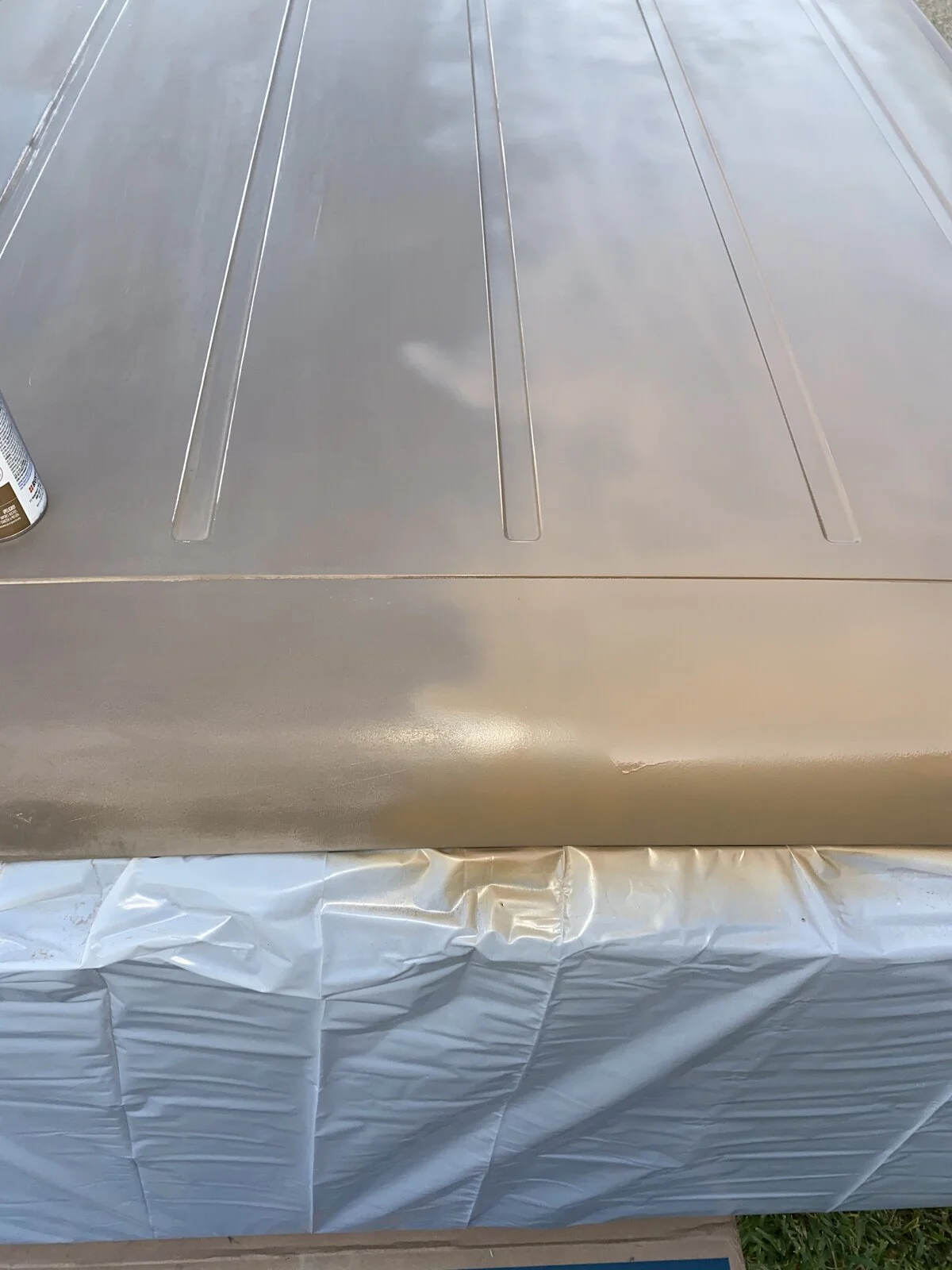

Next I repainted the faded and discolored hard top.

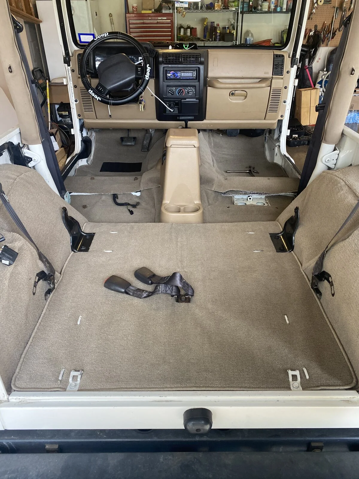

Finally got some carpet installed! Which helped a lot with road noise and heat coming up from the transmission.

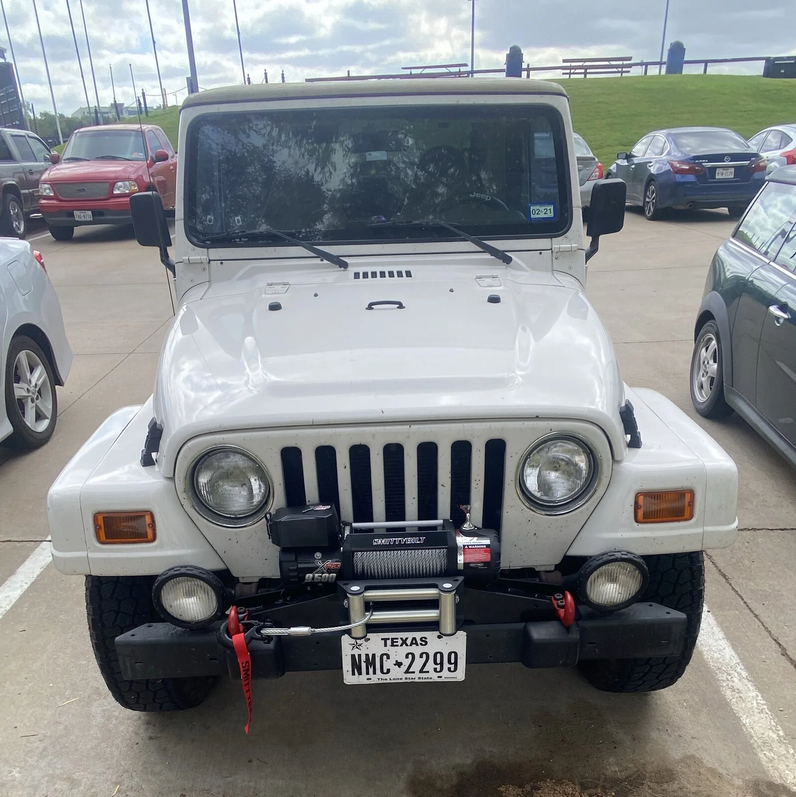

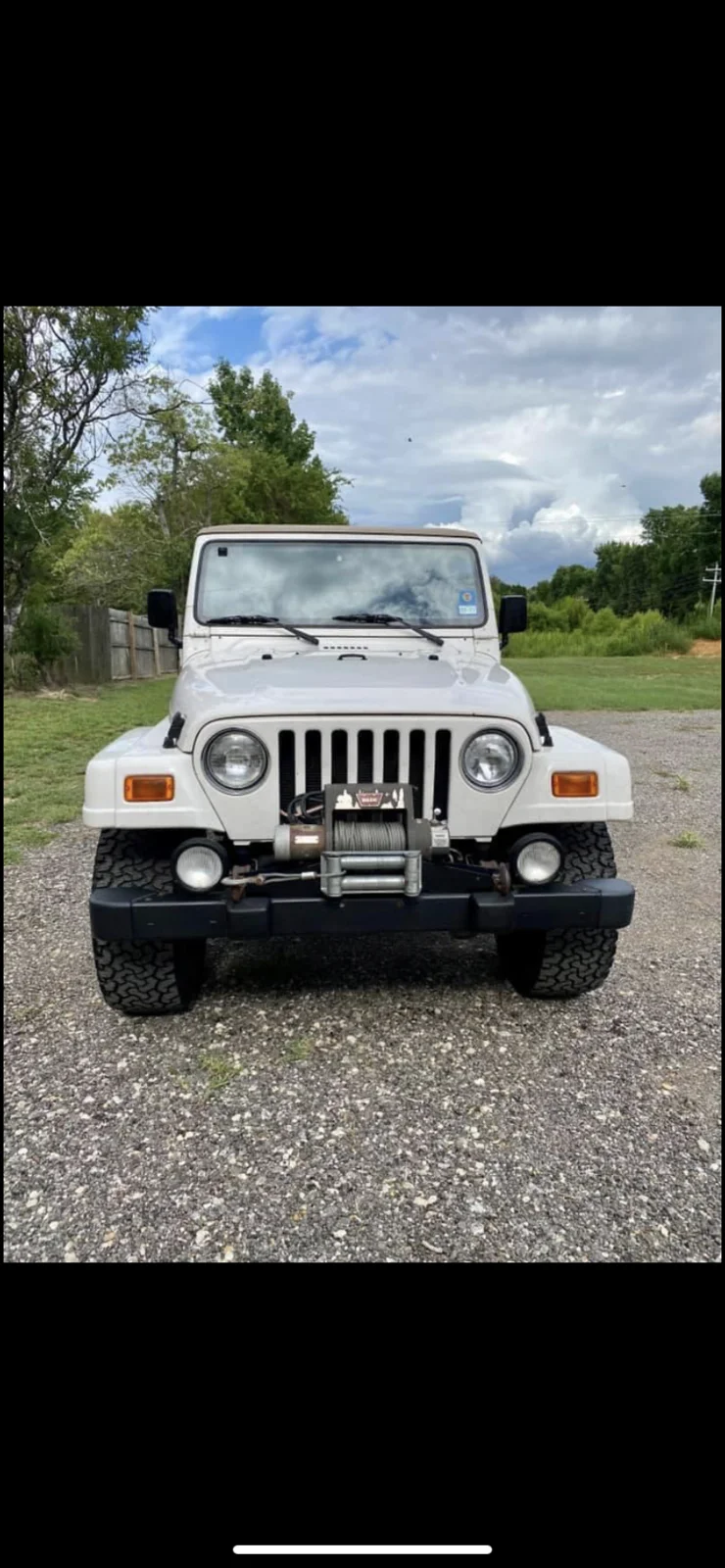

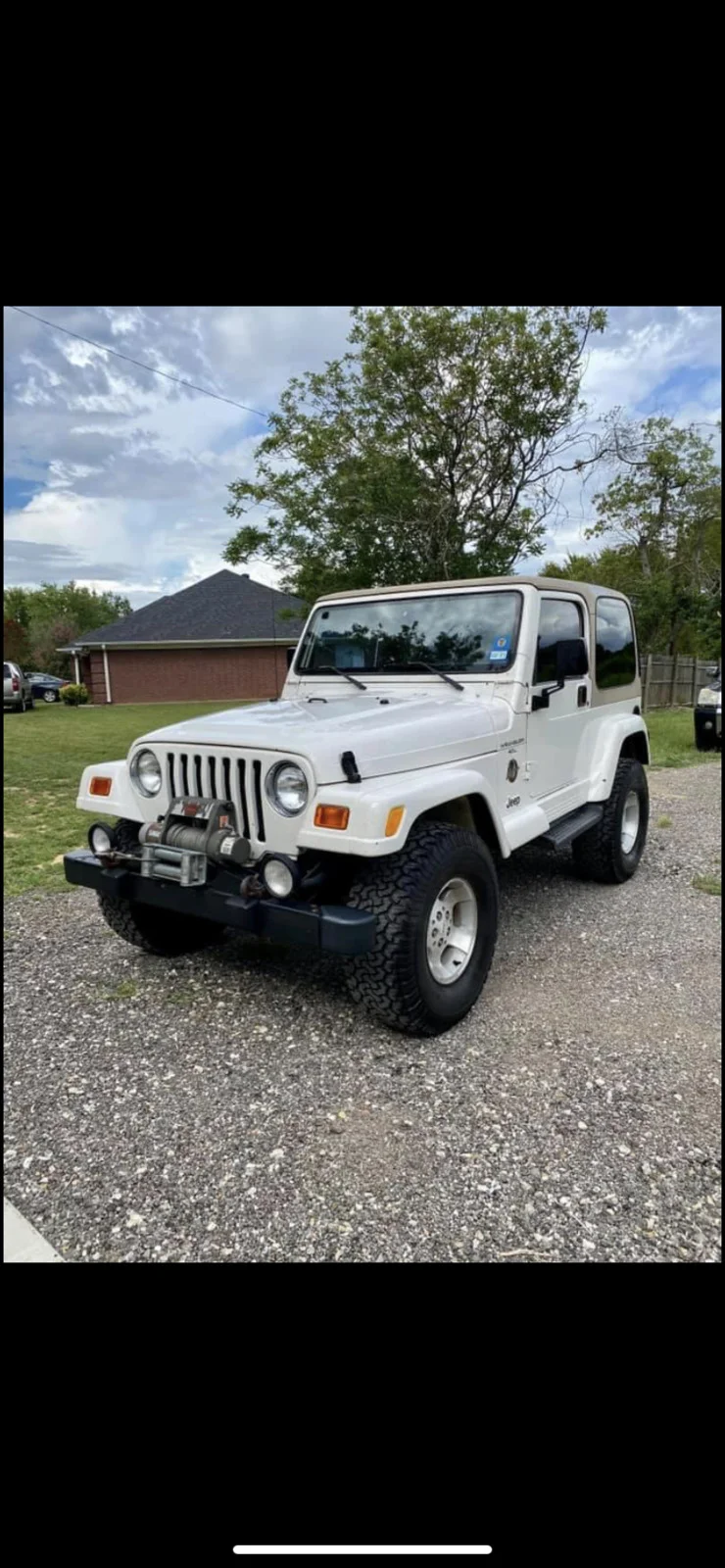

After trying for a while to get the winch that came with it to work I eventually gave up and got a Smittybilt XRC 9500.

I forgot to add that with the stock gears in it you made the right choice by going back down to 31" tires over the 33" tires. Once you can afford the bigger ticket items then plan on regearing your axles when you go to larger tires. But have fun with it now and as it grows.

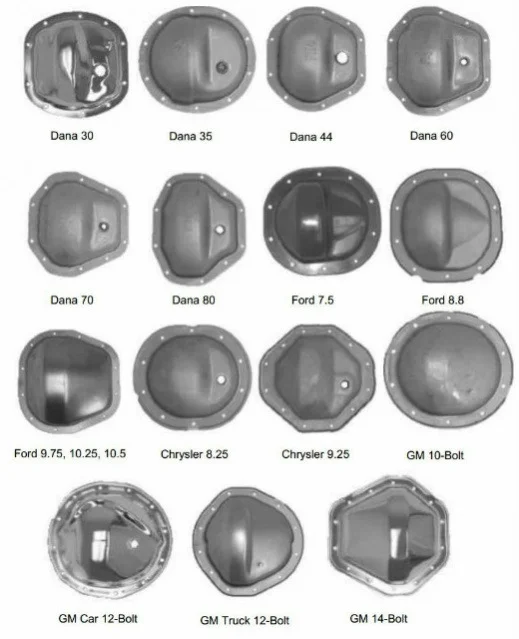

I'm always amazed at WHAT people DON'T know about their rigs. And I always laugh when I read an ad from some dealership that says they have a Jeep TJ with a 4.0 V-6 engine.....

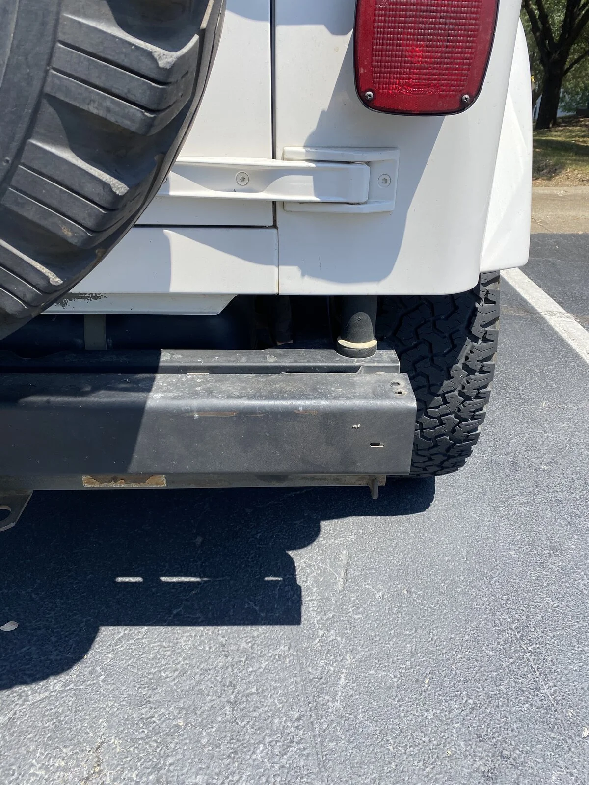

Unless it is a Rubicon model it came with a Dana 30 front and a Dana 35 or 44 rear axle. The Rubicon model came with a Dana 44 front & rear. The way you can tell if your rear is a Dana 35 or 44 is a Dana 35 came with a rubber plug in the stock cover where the Dana 44 came with a metal screw in plug. The shape between the two axles is also very different.
Reactions: motomick76
That's super helpful thanks! I'll have to look tomorrow and confirm what I have

I'm guessing you dont still have the winch that came on it?

Very nice find and good job on fixing it up! My favorites have always been the white Saharas with the two tone interiors like we share. It is sad to see the drivers seat did not fare so well. I think you did right thing going from 33 to 31's. I had 33's on, and it was terrible until I re-geared. Making jump to anything larger than 31's needs re-gearing. Have fun!
Thank you! I love the two tone seats when they are in good condition but mine were pretty bad. Super faded, almost to like a greyish color, a really bad rip on the driver seat, and some... interesting... stains on the passenger seat.IMG_2479.JPG
I will probably rear gear in order to go back up to 33's eventually. Just have to save up:rolleyes:
One thing if you want a small bump in gearing is to look for someone parting out a 4 cylinder TJ. If it's a manual transmission rig they came with 4.10 gearing stock. Not a big jump from 3.73 but would work for 33" tires for a while.
