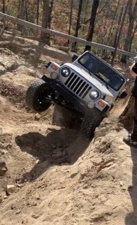

That same weekend, post a quick alignment, we took the Jeep out to Uwharrie and met some great fellow jeepers and had a blast. Pretty early on we lost 4lo. Got underneath and could force into 4lo but would eventually popout. Continued on some easier trails in 4hi.
Not soon after getting back, did some research (thanks to this forum) and realized this was a common issue when cheaping out and doing a transfer case drop. I did not realize I needed some adjustment bracket for the transfer case shifter. Still do not know how that did not come up in my weeks of research, but after getting under the jeep I quickly realized that was the issue. To remedy this, I ordered the Savvy Transfer Case linkage and got installed in about 6 beers (to clarify typically IPAs) and also changed the t-case fluid.
A weekend later, we took it back out to Uwharrie to test my home repair and met up with some of our new Jeep friends. 4lo worked like a champ and damn what a difference after installing. It is so much smoother engaging 4 wheel drive - no more of that "did I do that right" - It just works and you know if you are in 4hi or 4lo. So satisfying to essentially "break" something and be able to fix it. Here is great picture showing us doing a badge of honor trail and showing the recently installed upgraded steering linkage.
