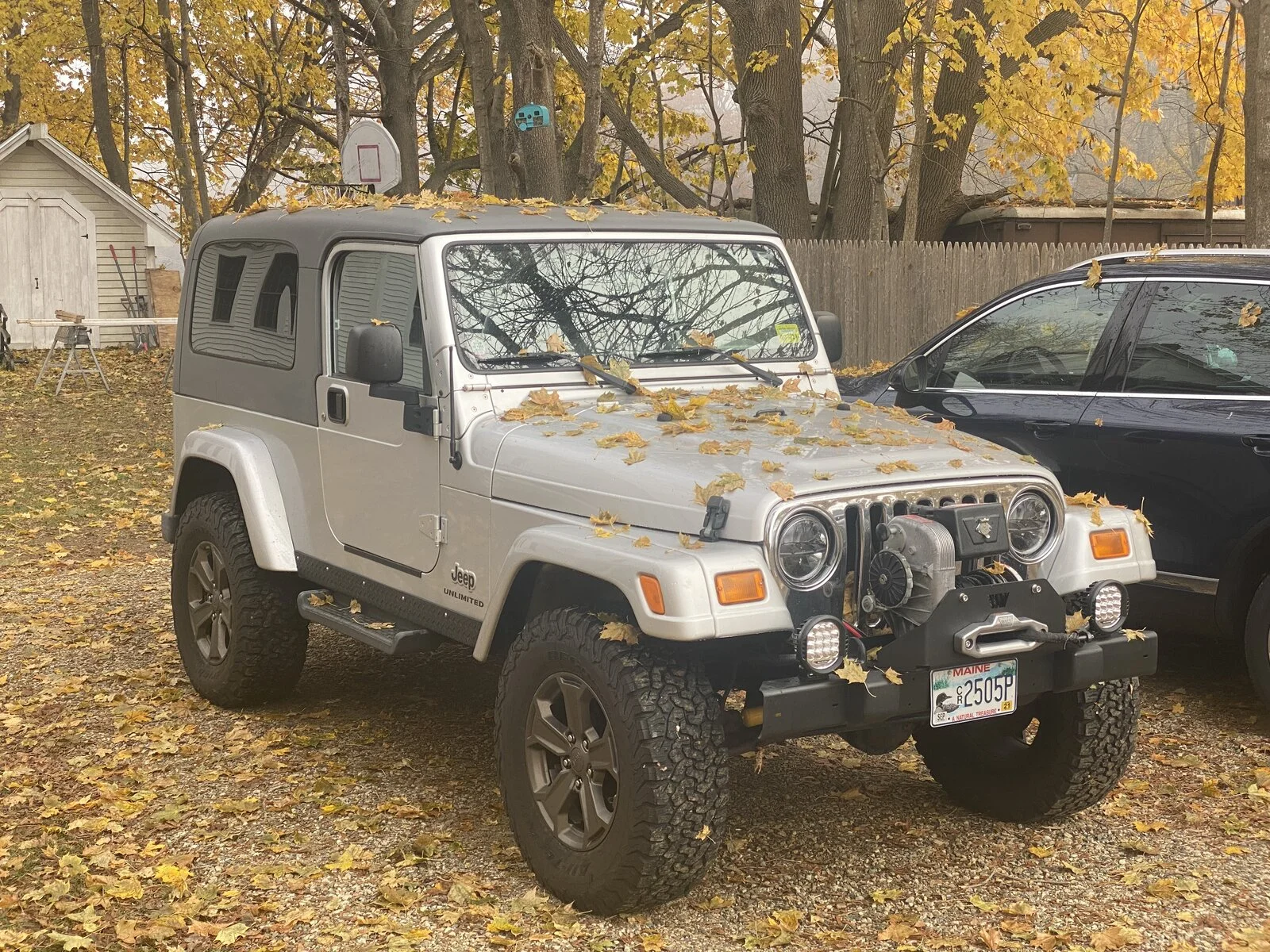

And I’d been checking Facebook Marketplace and Craigslist for parts pretty much constantly. I happened across a hell of a deal on a Warn M8274. Based on the date code and some details it appears to be a 1978. The seller bought it new for his CJ and kept it planning to put it on a woods rig and never got around to it.
I also picked up a free TJ winch plate thanks to FB Marketplace. The original plan was to marry the CJ winch plate with the TJ plate and get it mounted up. But once I mocked up the CJ plate, I decided it was too big. And while everything was apart to mock up the plate, I started cleaning up the frame. The frame horns were the worst from the plowing and plow frame mounts. So I hit it with some wire wheels and flap discs and got a quick coat of paint on the frame, sway bar and bumper.
So I ordered a Hanson M8274 plate, but their customer service has gone into the toilet since I last ordered from them back in 2004. I ended up with a Warn M8274 mount for the Warn JK bumpers which I think will look a lot better. I’ll cut the fairlead mount off The TJ plate and use the two to get the winch up and running. I also got 100’ of synthetic cable, a new hook, new power cables and a hawse fairlead.

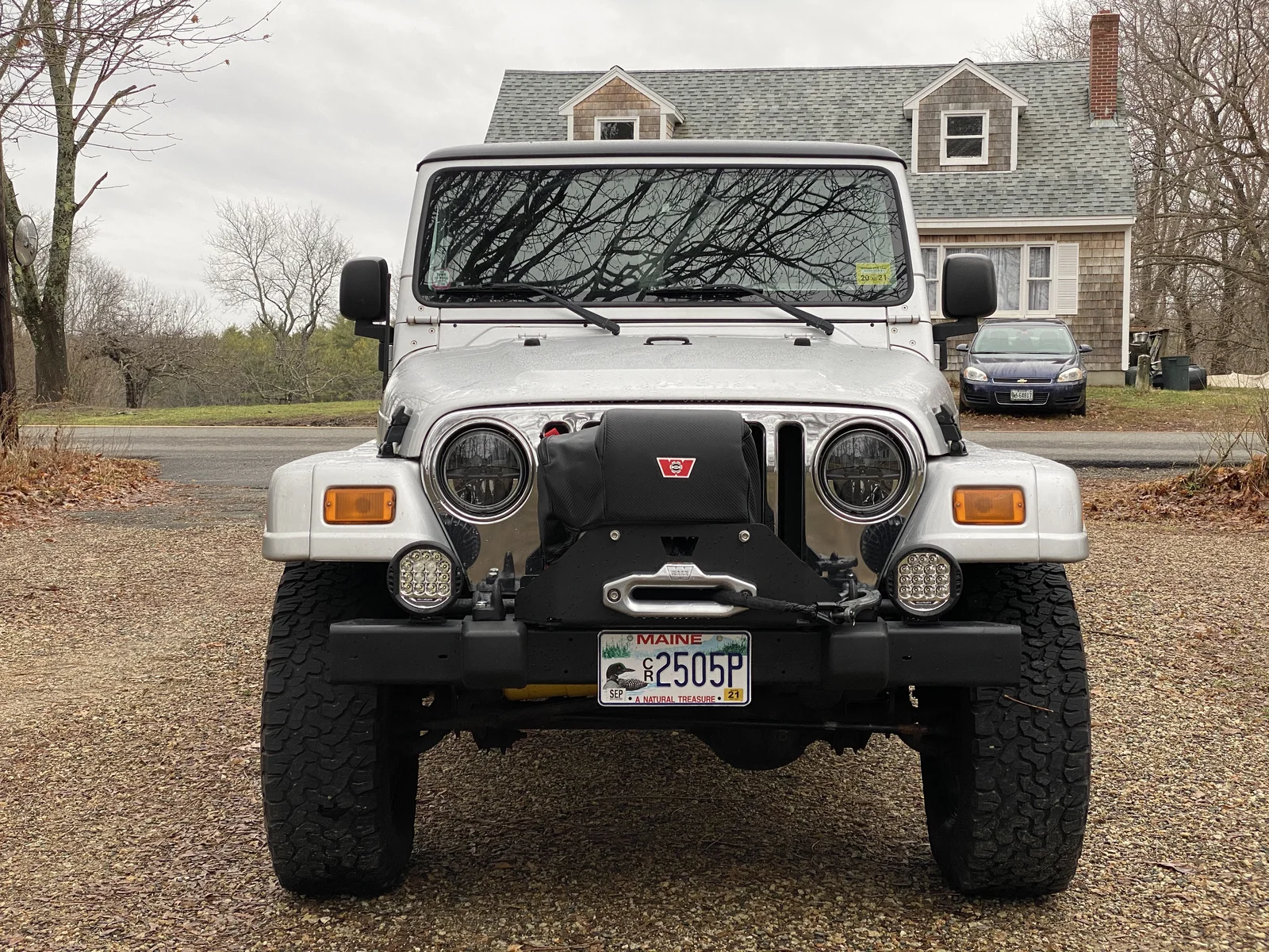

Yesterday I finished cutting up the TJ winch plate and got it welded back together and drilled to match the JK 8274 plate. I also cut out the nut with a broken bumper bolt out of the frame horn and welded a new nut in.
Today I gots few coats of paint on the plate, got the JK plate on it and got the winch mounted. Then I got it on the Jeep, got everything wired with new cables and got the synthetic line spooled (though I will have to respool).
It’s ridiculous. It’s excessive. But I’ve always wanted one, so it’s perfect.

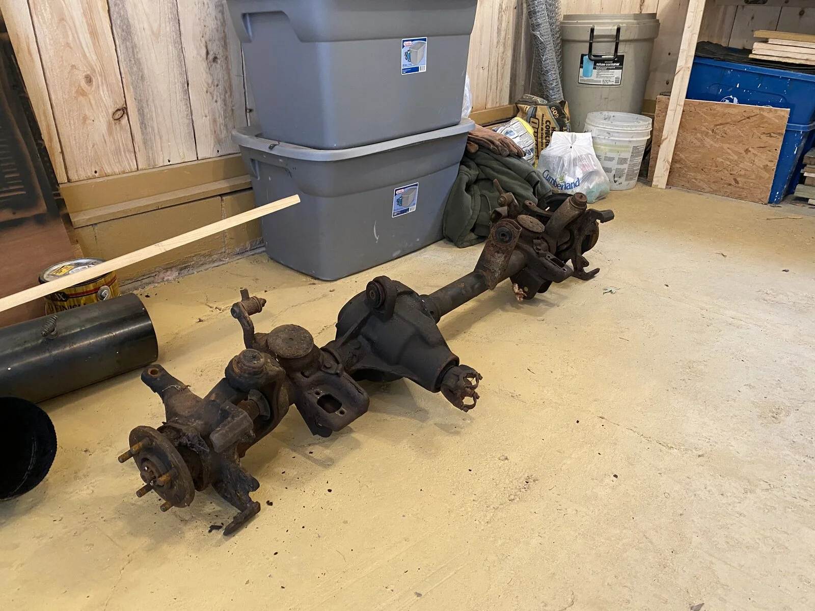

A few weeks ago I picked up a HP Dana 30 so I can take care of a full rebuild on the bench. It needs some work but the price was right and it will be a fun project. I should be able to do everything but the re-gear myself.

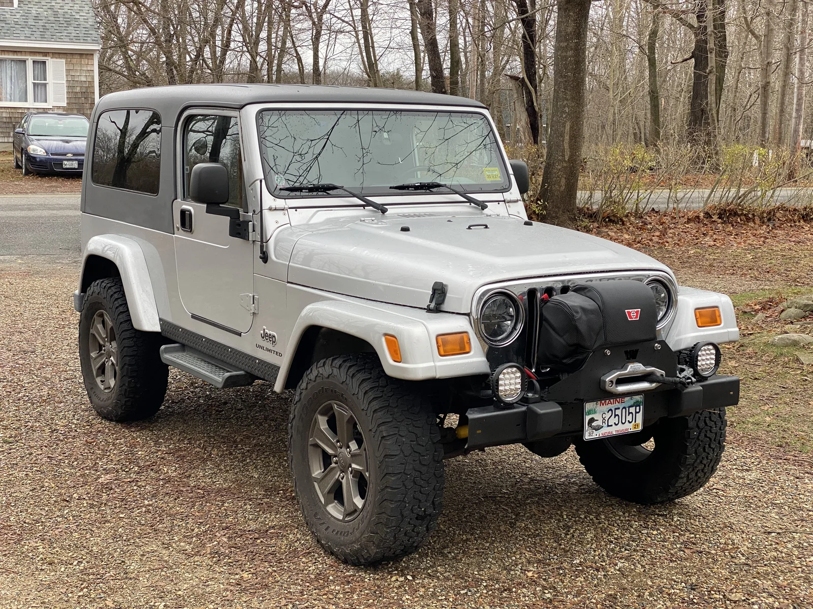

A few weeks ago I installed a new East Penn/Deka AGM battery from NAPA and a set of Custom Battery Cables. I was able to swap everything over since the terminals were in rough shape and there was a lot of corrosion on the wires at the connections.
I also picked up and threw on the Warn Stealth cover for the winch for the winter.

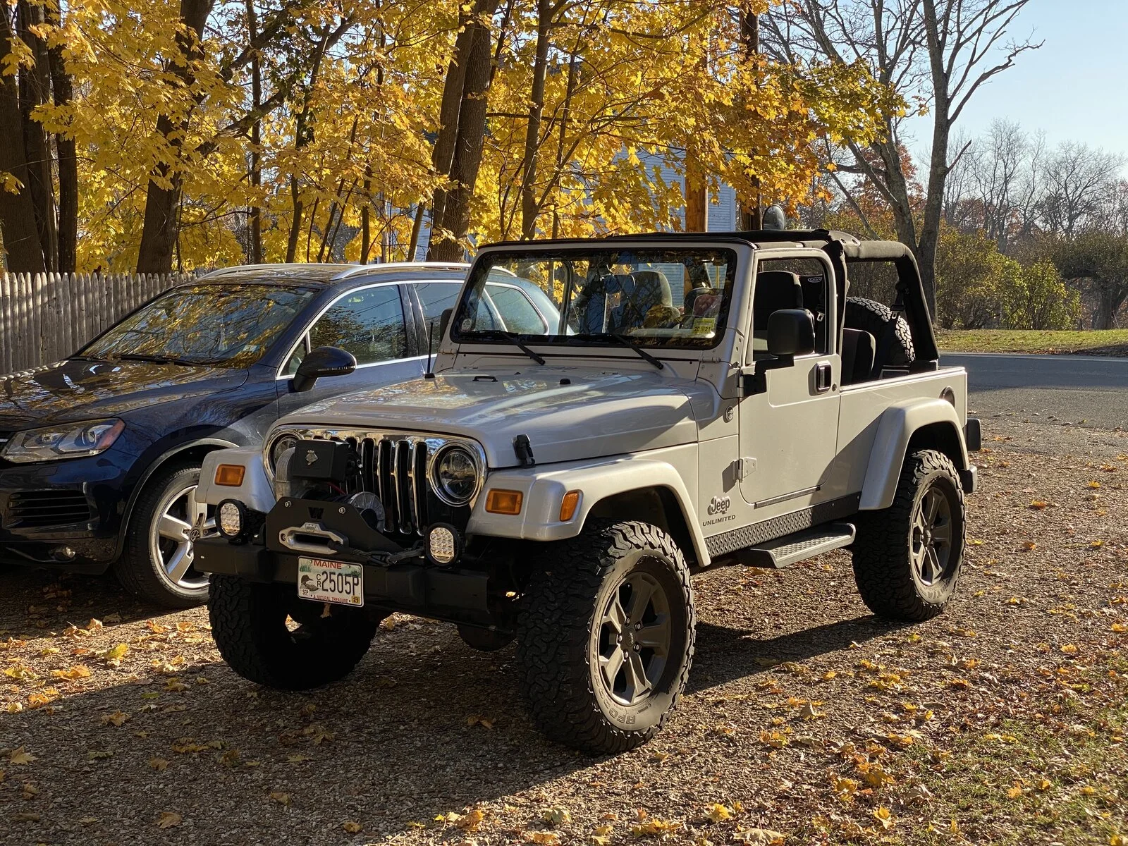

There are probably some things that I should've done first, like brakes or addressing the fuel sending unit. But I just couldn't stand the stock stereo any more. Last night I installed a Joying 8.8” single-DIN Android floating screen head unit. The widescreen aspect ratio fits perfectly between the vents and HVAC controls, though I need to adjust the screen up a little. It has wired and wireless CarPlay, and looks and sounds great. And because it’s single DIN, I was able to keep my silver bezel.

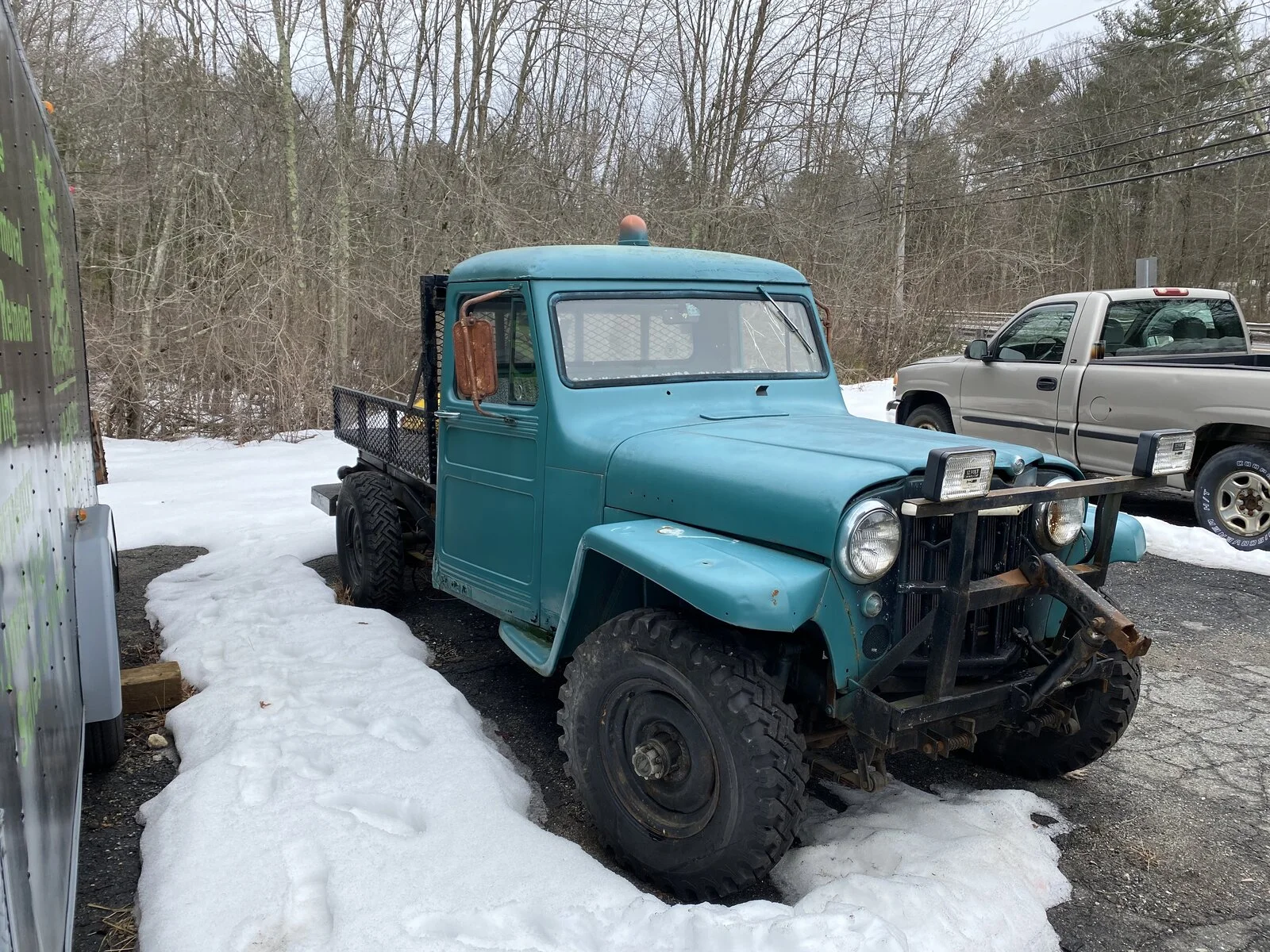

So not directly LJ related but... My Dad decided he wanted a truck to eventually replace his JK. And since he wanted a project for us to tackle, he didn’t want something turnkey. After missing this on a local forum, it popped up on FB Marketplace yesterday. I just got back from looking at it with him... He bought it and we’ll pick it up next weekend.
It definitely needs some work, but it should be a fun project and a great way to develop some new skills while being a great excuse to buy some new tools!
