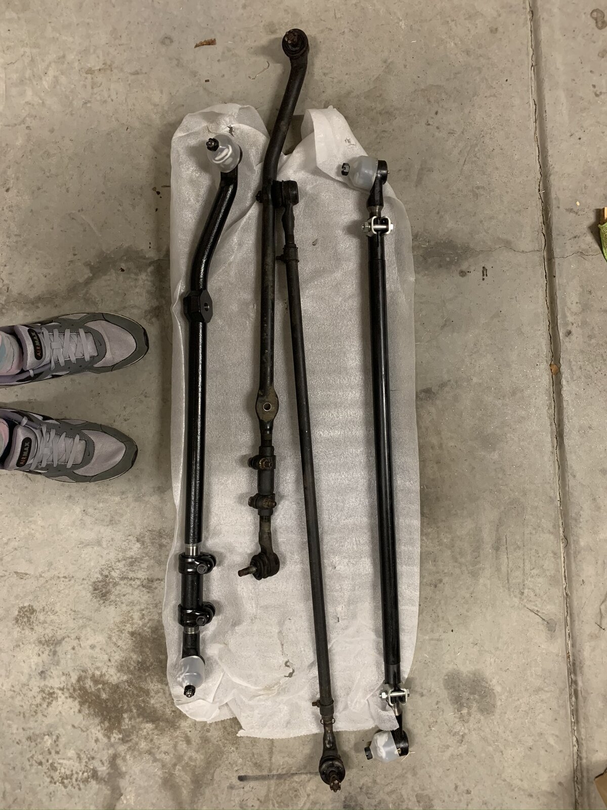

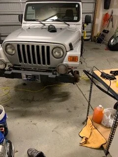

- October - decided it was time to upgrade the steering in preparation for trying to go out wheeling and looking at the tiny steering linkage had me concerned. Good news - no hours of research needed, went with Currie CorrectLync that is the gold standard per this forum. A bit pricey but certainly well built and the install took me about 6 beers so thats a win in my book. Here is a quick comparison that includes my feet for some reason.
.View attachment 210824

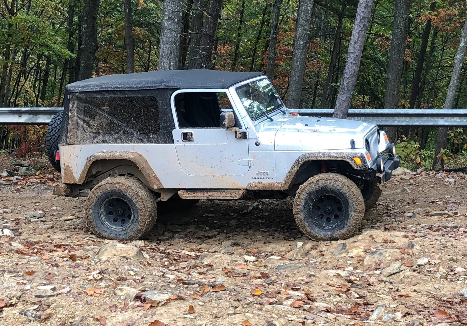

That same weekend, post a quick alignment, we took the Jeep out to Uwharrie and met some great fellow jeepers and had a blast. Pretty early on we lost 4lo. Got underneath and could force into 4lo but would eventually popout. Continued on some easier trails in 4hi.

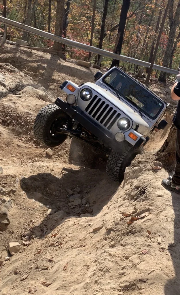

A weekend later, we took it back out to Uwharrie to test my home repair and met up with some of our new Jeep friends. 4lo worked like a champ and damn what a difference after installing. It is so much smoother engaging 4 wheel drive - no more of that "did I do that right" - It just works and you know if you are in 4hi or 4lo. So satisfying to essentially "break" something and be able to fix it. Here is great picture showing us doing a badge of honor trail and showing the recently installed upgraded steering linkage.

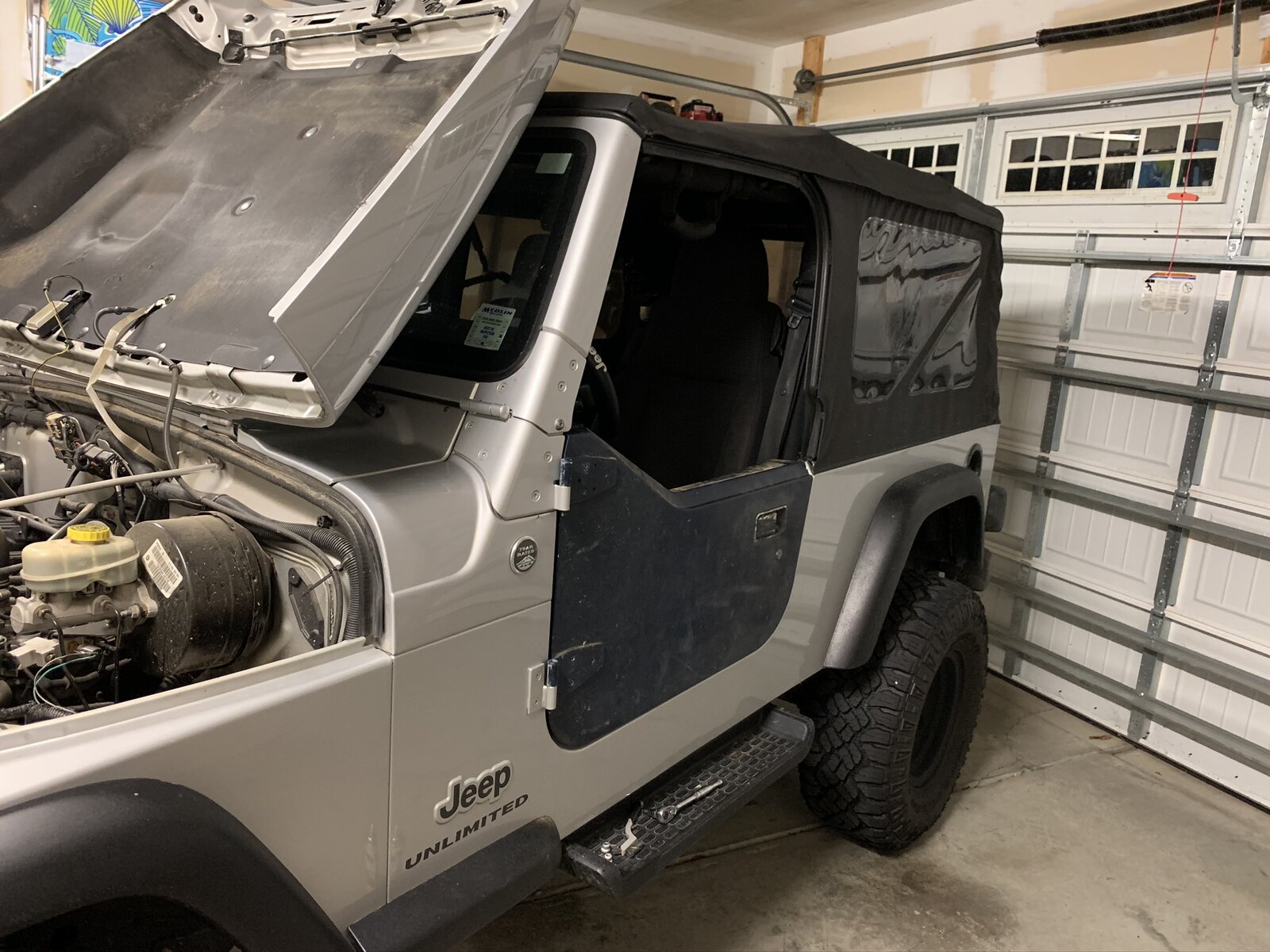

Continuing on the money pit - ordered rock sliders and an engine skid. Decided to give fishbone off-road a try. Had planned to install this past weekend but a cracked radiator got in the way.
Tonight decided to tackle one side of the sliders as the boxes were starting to collect dust.
These arrived very well packaged and are pretty heavy. I absolutely hated drilling into the tub of the Jeep- debatable if I prefer that over a rock slamming into the rocker. I think it turned out great.
View attachment 261005View attachment 261006View attachment 261007

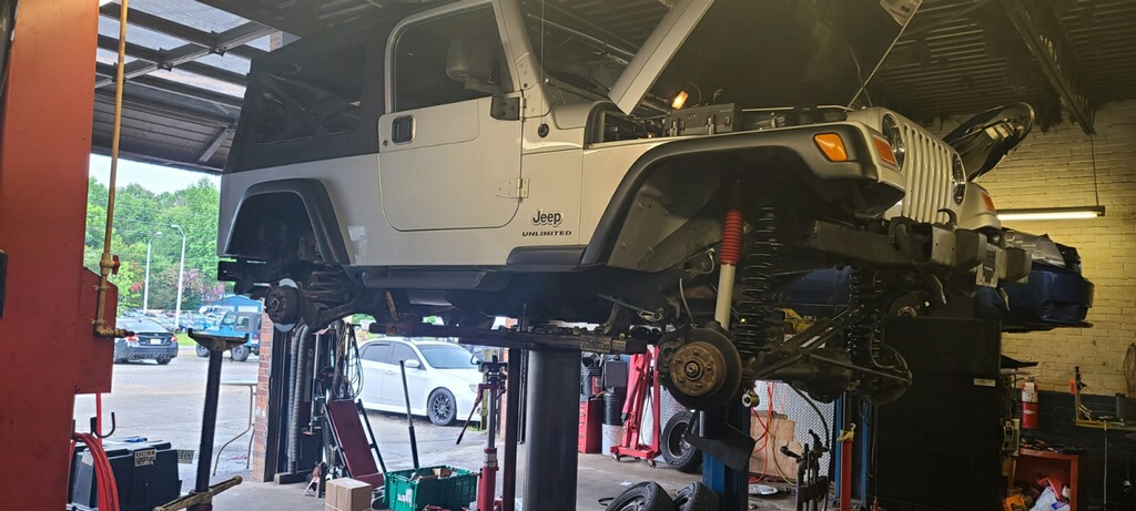

No pictures in this update, but the Jeep has returned after a quick stay at East Coast Gears. Here is a quick list of what was done:
- 513 gears
- Eaton E-Locker in rear
- Spartan Lunchbox locker up front
- Chromoly front axle shafts
- Upgraded to Spicer 5-760 U-joints
This probably goes without saying but the regear makes driving the Jeep so much more enjoyable. Can actually maintain speeds and even increase from 70 mph without toggling the O/D. I mentioned to my wife, there is actually a chance now to "accidentally" speed.
