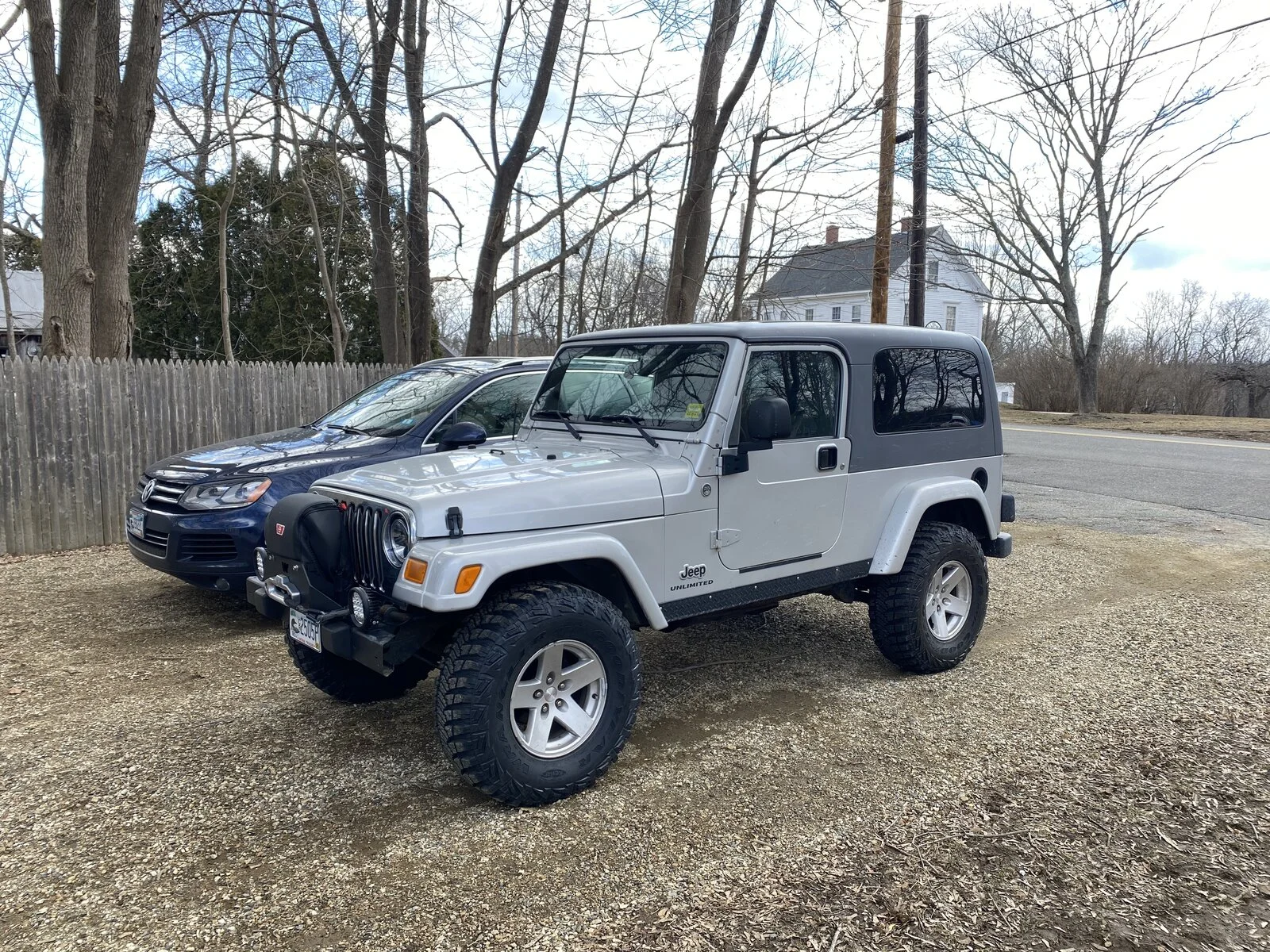

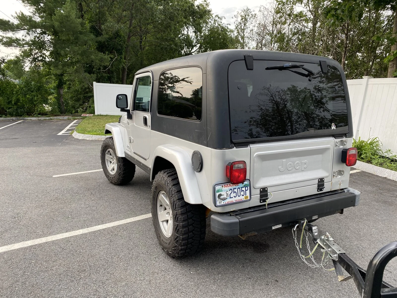

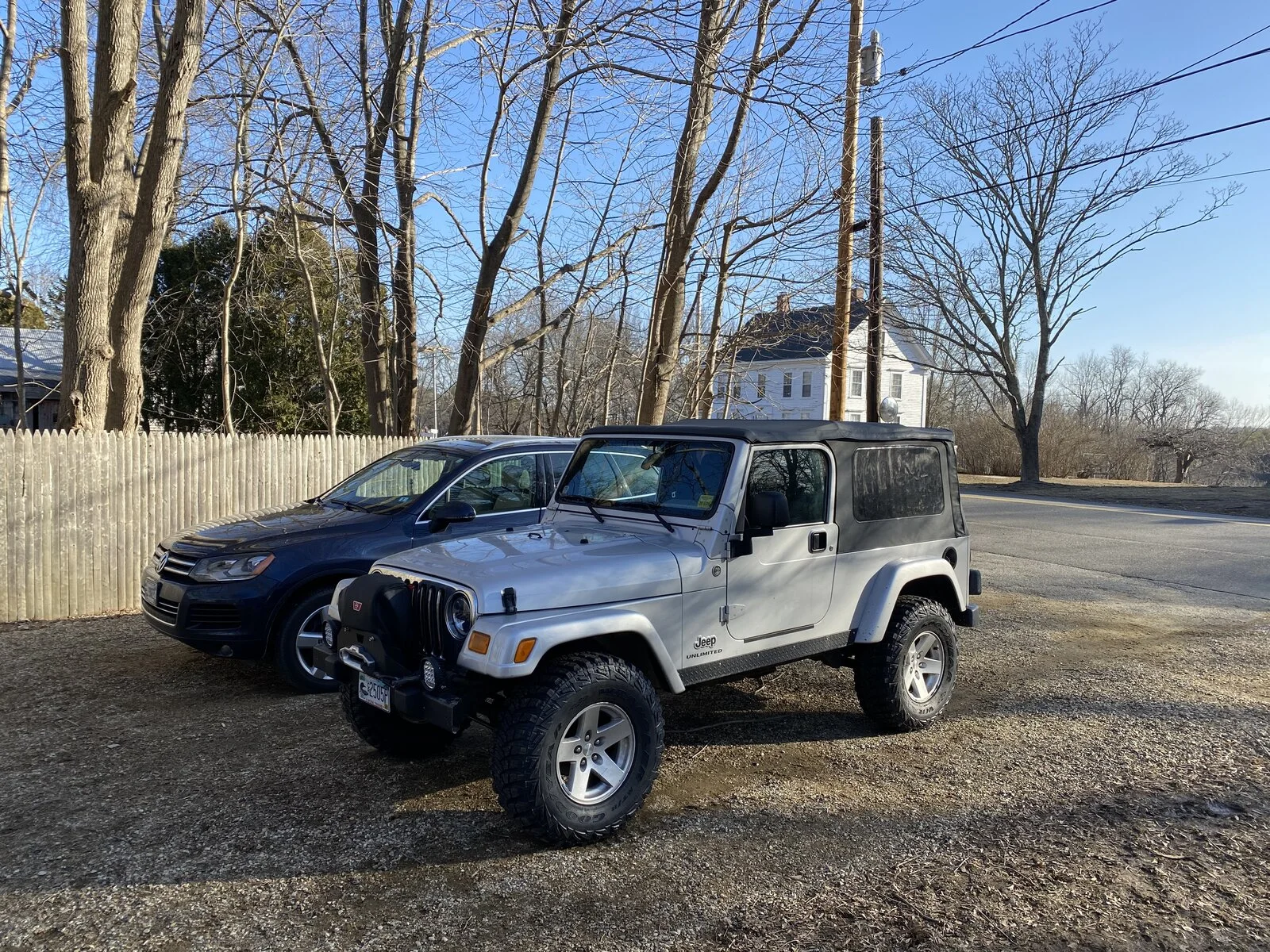

Got my new wheel and tire package on. Buyer for the JK Recon wheels, KO2s, adapter and spare relocation bracket had access to a lift, so we pulled everything and I moved to ‘06 Moabs and 285/75R16 MT/Rs.
I liked the 17s and KO2s. But the Recon wheels weren’t my first choice and since I don’t drive it much, I wanted a more aggressive tire.
Very pleased with how things worked out for essentially an even swap. I think I just need some 3/4” spacers up front, especially once the hard top comes off.

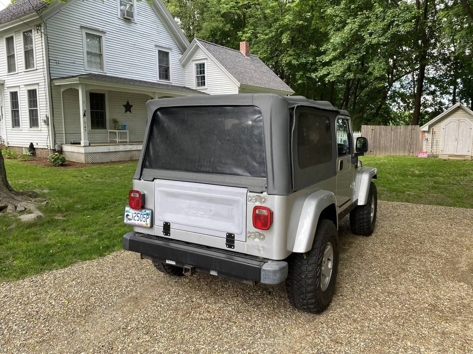

Sold the hard top today. Never really liked the medium gray, don’t love the LJ hard top in general, got a lot for it, and love the look of the soft top... so much better now!
I ordered a plastic polishing kit, and will be trying to clean up the windows this weekend.

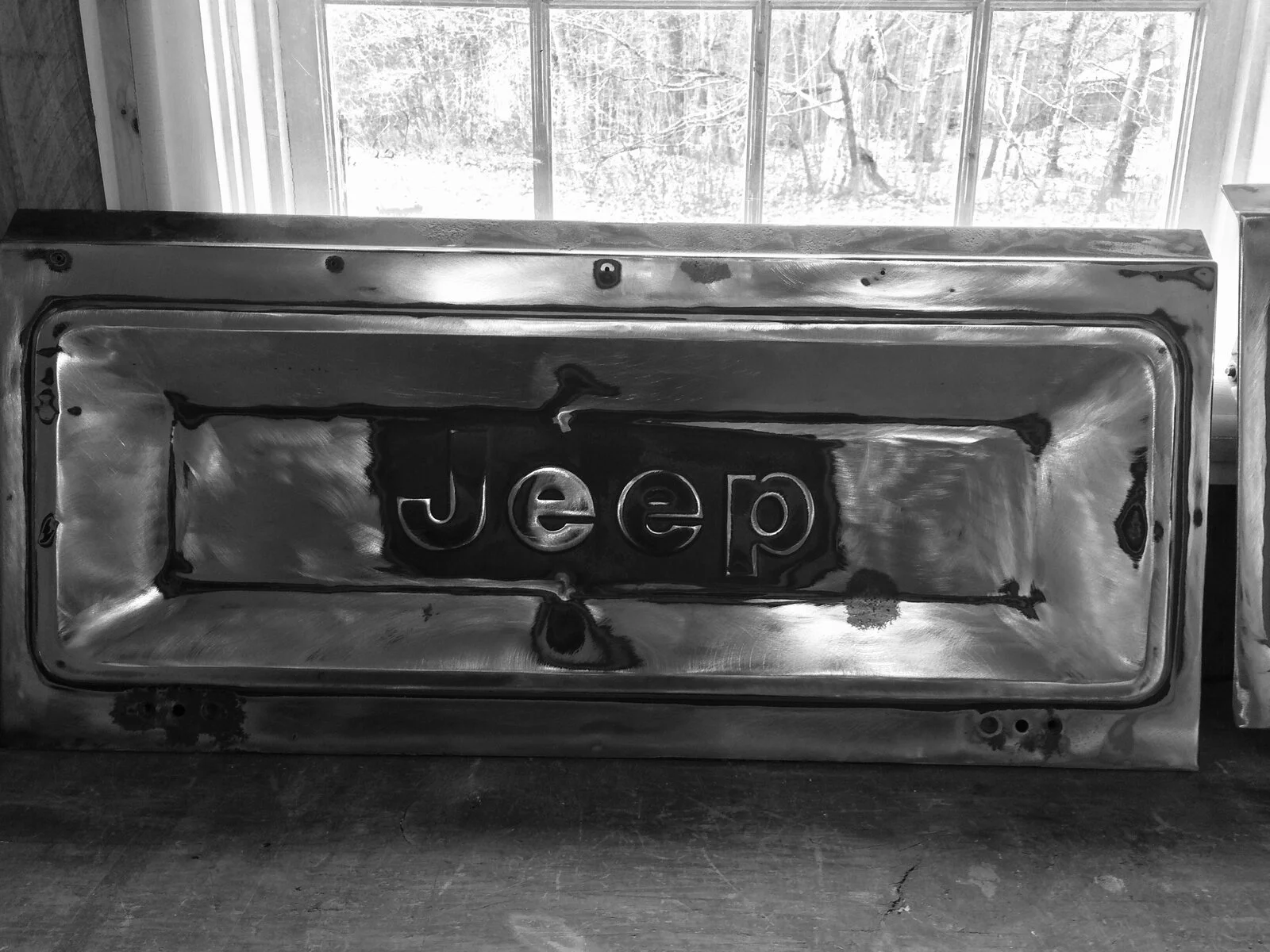

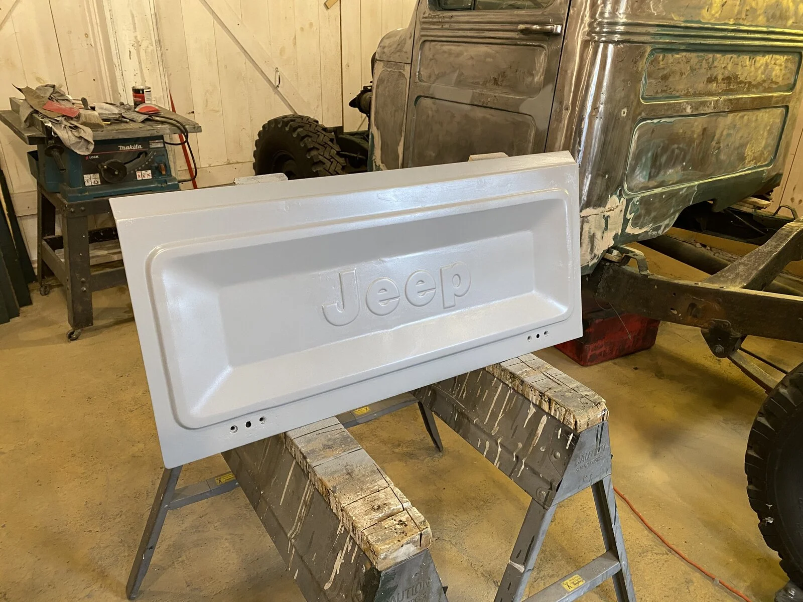

So, good day on the tailgate project.
I wasn’t thrilled with the condition of the one I bought this winter, so I picked up another. While my father has been getting layers and layers of paint off the Willys, he also did a bunch of sanding to get the tailgates stripped down. Turns out the new tailgate is worse than the first one, so back to square one. Today I welded up the snap holes and a small hole above one of the hinges. I was also able to chase the hinge holes, which saved me a ton of work. Then I hit a few spots with filler, got some self etching primer on and then hit it with some high build primer. I may still need to fine tune a few spots, but it’s getting close!
As received:
Mostly stripped:
As it sits:
Gratuitous shot of the Willys:
Edit:
Apparently April is CJ tailgate month for me.
Well, I thought the tailgate was ready for color. Turns out it’s not, so I have some more work to do. But that said, I was pretty happy with the match considering there’s no clear on it. I'm really looking forward to getting it on for good.

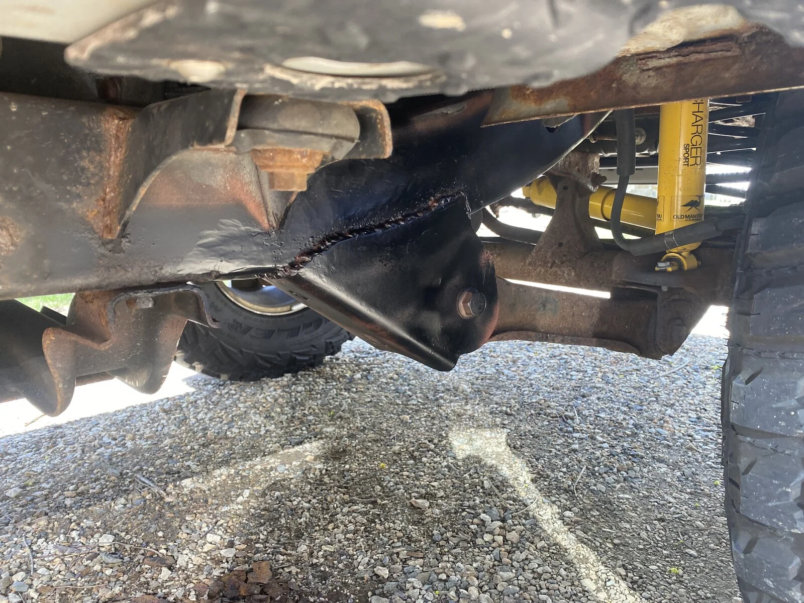

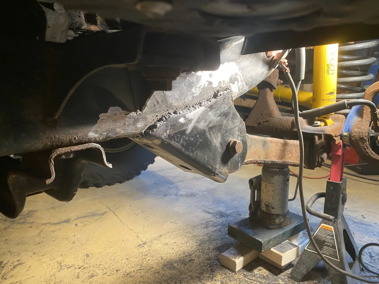

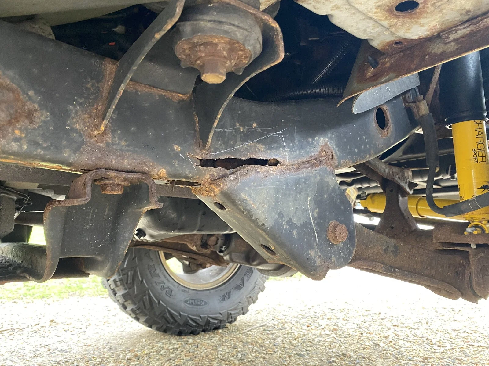

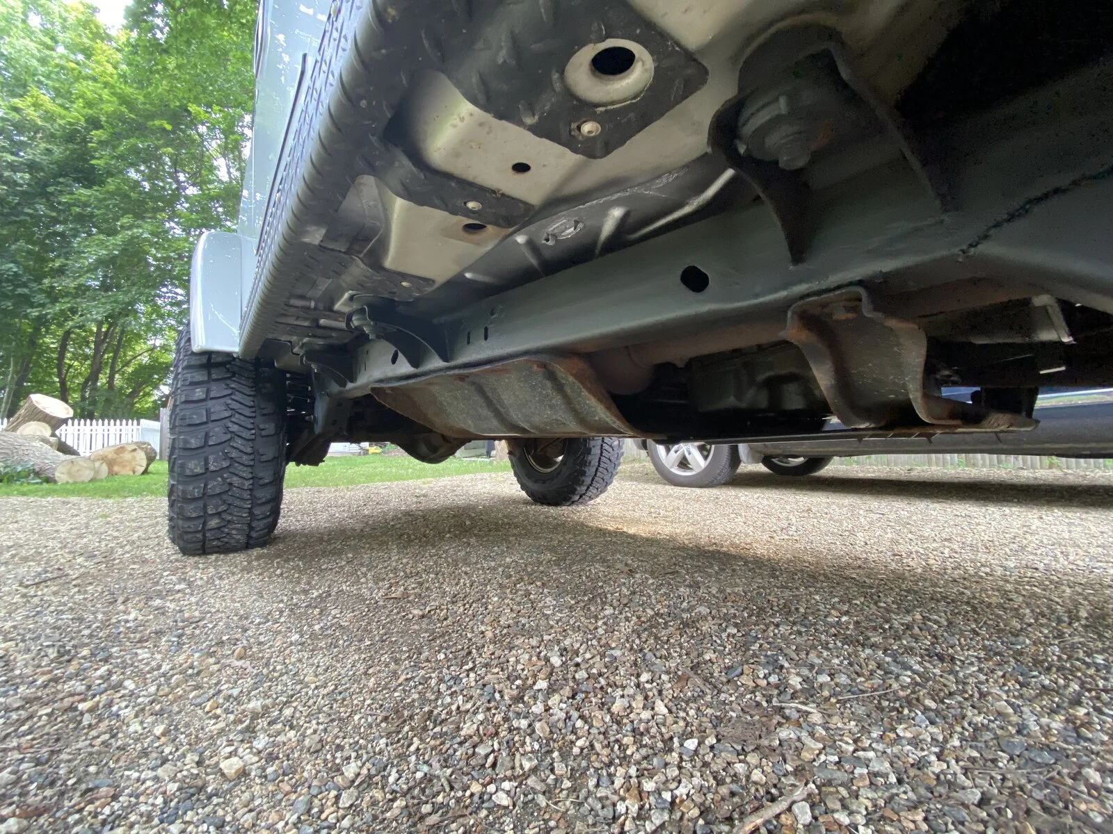

Unfortunately i got some bad news earlier this week. My Jeep failed inspection due to a bad spot in the frame, on the outside and the bottom around the PS frame side front lower control arm mount.

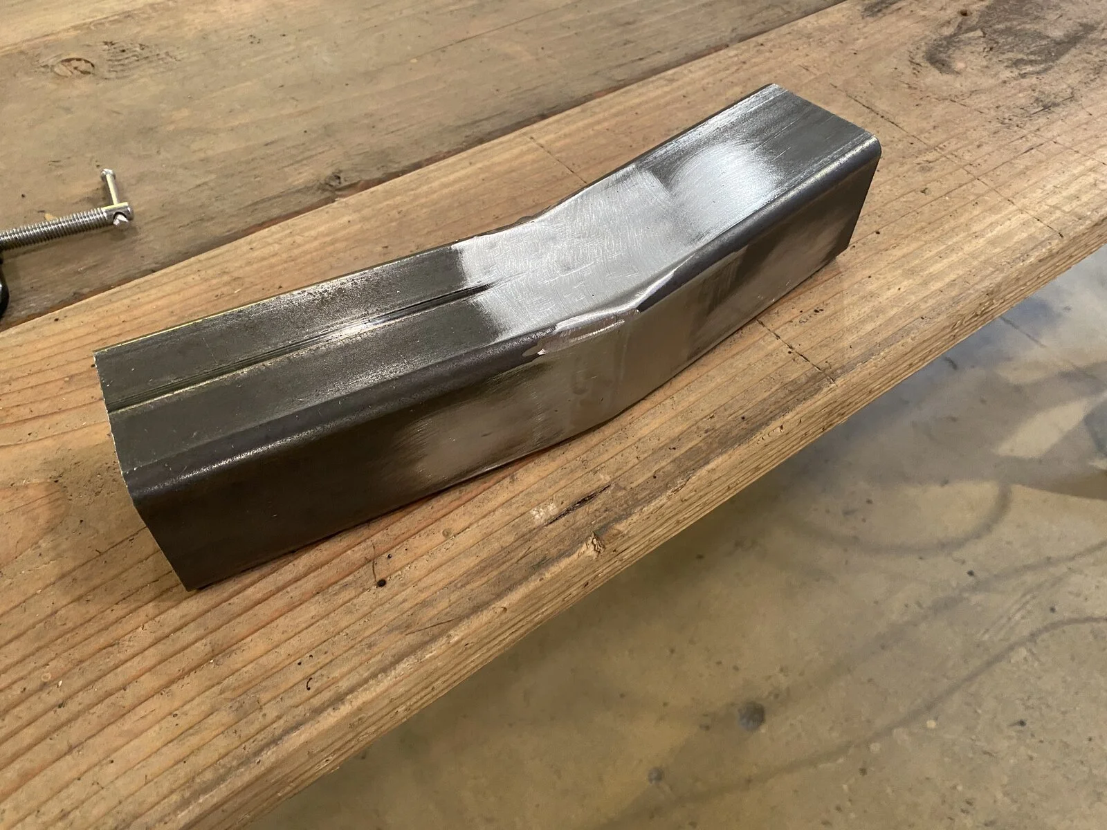

I didn’t want to use a Safe-T-Cap. So I picked up some 2.5”x2.5”x3/16” square tube, and yesterday I mitered it at 7.5 degrees and flipped one side to get 15 degrees to match the angle of the frame. When the edges were prepped, I welded that up to have my frame patch ready.
This morning I took a bunch of measurements before I cut off the control arm mount, and then hacked away. Once I had access, I cut out the bad section of the frame, cut my patch down and with a lot of trial fitting and trimming, got the patch in. Then I rewelded the control arm mount back to the frame, carefully matching my pre-cut measurements.
Unfortunately I forgot to get a picture of it with the frame section removed.
I still need to work on my welds for when I work on the Willys, so more practice is needed. But I cut through some of my welds to check them and I was getting good penetration. The flux core doesn’t always result in the prettiest welds, but it did very well once I dialed in the settings.
So now I just have the rest of the frame to clean, prep and paint, and likely will find additional places to repair. but not I’m pretty confident I can address anything that comes up. And I’m also adding drain holes and internal coating so I can get as much time out of this as possible.
Edit:
And I just got back with a sticker. I was vague on who did the work when I brought it in to make sure it a fair inspection. Tech even commented the patch looked really good, so that was good to hear. He was a little surprised when I told him I did it.
Holy smokes. That is a whole lot of rust. They practically dissolve up there.
It really is. Most of the frame still has good section left, especially above the bottom inch or so, so I still have a lot to work with. The front axle is horrible because the previous owner plowed with it, which contributed to the rest of the rust for sure. But I have the HP Dana 30 ready to build and that will go a long way to cleaning things up.

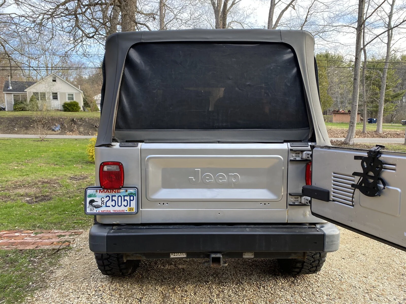

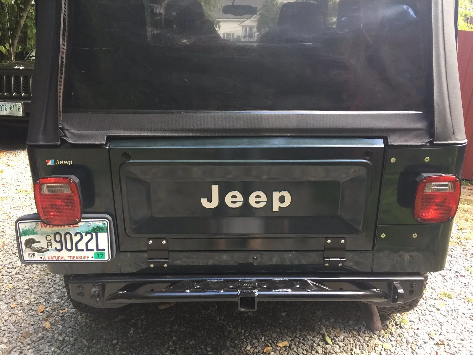

Got sick of looking at the swing out tailgate with no spare while waiting for my paint to arrive, so I mounted the CJ tailgate in primer. It was probably a good call since I didn’t damage fresh paint mocking it up. I’d rather look at this than the alternative! And I’ll paint it and the half doors once the paint is delivered.
Last time I did this I modified a CJ reproduction tailgate seal and the fit was terrible. This time I repurposed the TJ seal and it worked much better. I just have some tweaks to make where it meets the tailgate bar when I put it on for good after paint.
I’m not sure what I’m doing to do at the stock hinge locations. Last time I used Poison Spyder corner armor hinge delete plates painted to match. They’re not available anymore so I’ll either make my own or come up with something else.

Man I really like that look. I know some don't but it just looks more natural to me.

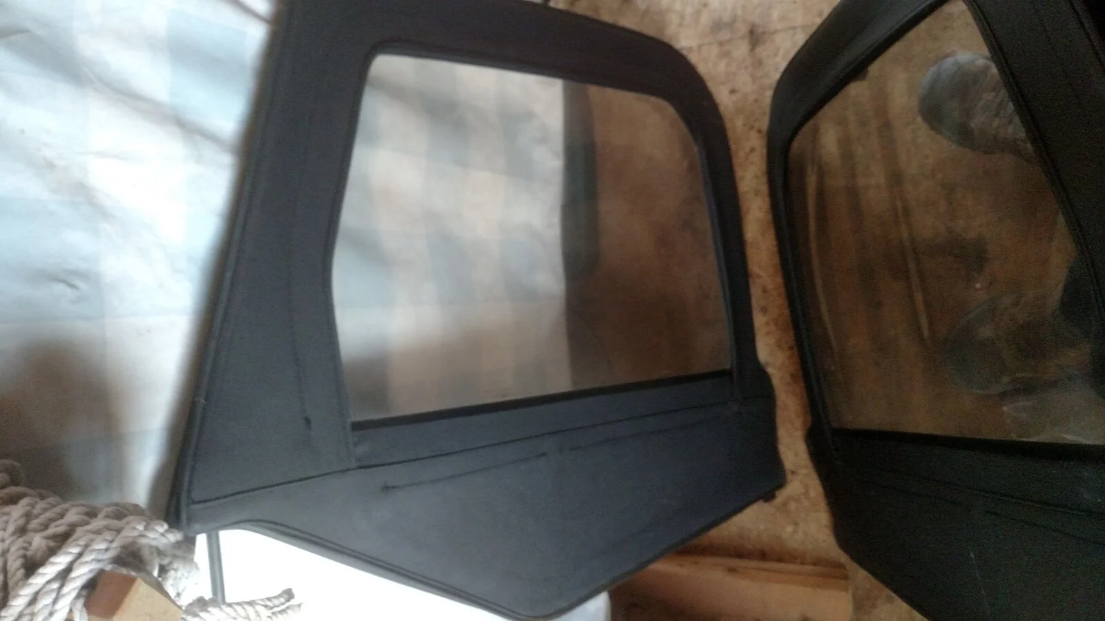

Just a little progress on the half doors… Got them stripped down and ready for prep and paint. I’ll also test fit them next time to make sure the alignment is good and that I don’t have to adjust the hinges

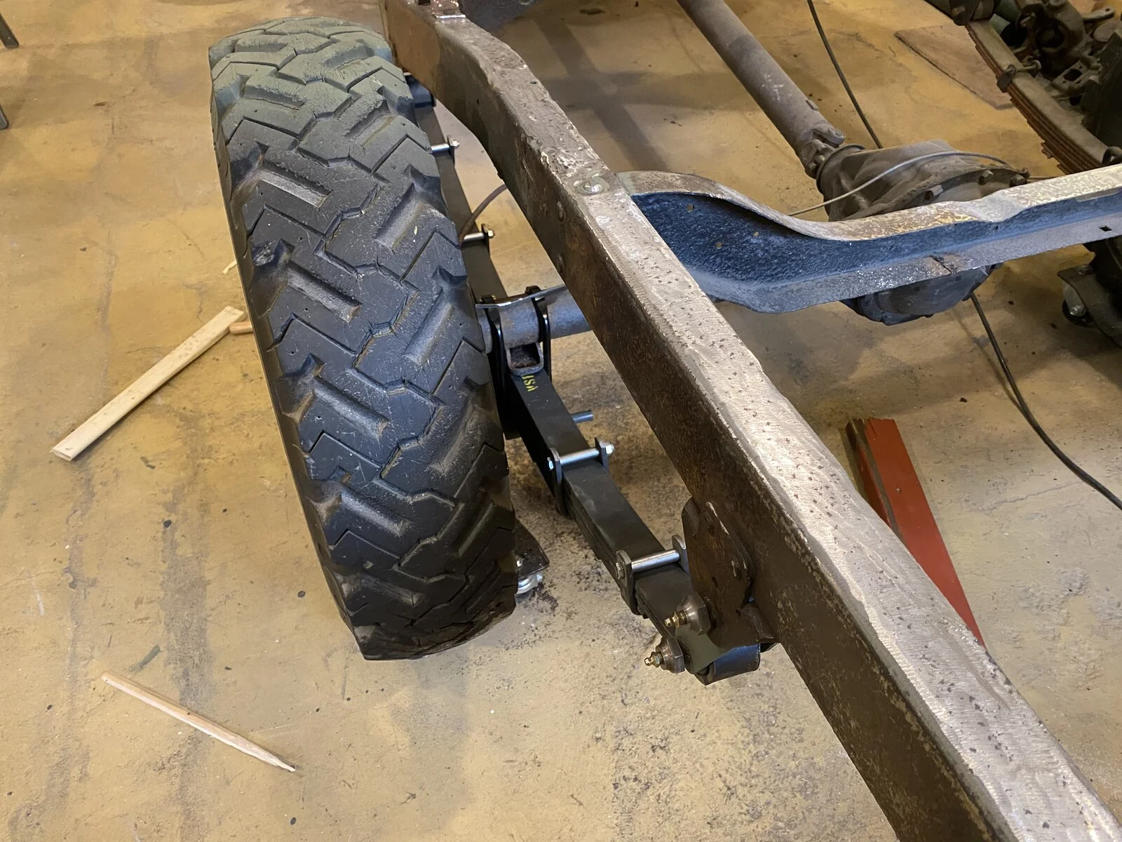

I also got a little done on the Willys PU. One spring and shackle swapped out. A PO welded the castle nuts to the frame, which slowed us down considerably.

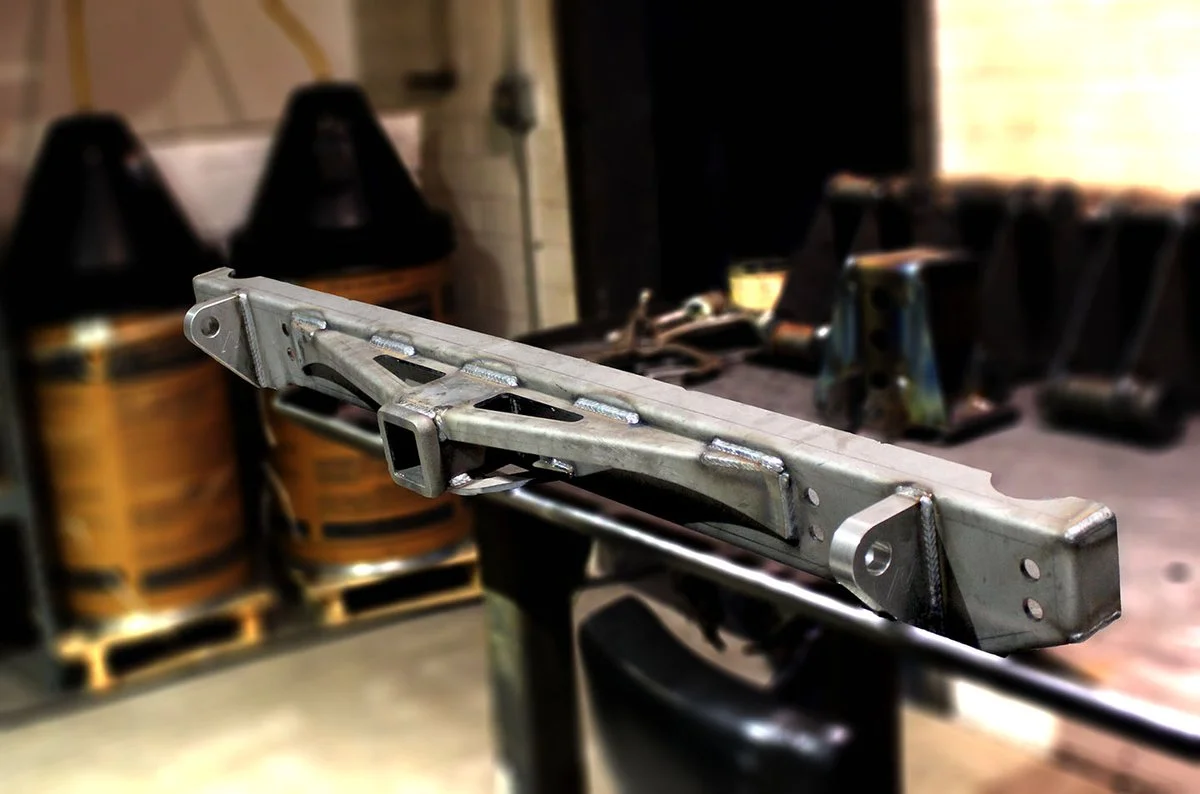

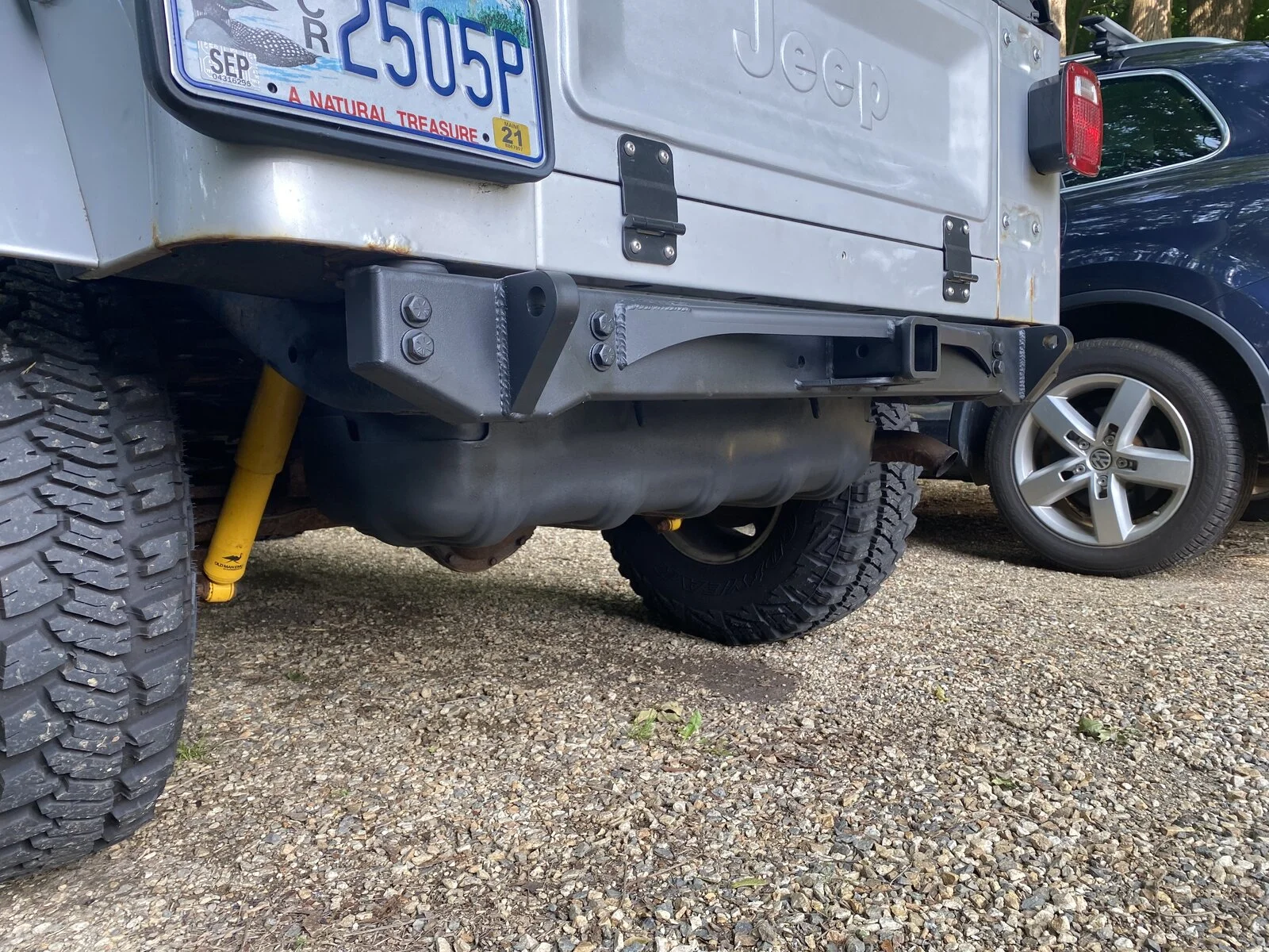

Well, I could stand the stock rear bumper and low-hanging tow hitch no more! While I don’t mind the stock rear bumper for what it is with a spare, I hate the look with the CJ tailgate.
Next Venture High Clearance Hitch Bumper ordered!
From their site:
I really liked the Swag version I had on my last LJ but they’re only offering the unwelded kit. And I thought about adding a hitch to one of the other rear crossmember bumpers out there but this looks well done and I have plenty of other projects, so I don’t need to make this harder than it has to be.
Edit: My last LJ for reference.

I did (finally) receive the NV bumper and installed it. Loved it.

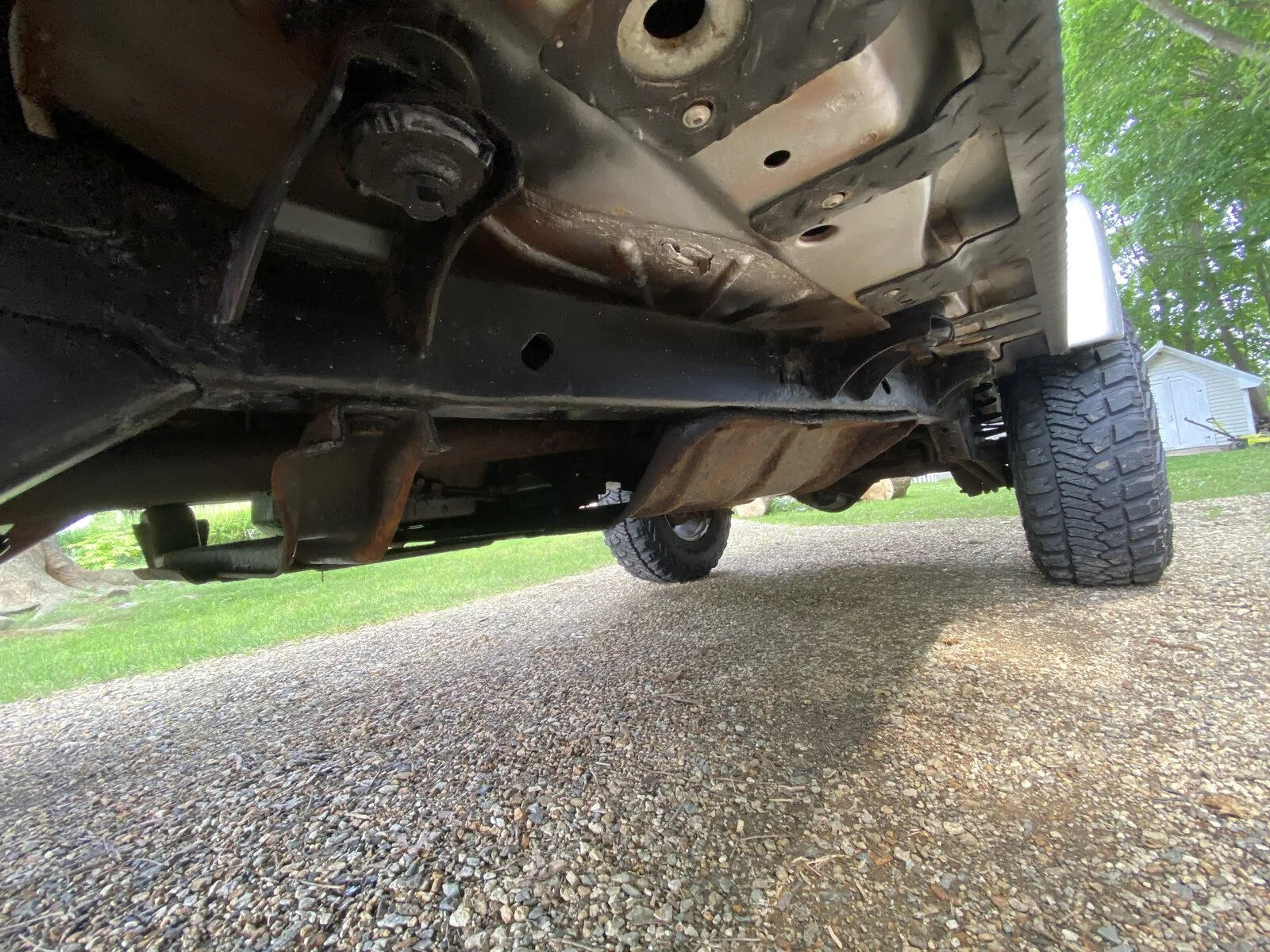

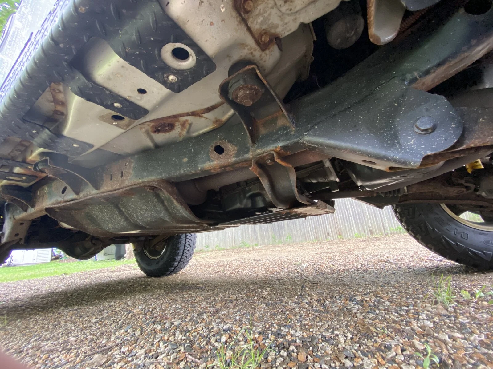

Spent a lot of time with a grinder and 40 grit flap discs taking the frame and torque boxes to bare metal. Everything was solid.
Some before and afters:

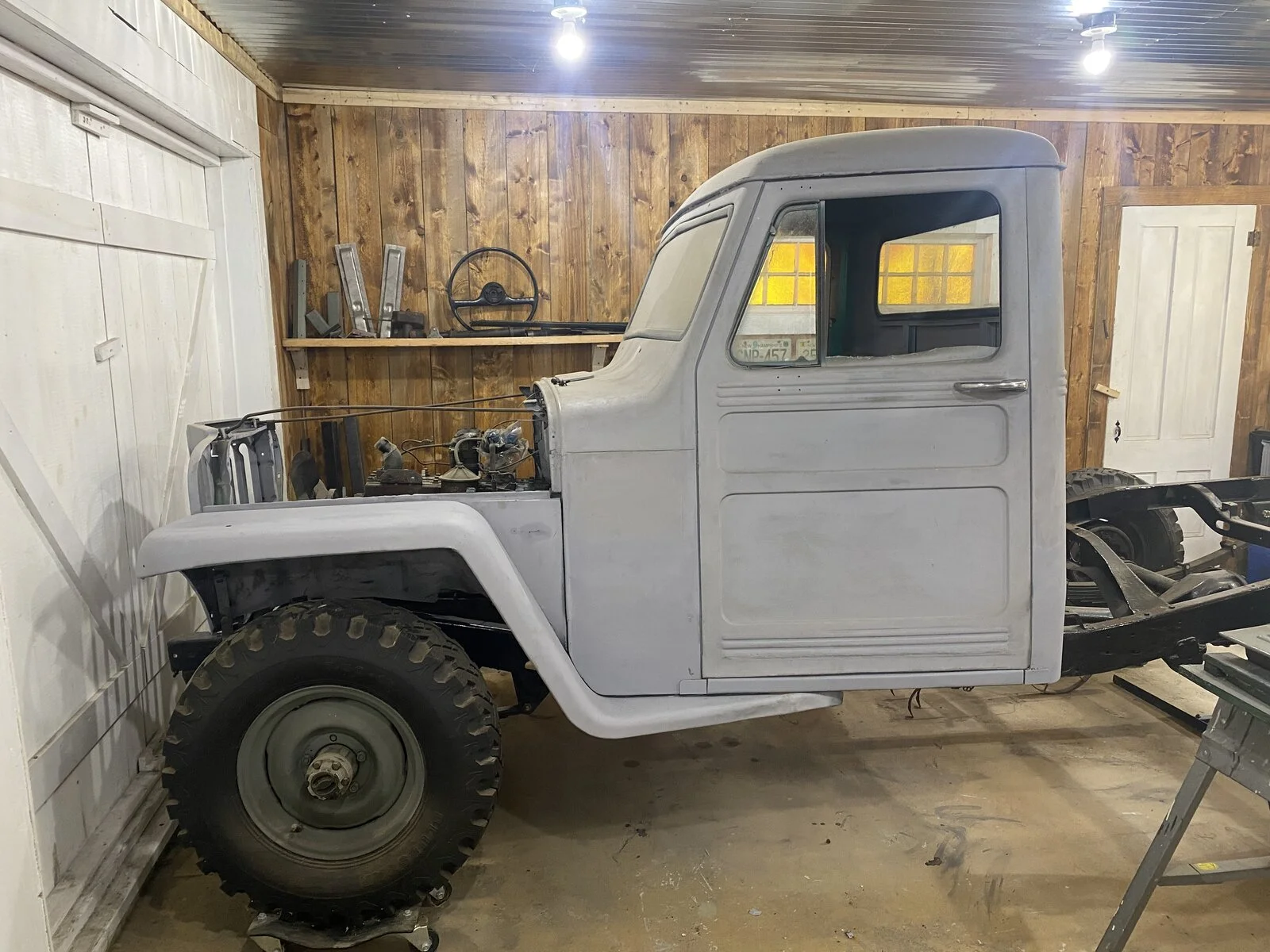

Frame is all cleaned/patched and painted with POR.

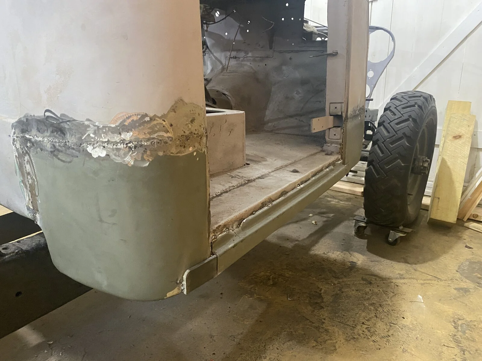

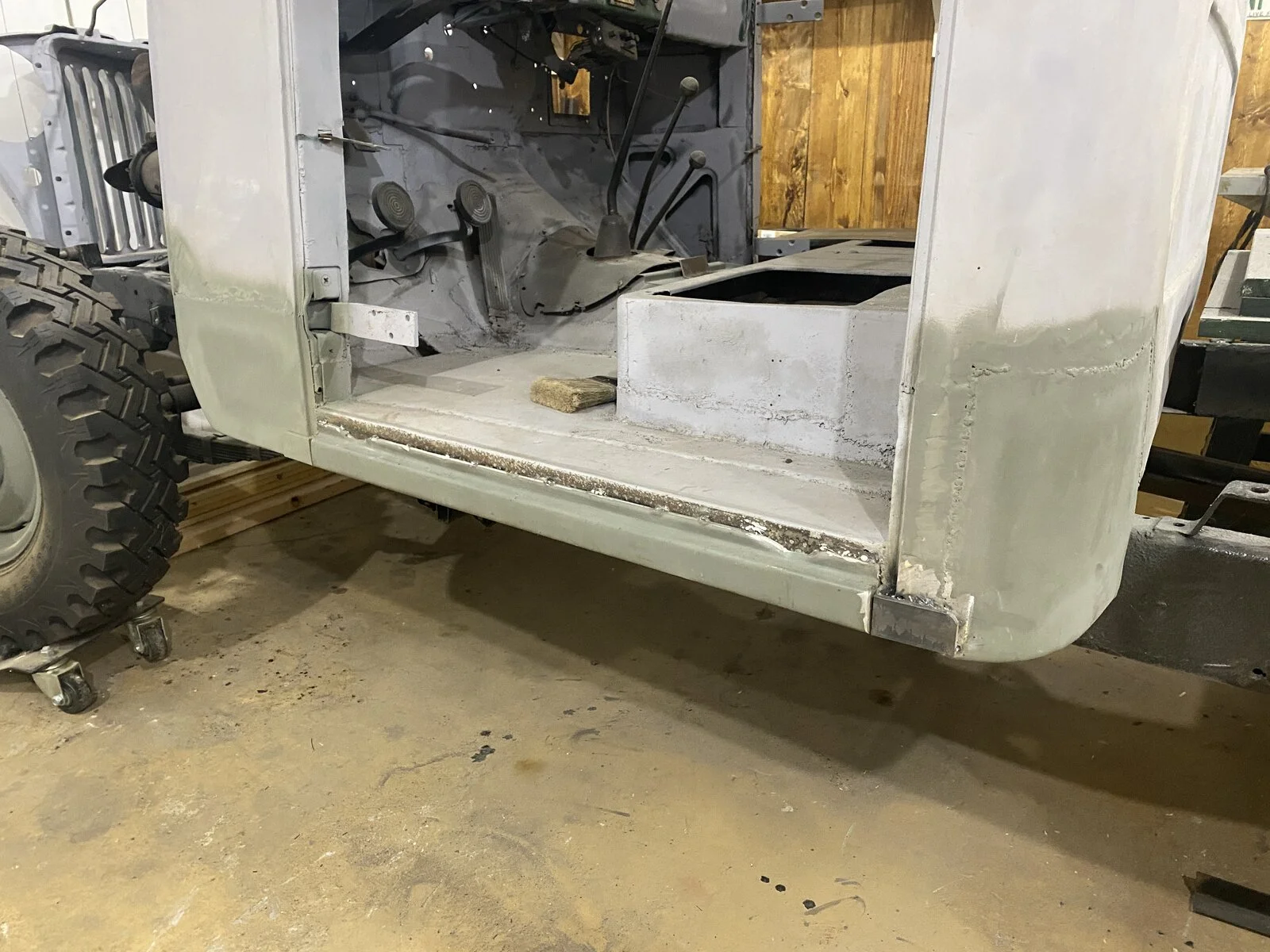

The previous owner(s) had cut out and replaced much of the floor. There's still some clean-up work required.

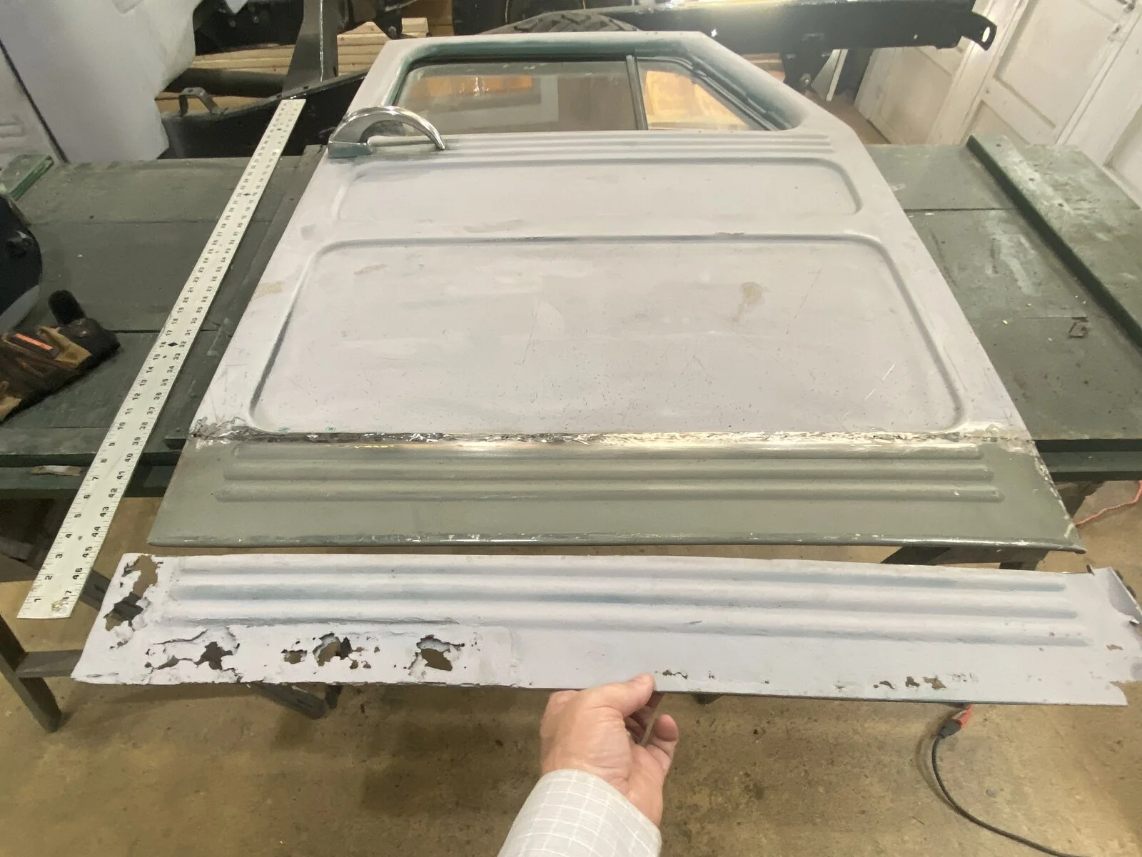

All of the bad sheet metal has been cut out and patched. Both lower cowl panels, sills and rear corners, as well as the passenger-side lower door with replacement panels from Walck's 4WD. We have the panel to do the driver-side door, and we're just trying to decide how far to take it. The doors were a pain since the edges are all bent at 90 degrees, and after the existing panels are cut out, the new ones go on and have to be bent around the door structure.

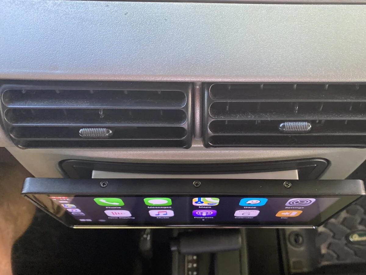

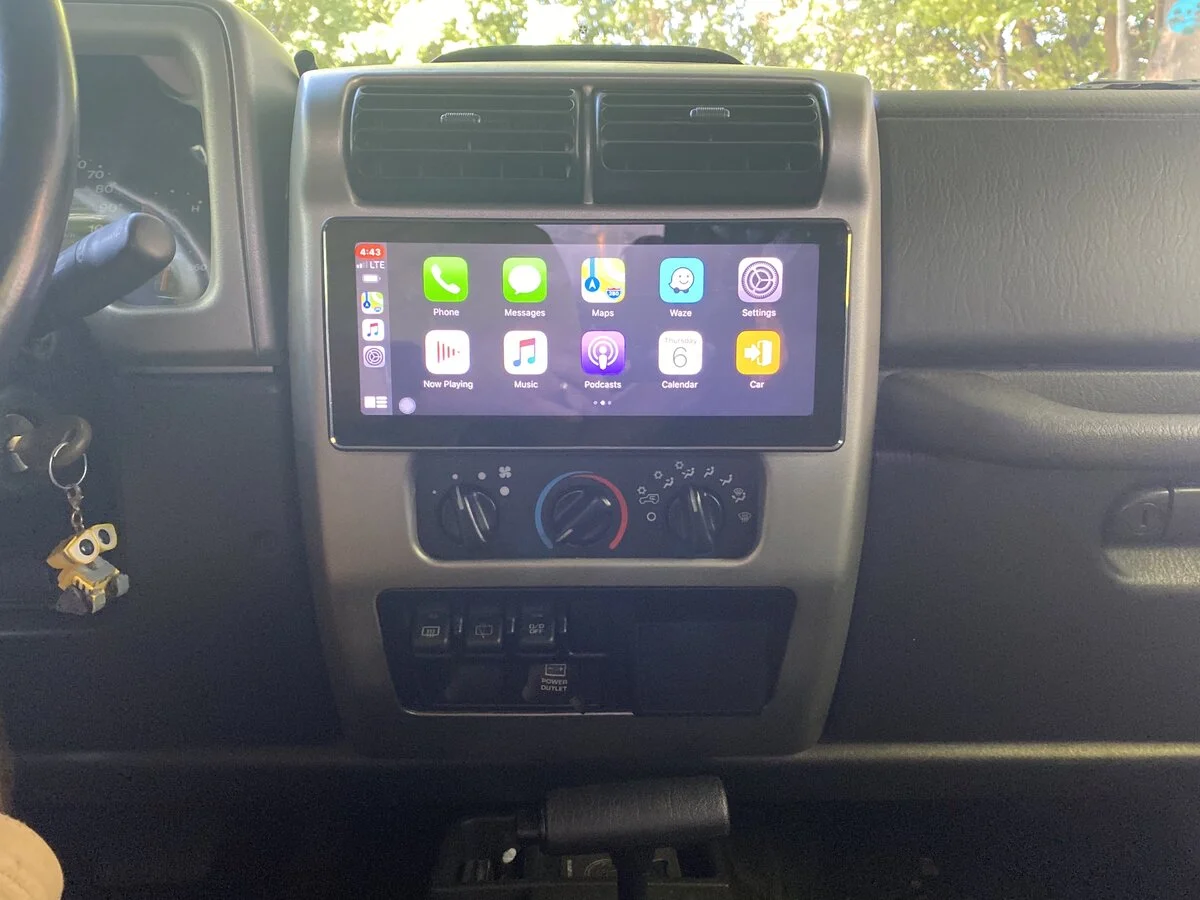

There are probably some things that I should've done first, like brakes or addressing the fuel sending unit. But I just couldn't stand the stock stereo any more. Last night I installed a Joying 8.8” single-DIN Android floating screen head unit. The widescreen aspect ratio fits perfectly between the vents and HVAC controls, though I need to adjust the screen up a little. It has wired and wireless CarPlay, and looks and sounds great. And because it’s single DIN, I was able to keep my silver bezel.
Now to refill the Jeep fund for whatever comes next.
I just installed the 7in single din version. Any suggestions for setting the equalizer?
