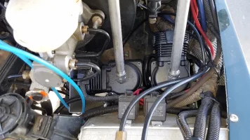

I'm interested in this. Does anybody have specs/dimensions? I've got a modified Smittybilt compressor mounted in my engine bay and would love to be able to double the capacity if there is room.

I tried to compare it to a twin ARB, but ARB only give amps at 0 psi. I have this one. It looks like the Smittybilt and draws 45 amps max. It is not inconceivable for a twin to draw 90 amps. The cfm rating at 29 psi for the Summit is 6.36 and the ARB twin is 4.68.
