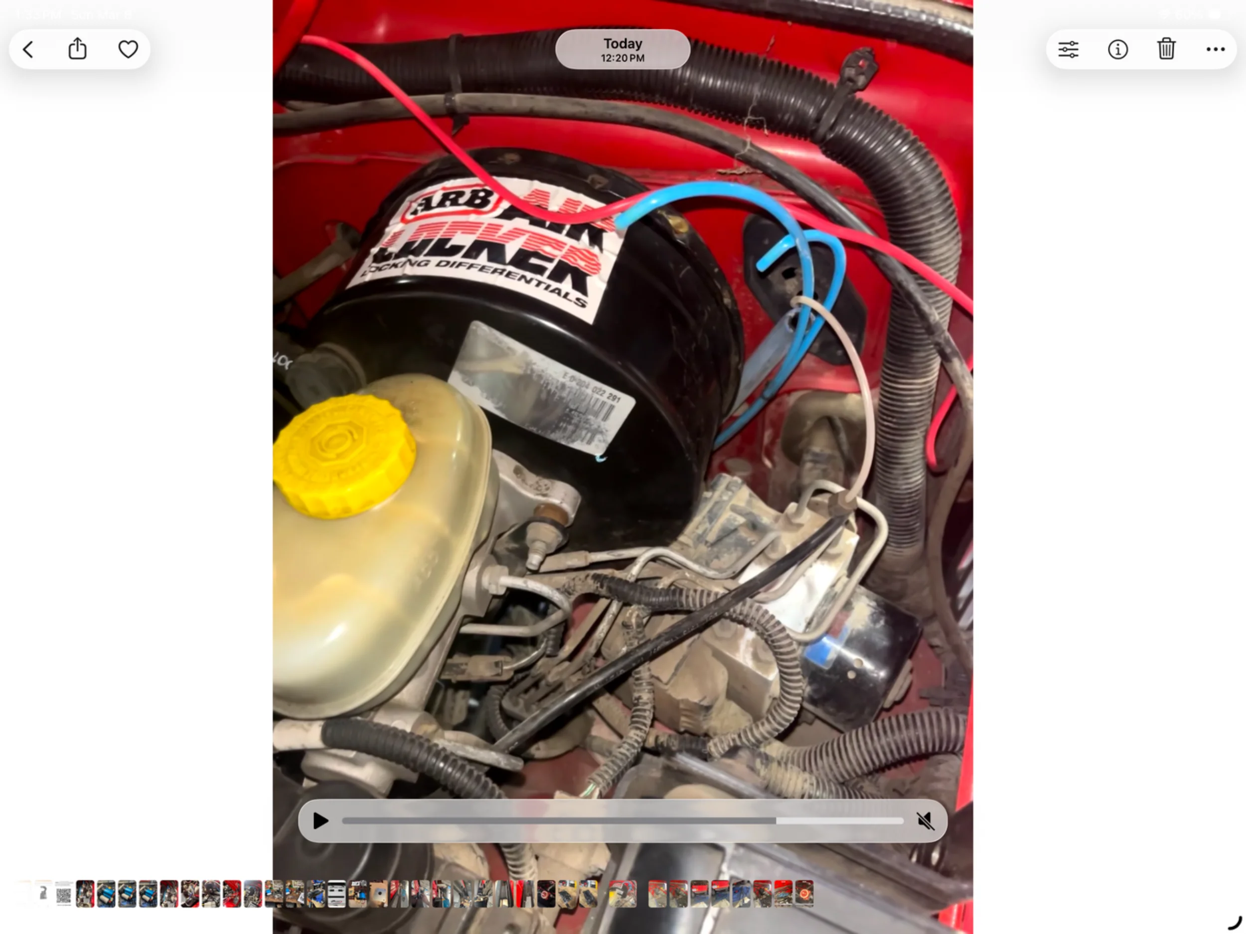

removed the old, sort of, arb locker wire harness attempted more getting that manifold off of fab bracket, gave up, need new drill bit set, a bench drill press is on my tool list.

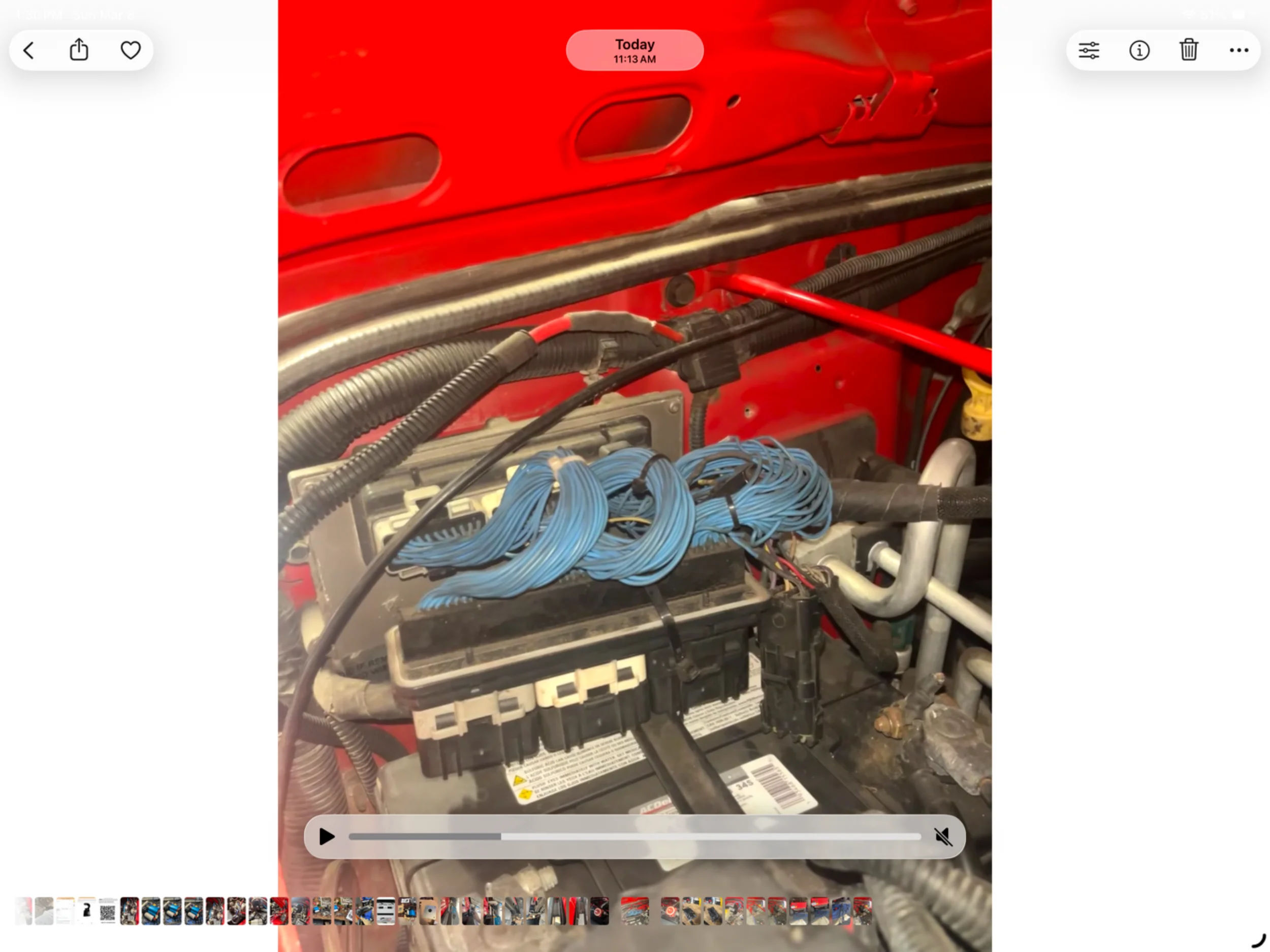

just started pondering how to piggy back the tuner cpu, in cleaner looking manner

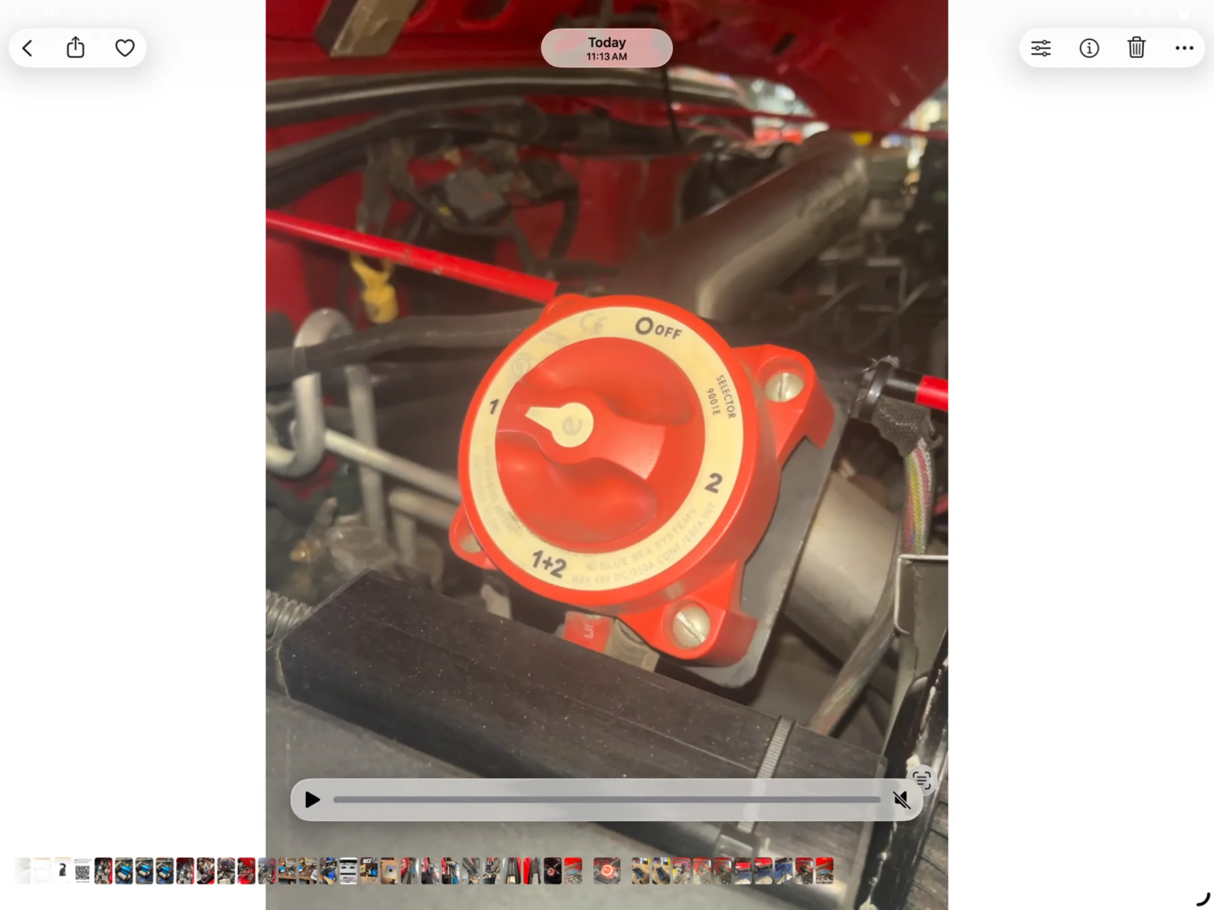

decided to remove dual battery switch and mount the aux beam relay box there when I start that project

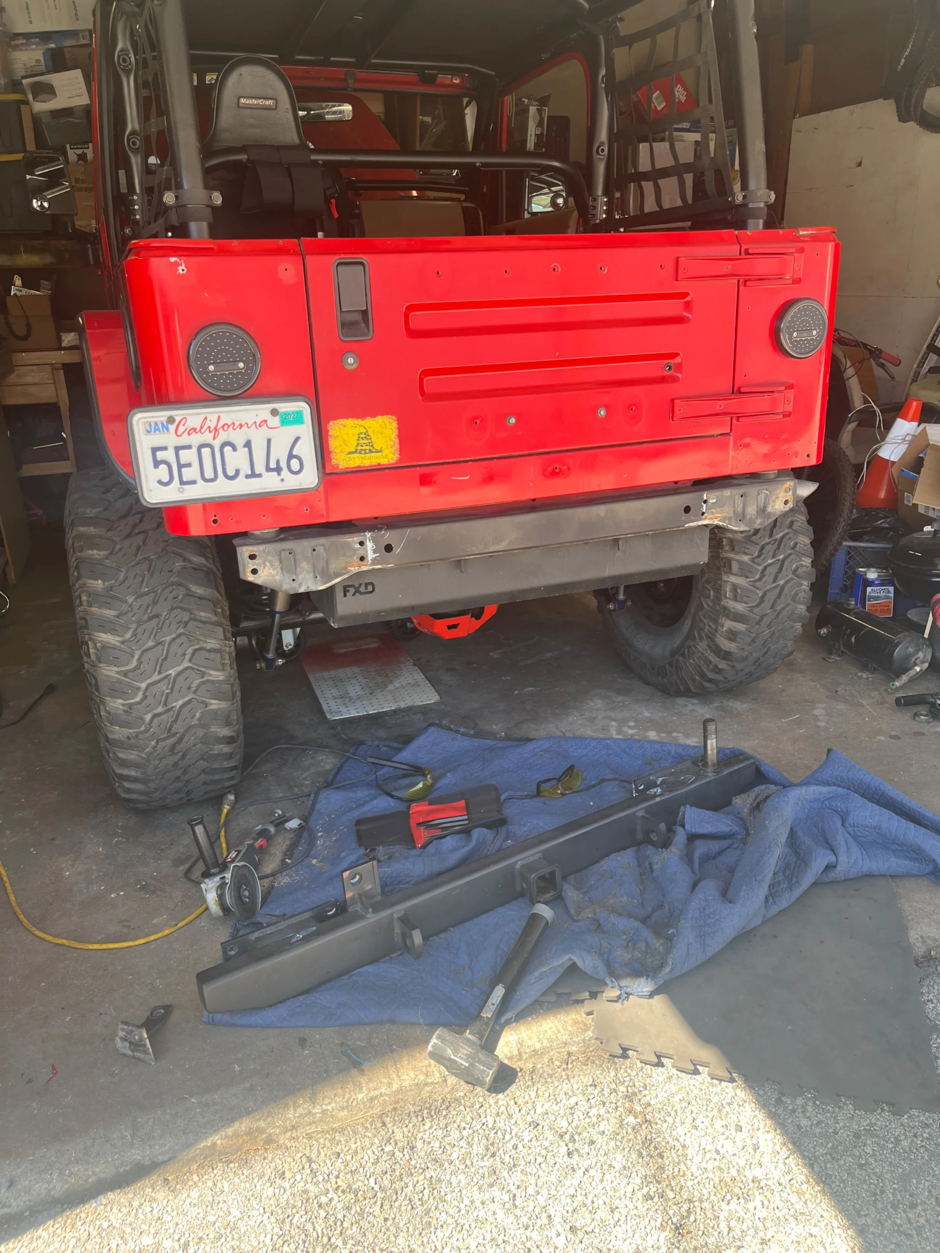

And…..finally I removed my rear bumper, the thing is tweaked. I want to go with bumper delete look and I am. My GEN RIGHT wish list just grew.

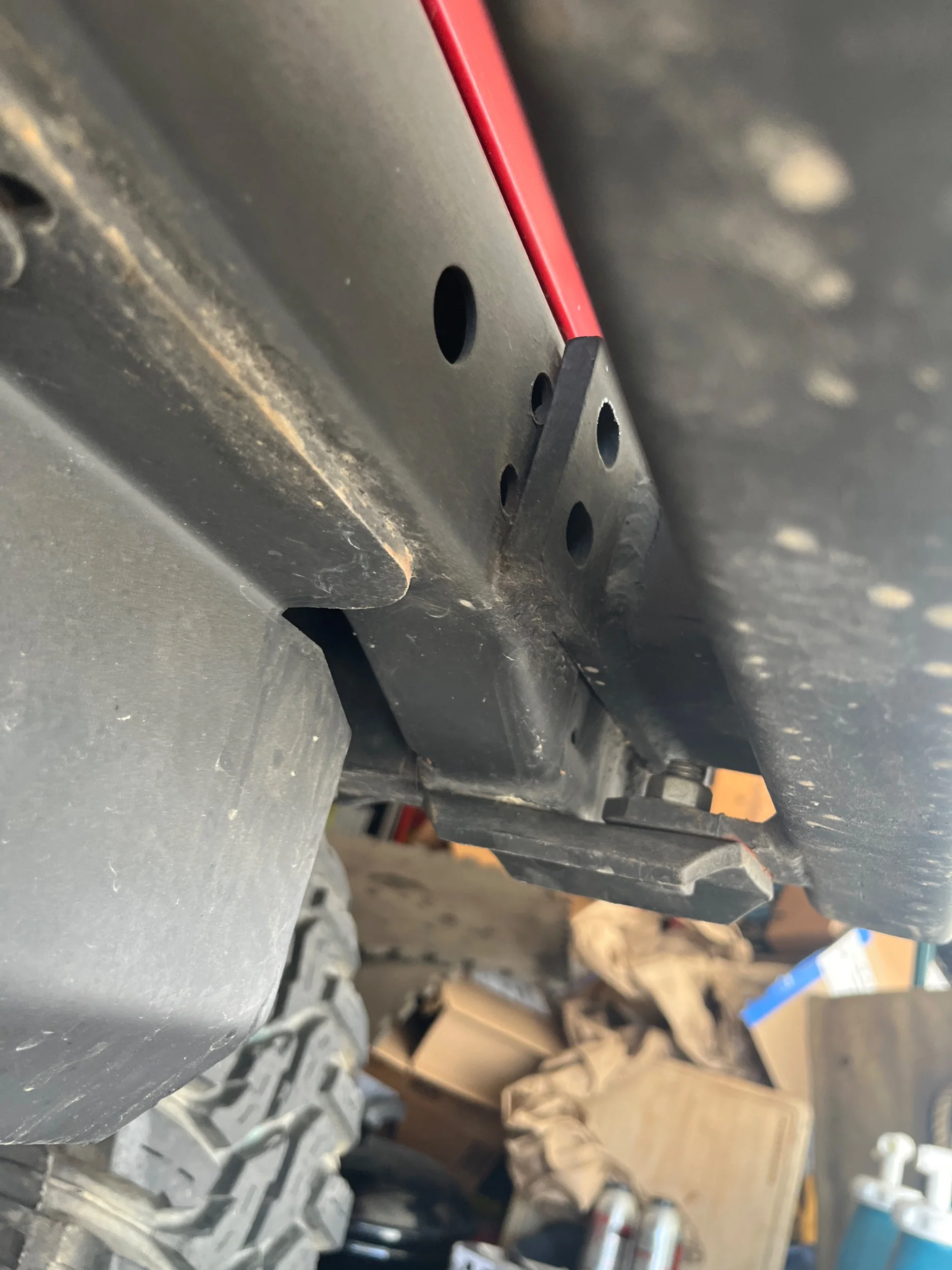

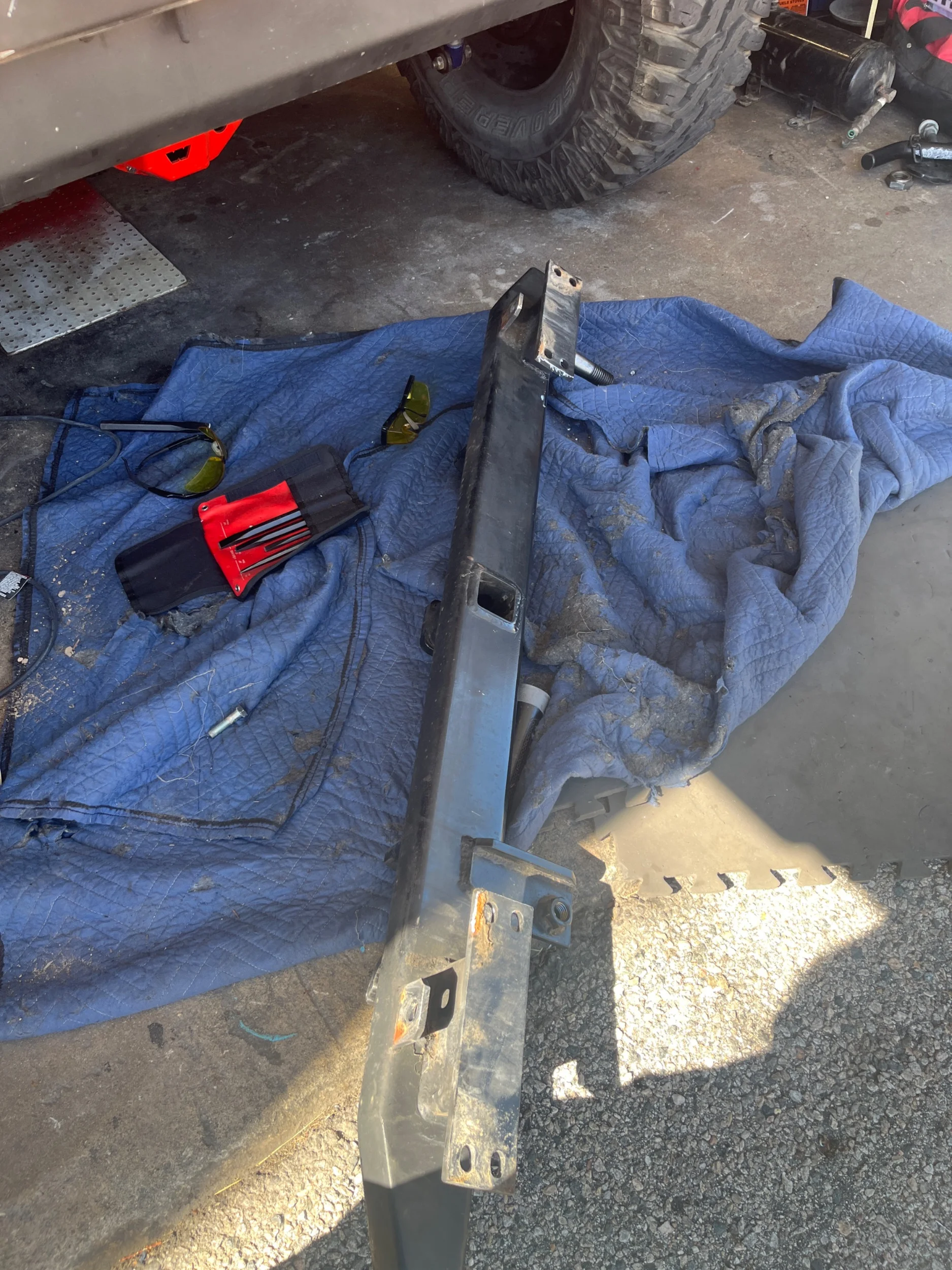

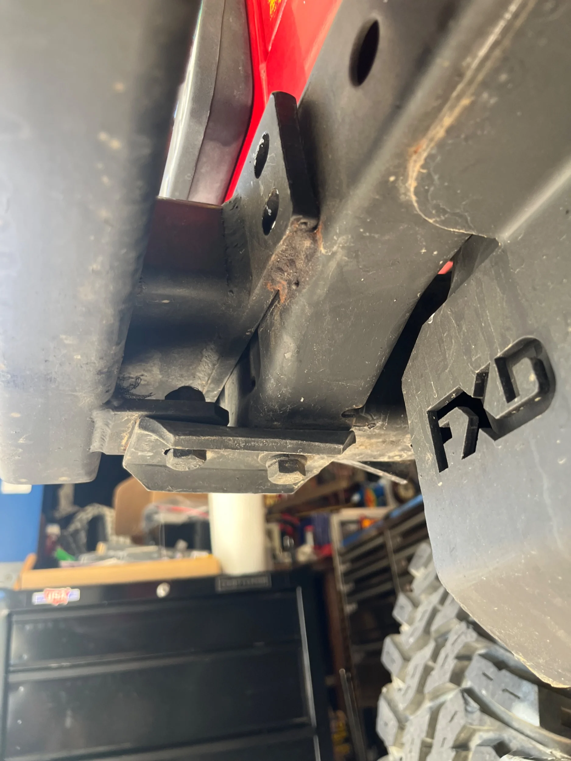

I thought it would be an easy removal…..NOT!!! Has to grind some welds. It’s not pretty, but same on both sides….HA.
The bumper would make a nice bumper air tank. It is NOTgoing back on this rig. The red wire loose near fire wall is my for amp feed had temporally strapped to old arb harness.

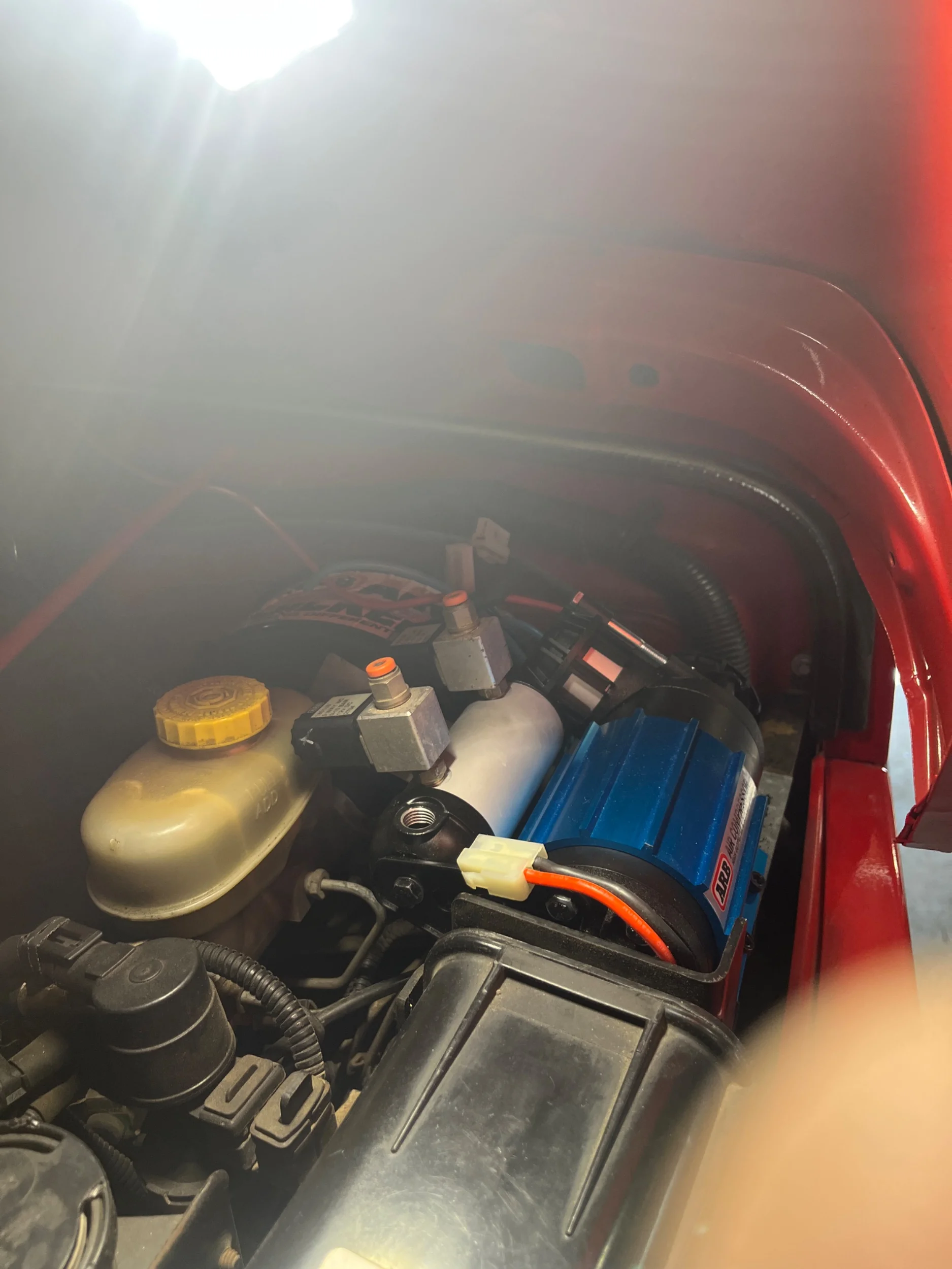

I am on a fencepost on getting that compressor bracket that mounts off of the brake booster.

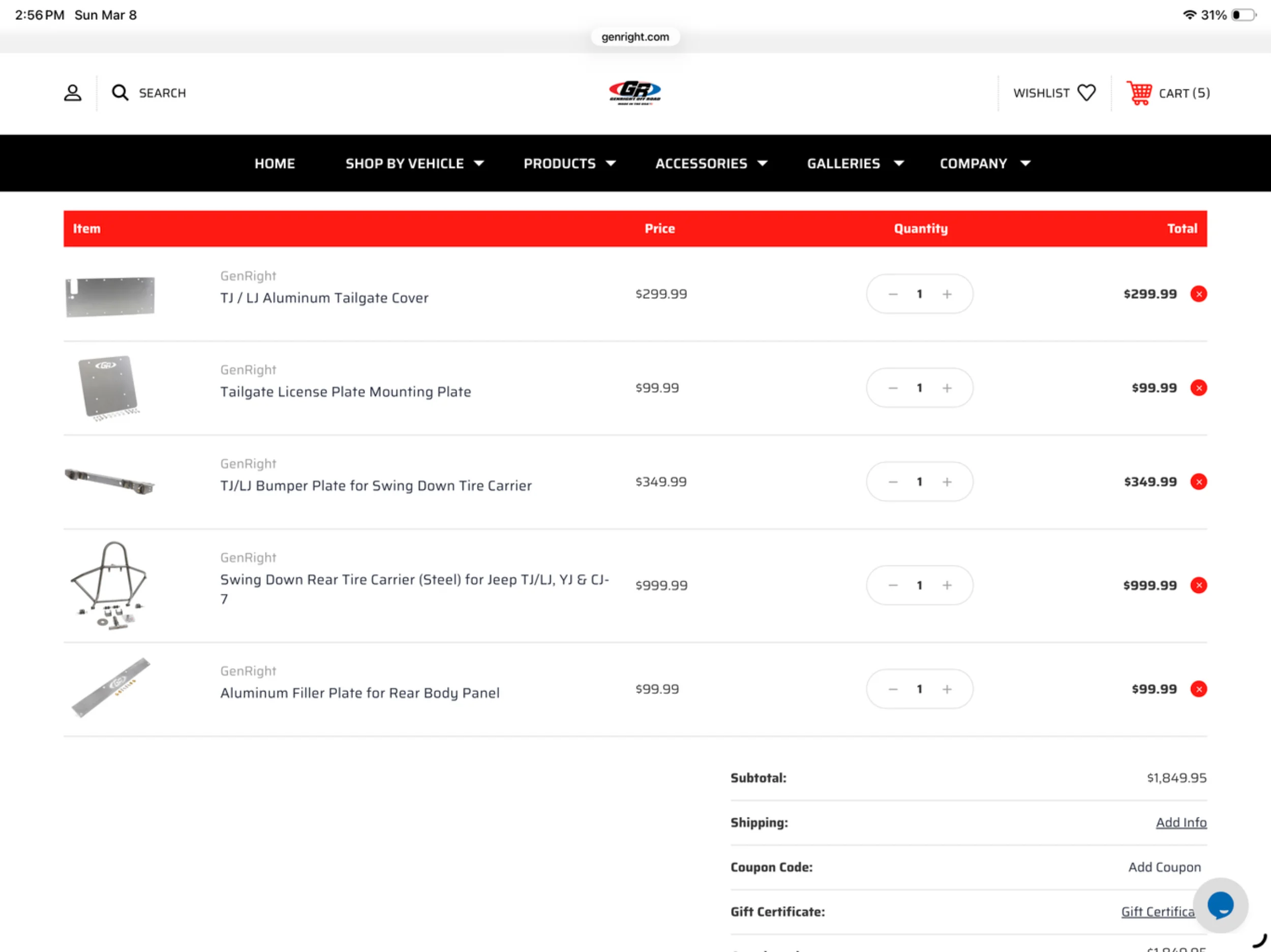

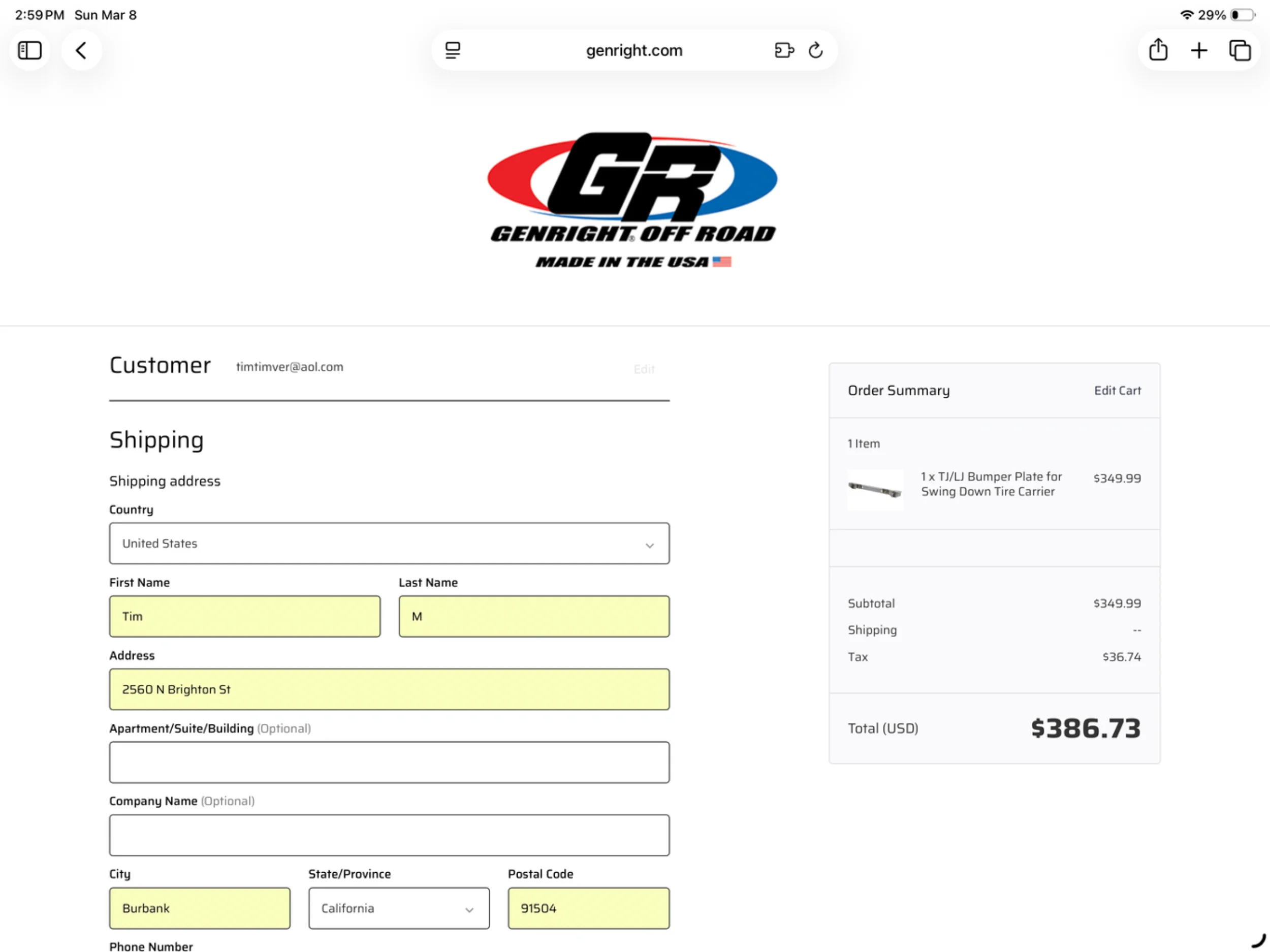

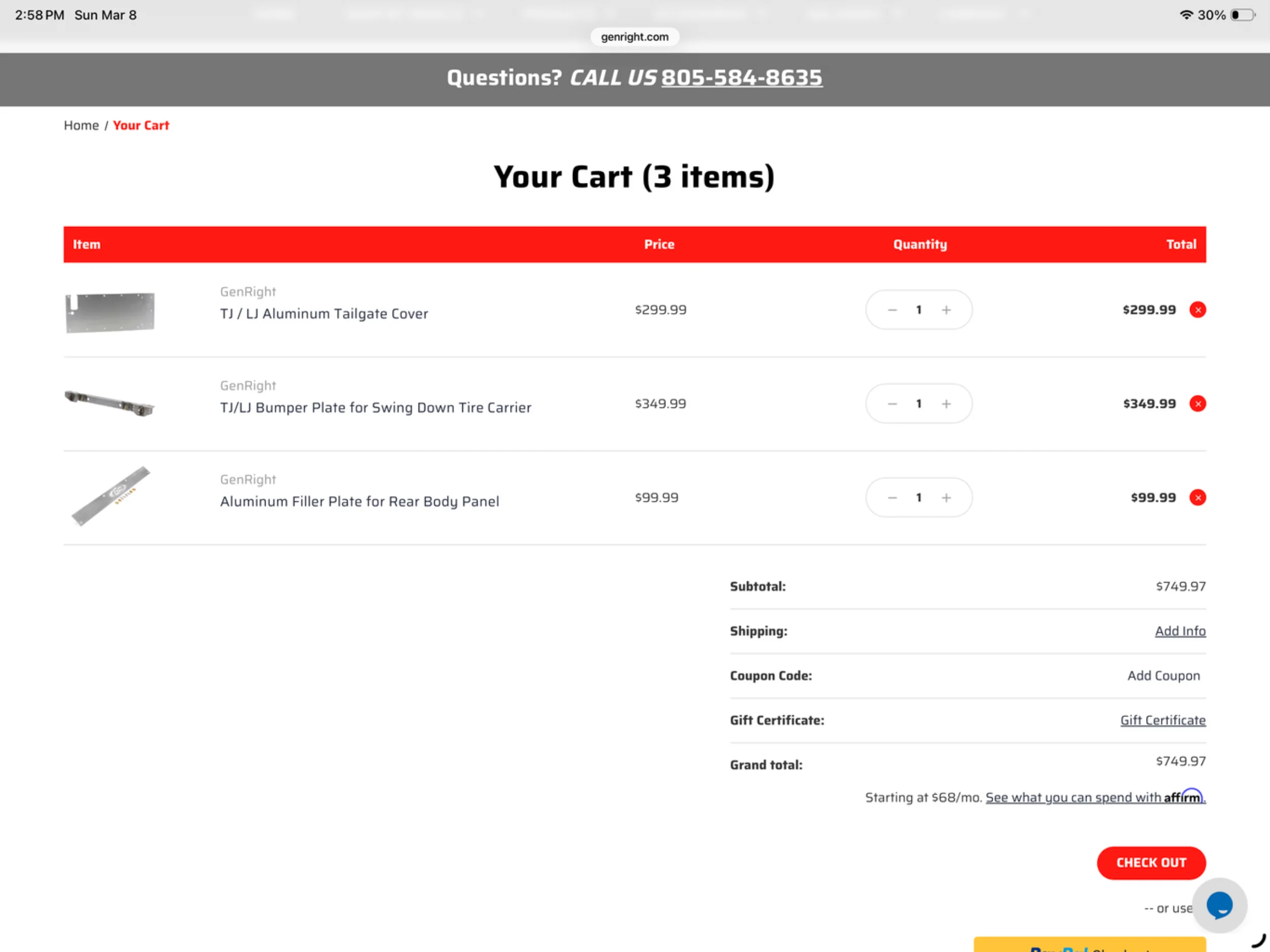

To start, I am going to get the drop down tire carrier bumper plate next month. It will be a nice drive to pay them a visit, WITH CASH ONLY FOR BUMPER PLATE, NO CREDIT CARD, when I visit. I would like to have hitch receiver welded on plate as well.

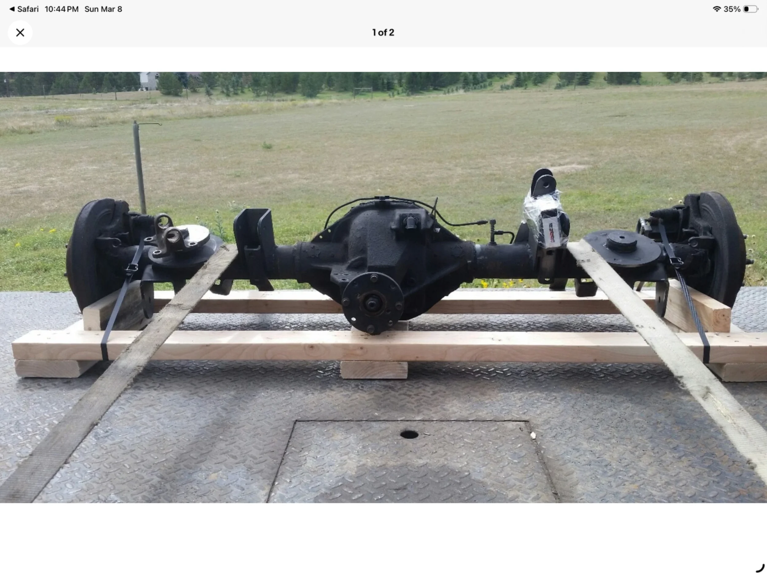

At this point with the rear end issue, I want to get 5” stretch kit. There are only two that I can find, Barnes and Clayton. GR 8” is over my bounds and pricey and more labor
Any Suggestions?

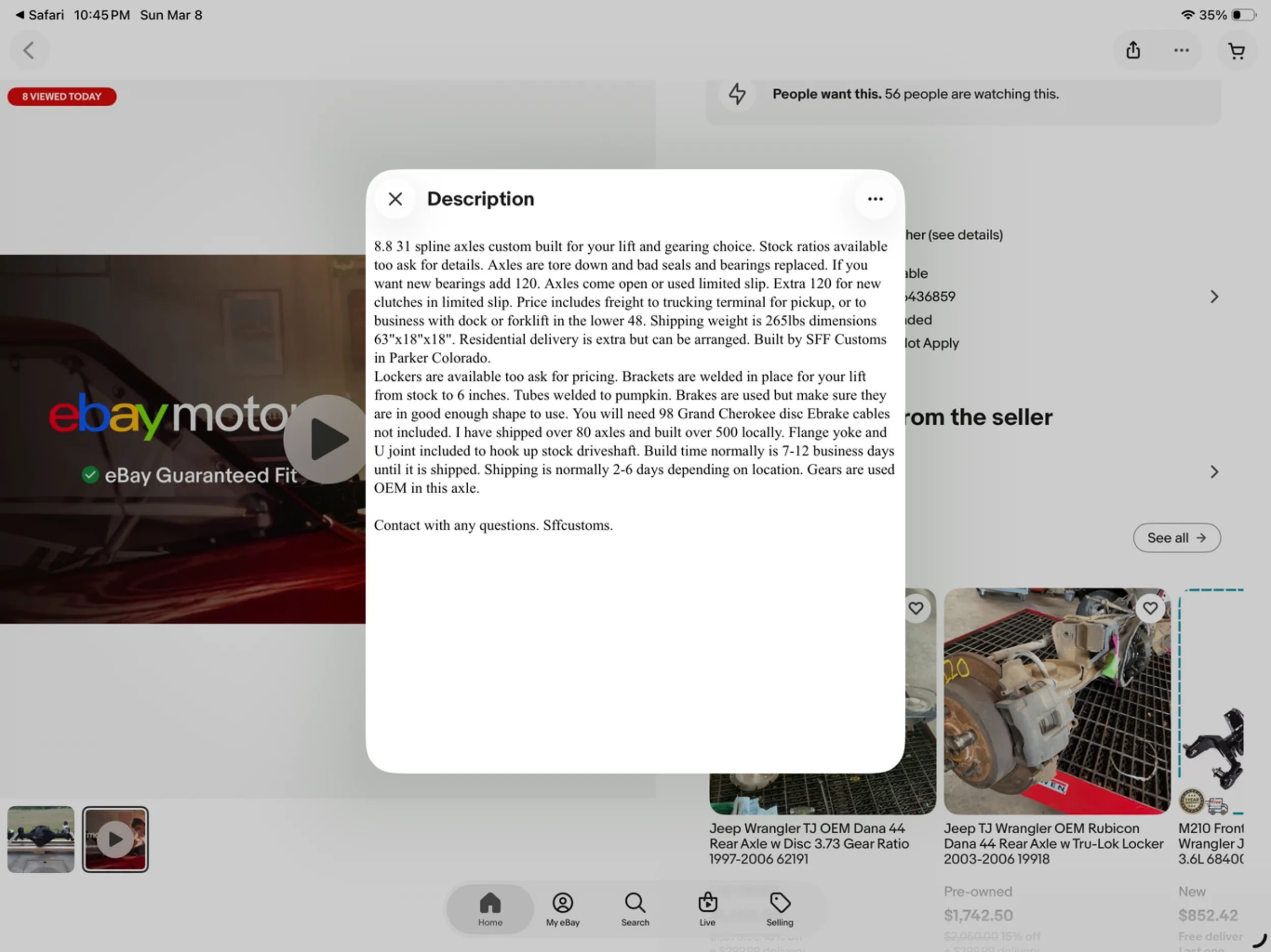

8.8 for 02 TJ on EBAY, its out from Colorado.

I managed to drill out the manifold mount screws to bracket. I gave a whirl, it does not fit as envisioned and hotter in that corner I would imagine.
I will order booster mount bracket with the amazon returns.

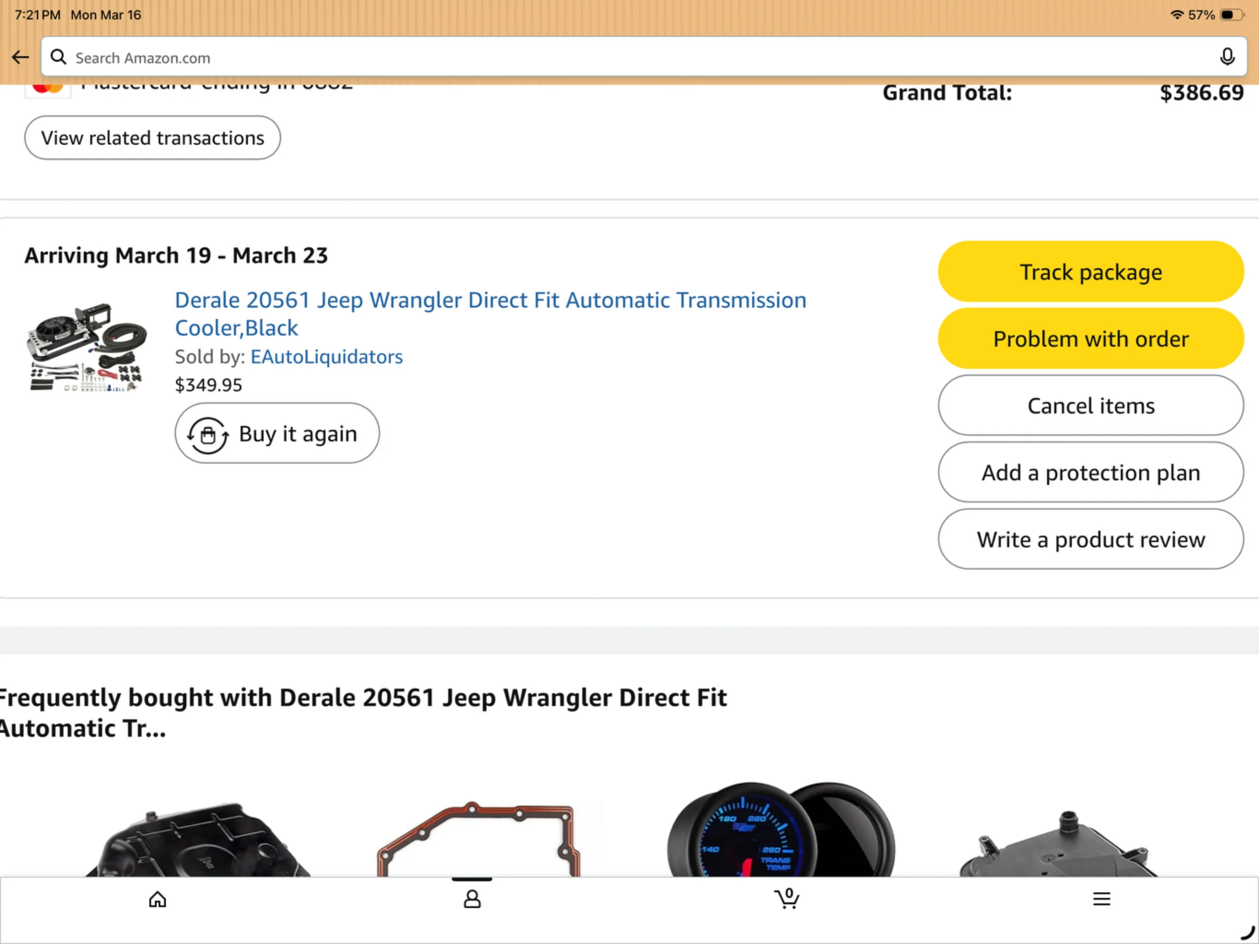

I have abandoned any trips to Gen Right anytime soon. I do intend going with them but not getting the drop down tire carrier. Thinking bumper plate with tow points, corner guards and rocker guards from them when on sale. The GR swing out carrier is nice but pricey. The carrier from Rusty’s is a consideration. No Jeep trips anytime soon with current gas prices, crazy here in so cal. I have a full tank.. I need to focus on what needs to be wrapped up. I did tap into GR fund to get a transmission cooler, couldn’t resist the price. I intend to get a higher capacity Transmission pan and temp guage next month. I have everything to flush out cooling system and replenish.

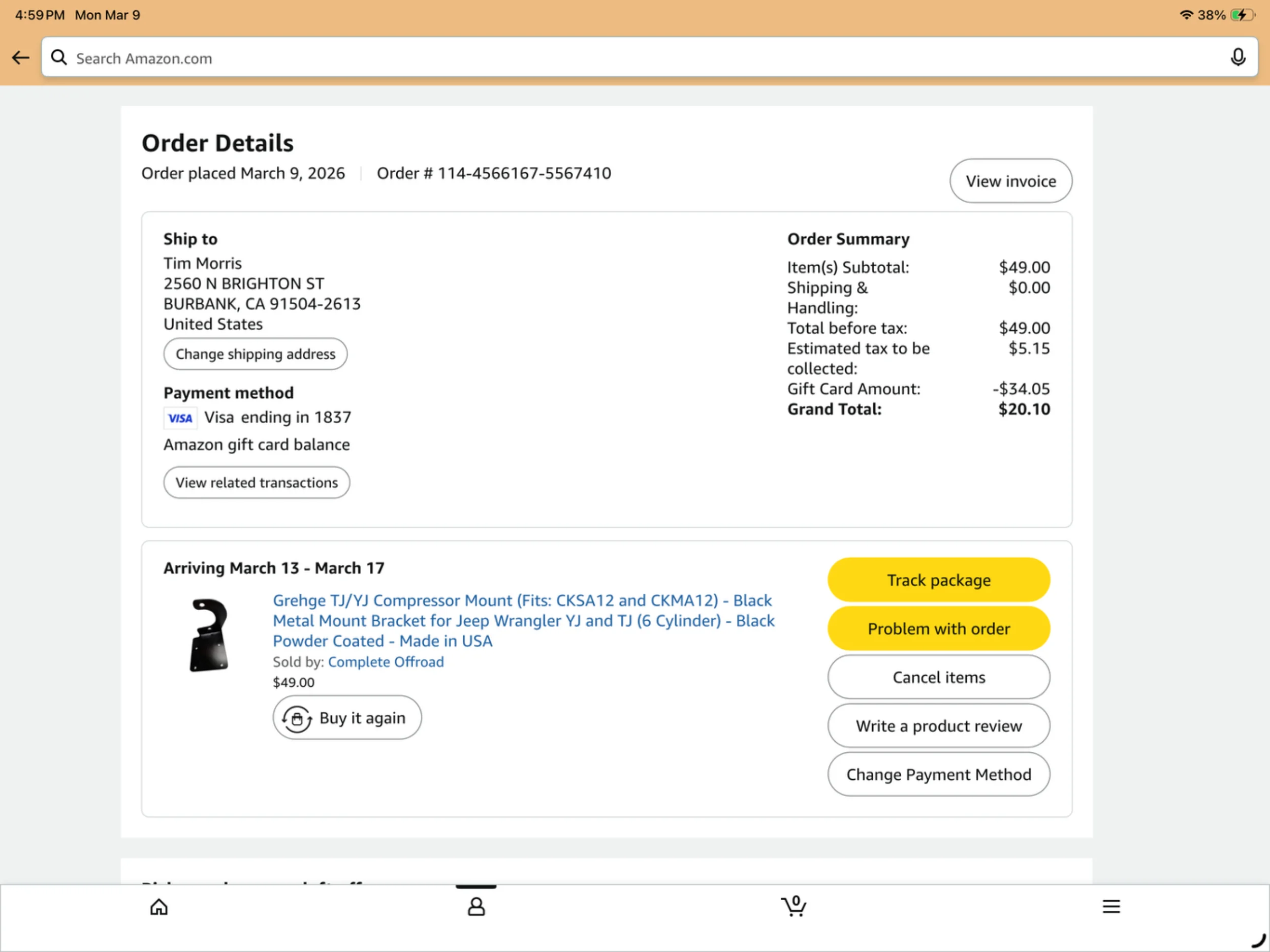

The ARB compressor bracket should finally roll in tomorrow.
