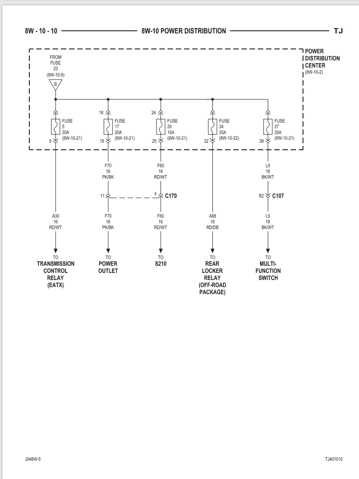

03-04 TJ input about EATX relay
Almost 200 miles today with multiple stops. Everything seems normal without the EATX stuff plugged in.
Reactions: mrblaine
Apparently not since neither of us knew we didn't install it.
I have 2004 TJ with the 42RLE auto. I pretty much no nothing about electrics.
So I was looking up how/where I could find a switched power source for auto trans cooler fan.
Saw this post, a bit old but, mine has no relay in the Etax location, had the vehicle for 4 yrs.
Seems to work fine just thought I would let you know.
Should there be a relay there?
