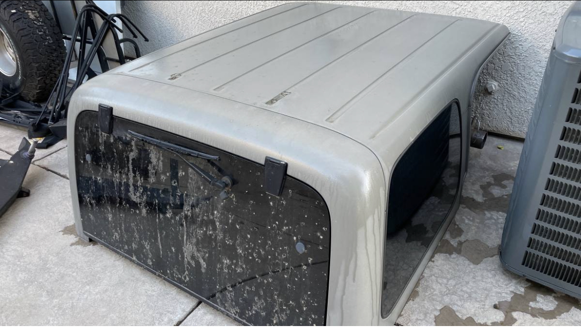

Will a hardtop off an ‘04 fit on my ‘97 Sport that I believe came originally (my vehicle specifically I mean) with a soft top? It has a rear window wiper so I’ll have to wire that which is fine, none of my dash switches over the cigarette lighter are used. Other things I should be aware of or look out for? It’s grey and has ribbing all the way across. Asking $1200, I know new ones are twice or 3x that.
Without a vented tailgate to go with it, the only issue would be the lack of venting which would require a harder slamming of the last door closed.
Some people will warn you about breaking windows when slamming that door. I'm not sure how often that happens, if ever.
