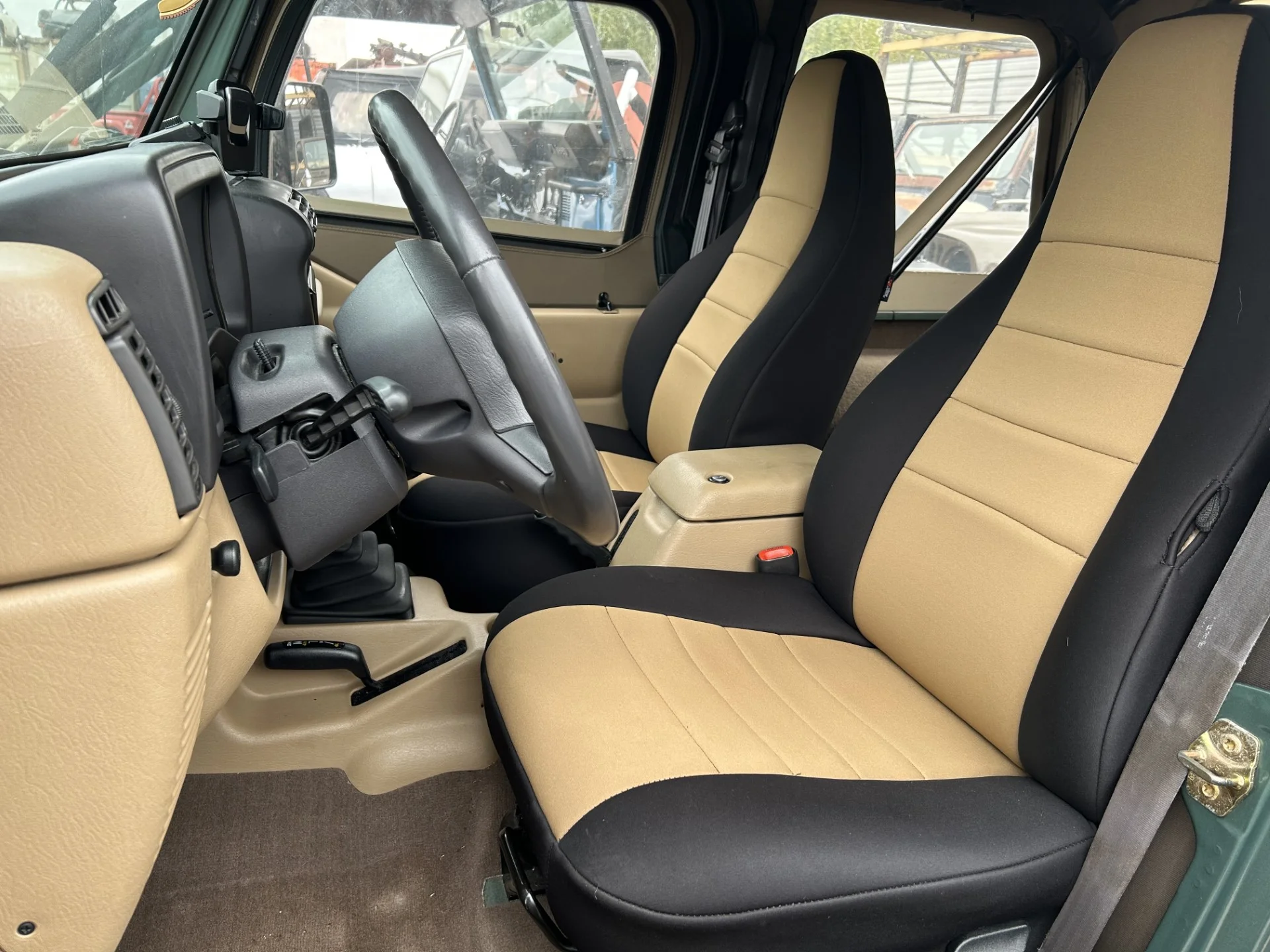

I am sure they are nice covers, but that prominent logo irritates me more than I can tolerate. I called them and politely asked if they would do a one-off without that logo or if they could put the logo in the backside of the seat, and they refused both (not surprising I guess).
I'm with you about logos. I was very happy prp had an option to not have one.
Too bad more companies don't have the mindset that if they make a good product people will advertise / advocate for them better than any glance at a logo can. Besttop comes to mind.

I've been pretty happy with my seat covers, and they are budget friendly. You'll have to look in my build as the name of the company escapes me right now.

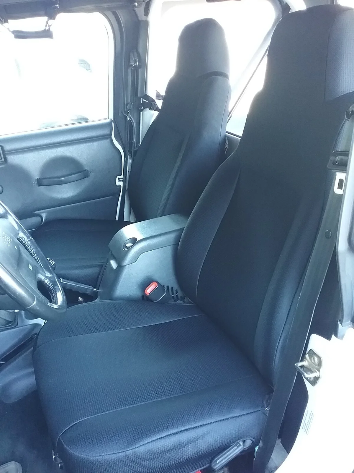

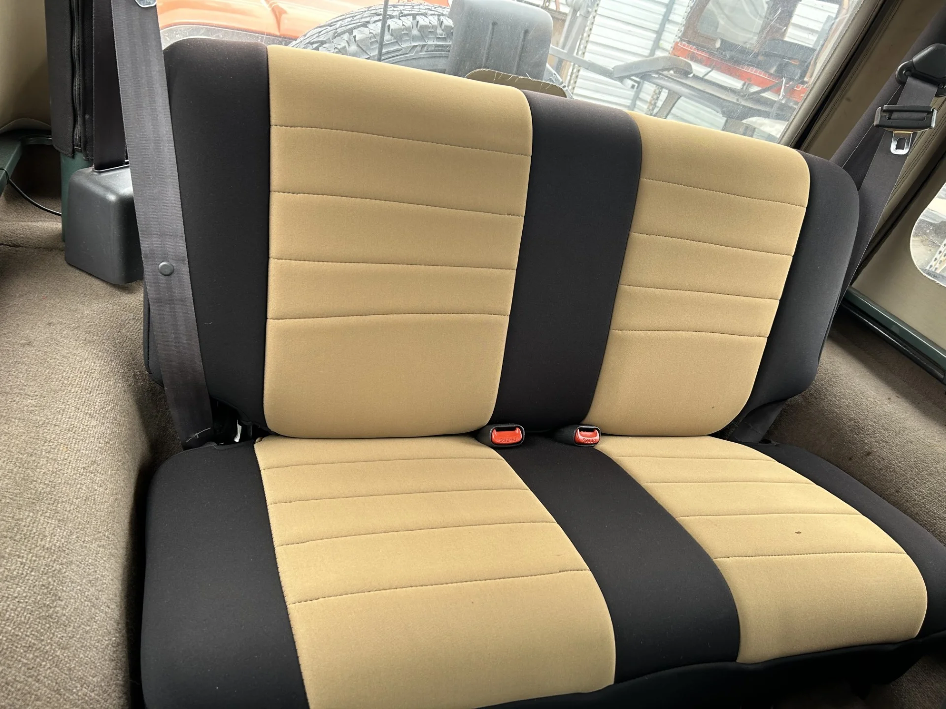

I think this was a great learning experience, however, it did drive me kind of crazy (my dad can testify). Next project is to rewire the side markers and hopefully get rid of the feedback in my dash. Also, seat heaters are all wired up and ready to be plugged in. Any suggestions on seat covers? Don't really want to take off all the stock covers and deal with all the pins.
Check out Cal-Trend seat covers. Installed them 2 years ago so far so good.
Seat covers can make your seats look better but both sets of stock seats I've had are not that comfortable to begin with. Isn't a cover just lipstick on a pig?
Reactions: PNW_LJ and JMT
Yeah, I've got CalTrend. The prices have gone up substantially in the last couple of years. I got a set for $140. They are way more than that now. Iggee's are still reasonable.
Even Iggee has gone up in price. Not a lot, but still higher than before.
Reactions: JMT
My dad "JMT" has the Cal-trend covers, I'd love a set, but kinda pricy for just a seat cover. Liking the look of those Igee covers, but I know a lot of people don't like the fact that vinyl is just like leather and gets hot and cold. These are just covering up some seat heaters, so I don't have to deal with taking off the stock covers.
If you wait long enough, I’ll probably buy some PRP seats. Then you can have mine. 🤣

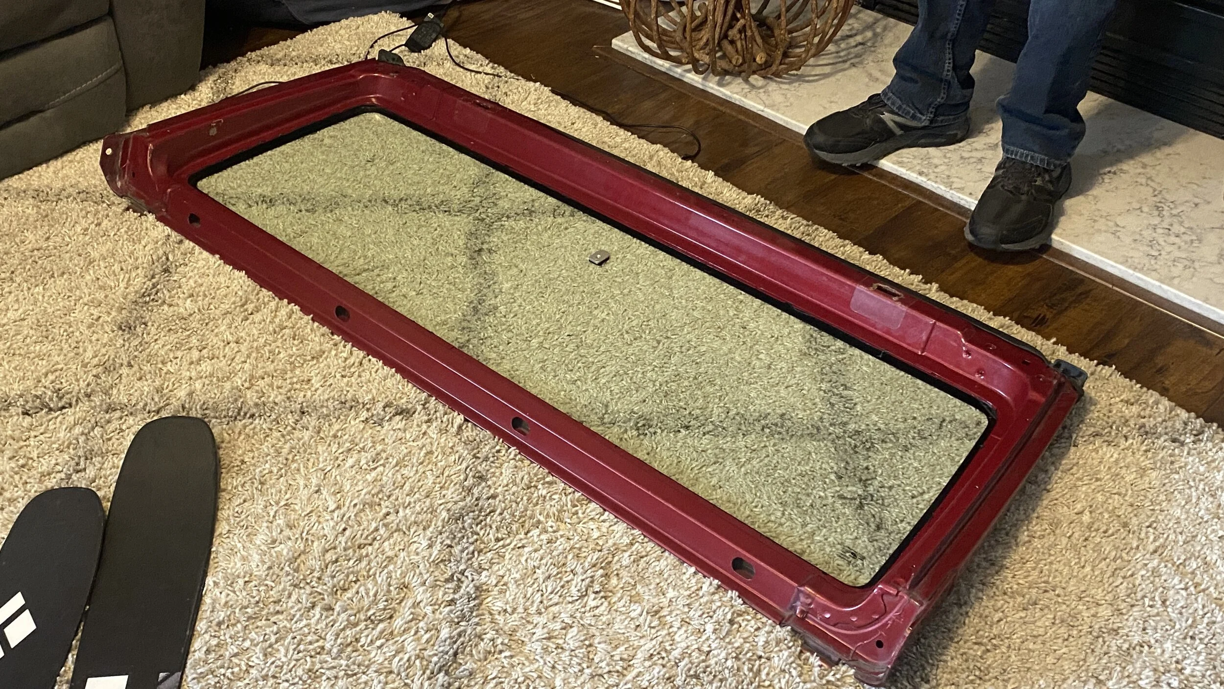

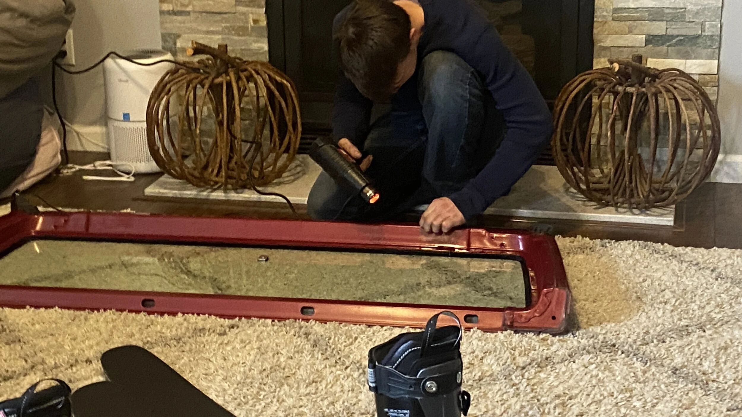

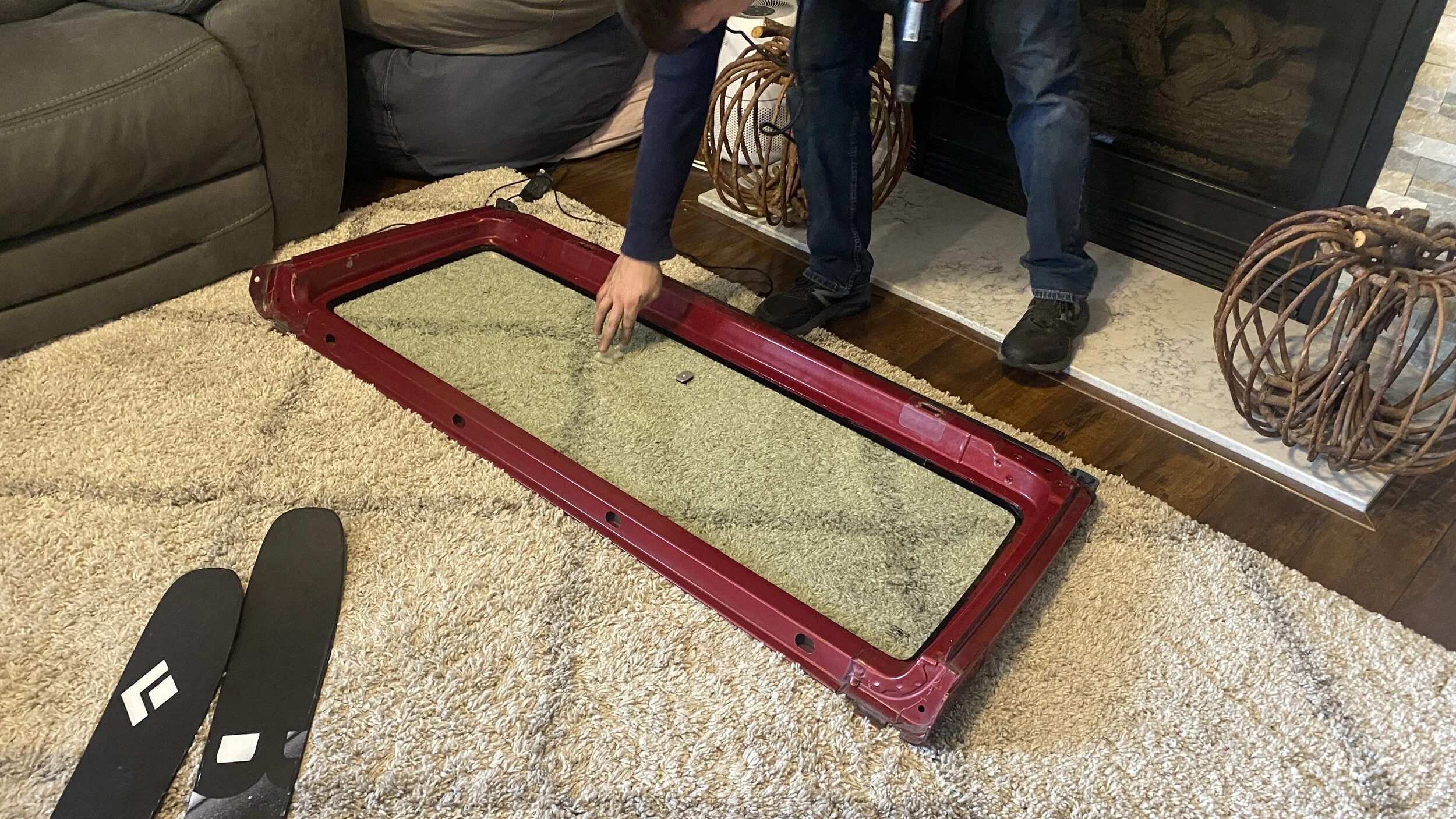

Kaleb went to the state line today to pick up a new windshield bracket and windshield. His has rust, so he’s going to paint this one. The windshield is better too, and only some small stars, so it can probably be filled so they do t split out further. He went crazy and 4.5 hours later it’s ready to paint. He’s very meticulous. Good work K! Really nice. Great project you’ve taken on.
Nice mohawk helmet.
Reactions: JMT and bobthetj03

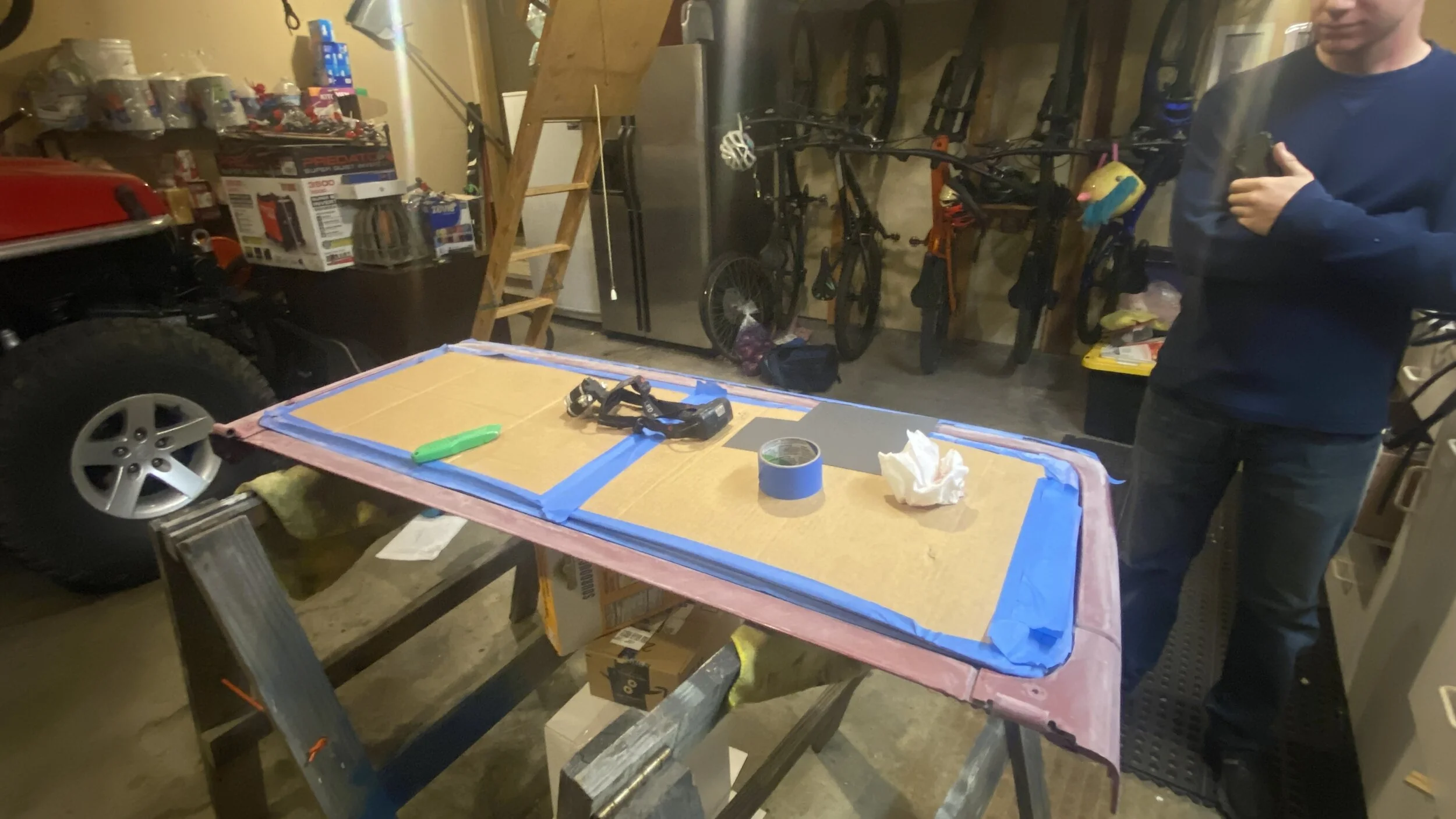

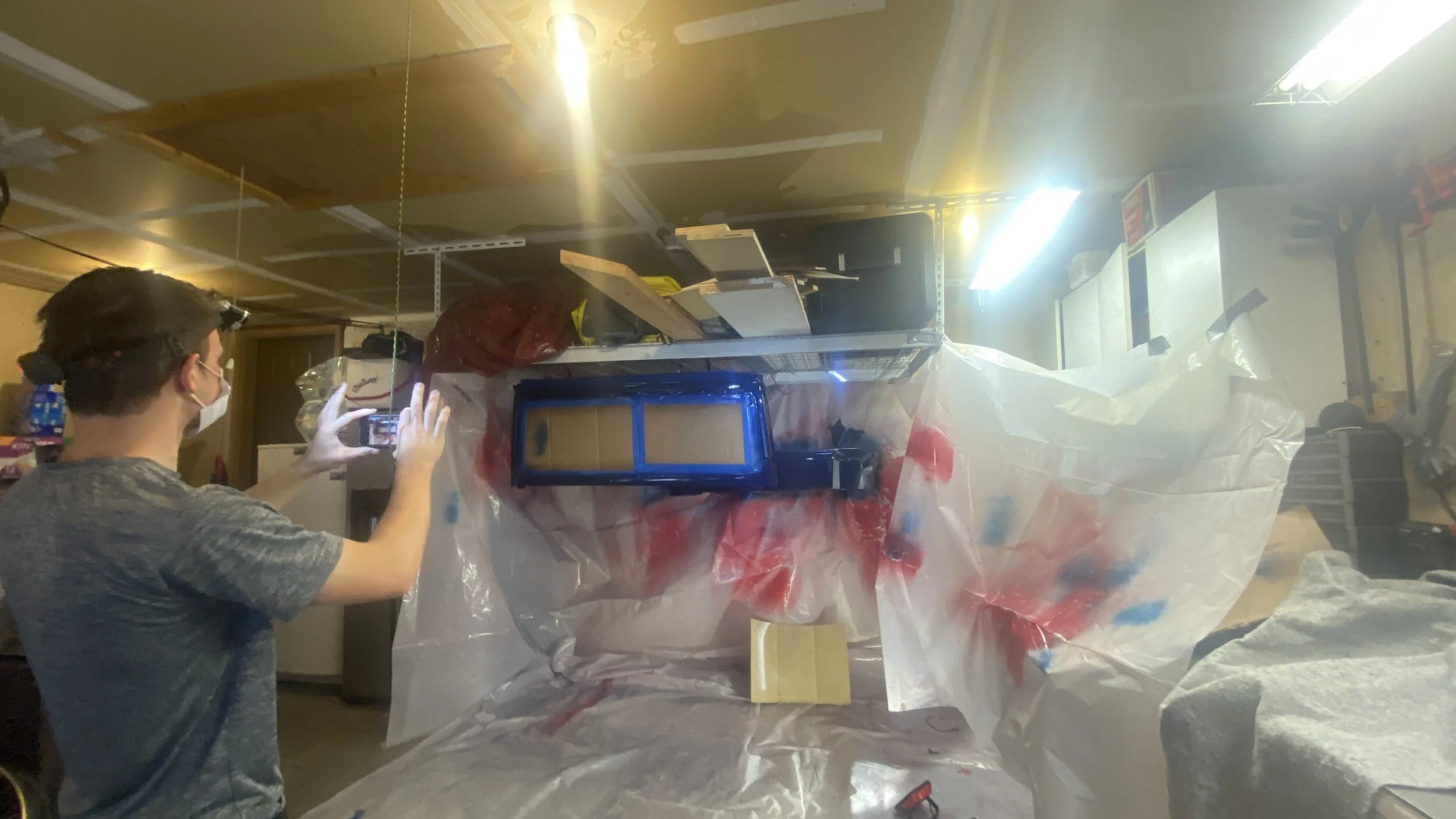

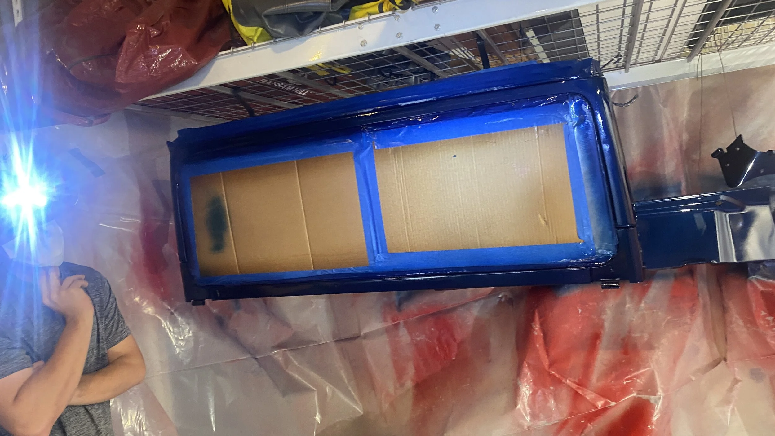

Kaleb’s windshield frame had some rust, as well as the cowl which had a quarter size hole on the driver side just under the cracked windshield. I found one in ID, and he went and bought the frame and better windshield.

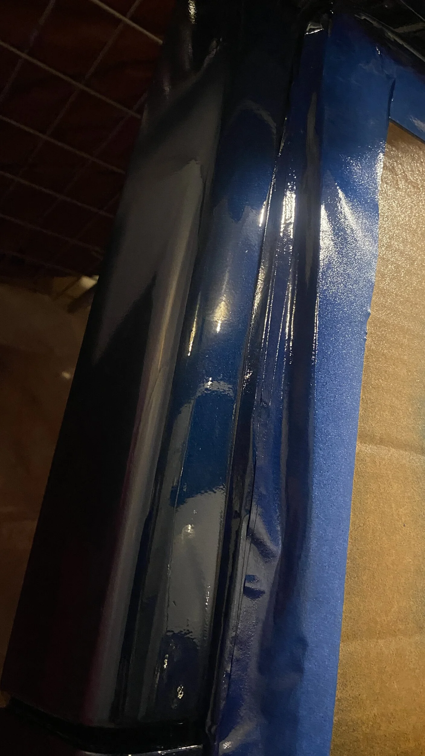

He prepped the windshield and taped it off. He fixed the quarter size hole in the cowl, as well as three holes in one of the new windshield hinge brackets.

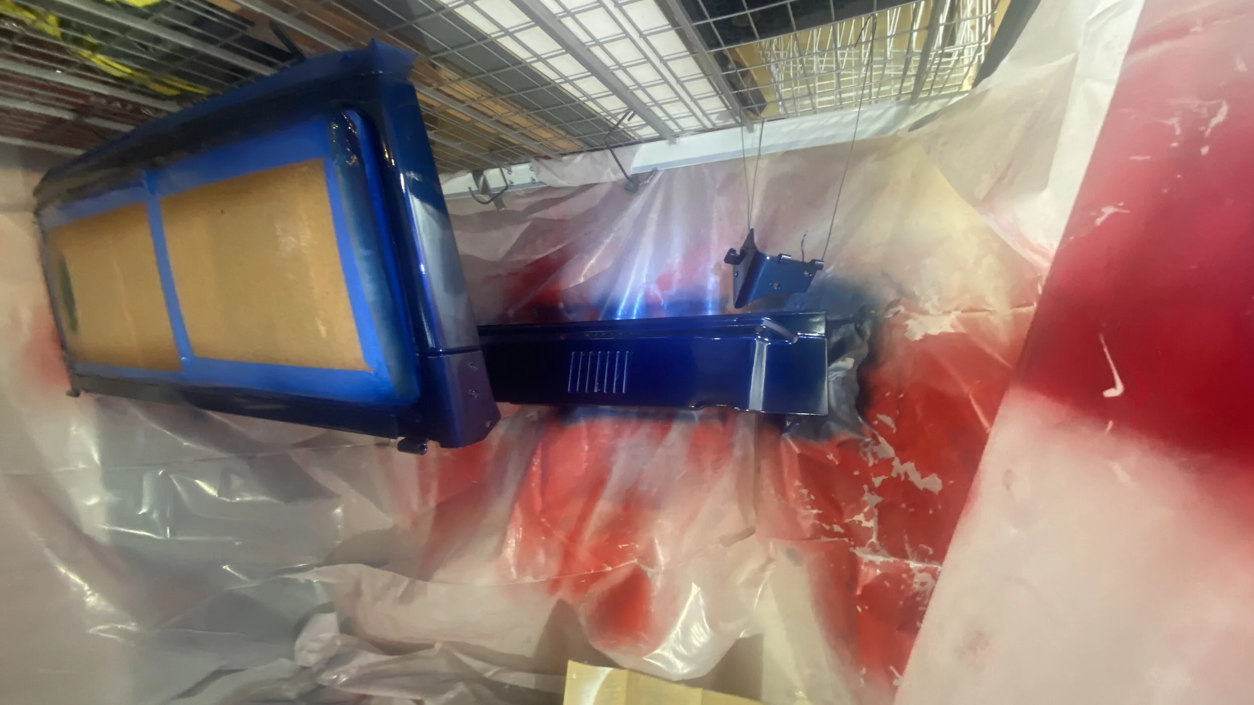

Prepped and painted with Patriot Blue. This color has worked well for us before. Pretty much a Perfect Match. We clear coated it with 2K gloss clear through an HVLP gun. Turned out way better. Now just sorting out how to do the hinge pins.
