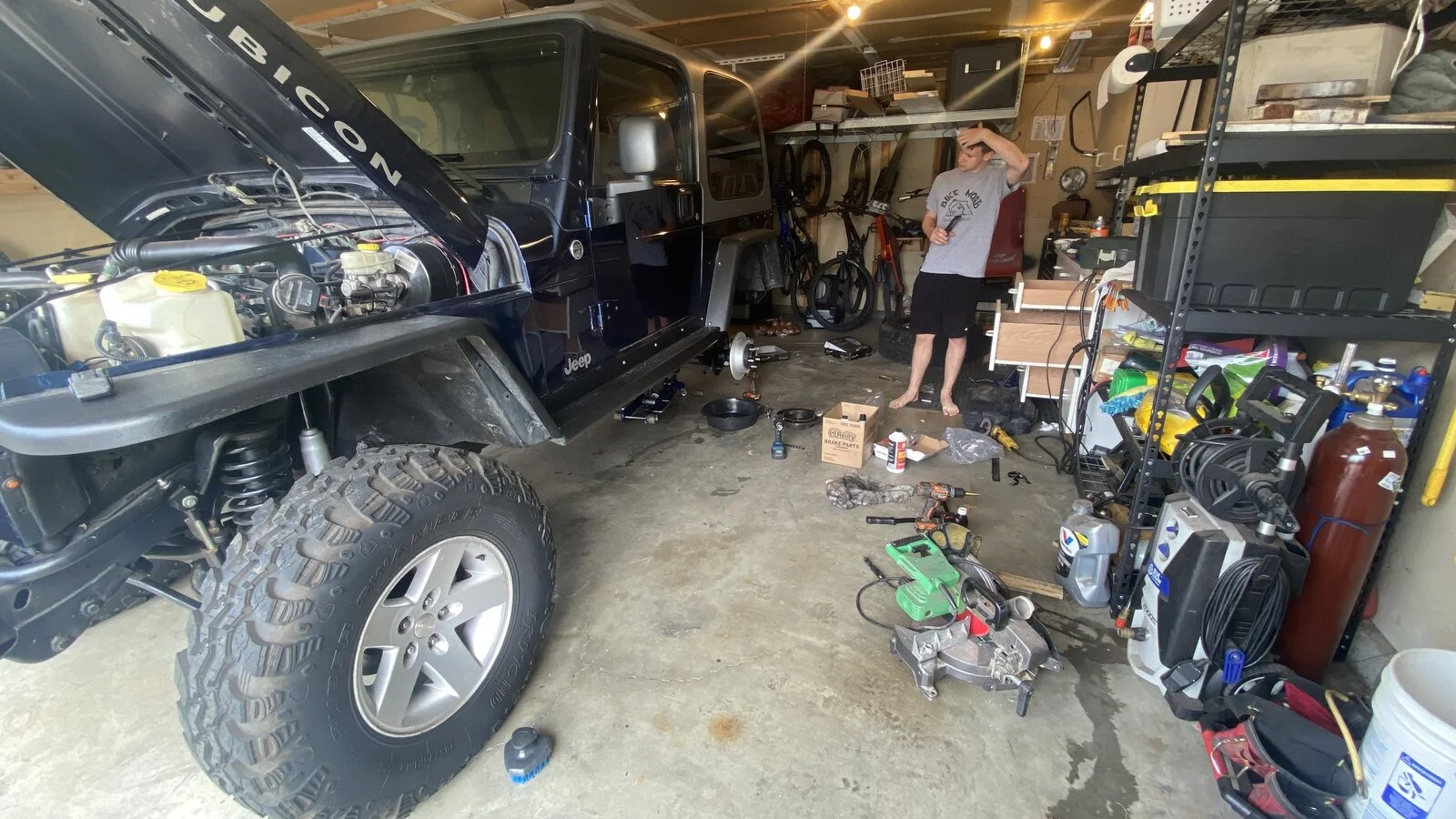

I came home from Moab to this: a 17 yr old someone had taken over my garage. 🤣

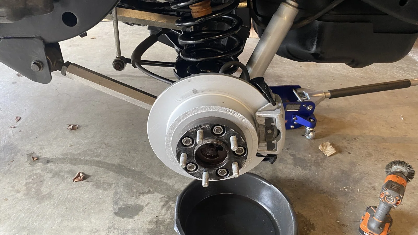

It’s pretty cool to see he’s taking responsibility to do it himself. He’s got to have perfect brakes, so he got new Centric Rotors, new calipers, and new pads. Then he bled the brakes and went out and bedded them in. While I was not happy about the garage being in disarray, it is lookin’ good K!

I'm starting to think Kaleb and I have very similar bad habits 😅

Yes, I noticed your flip flops Alex. I’m no better. Whatever footwear I’m wearing I’m wearing. I think in that pic @FarFire70 , Kaleb was just walking out. He wasn’t working on it, so there is that!
OK I'll give you a pass on the footwear for NOW....
But WTF!! Am I just not seeing the jackstand or is the jeep supported on a floor jack? If it is shame shame on him & you....

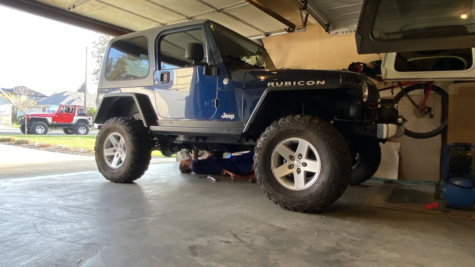

The TJR is looking good. We adjusted the rear pinion today. I don’t know why the pinion was so high relative to the driveshaft. I thought we dialed it in when doing the lift in January. It was 15* shaft and 18* pinion. Now it’s 16* shaft and 16* pinion. We also moved the rear axle about 1/2” forward. Loved the second pic.
Color me impressed. How did you get the blue to reflect so far?

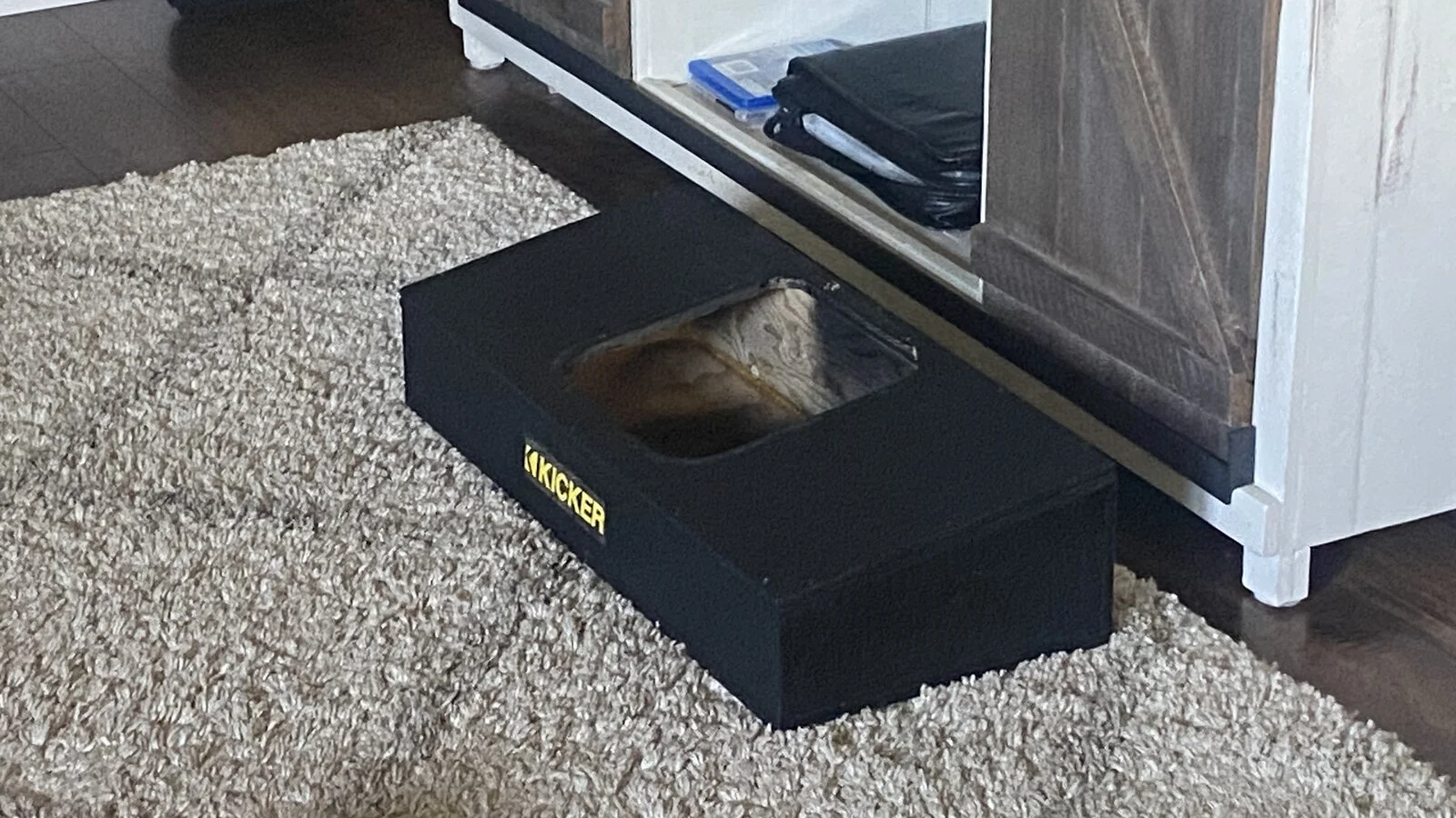

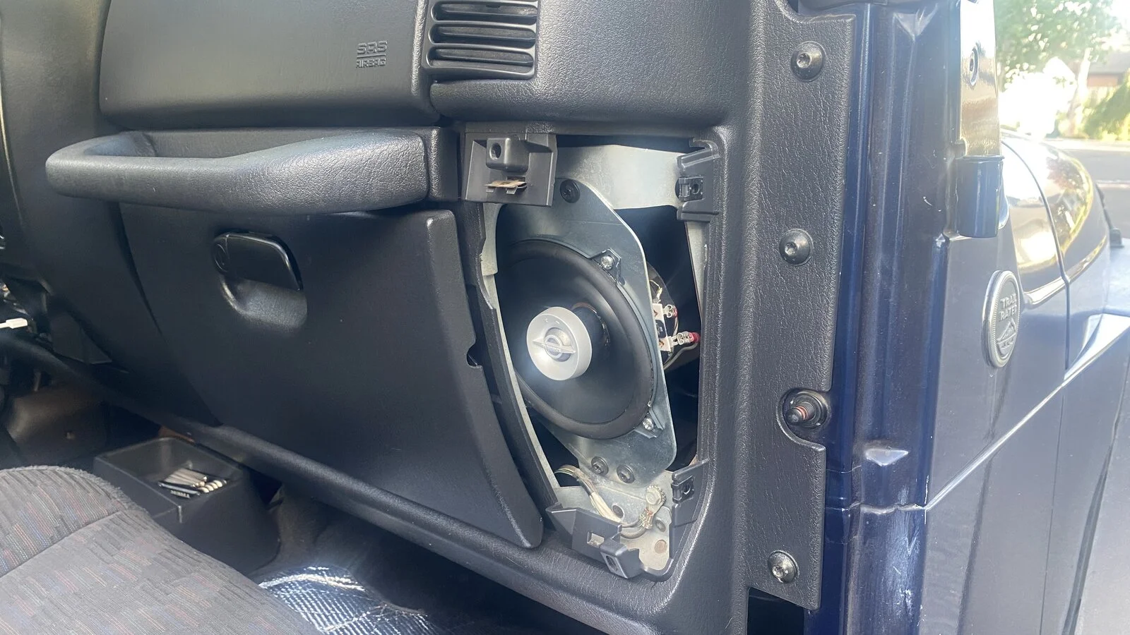

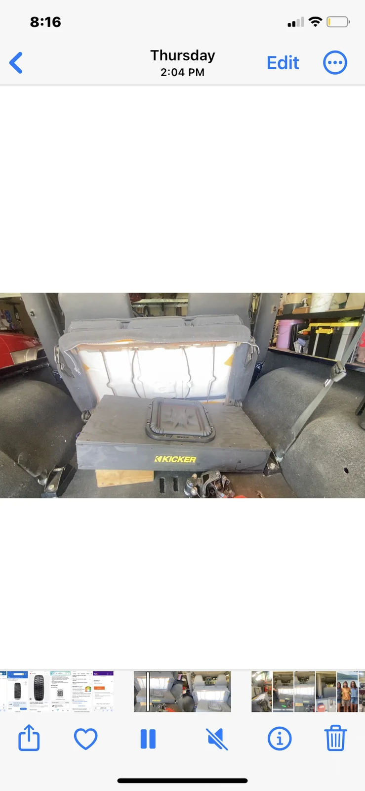

For Christmas we got Kaleb a Soundstream Nano Picasso 640D amp. Gradually he’s been piecing together the other parts of the sound system. The Kenwood head unit came with the rig. It has three pre-amp outs, so he was good to go there. It also came with a pair of Kicker 5.25’s. I think class CS. He got the adapter brackets and installed them in the dash. His annual Christmas gift at work was a gift card to Best Buy, so he came home with another pair of Kicker’s for the sound bar. He installed the amp under the steering column like many of us have done. The final piece of the puzzle was the sub. He originally wanted to just upgrade the speaker in the console, but decided it would sound too punchy. He wanted a Kicker LT7 10”. He’s always got to one up his old man who runs an 8”. It’s got to be hidden, so we measured for under the rear seat 27”x11 3/8”x4-5” rise with 1.5” seat risers. I got to teach him how to use the table saw. That was a really good day. He got a lot of joy out of doing it himself, and that gave me a lot of joy. He cut all but one piece, flubbed a couple of end pieces, but in the end it turned out great. The system sounds similar to mine, but it can hit the lows better and clearer. Sounds amazing!

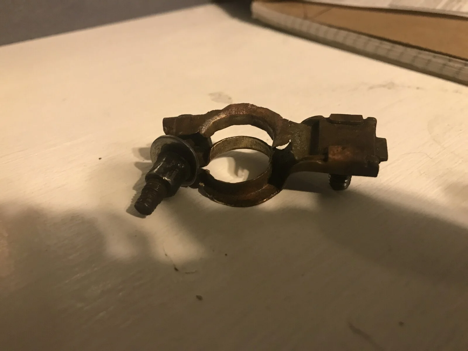

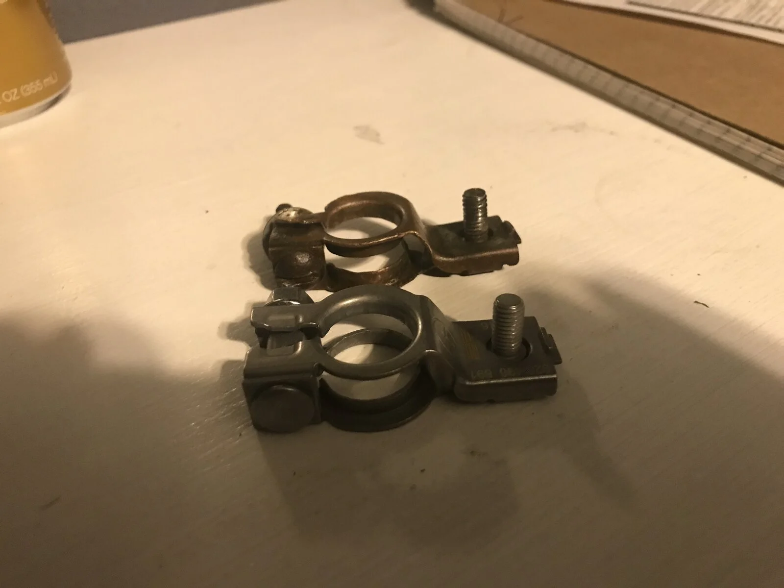

UPDATE! The jeep is fixed! I’ve been trying to learn everything there is about fuel pump problems over the last couple weeks. However, Thanks to Alex, I found it was just a simple voltage issue.
Last week, I hooked up the jeep's battery to my brother's rig, and it started right up! This sounded like a battery problem which really surprised me as l had just replaced the battery one year ago. I drove it up to O’Reilly's to get the battery load tested and the load tester wouldn't even draw enough voltage from the positive terminal to even load test the battery. I took a closer look at my terminals, and decided I'd try and replace the positive terminal as it was looking pretty rough. So, I went ahead and ordered a new battery terminal from Dorman Solutions for 15$. The part got here Friday night, installed in 10 minutes, and it started first time! It now starts and drives better than it ever has!
Found the old terminal was missing a whole side!
New terminal :cool:

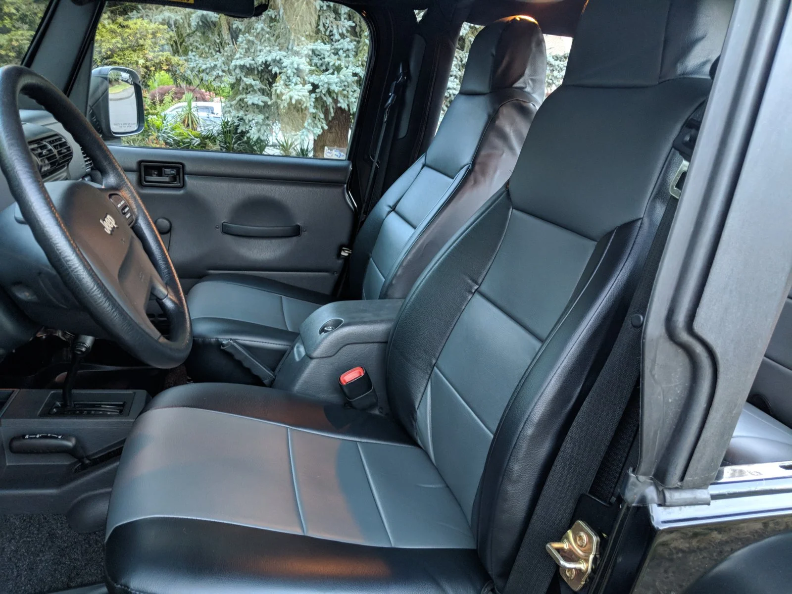

I think this was a great learning experience, however, it did drive me kind of crazy (my dad can testify). Next project is to rewire the side markers and hopefully get rid of the feedback in my dash. Also, seat heaters are all wired up and ready to be plugged in. Any suggestions on seat covers? Don't really want to take off all the stock covers and deal with all the pins.
If you don't mind Vinyl, Iggee makes pretty good ones. I put mine in 2018 and they still look new. I went with black and grey.
I don't like leather for many reasons. I wanted something that is easy to clean and won't get stained. These fit the bill perfectly for me.
View attachment 465653Found the old terminal was missing a whole side!
New terminal :cool:
Im glad it was a simple fix. I believe @Midnight LJR has the bartact covers. They are really nice but aren't really budget friendly.
If it was me I'd probably get something fairly cheap off amazon and keep my eyes peeled on facebook marketplace for some prp or mastercraft seats for a long term solution. I wish we were closer so you could sit in mine but having a seat with more bolster really helps in off camber situations. I rearly find myself hooking on the door or center console with my elbows after installing the PRPs which adds a lot of confidence on the offcamber stuff.
