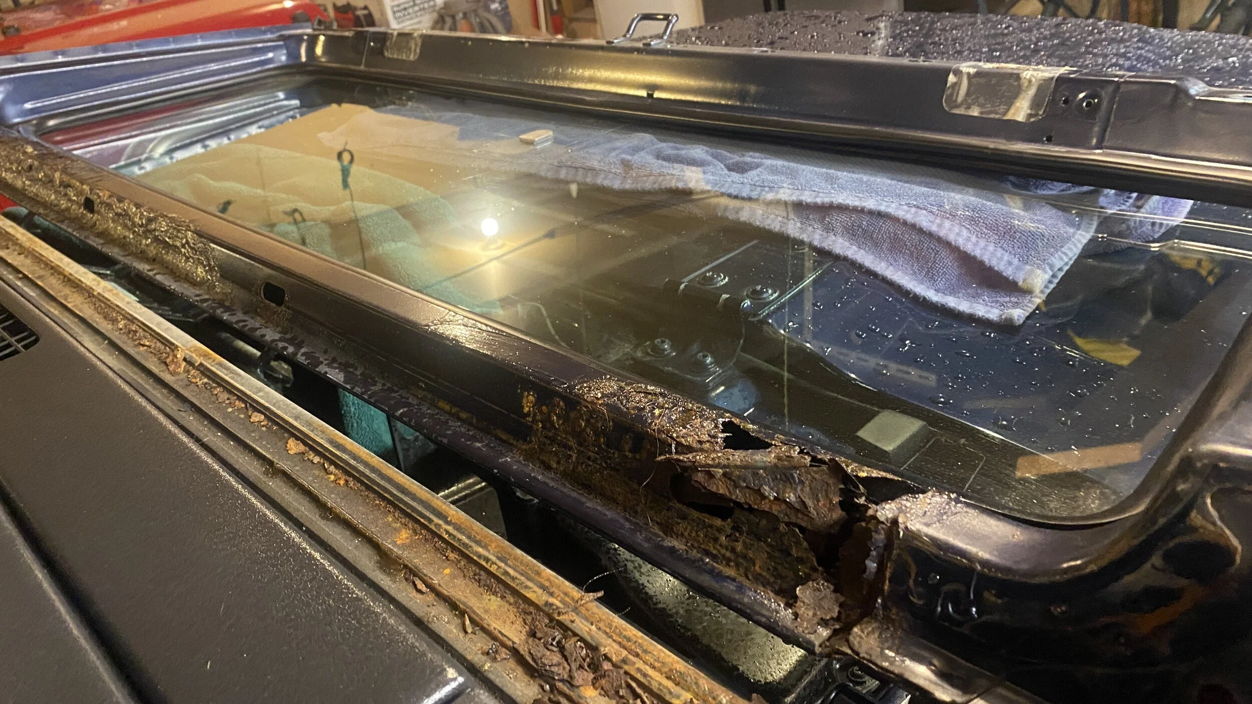

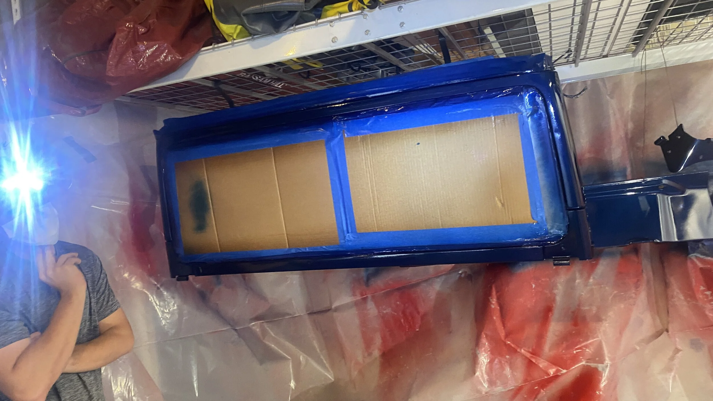

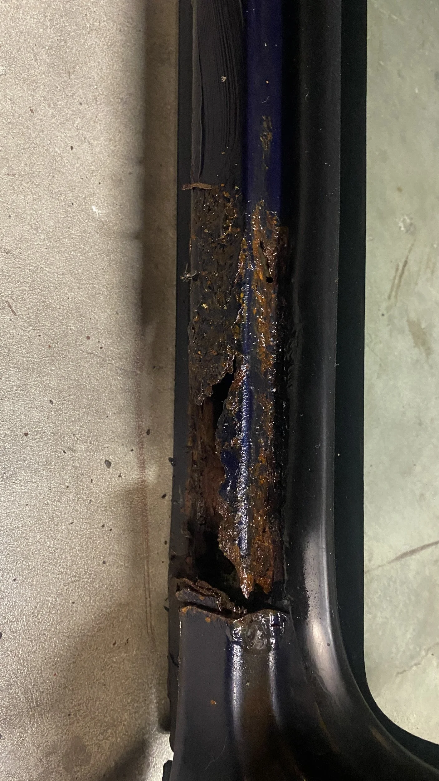

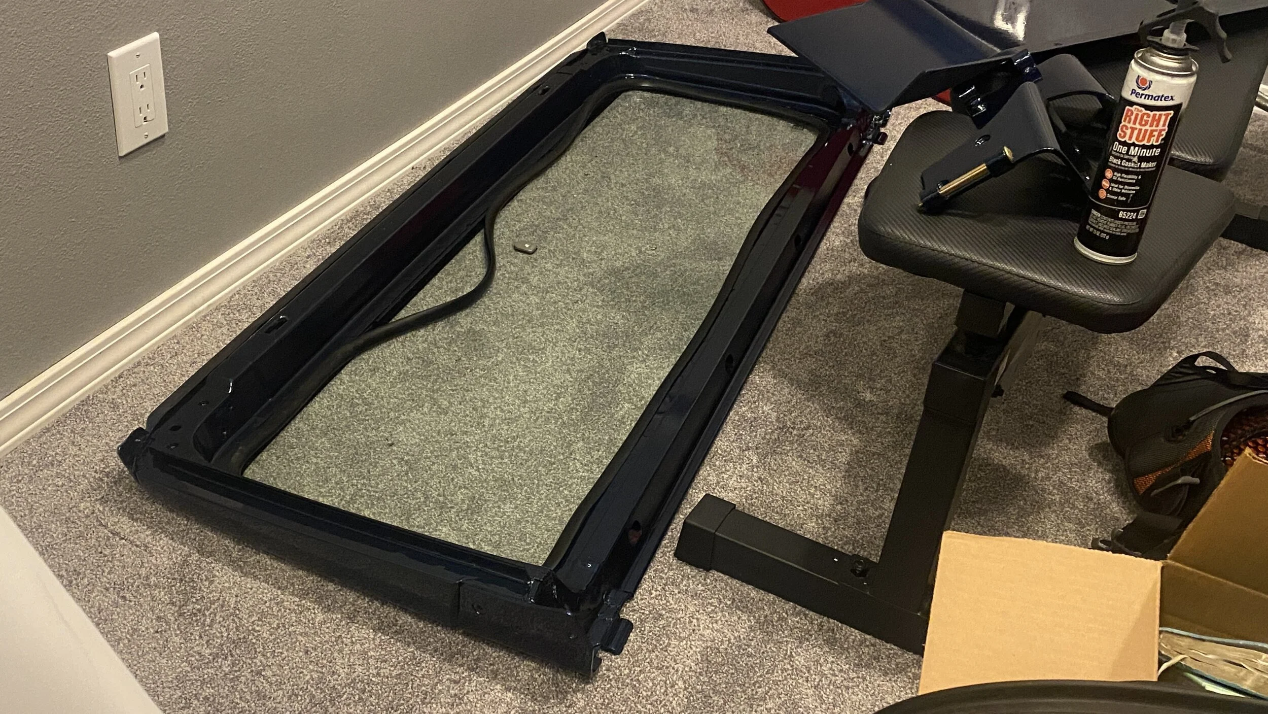

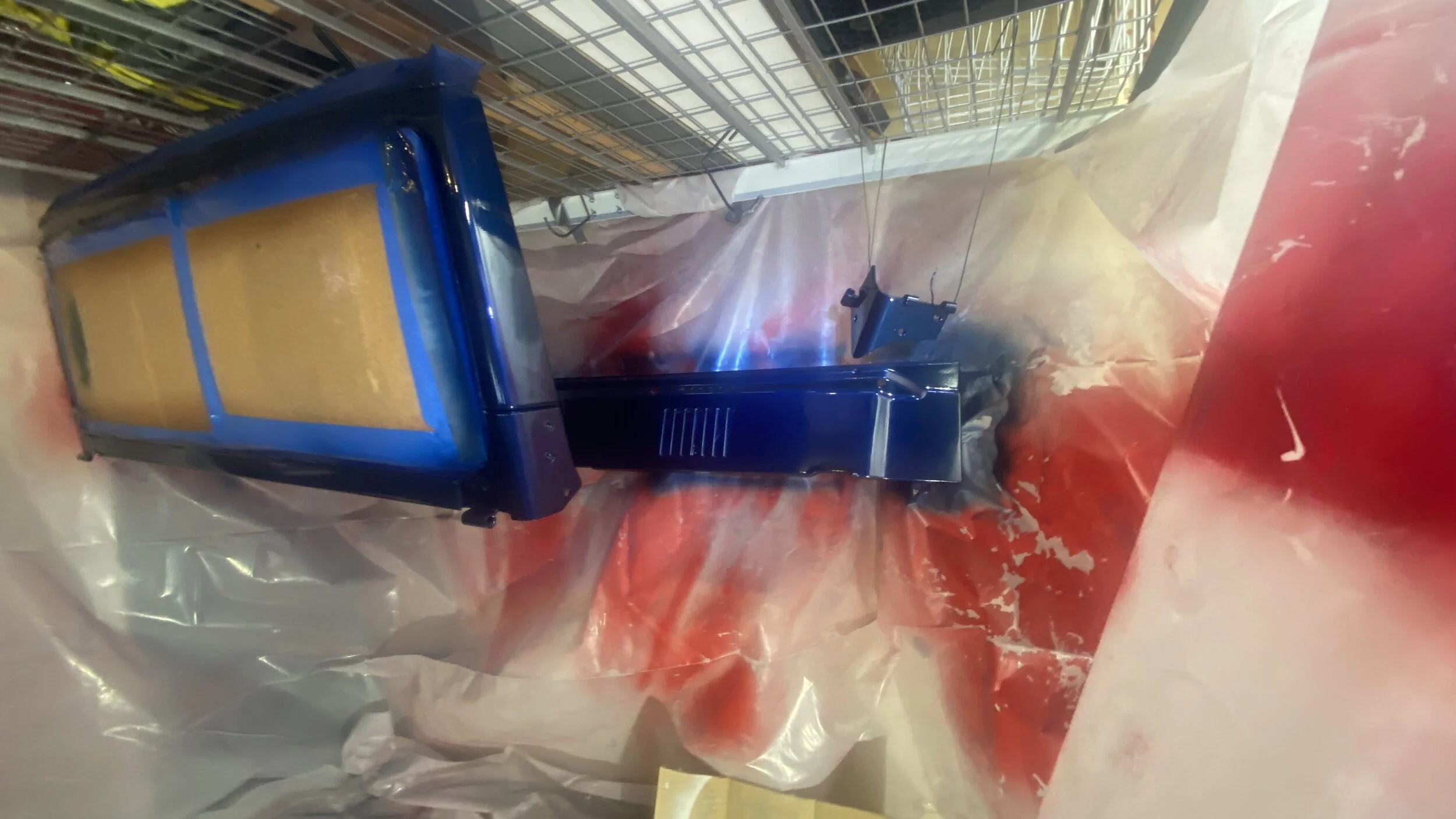

Old rusted windshield frame out. New about to go in.

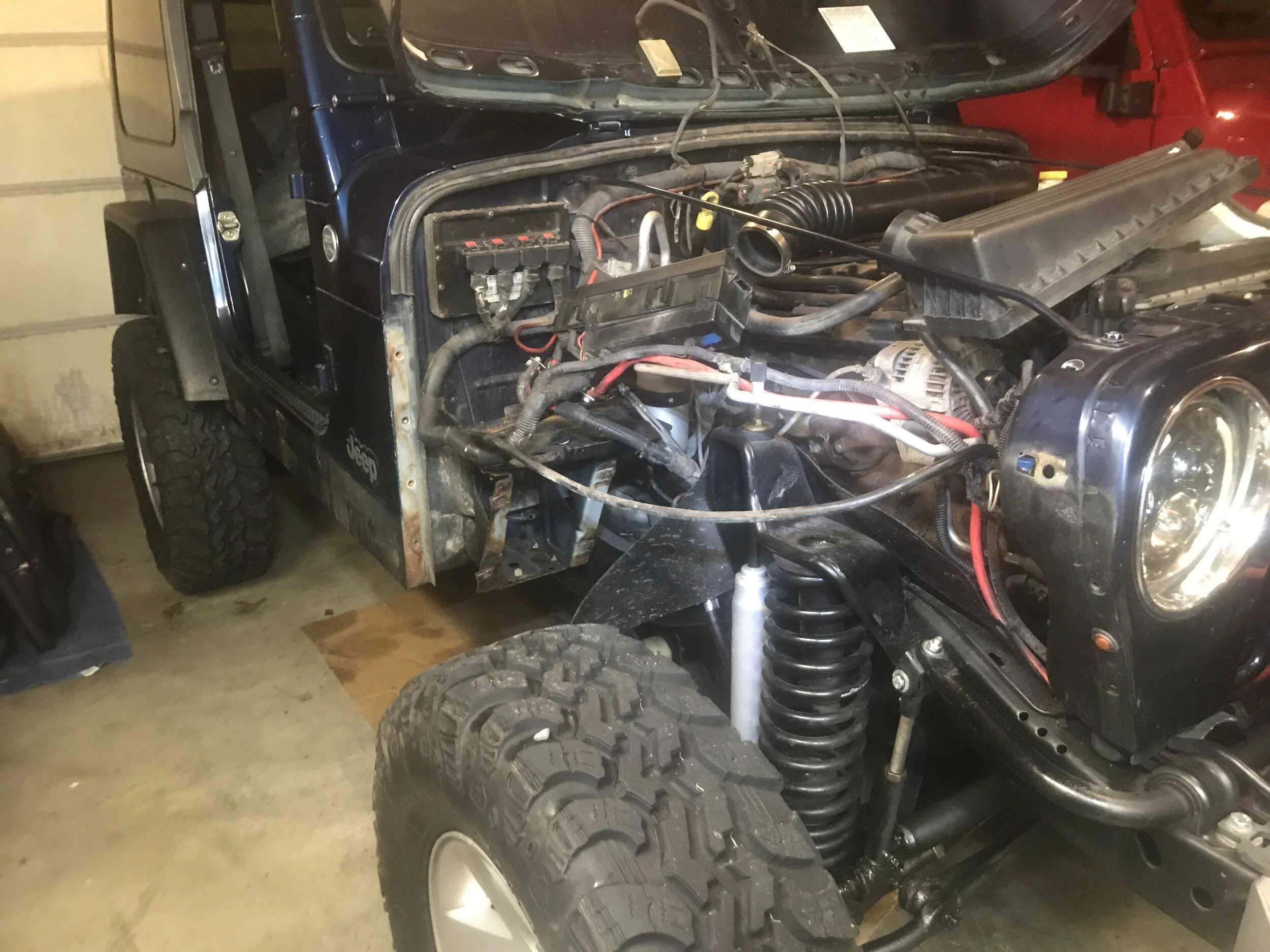

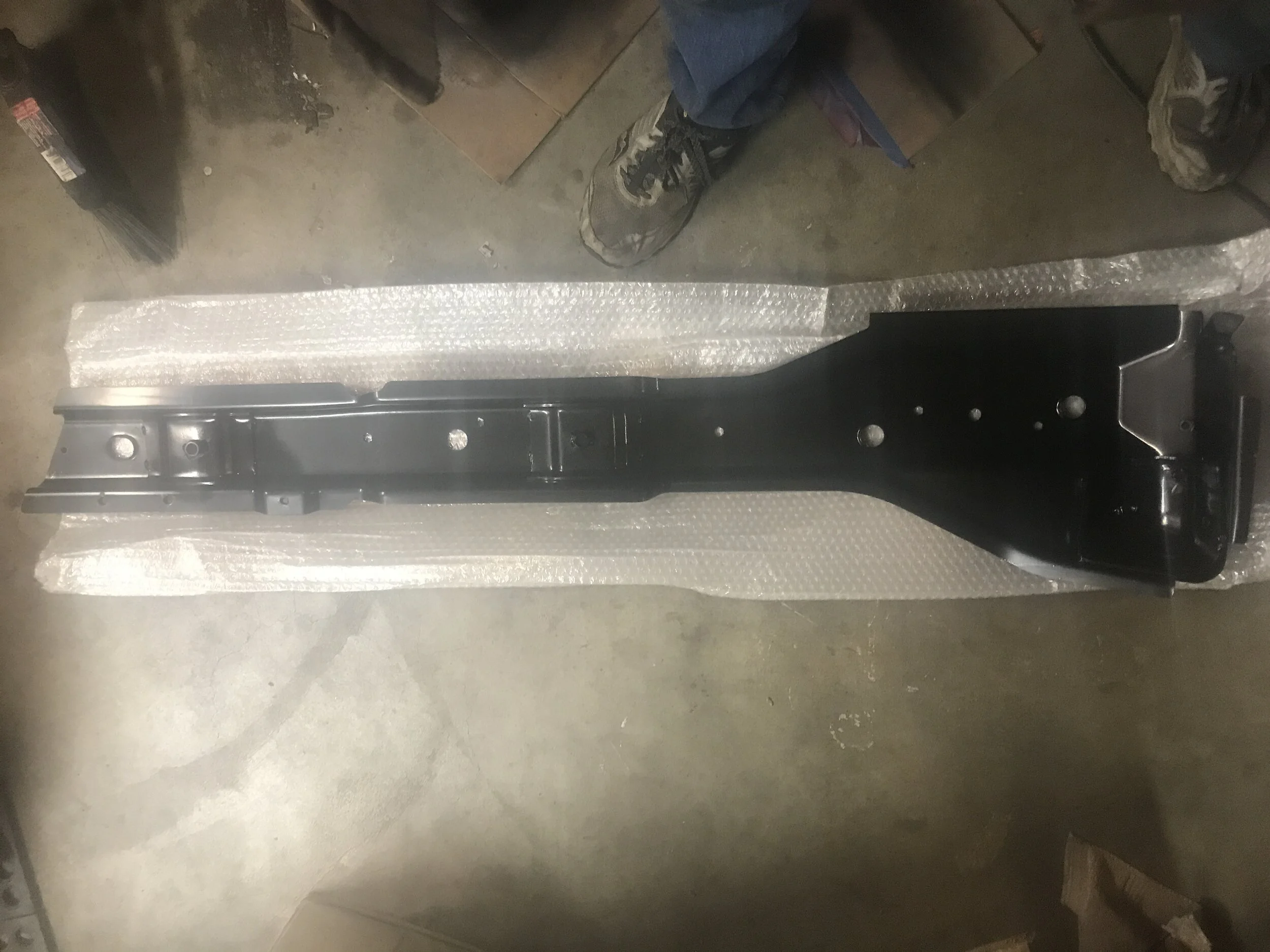

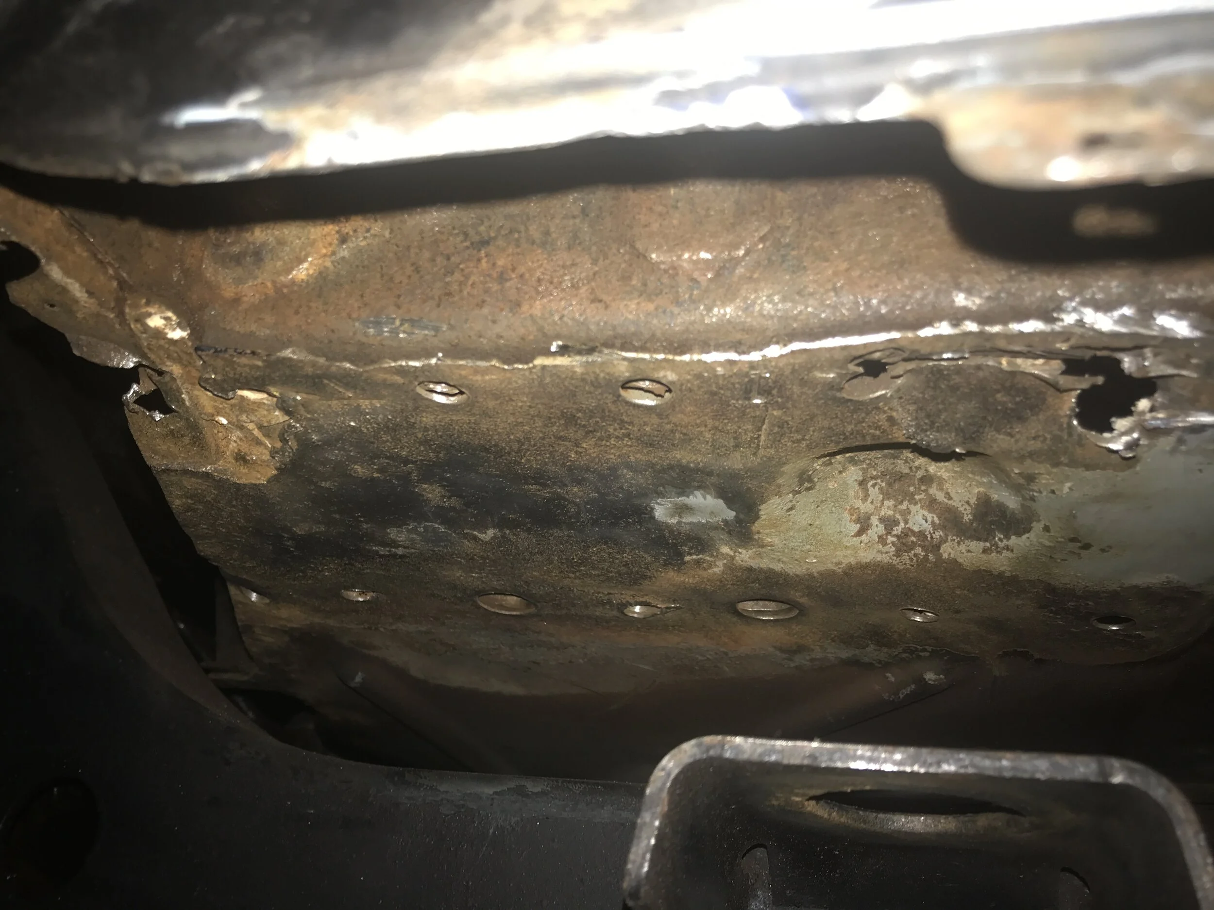

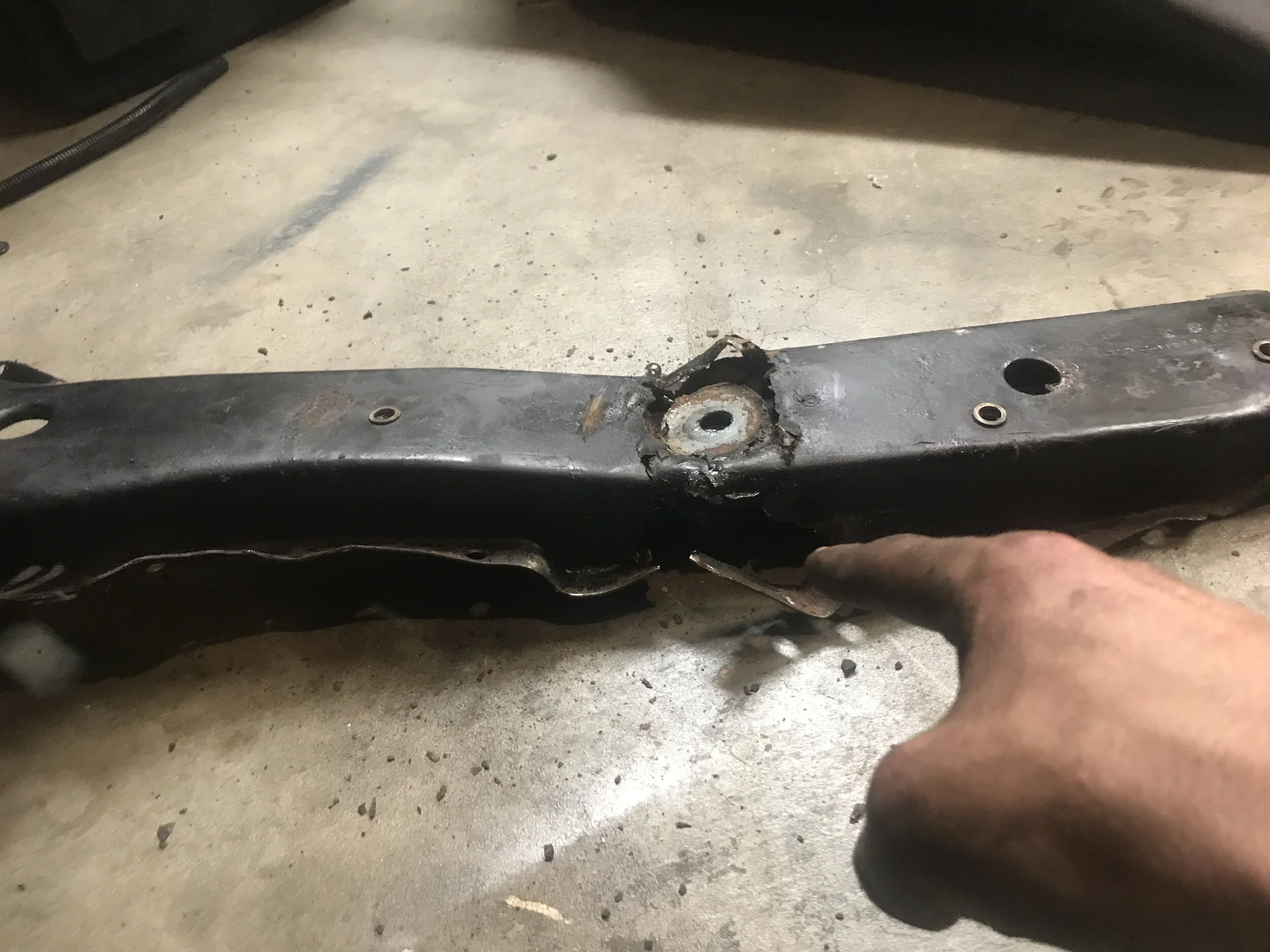

Well, on Thursday morning l started the removal process of the passenger side torque box. I was hoping it would be a 2-day fix, but turns out, removing your torque boxes is no joke.
Removing the fender only took about an hour, it was super easy as long as you remember to remove the 12 bolts and stuff in the engine bay.

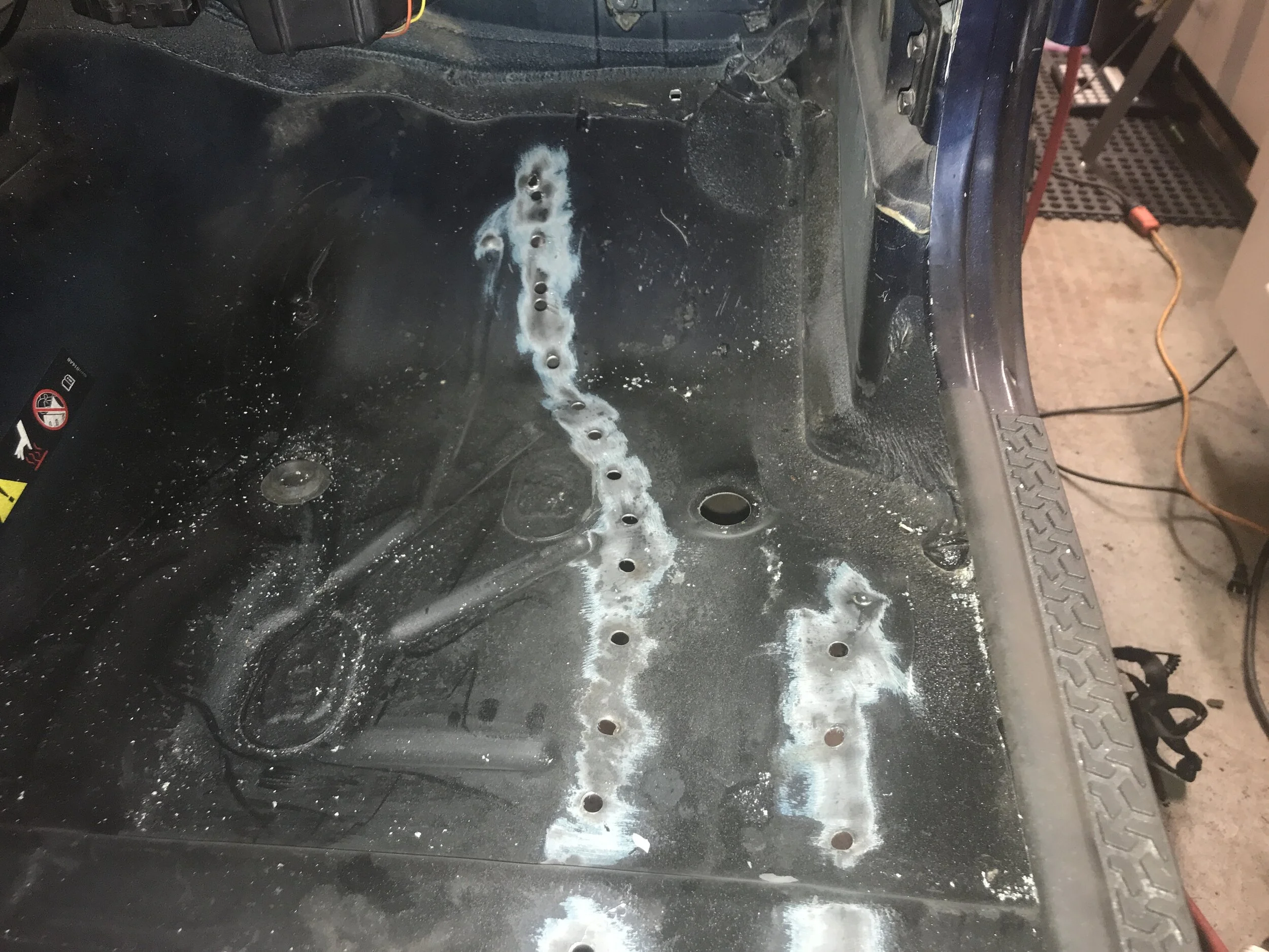

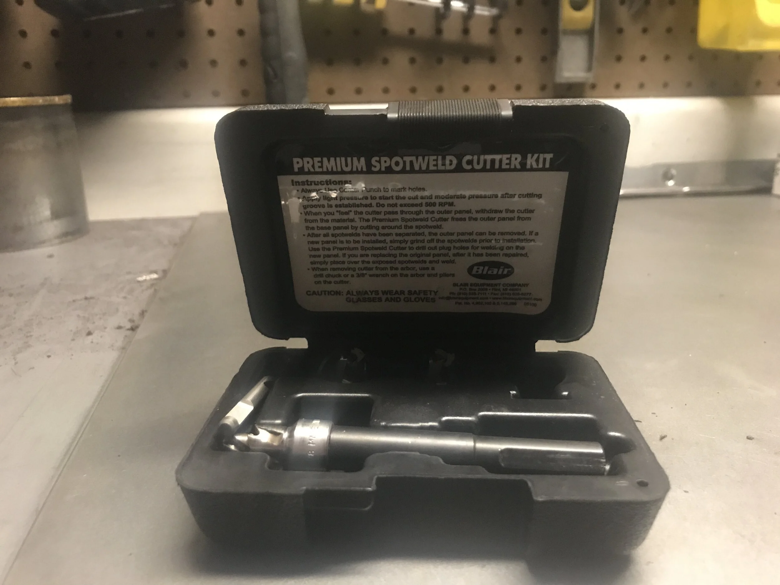

Next step was finding and drilling out each factory spot weld. With a spot weld cutter.

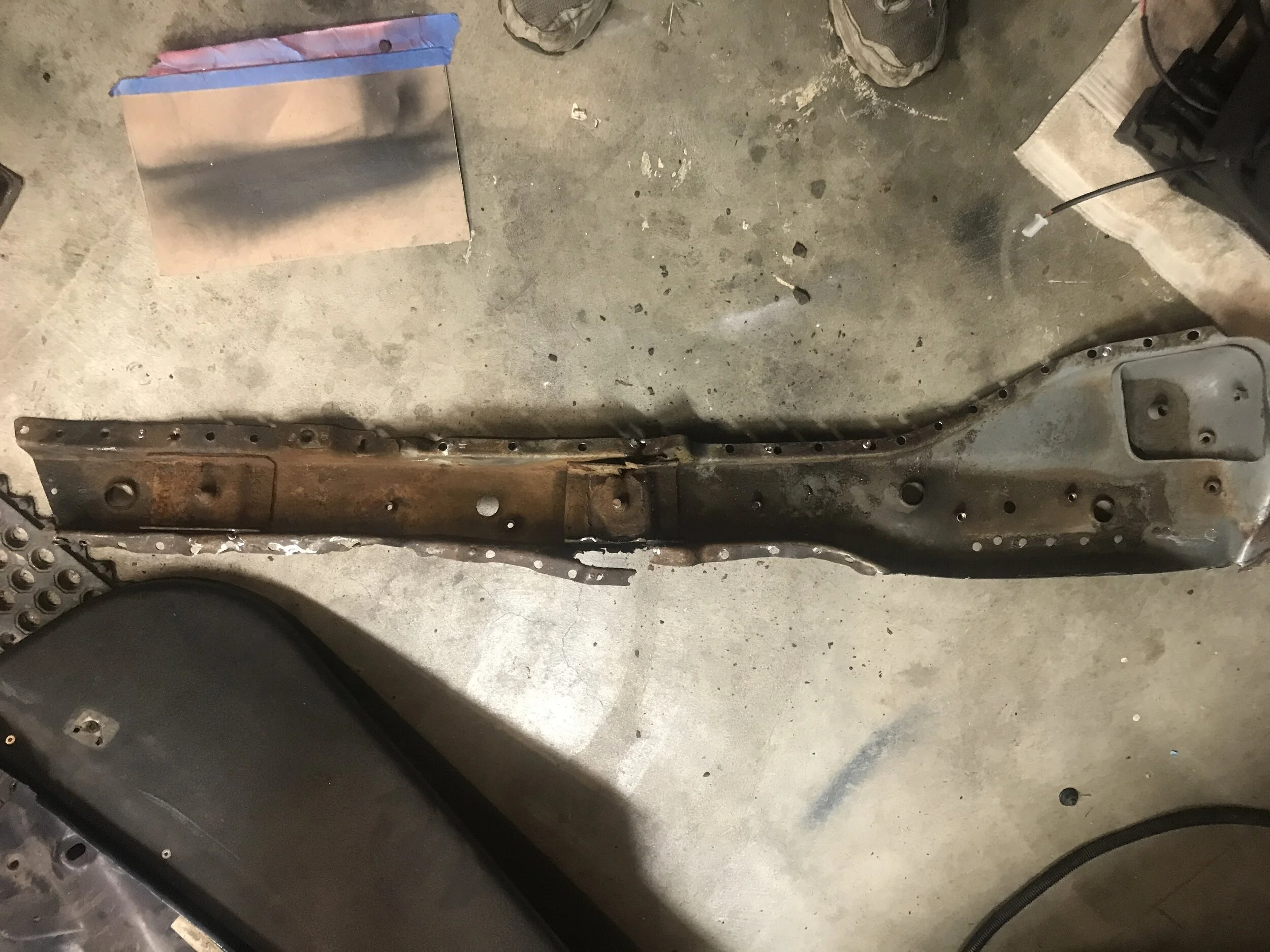

This proved to be the hardest part and after 7-8 hours of work and a lot of prying bending and breaking, it came off.

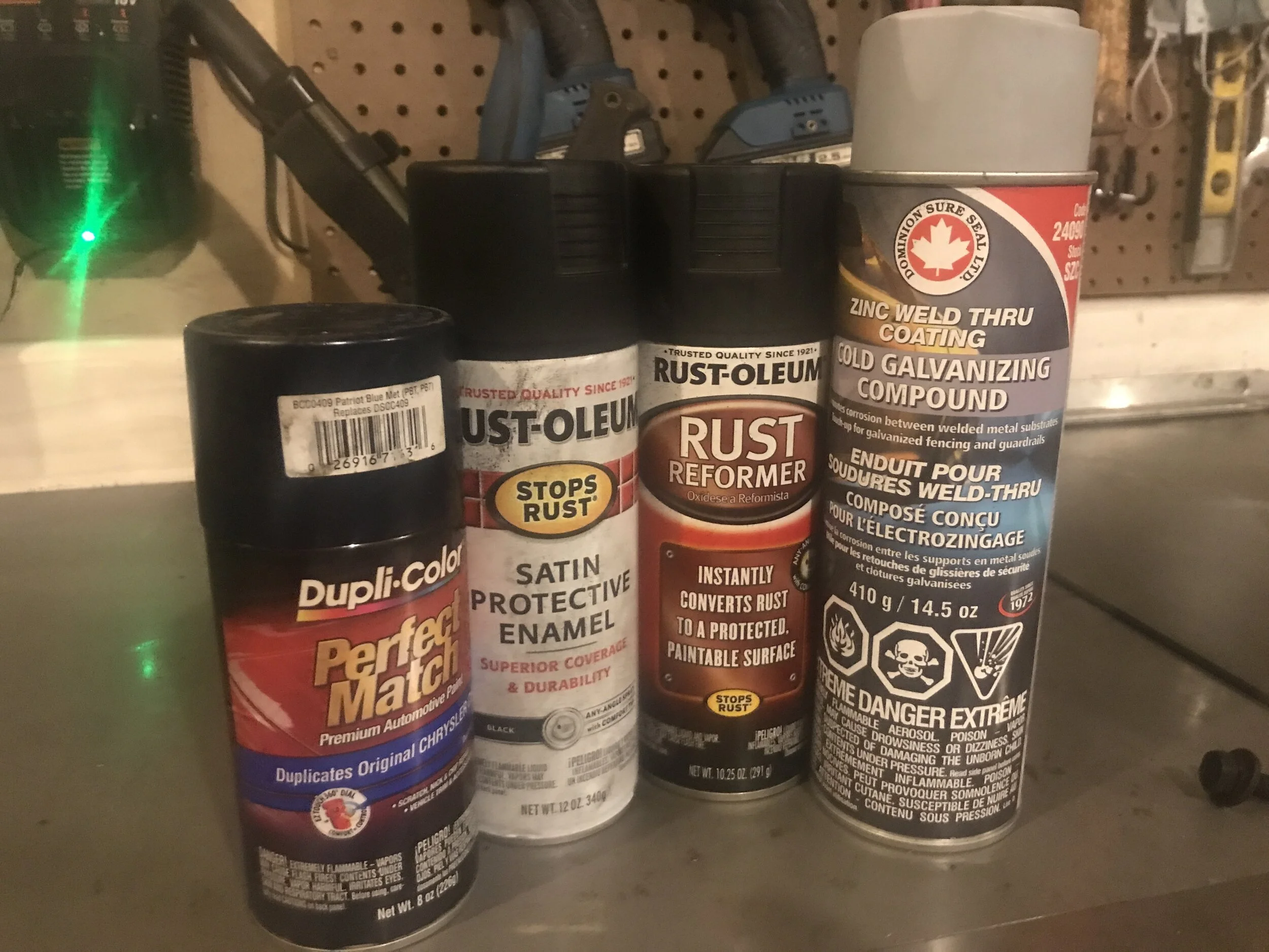

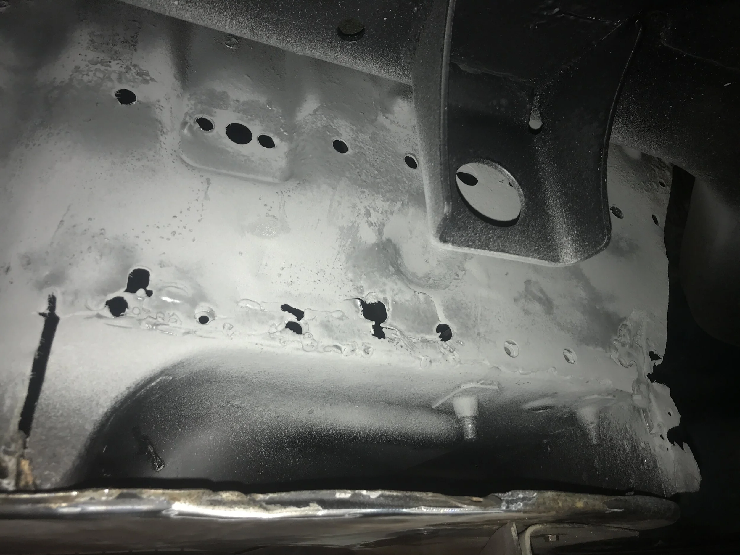

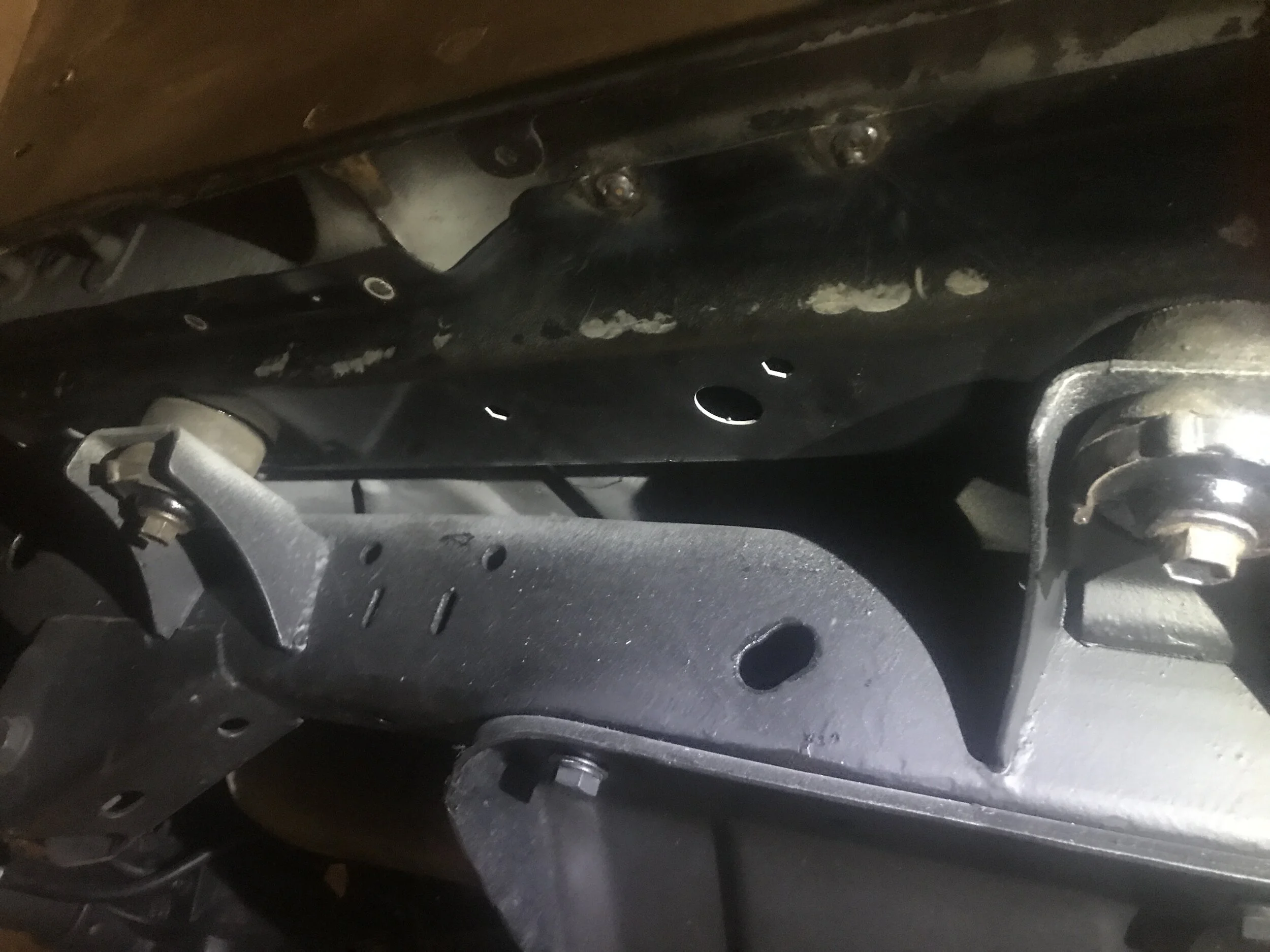

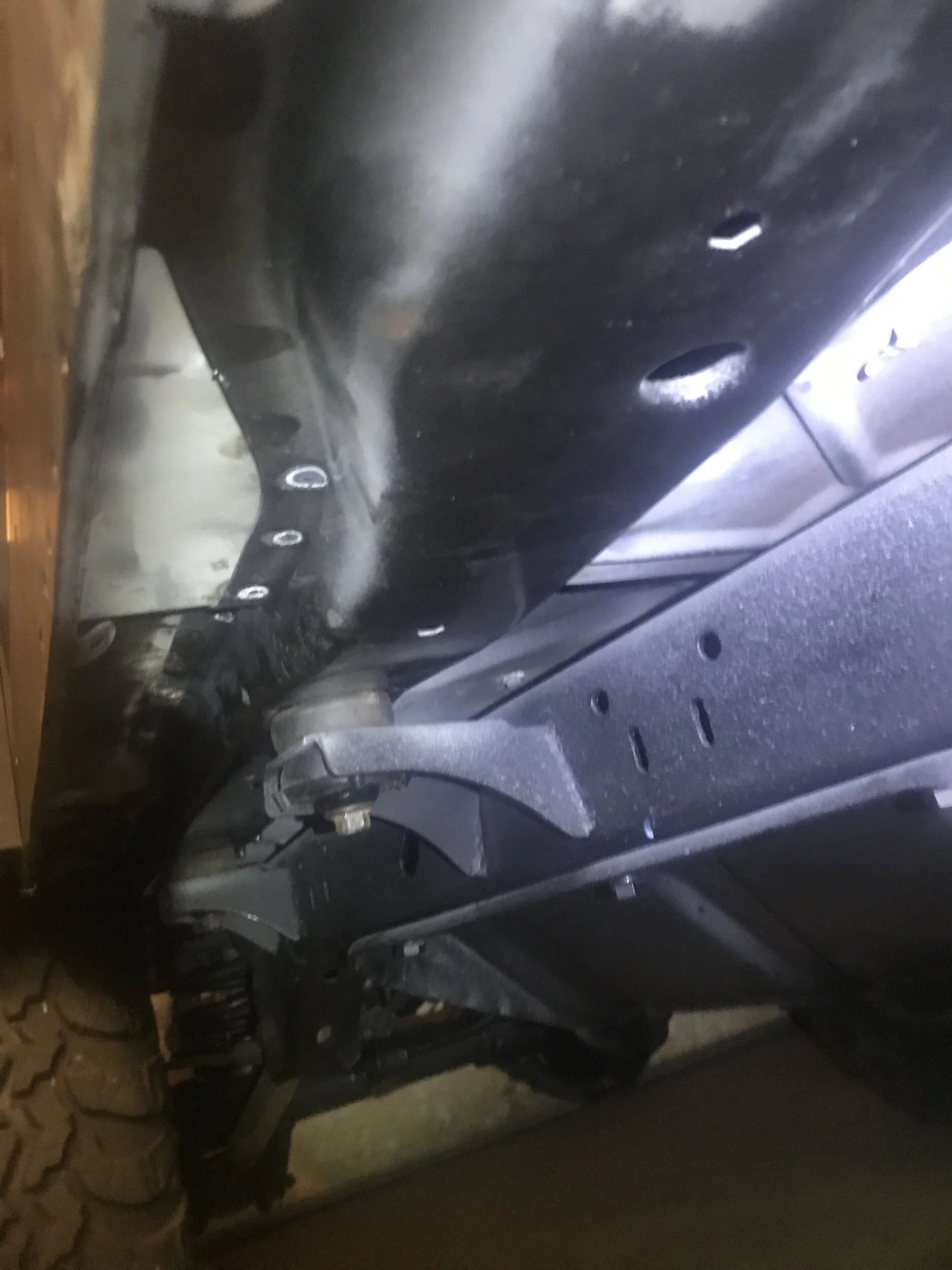

After the torque box was removed, l spent the rest of the day getting everything underneath and in the engine bay prepped for paint and some weld through primer.

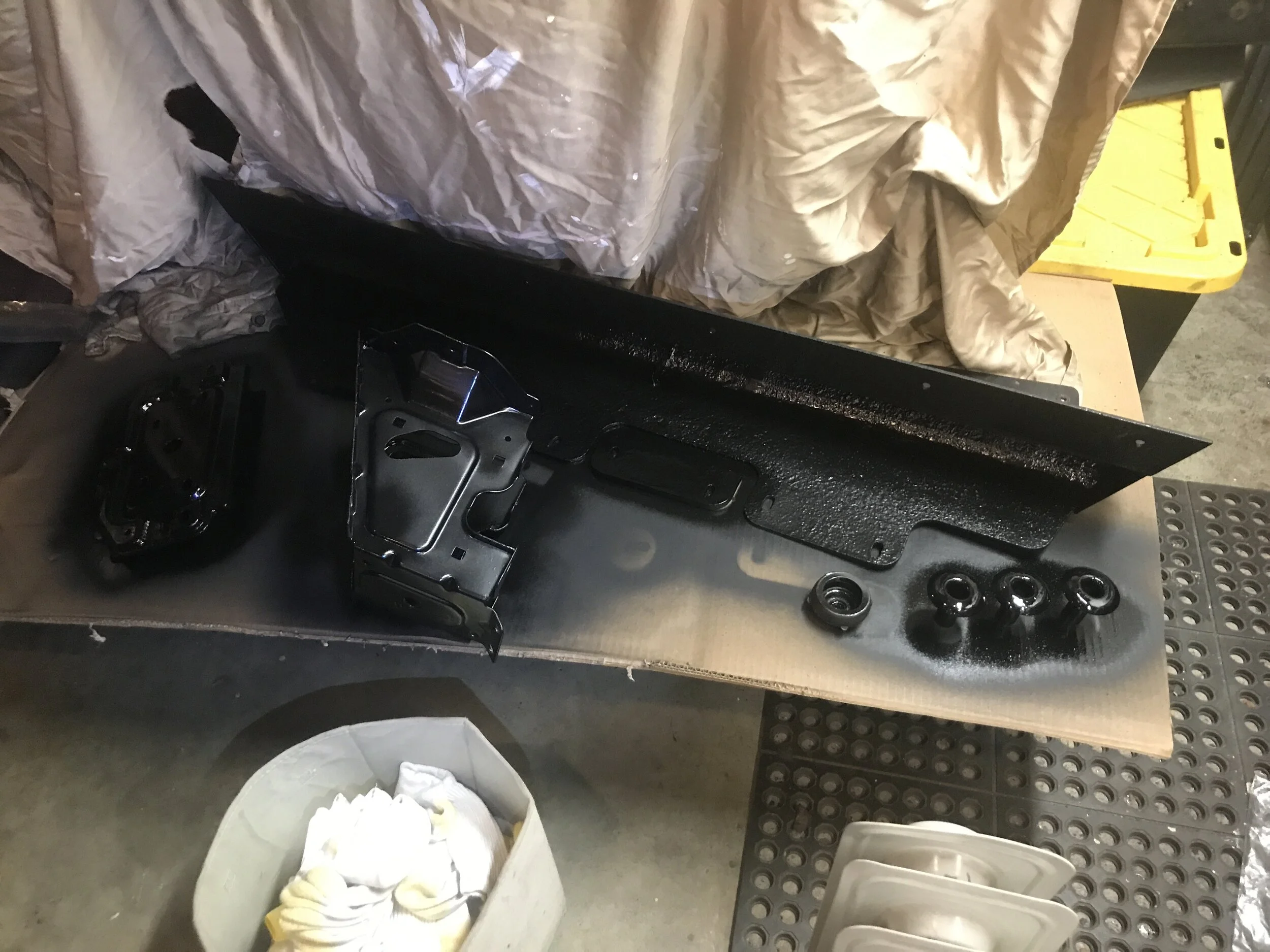

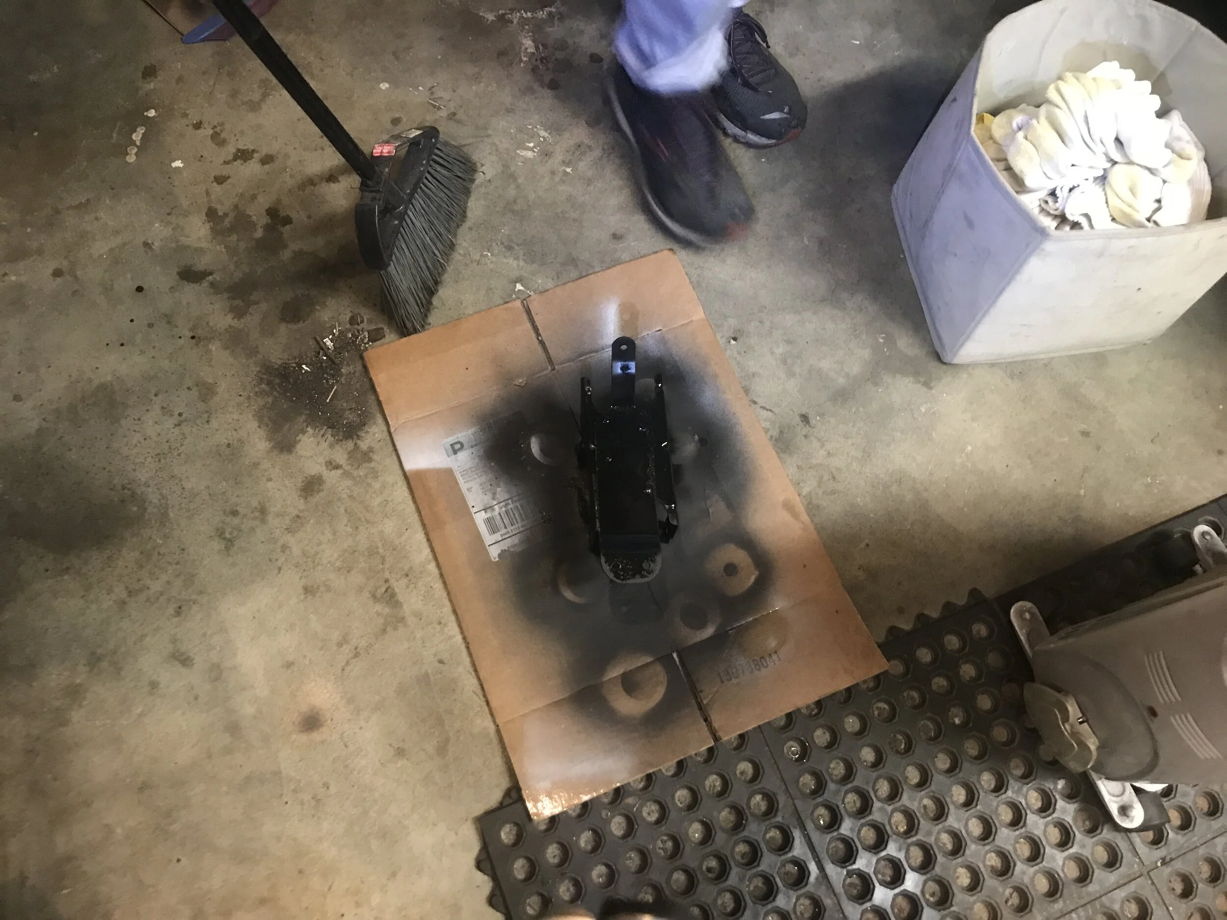

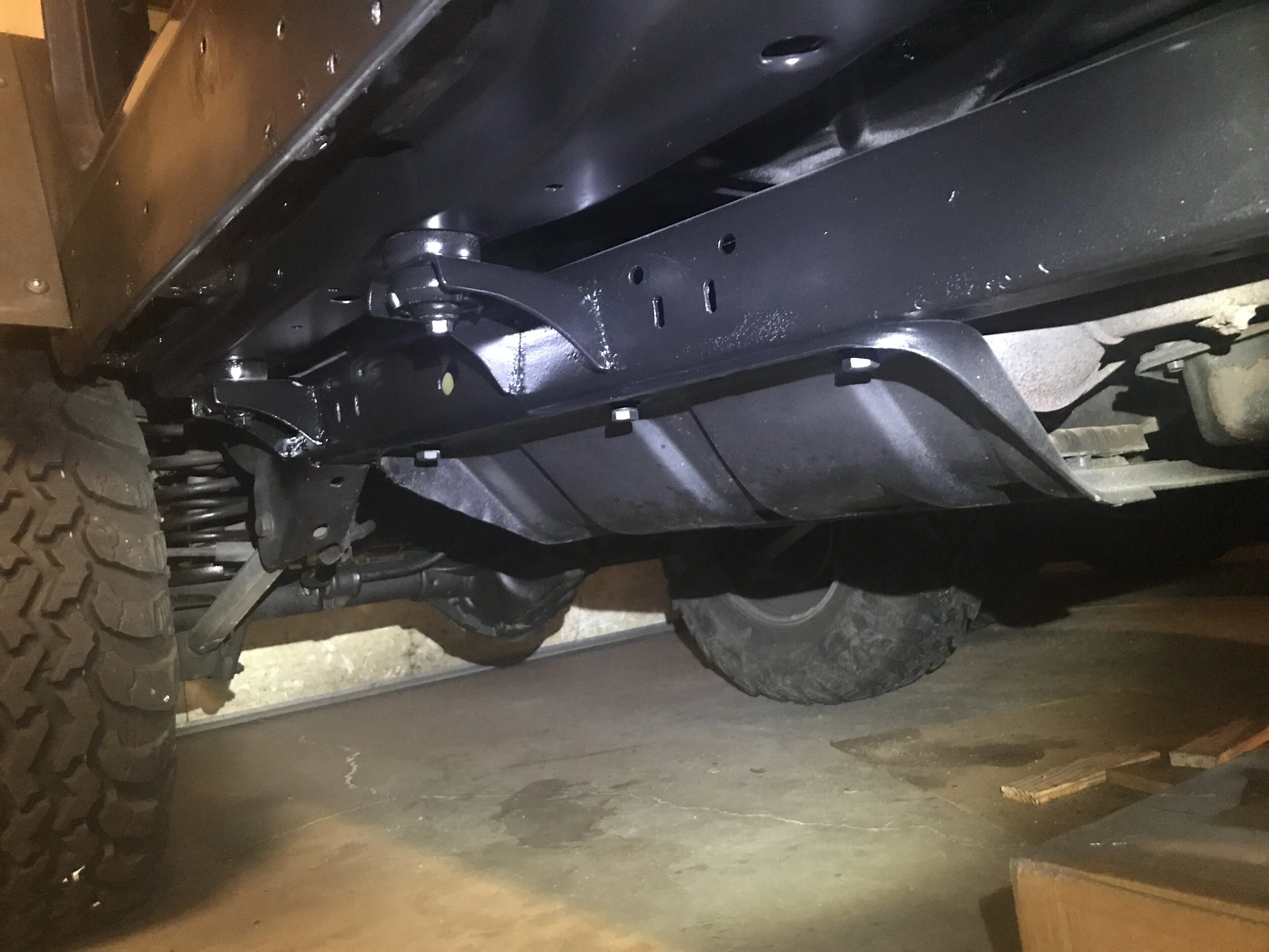

On Friday, l was waiting around for the new torque boxes to arrive so l started painting everything related to the passenger fender, ended up also painting that front section of frame again, because it was easy and why not.

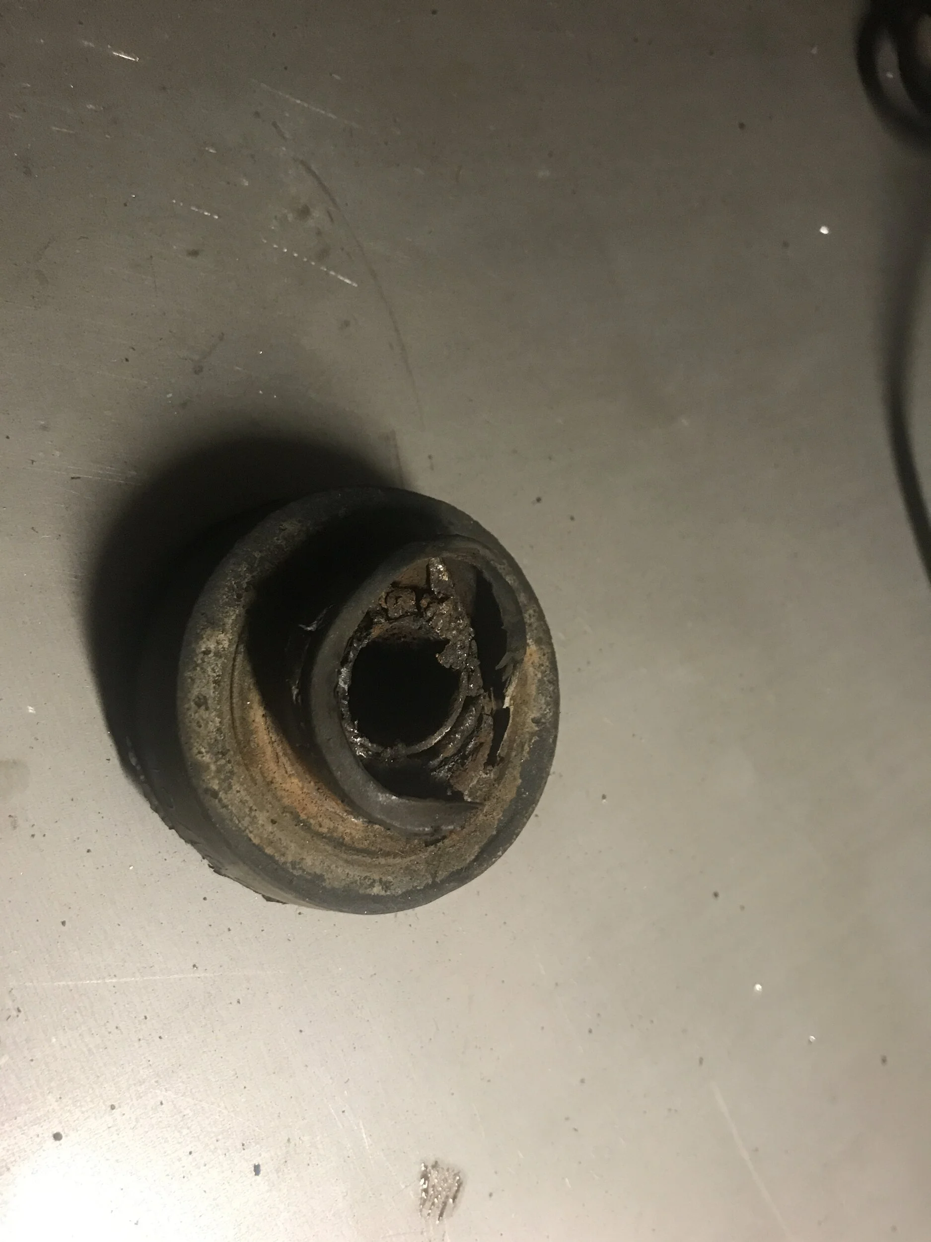

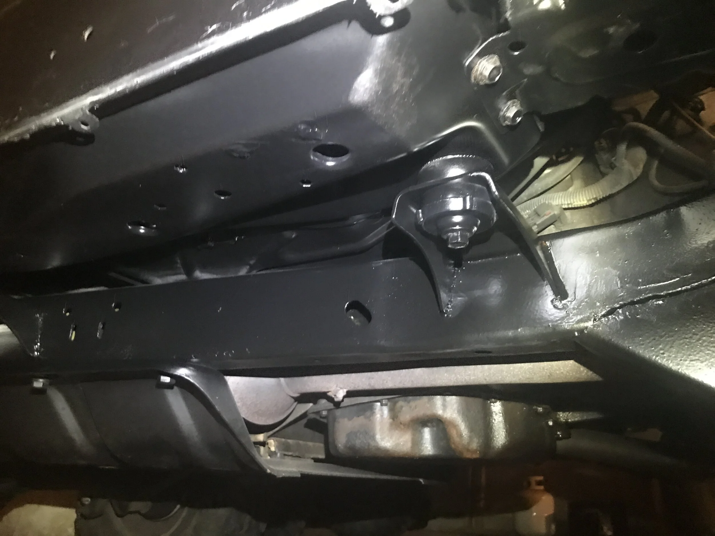

Front body mount was crushed, so l went ahead and slipped in a new one from Dorman.
At 3:30, the UPs man finally arrived (which is kind of funny because me and that guy have a history and long-standing joke about me always working on the jeep 🤣) Went ahead and attached the torque box via the body mounts, marked where l needed to drill, drilled and re-installed.

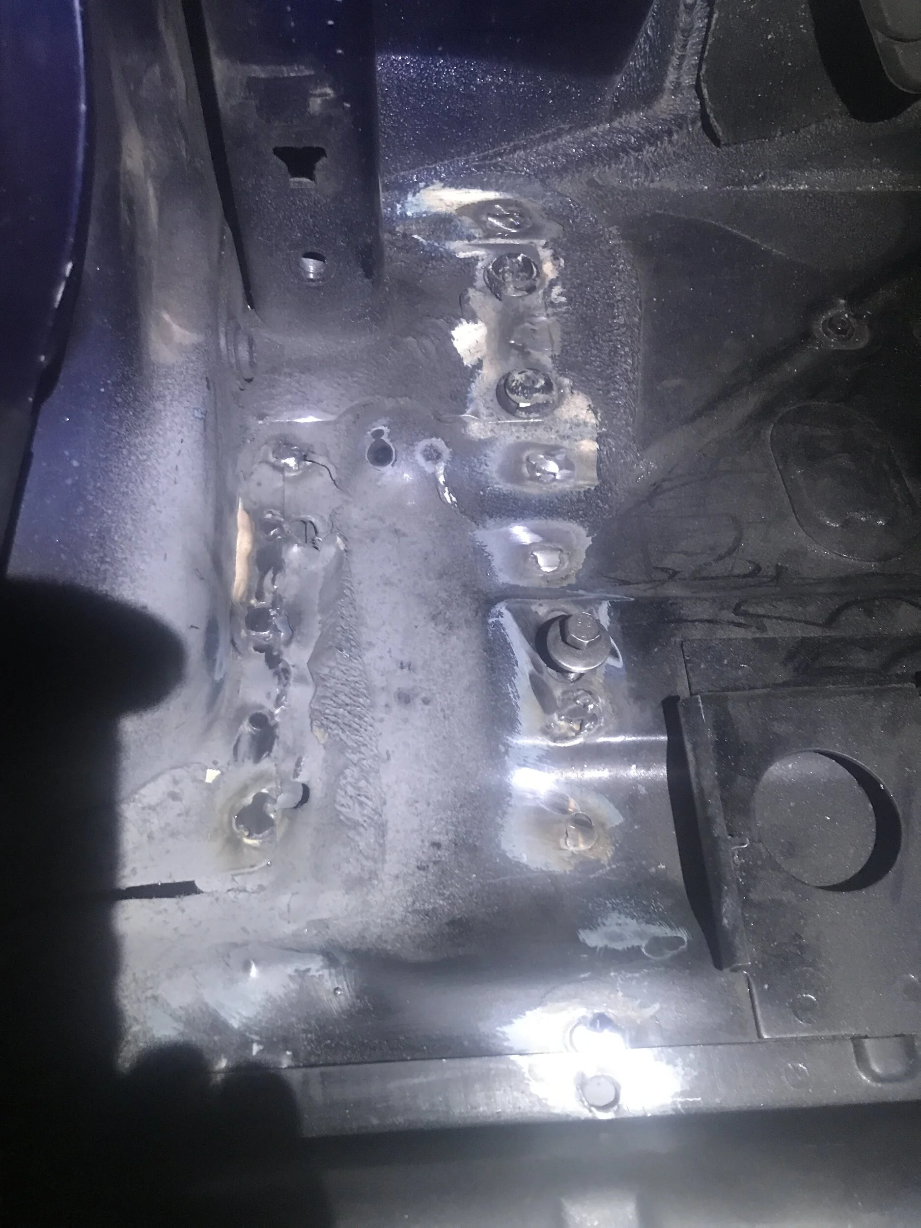

Welded the new torque box in with spot welds (super fun by-the-way) ....... I was better than dad :sneaky:

Then fluid filmed the inside, used lots of seam sealer to fill in all the cracks, and painted everything to match. I think it turned out better than factory.
I think I underestimated the length and intensiveness of the project, but I think I learned a-lot, especially how to weld and get stuff done despite the odds. This was the first really big project that dad @JMT wasn't around to help with all the time, so it was just me and my "skills".

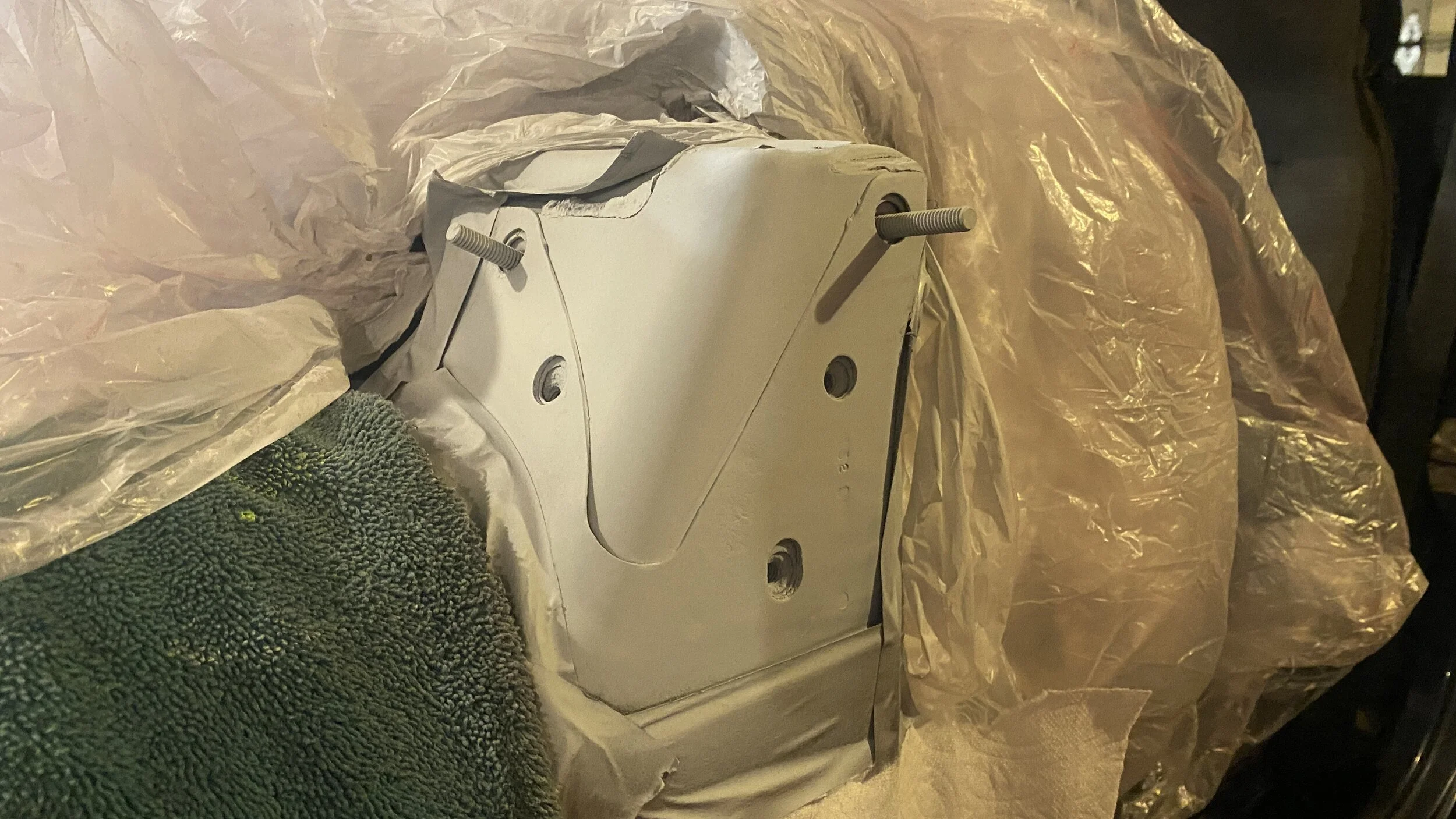

After the torque box was removed, l spent the rest of the day getting everything underneath and in the engine bay prepped for paint and some weld through primer. View attachment 484901
On Friday, l was waiting around for the new torque boxes to arrive so l started painting everything related to the passenger fender, ended up also painting that front section of frame again, because it was easy and why not. View attachment 484907
Front body mount was crushed, so l went ahead and slipped in a new one from Dorman. View attachment 484913
