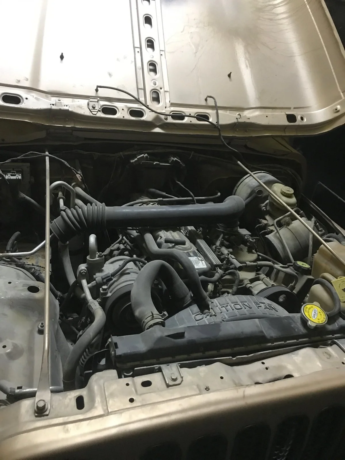

Not sure what all is different from 98 to 05. Probably the best thing to do before really getting into it is studying the pinouts of the 2005 and the 1998 harnesses from the FSM and comparing the 2.
Another thing to consider is the differences in the fuel systems. I think late model tjs run a higher fuel pressure than early models (not 100% positive on this) .
Most likely, just guessing, your 2005 tj body is going to end up with a complete wire harness from the 1998.
What is your goal? I personally would try to find another pcm for the 05. It is probably possible to swap complete harnesses, but that is going to be a huge project.

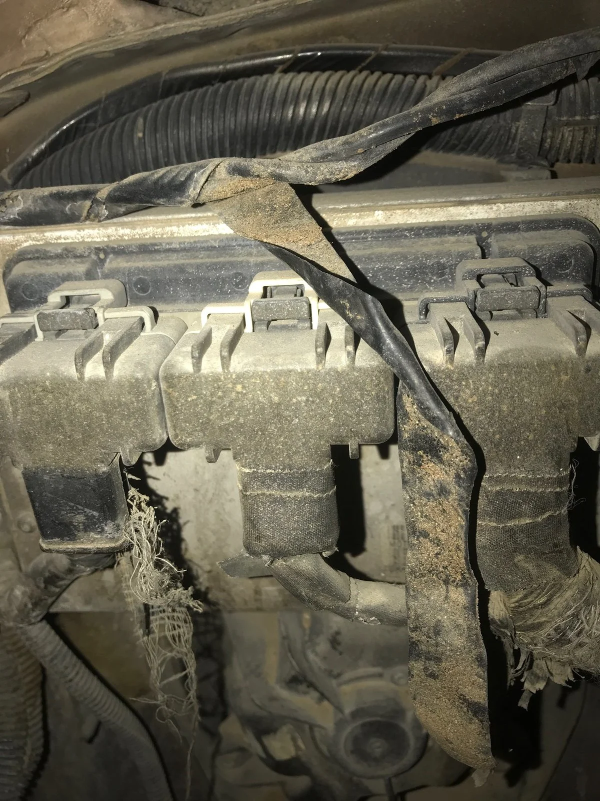

My situation was different. I modified my old harness to run a ccd tj cluster with a ccd style dodge ram pcm. If you plug in a scanner to my jeep, it comes back with a vin from a 2000 Ram pickup.

I own my tj for 6 years, I’ve changed 3 pcm’s and 4 42rle
Our weather is hot it reached 58c in summer
I tried everything to cool the pcm and gear but ended up changing them
So i said to my self why i will pay 1000$ for the pcm when i can buy a 98 pcm and harness for 150$
And manual transmission is way better and stronger than 42rle
So i buy the scrap 98 tj for just a 1200$ and its working great but the chassis is rusty that it cant be fixed but other things works just fine

What sort of issues prompted you to get a new pcm?
I'm starting to think that's what issues I'm having.
Start getting codes that you cant clear
Cars misfired randomly
Sometimes you need to switch off and back on to get everything works fine
Transmission most of the time on limp mode
Lose of power

Sounds like swapping to the 1998 stuff is a solution then. Like I said before, your jeep probably is going to end up a 2005 body with a 1998 wire harness and drivetrain. If that's what you want to do, it's most likely possible.
You should really study the wiring diagrams for both jeeps before you start. Unless someone has done the exact same thing you are trying to do, we are all just guessing.
You asked about the ac . If the 1998 had ac, then it should be just a wire harness swap . If not, than the wiring diagrams may point you in the right direction to make it work.
I am only sure of what I have done myself. I do not have all the answers for what you are doing.
