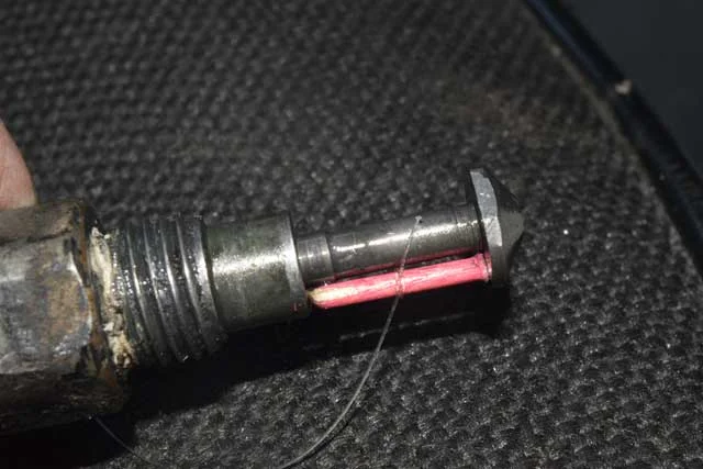

If they feel completely locked with no unusual noises I'd have to guess your problem is with the sensor located in both axles. The sensor has a plunger that gets pulled out when they're completely locked which turns the locker lights steady. The sensors are the only thing on the axle housing that has an electrical cable going to it, it's up near the top of the pumpkin.
This shows the plunger of the sensor, the top hat of it hooks over the locker actuator that pulls it outward when the locker is locked. That red thing is the stub of a toothpick used to hold the sensor fully open when reinstalling the locker so the locker and sensor are properly linked together.
