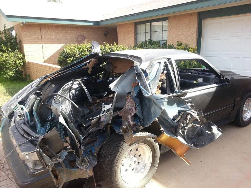

Me too. The closest comparison I could think of would be a nitrous tank in the cab. That has been done for years, but there have been examples of tank explosions that resulted in significant damage. I'm not familiar with CO2 tanks, but nitrous tanks have burst discs that attempt to prevent the entire bottle from turning inside out. I wouldn't run a pressurized tank inside the vehicle without a fail-safe.
Photos like that are non-helpful since there's no telling what actually caused that damage. A nitrous tank runs relatively low pressure too, similar to a CO2 tank. It's a non-issue though an idiot could kill himself with anything given that he's an idiot. A CO2 tank is a COMPLETE non-issue as was described above.

Iirc the car in the photo had a tank where the owner had modified it by removing the burst disc. Car got hot and the bottle let go. My point was a burst disc or similar safety device should be used when a pressure vessel is used in a confined space.

Burst discs (pressure relief devices) are required on pressure tanks by law, you can't buy a tank without one.
There's no accounting for an idiot who chooses to defeat safety devices. That's why I got irritated with the above photo showing the damage after a modified tank blew. Like showing a totalled car and dead bodies as a reason not drive cars without also including the facts the driver was drunk and bent on suicide by car.

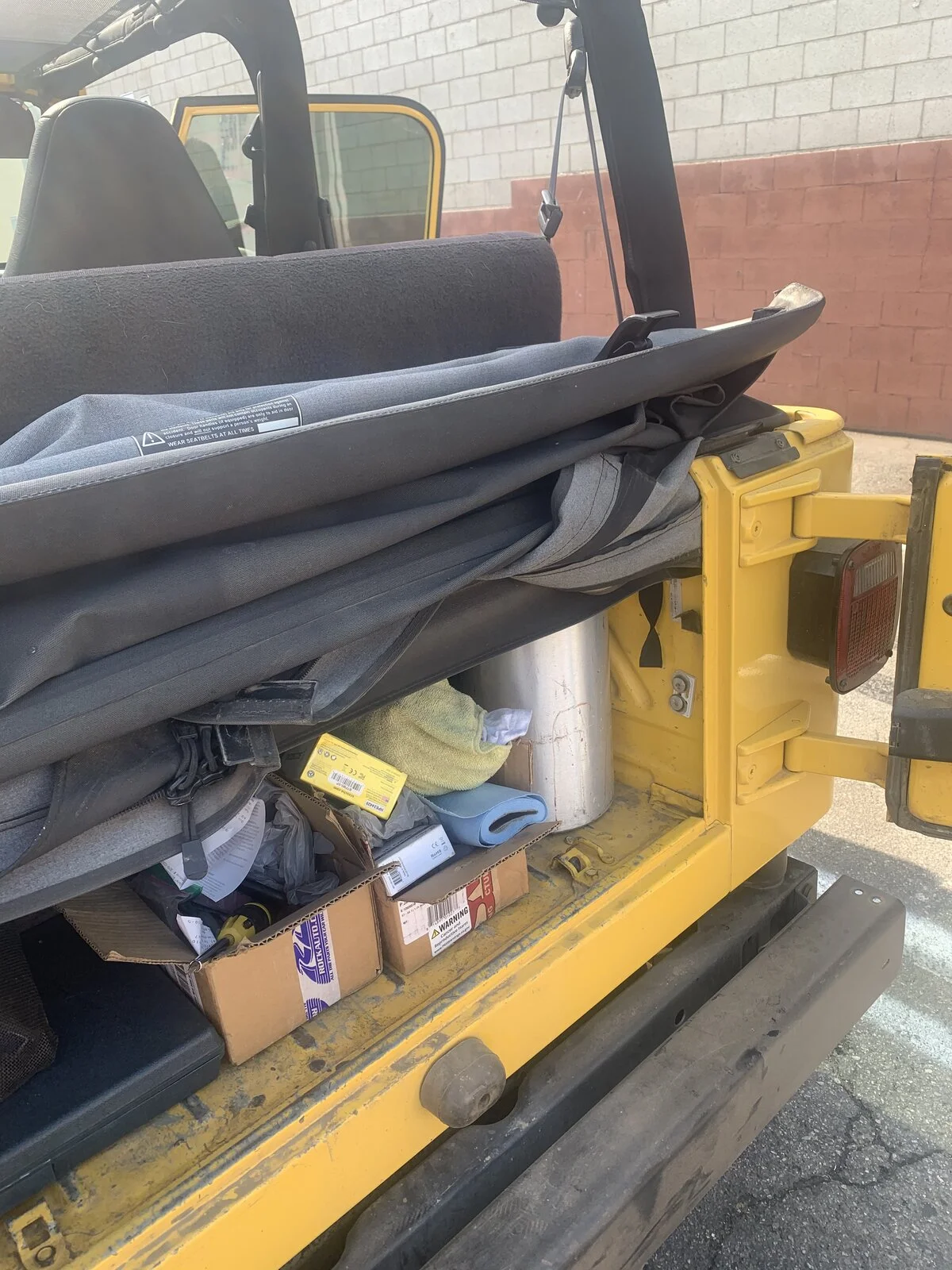

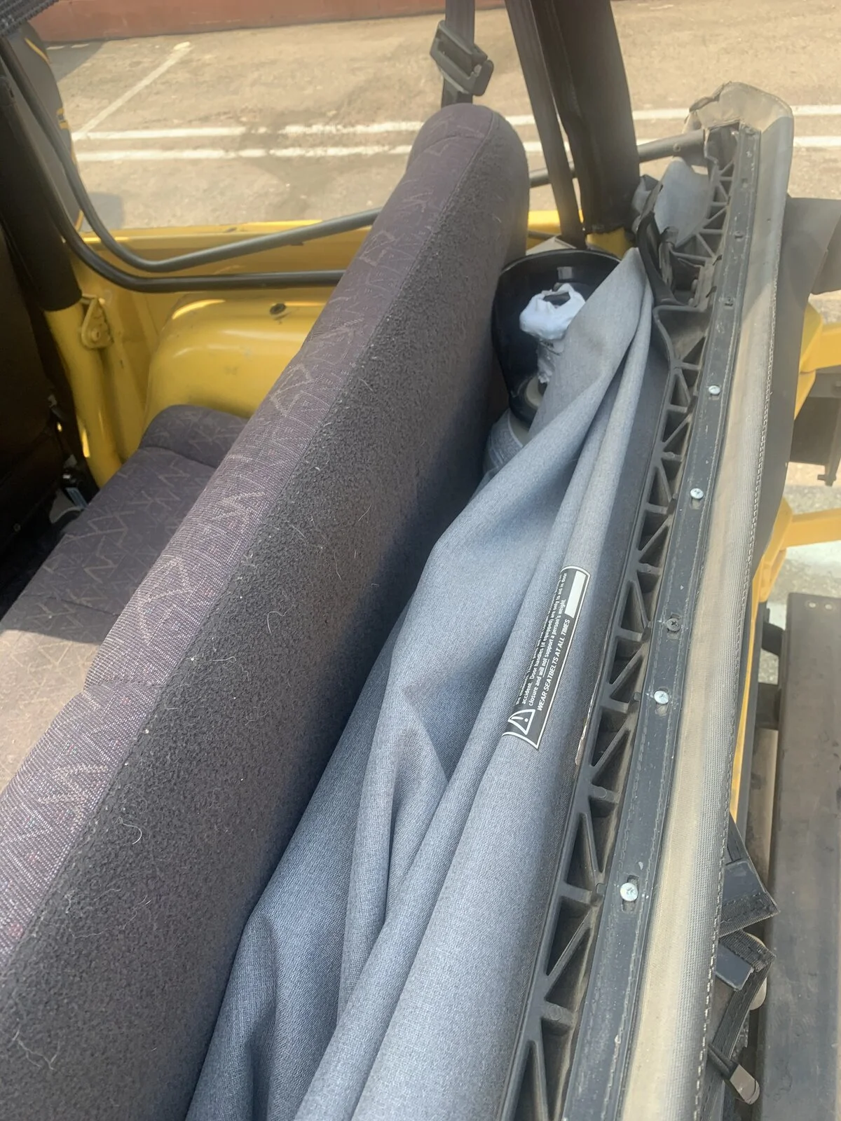

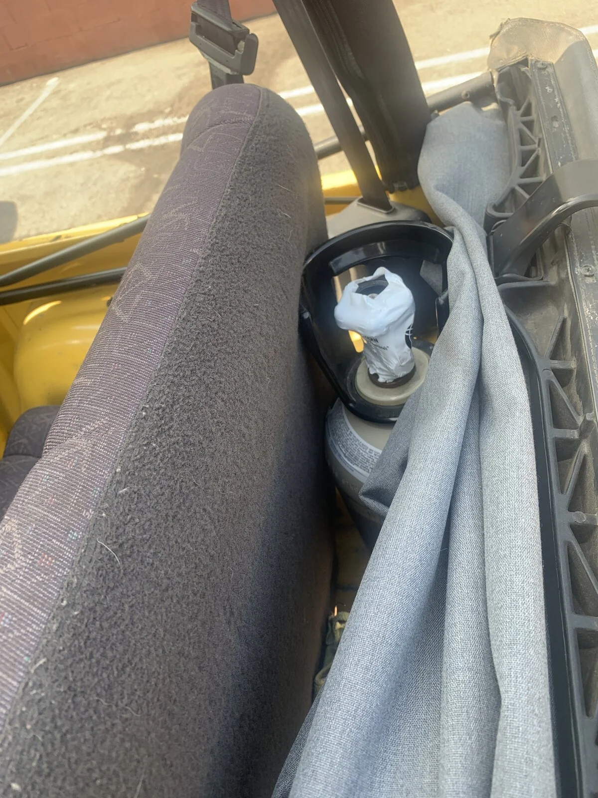

Sooo
im gonna strap it down right here. No interference

Can it interfere with the backseat at all? If so, I saw a really clean mount that bolted to the holes where the hard top would typically sit - however that took up a little of the leg room.

That's where mine used to sit with rubber straps. It interfered with the tonneau cover (if you ever plan on running one)
