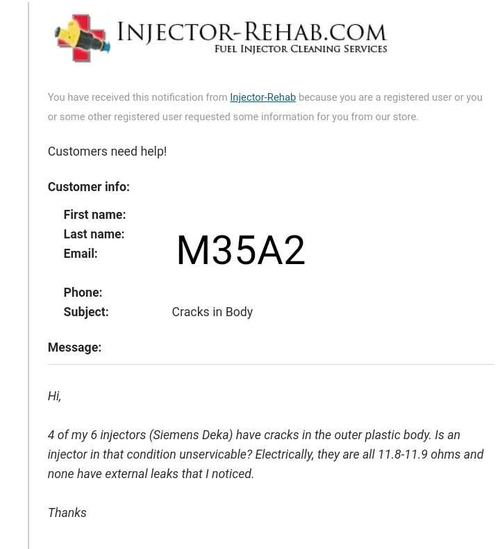

I do appreciate your input, sir. I was able to find a complete rebuild kit for all 6 injectors for $9.00, so it's a minimal investment to try. And since the original question was about $18 injectors from a reputable source, I am HIGHLY suspicious of an entire set of injectors for $35 from eBay.

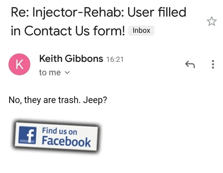

Keith Gibbons at Injector Rehab has advised me to replace them with a set of rebuilt and flow tested Bosch EV6 injectors, so I'm thinking I will probably do that.
