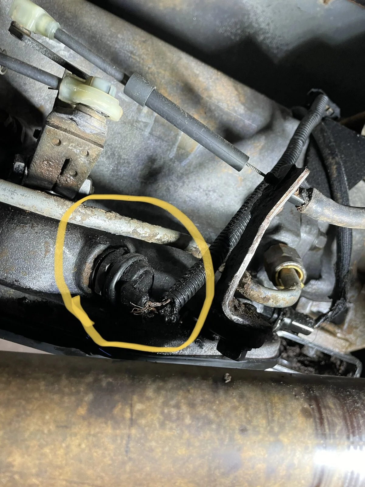

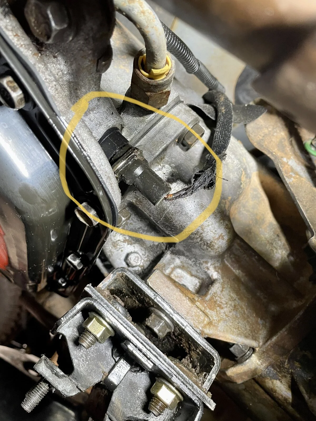

I ran into this same issue this week. After inspection the trans this week I saw this. I am having problems finding what the sensors or switches are. One of
them i believe to be the Neutral safety switch. I do not know what the other is.
