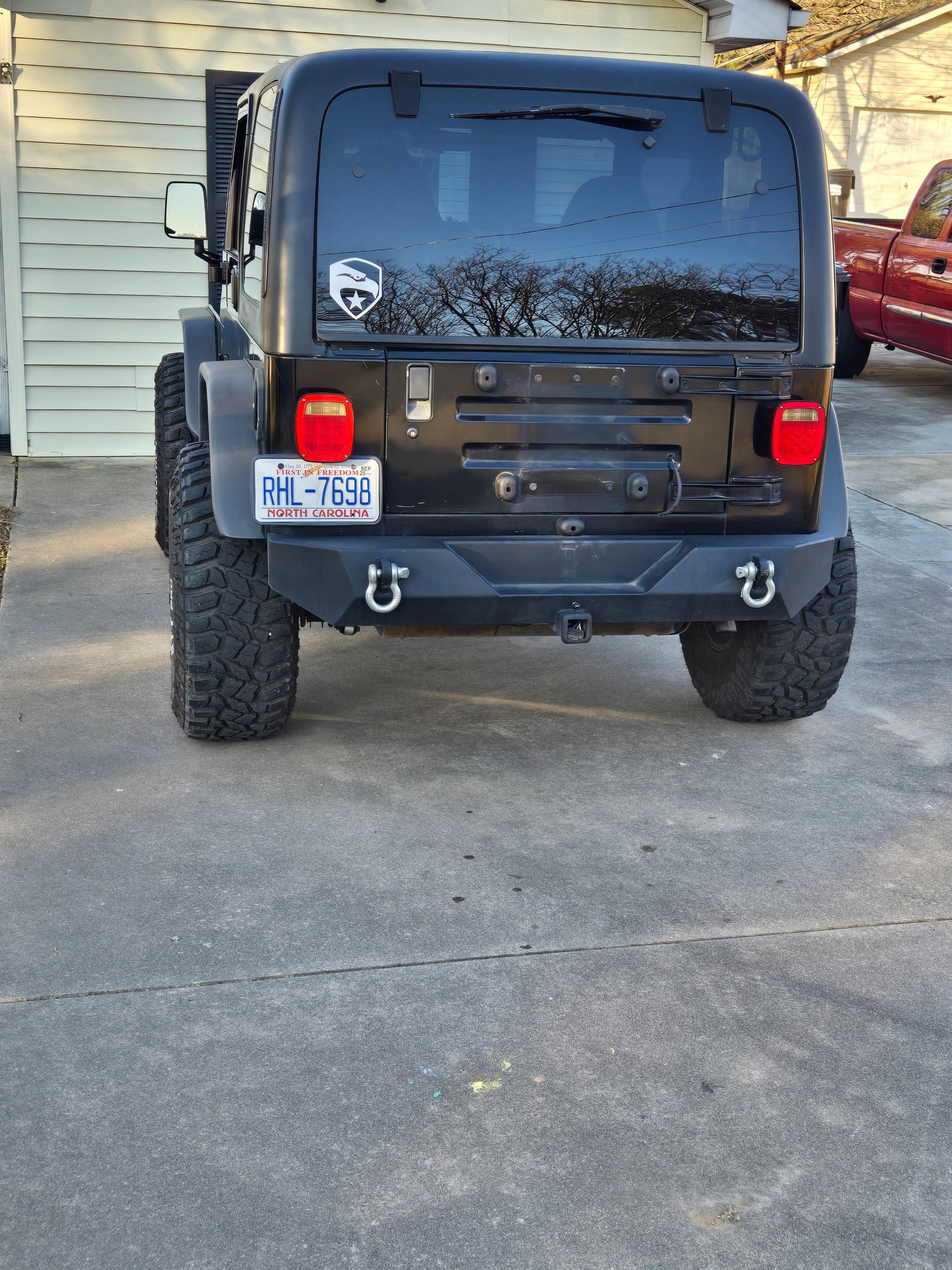

Okay so this is my first post, but Ive been reading this forum weekly since I bought this Jeep over a year and half ago. Came time for my new to me vehicle, wife knew Ive always wanted a Jeep. She for some reason agreed to two doors(we have two kids that need to start driving mind you). I searched and found a nice running 99 with a new lift, and 35 in tires. I was planning on replacing the rough country lift, and going to 33's. But I love the look of the 35s! Ive spent the last year fixing the small issue and wore out parts. Next is gears and shocks. Im a local mailman, so Im use to a rough ride. But my jeep is super bouncy with the RC shocks. At 55 on the country roads here, its always a bit touchy when I hit bumps. But I only drive 12 miles round trip a day to work and back. Never above 45 daily. Im set on buying Fox brand shocks. Its one of those things Ive always wanted. Ive been doing my research and the prices are making me rethink a little. Ive been saving for the premium 2.0. But this Jeep is mostly a street queen. Plus there's other things that need to be addressed. Litte rust is starting under the driver floorboards. Its my daily, only offroad Ive done is on my family farm and deer season. Ive taken a lot pride in fixing this jeep, bringing it up to date. Replacing cheap parts the last owner used, and running down random breakdowns on a 25 year old vehicle. But I have to be at work no matter the weather. Now for my questions. If I step down to the Adventure series, would I still get a decent ride? Its 400$ vs 900$.I know its going to be better than the "Premium Rough Country" shock that I have now. They leave much to be desired. In searches not much comes on the adventure series. Im alot more comfortable with 100$ per. After all I could always buy rancho for cheaper, and after the post on here I know ill be close to happy. I just want to try the Fox brand. Running a 3.5 suspension, 1.25 body lift, on 35s.

Ok so I ordered a set of the Black Maxx from jackit.com. I was set of the foxes but the reviews just aren't there for that kind of money. Plus there's a ton of other post on here that speak highly the black maxx's. I am still planning to order the fox steering stabilizer. I highly doubt the rough country one that I have is doing much if anything. Im running 35 psi now. Getting great tread wear, had them for over a year and half. But Im sure I could let down some. I know almost nothing about big tires, other than air down to offroad. Letting it down to 25 onroad is okay for my tires?

Ok wife noticed! That made a huge difference! Hopefully the new shocks calms down some the buggy feel. But just airing down made me rethink some of my life choices. That might been the best thing ive done to it since I bought it! Waiting on my local jeep guy to get some room in his shop to regear. Definitely going to 5.13.
