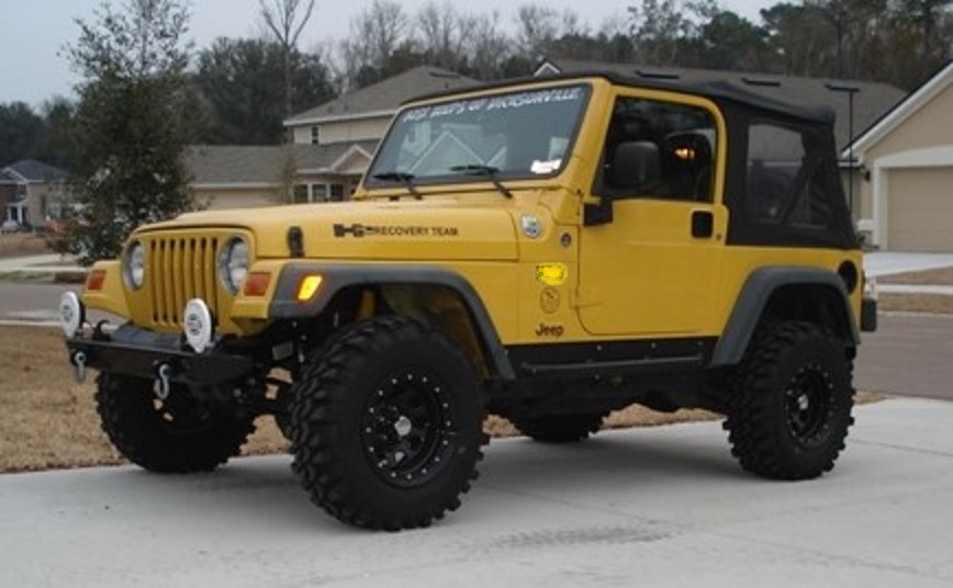

A 2" lift with 31" MT tires and 15x8" wheels with 3.75" backspacing.

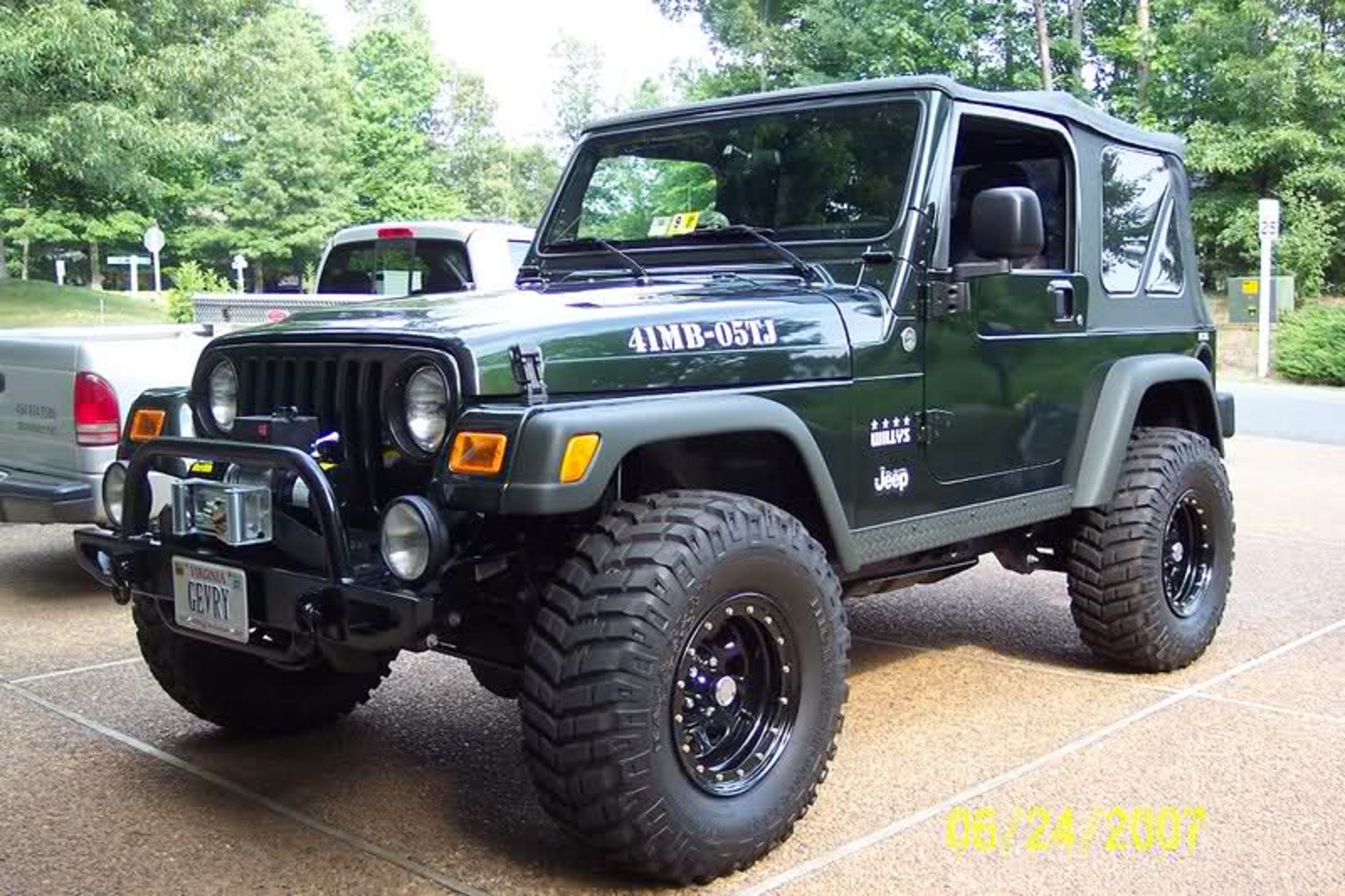

33x10.5" tires with a 2" lift.

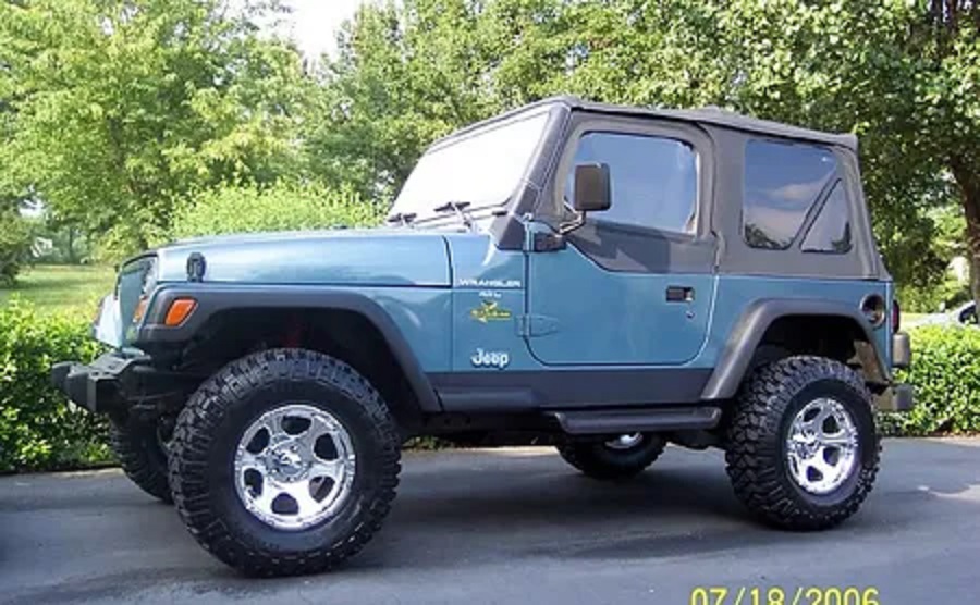

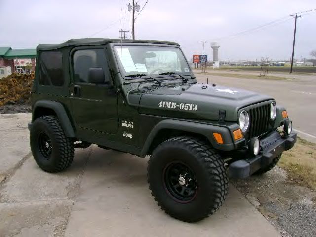

33x12.50" tires with a 2.25" lift.

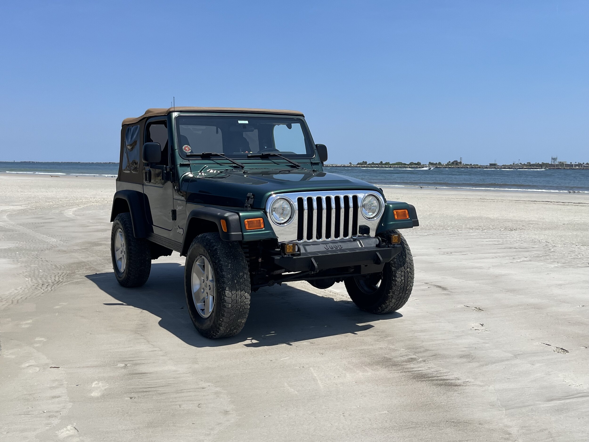

This a 2" spring lift with JK 17" rims. 1.25" spacer adapters, 265 x 75 x17 and Ranch 5000 shocks.
There is no rubbing when off roading in FL with front sway bars disconnected, but I have not flexed out the suspension like you would rock crawling.
Wait......... you disconnect the sway bars for beach crawling???? ;) ;)
