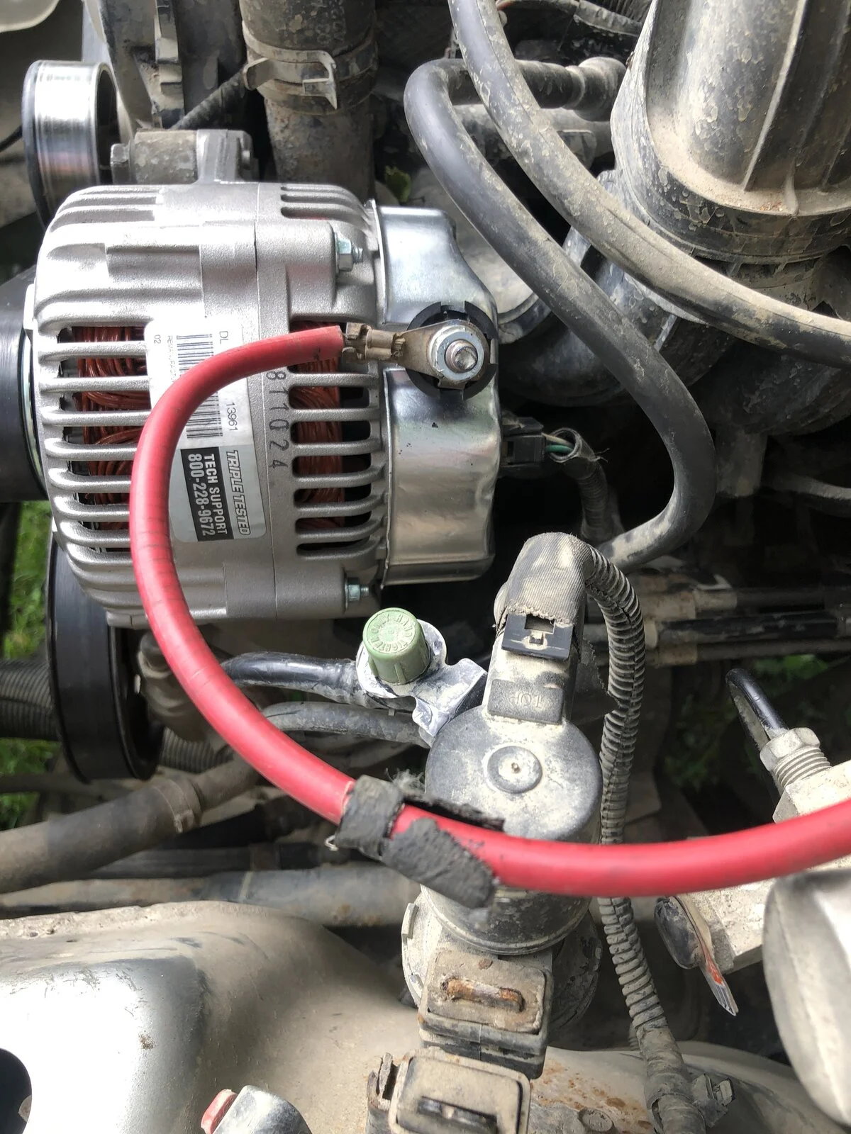

At any rate, theres only hot (red) on the side and the "other" (2-wire with electrical socket) connected at the back.

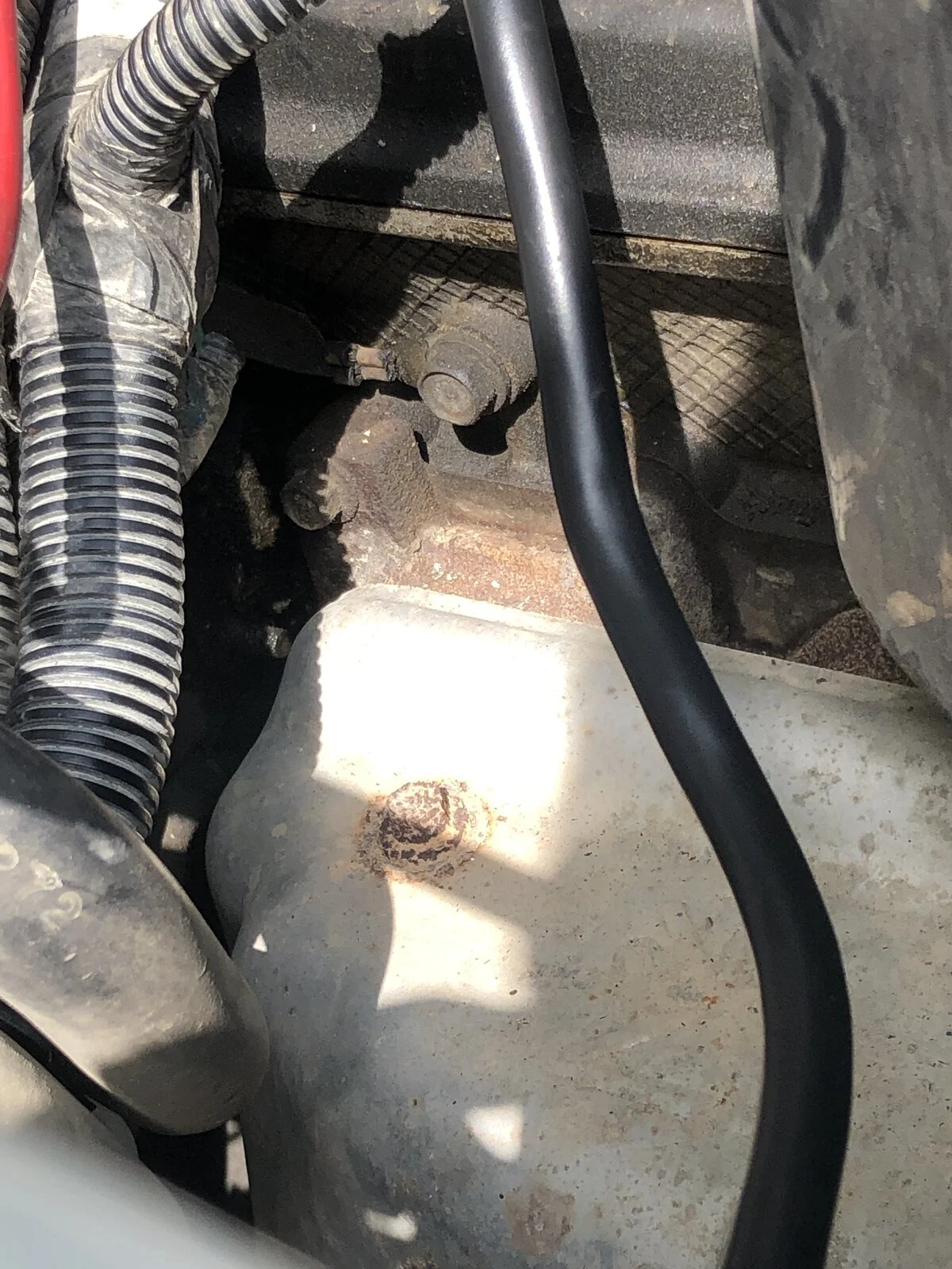

Here’s the alternator. It’s a 136 amp. The second pic is where it smokes once I connect the negative to the battery.
I see it is triple tested. Triple tested probably meant it must have failed the first two tests. The quadruple test was the installation. Disconnect the battery, remove it and return it. Most likely defective when you got and surely cooked now.
I'd disconnect that big fat red wire from the alternator, keep it away from EVERYTHING, and then connect negative to battery. If there's NO smoke at that point, it's the TRIPLE TESTED alternator that may have NEVER actually been tested.
You were right. Disconnected the alternator and there was no smoke. Gonna take it back
