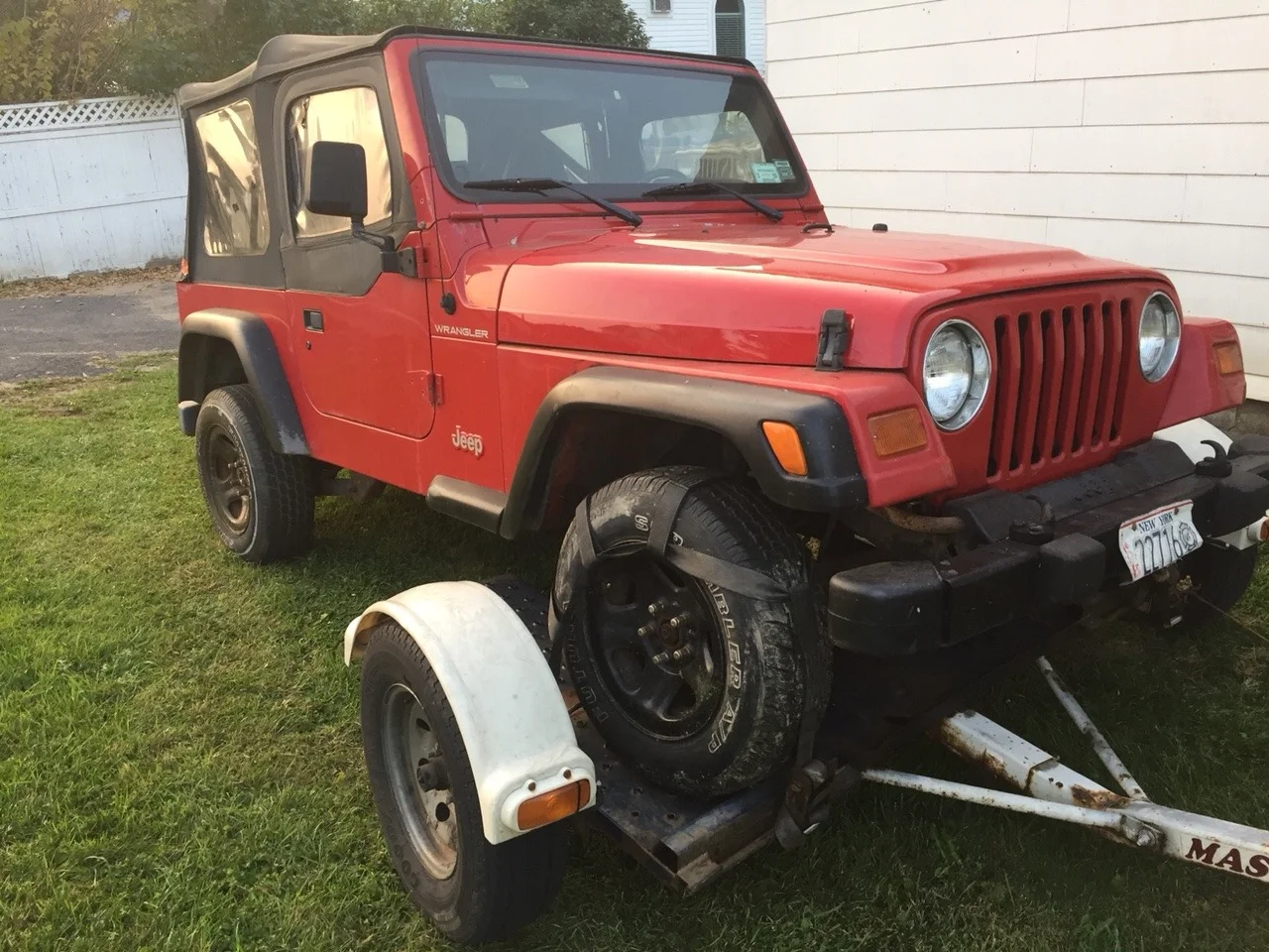

So I bought a 99 TJ for $1200 with blown engine.
Frame and floors great. Reason I bought Jeep was I scrapped my 95 after body and frame succumbed to NY weather. I saved everything but body and frame. The 99 came with complete engine rebuild kit for the 2.5 sitting on passenger seat. I figured I would just drop my 95 2.5 into the 99 but it is not direct swap according to interchange info. Now my question is it looks like the differences are intake and the 95 engine having sensor in head. Can I just block off sensor and swap intakes? Then of course use 99 wiring harness. The reason for just not rebuilding is I got word back from machine shop the head has major crack and block will most likely require machining.
