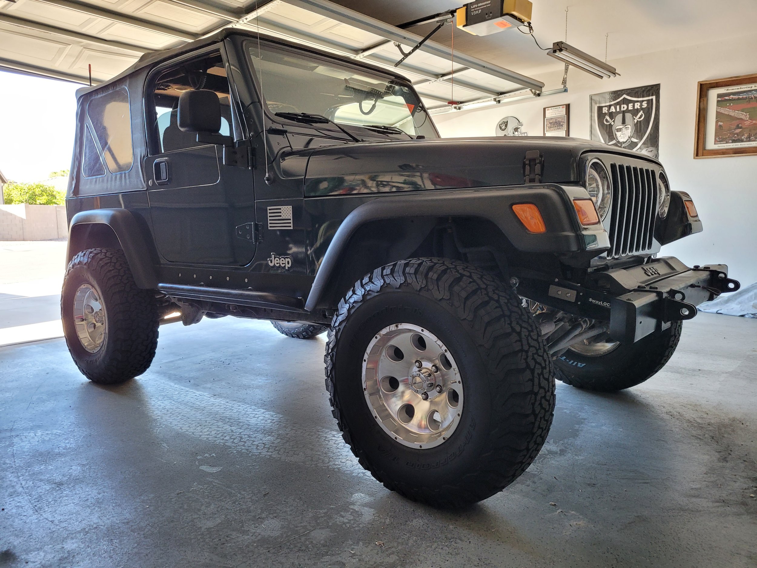

Mine's on 2" + 1.25" + skinny 33s. Yours should be fine, but like red02tj said, you should then cycle your suspension and set your bump stops.
