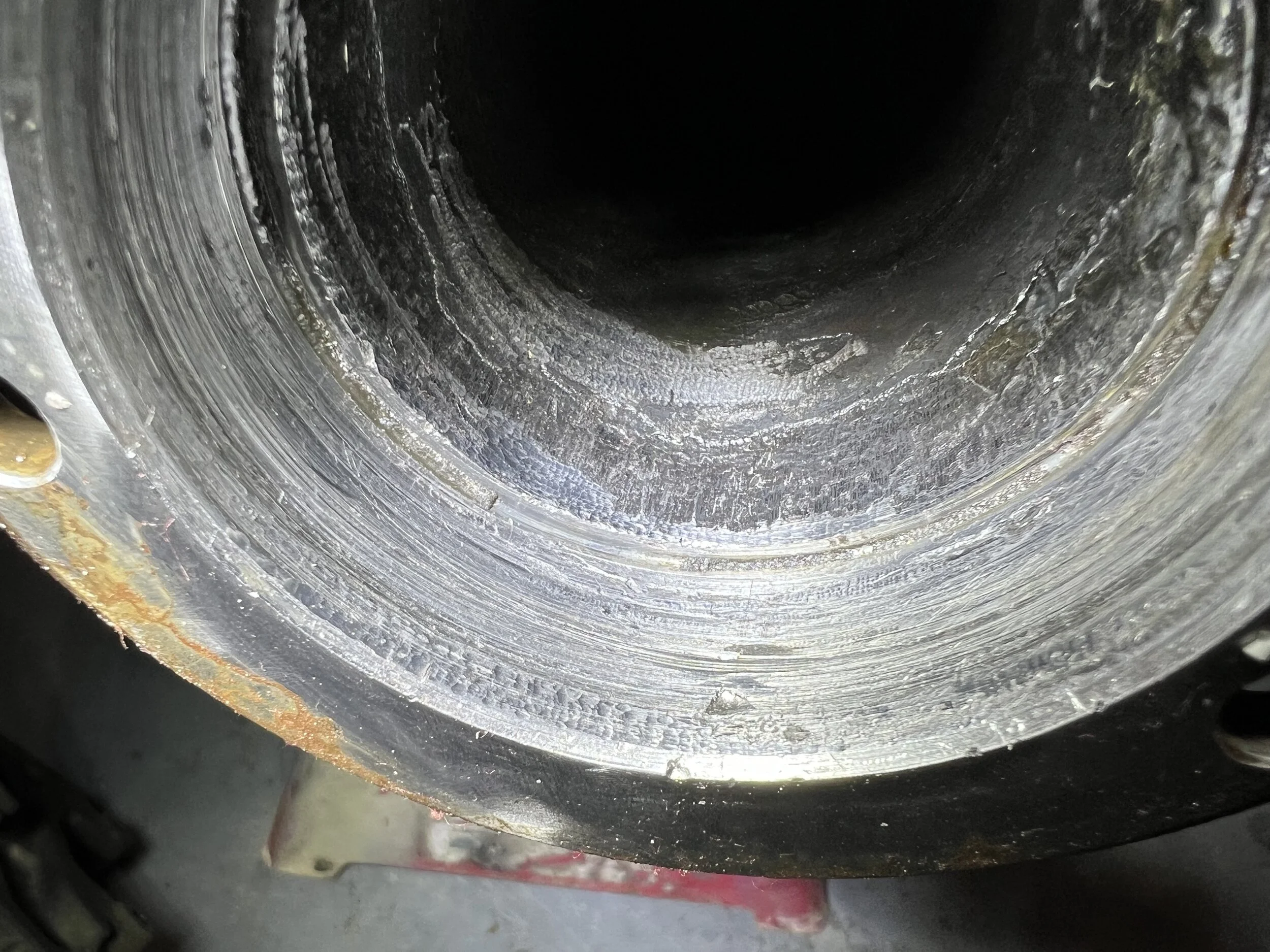

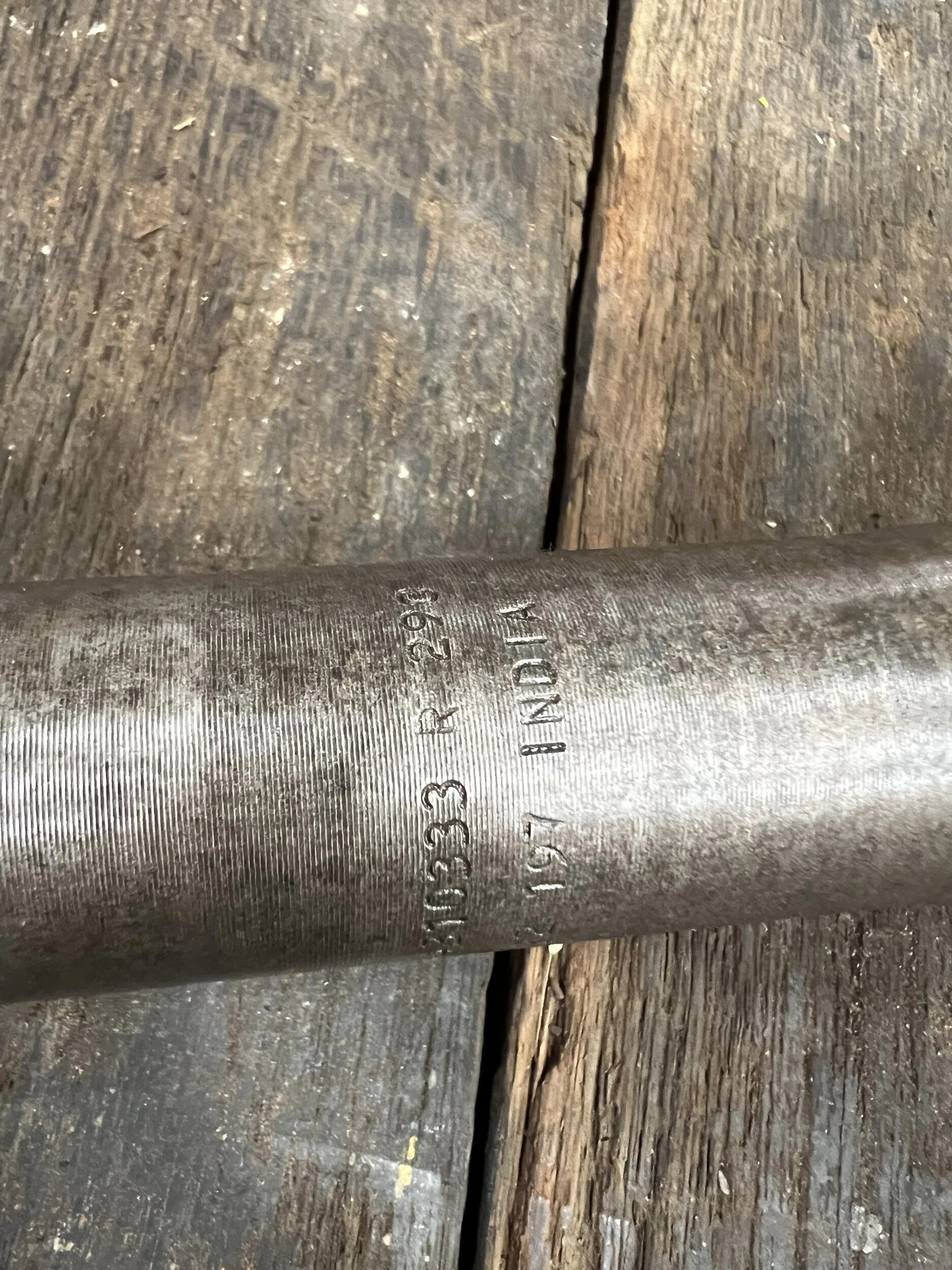

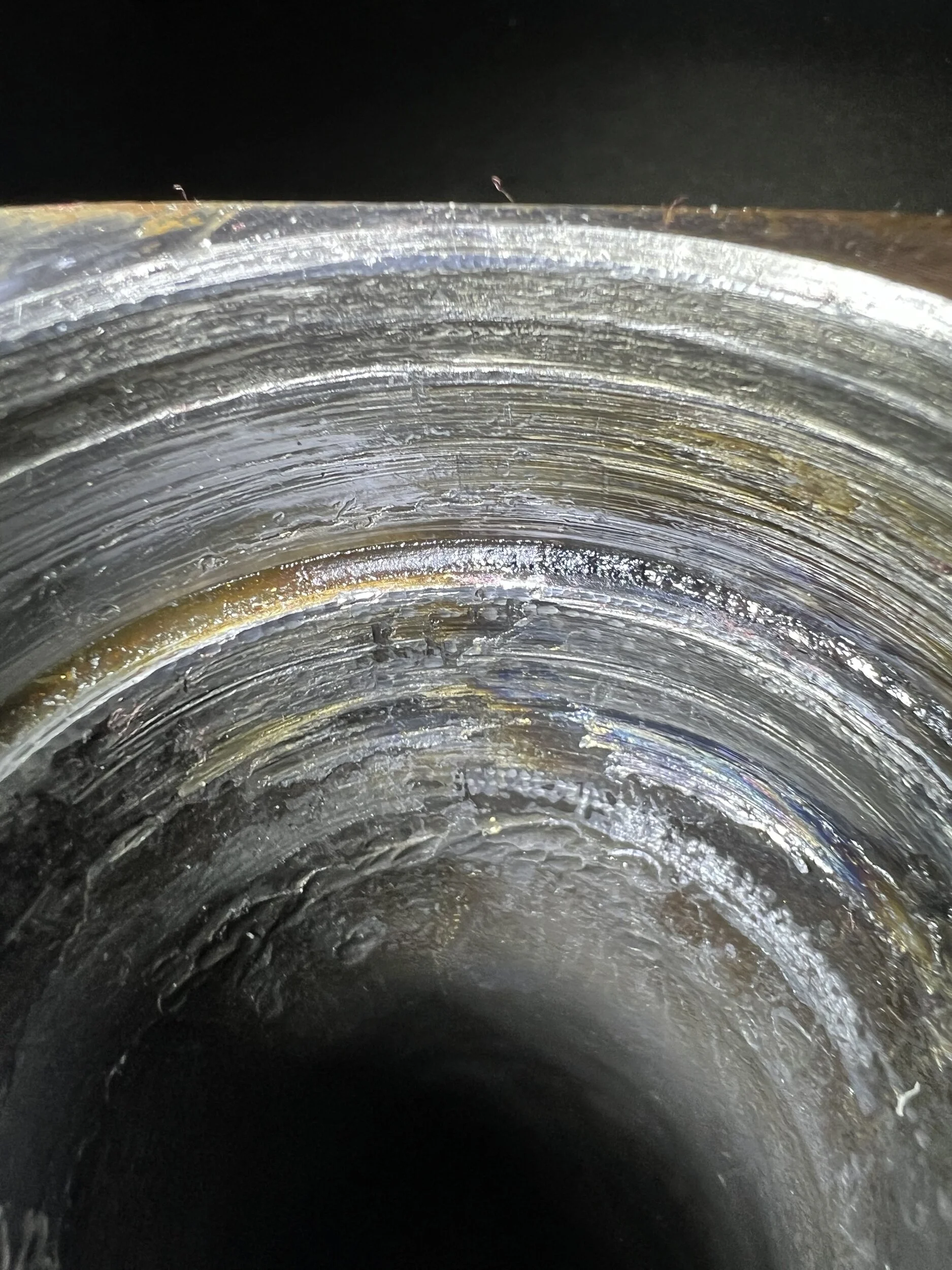

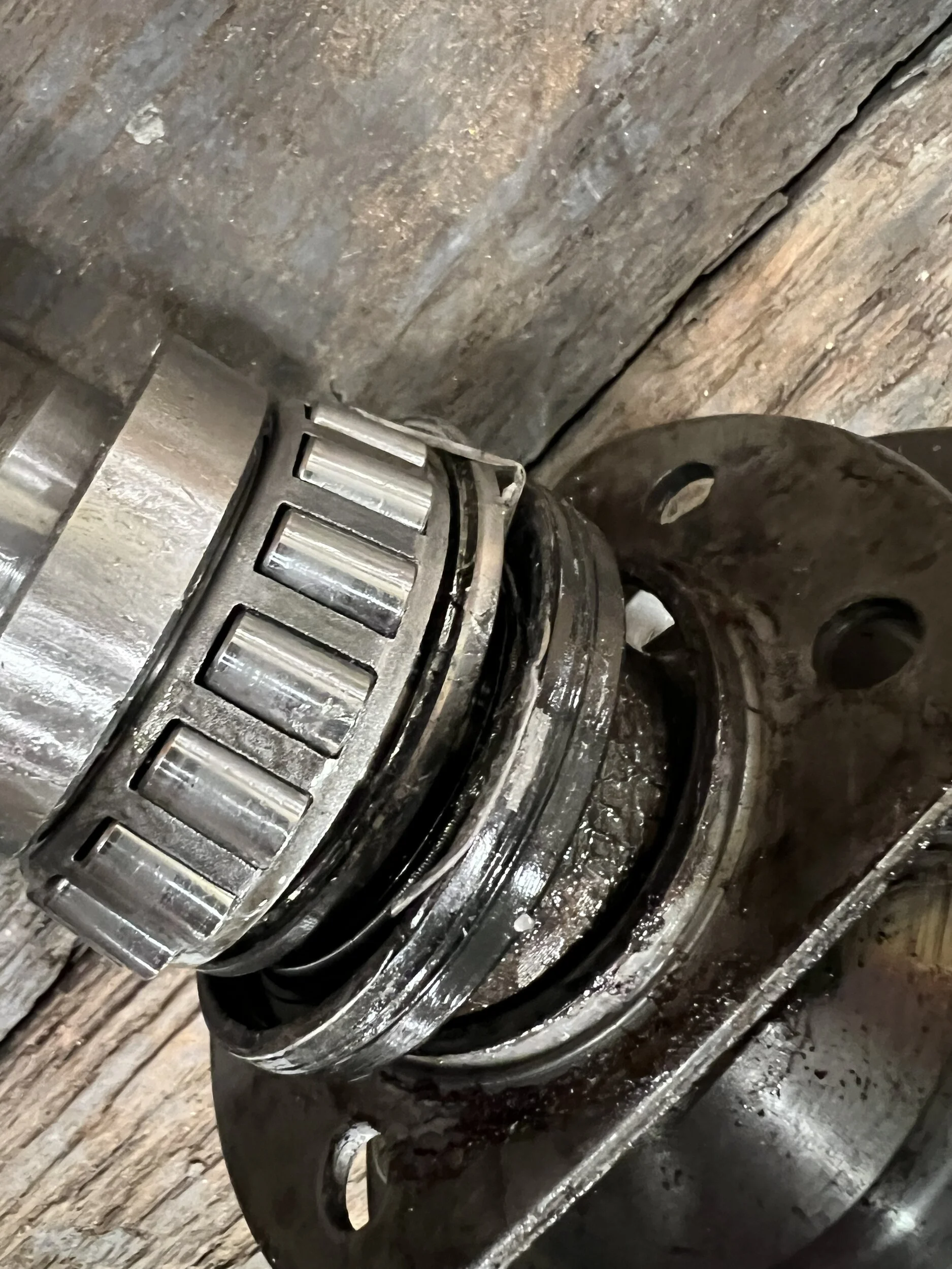

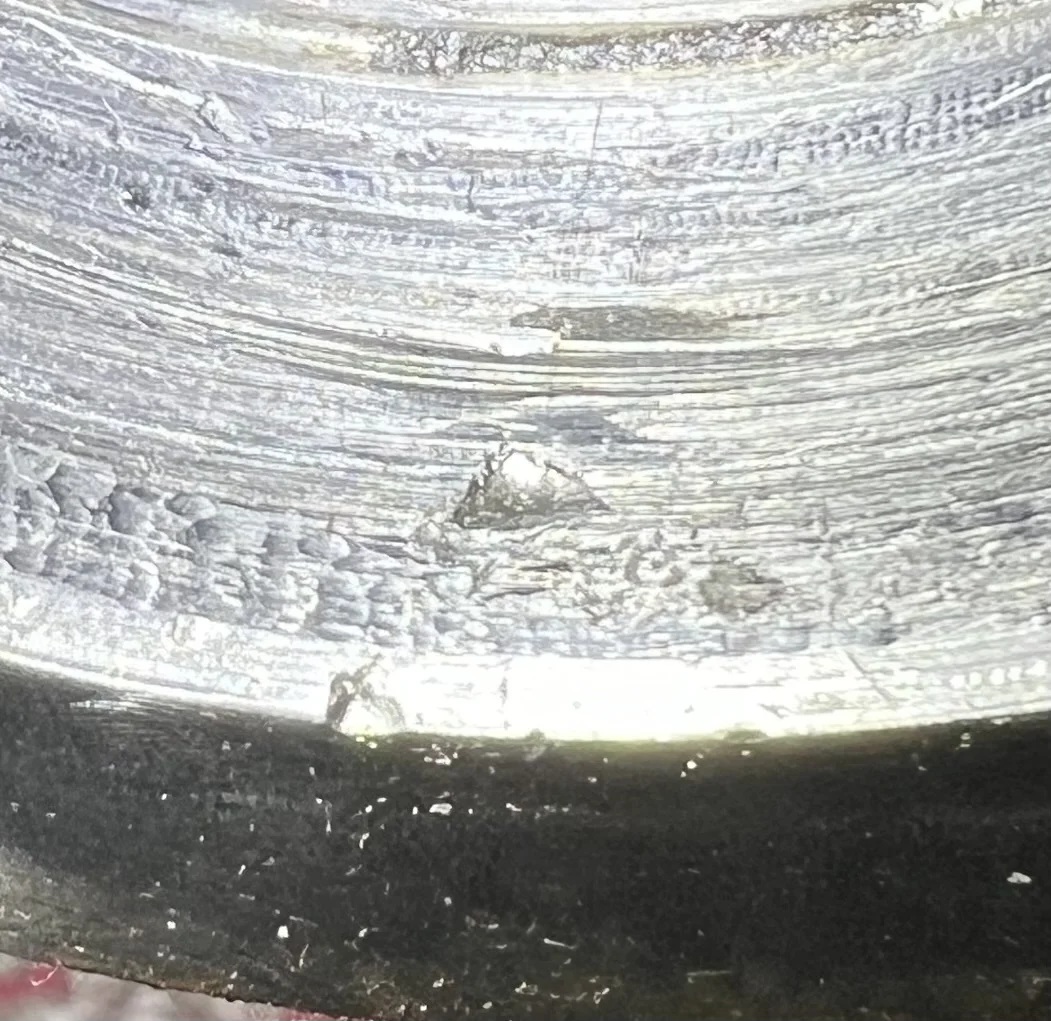

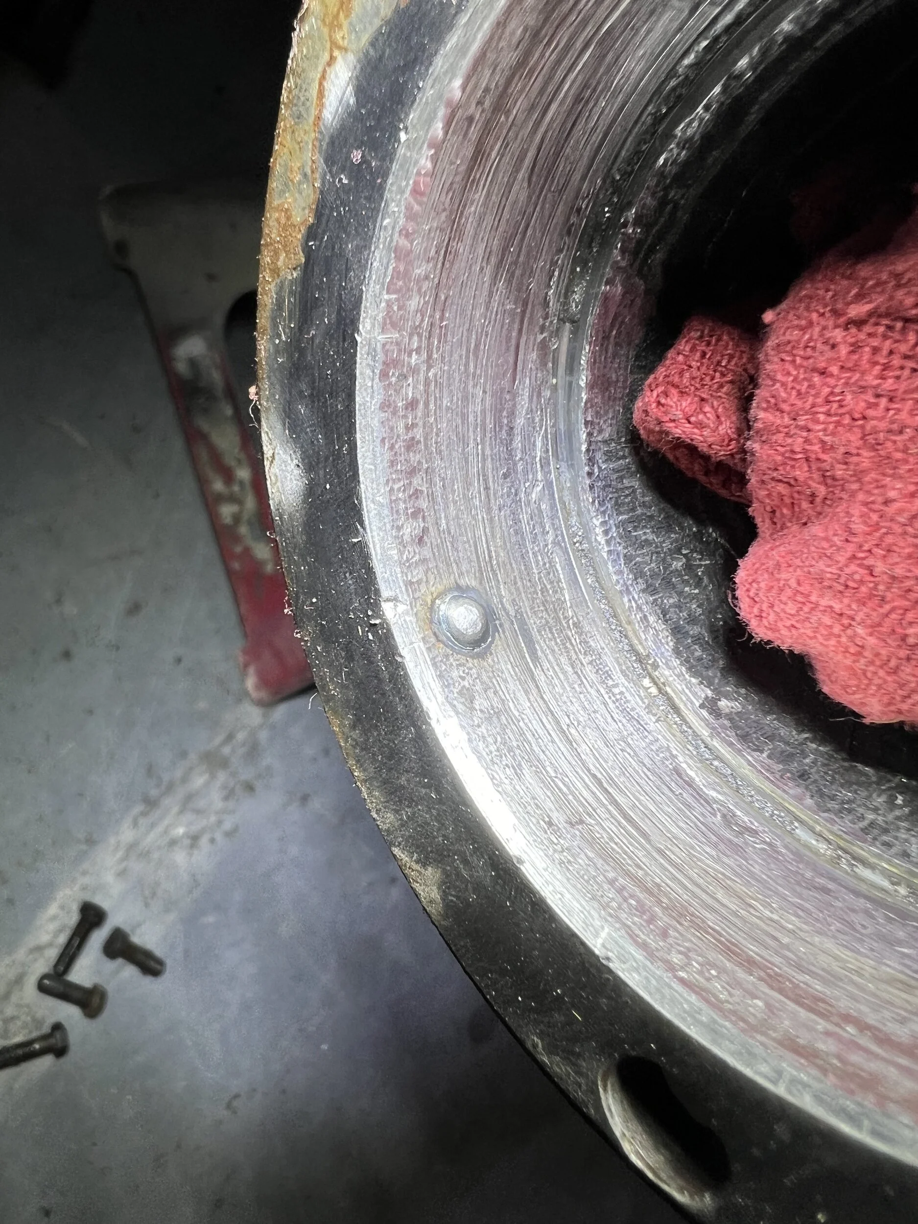

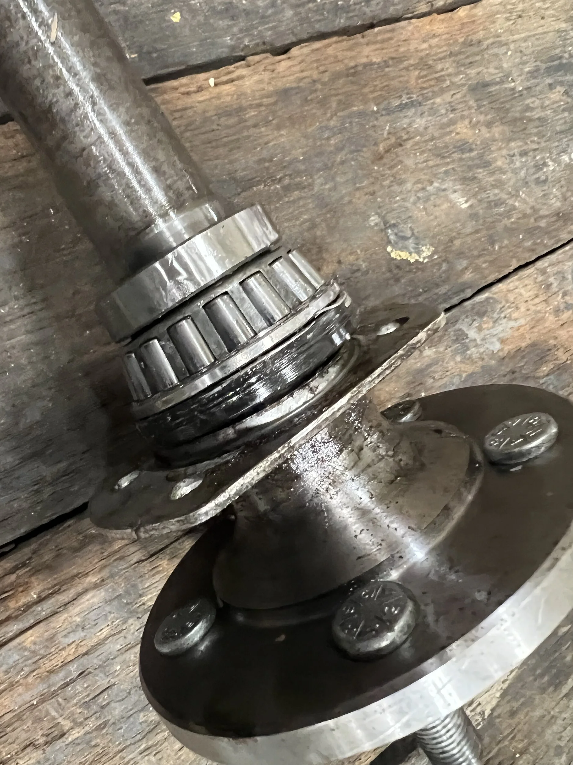

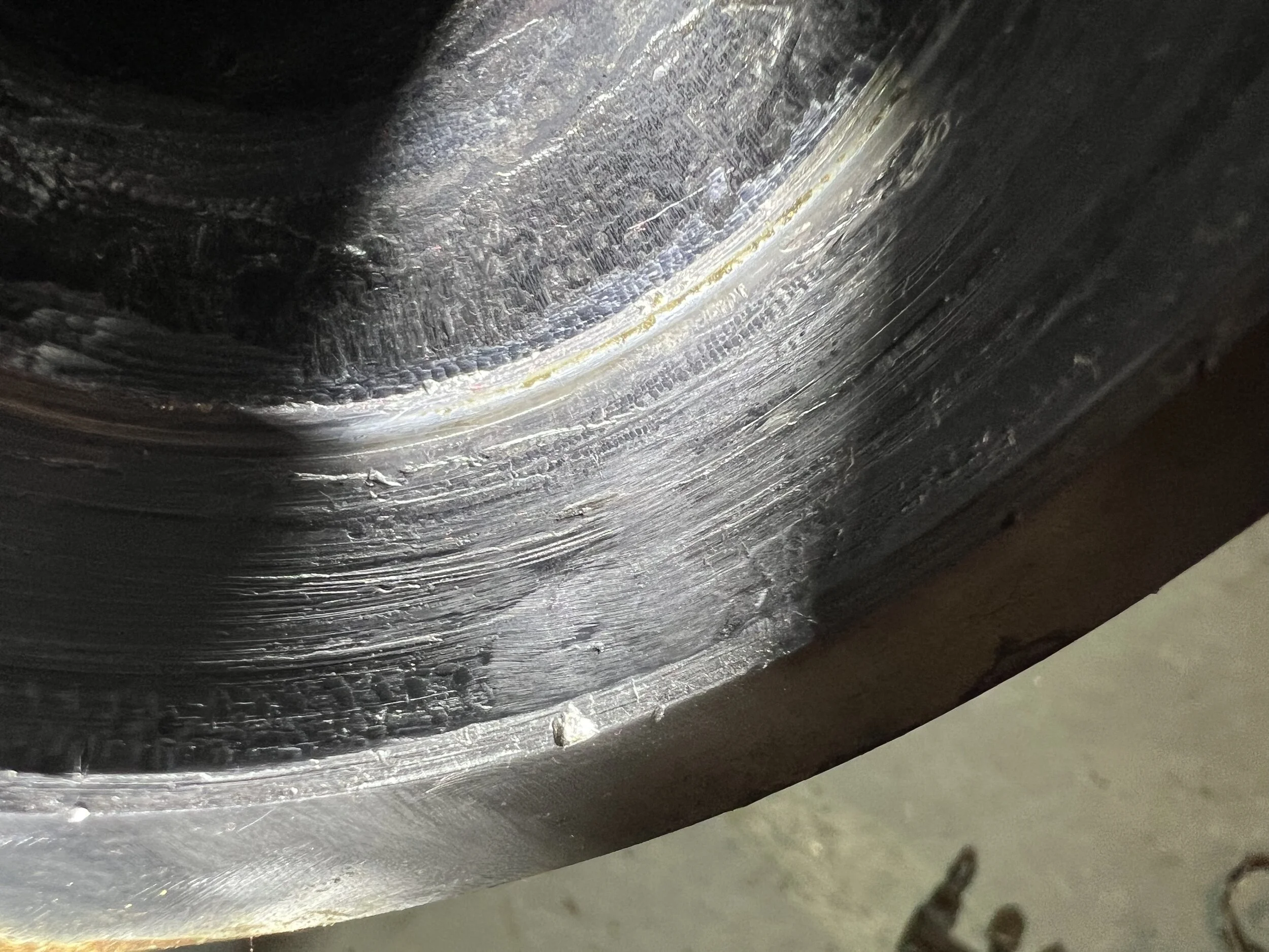

I have an 03 Sahara and everything is great with it, got it about a month ago. I knew when I bought it, it had a leaking left rear axle seal. Bout the only issue. So I took it to the shop I use and when they took the axle shaft out, it was new, with a new bearing and seal. There was a small groove on the inside of the housing where the seal seats. Is there a remedy to this, like a different axle seal that is wider or something? Shop was like oooo yehh you need a new housing.... which is entirely possible, but, I'd figure Id do some research first before dumping a lot of money into something that it probably doesn't need. Oh and it is a dana 44 with disc brakes. Thanks for any insight
